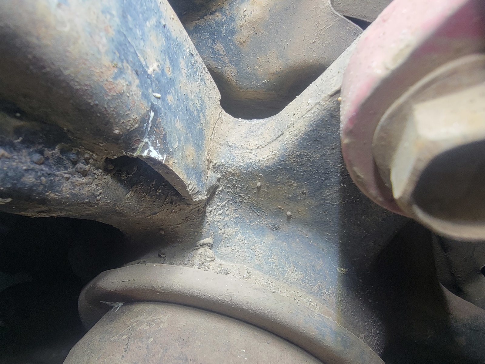

    My spindle gusset is cracked on the weld.

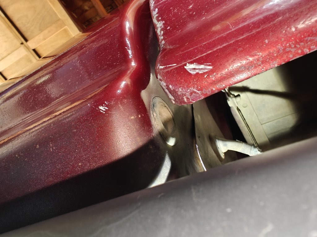

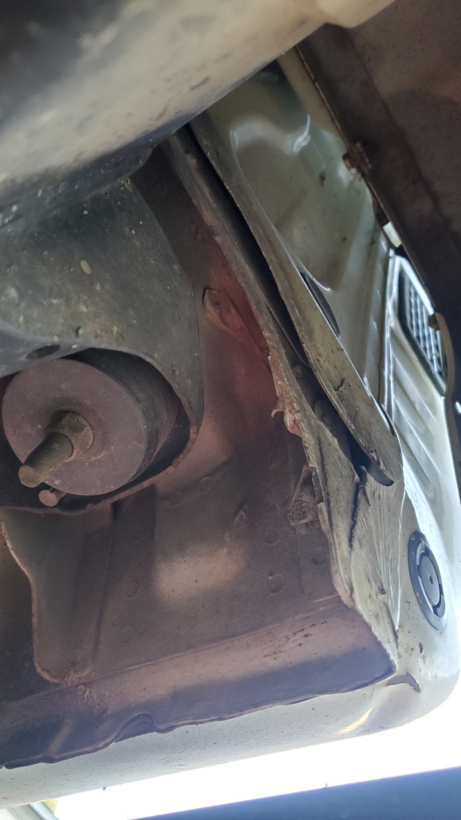

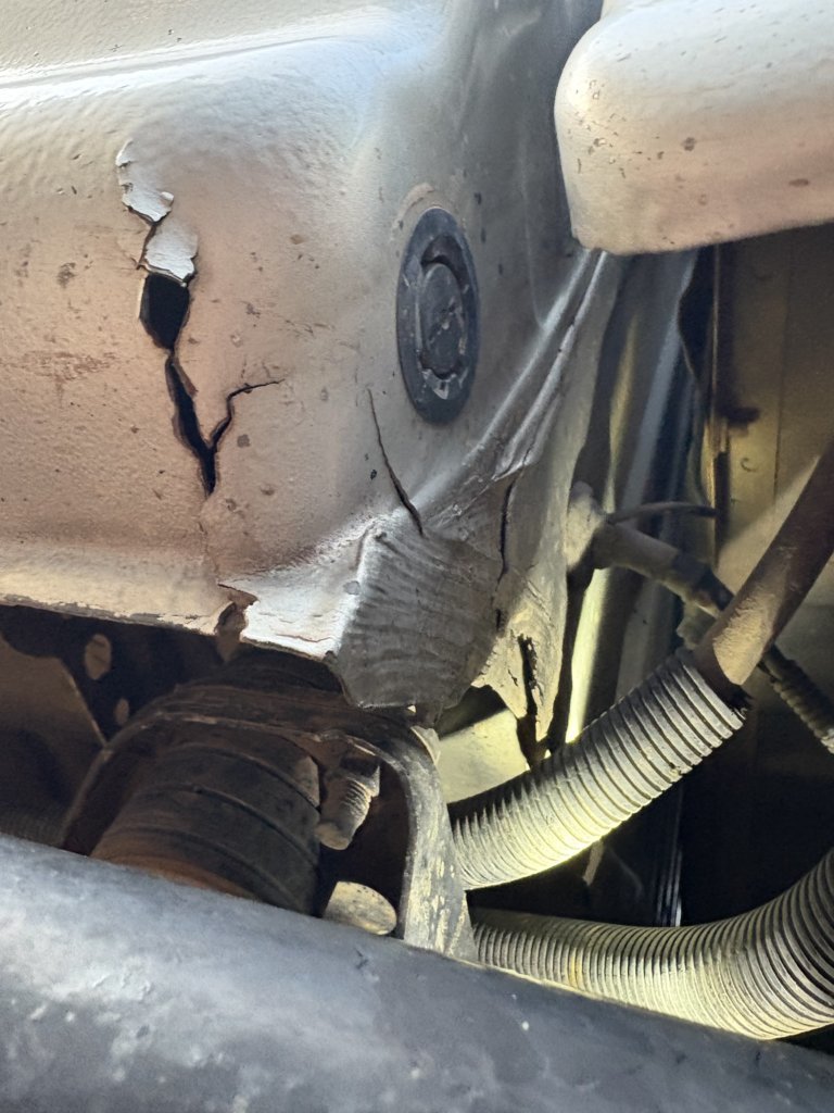

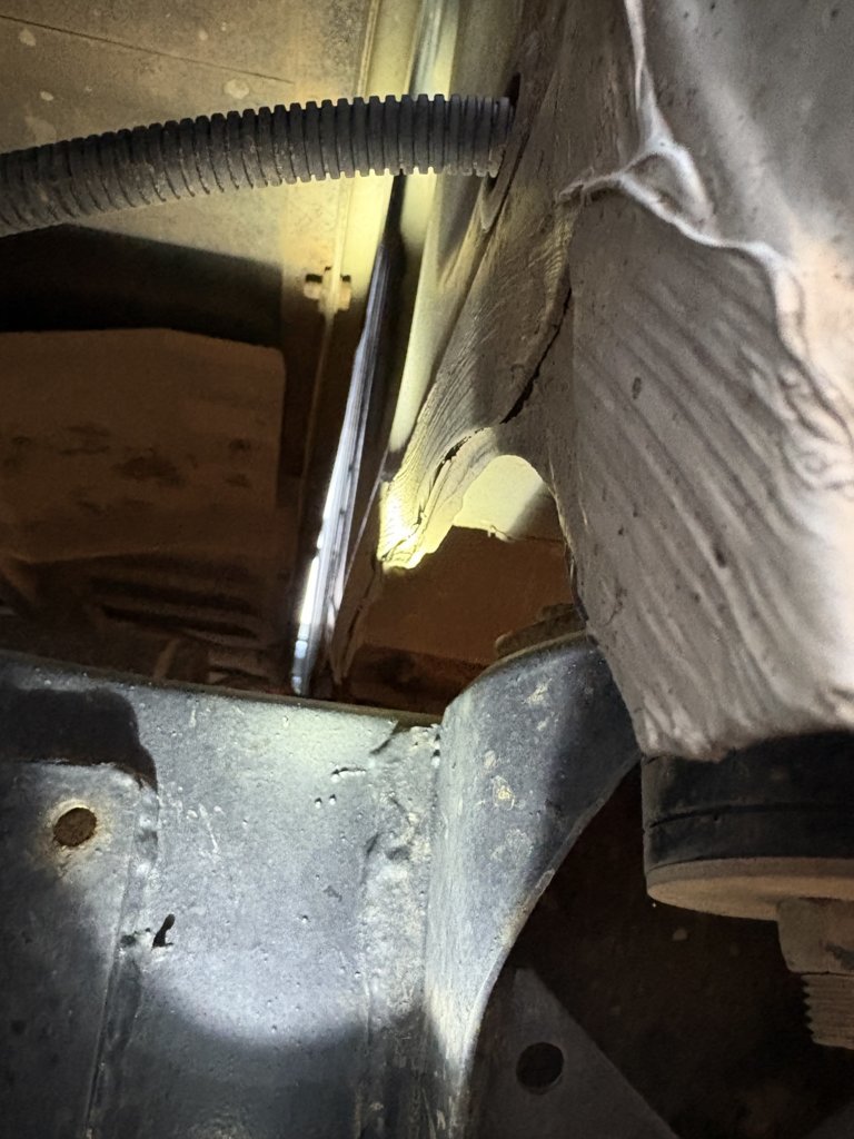

    What did you end up doing to fix this?
    Mine is separating on both sides, and cracks are propagating through the cab corners. Seems bad :notsure:

    Any noises associated with these? I'm hearing some new shit and hoping it isn't the cab falling apart.
    Now I'm afraid to do an inspection. :rofl:

    I think you already know the answer :oops:
    From what I can see, the back panel of the cab is held on mainly or entirely by seam sealer. Which sucks, but maybe means it’s not too hard to fix.

    Haha, yeah. I guess I should have been clearer. We saw those when we were doing the body mount replacement and I can hear creeks and squeaks from them when the cab weight shifts in sharp turns. But at that time I hadn't seen anything from the outside like you are seeing. And now I am kind of afraid to look again. Especially since I was hearing something new on this last outing.

    Yeah, lots of noises. They don’t seem especially worse than they used to be. Worth checking sooner rather than later though.
    Think I’m going to pull the gfc and bed off soon and look at remediation options.

    It's less Tacoma and more mod
    Lots and lots of 3M PanelBond, just don't forget what's in the gun before you go making a Seattle Dog

    I might try bolting through the bottom pinch weld, since the vibration is clearly causing the separation to start there.
    The cab corner is fucked though, I’ve already been thinking about redoing my sliders so I might just boatside this thing.

    It's going to break that flange off without some reinforcement, maybe weld a backer on or spot weld the panel. I'm not sure what the right answer is

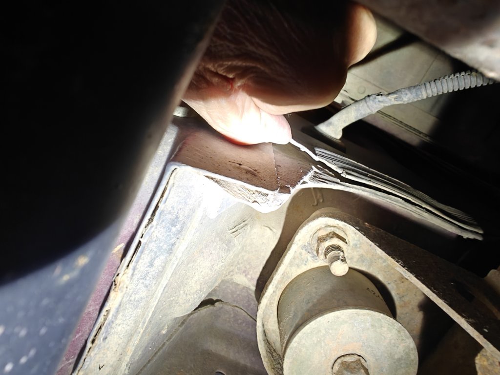

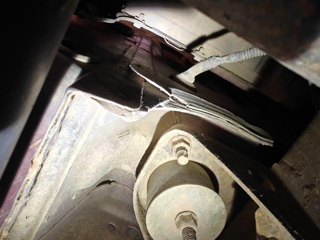

    Took a look. Mine looks more like @Burro than yours.
    My cab corner/bottom is still intact.

    I'm about to dive back into that project. My quick weld job to silence the noise before my 6,000 road trip isn't holding up. I'm the least worried about the seam. I have crack propagating in a number of areas in the floor.
