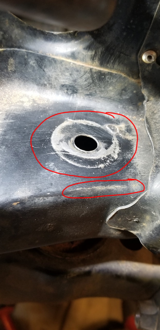

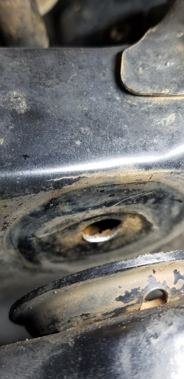

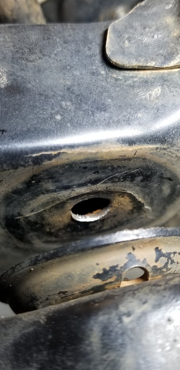

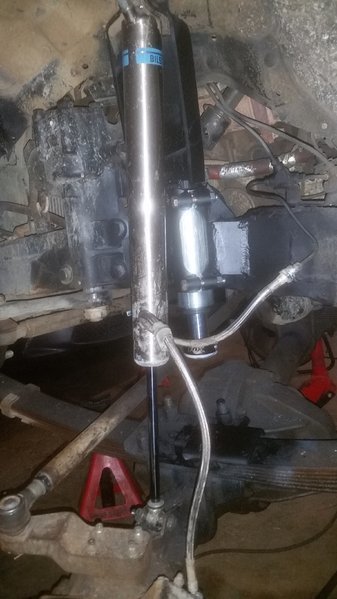

    Was tracking down a clicking noise and pinpointed it to my driver side core support body mount. Took it all apart and found a lot of cracks :anonymous:
    Good thing I caught it before it collapsed on itself. This core support is only about 6 months old too. Didn't last too long.
    I should prob slow down offroad....
    Now to figure out how the hell im gonna reinforce it.

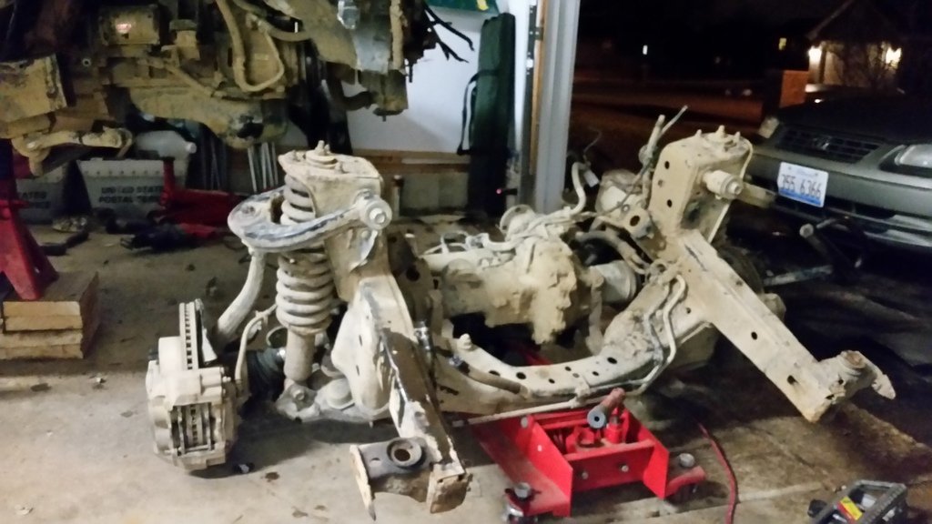

    This fixes alot of problems with cracking.
    20160228_1951431_zpsatokaytf_a21b3e9a450763c71d7d2fa6ce63c88138890586.jpg 20160505_210233_zpsmbusmx5i_d66f351788fc0d4b26939ad817e882cdfd8da1a3.jpg 20160403_165914_zpsbu3yqwzv_4ce0c6cb072d66442fff741c086e93aa0a7a3fcc.jpg

    Mine was starting to collapse there too, but not that bad. I assume you used an aftermarket core support when it was replaced?
    Maybe with leafs. I'm kinda thinking a linked SAS with good coilovers may be the best setup for going at least as fast as we already do, and not falling apart.

    yea it was an eBay special.
    Didn't think of getting an OEM one at the time. Even if you can which i'm not sure of.
    Did you do anything to reinforce it/prevent it from getting worse?
    I'm thinking of just plating that area and putting a tube through the bolt hole to brace both ends. Don't particularly remember, but the OEM core support might have a tube that goes through those two holes to do just that.

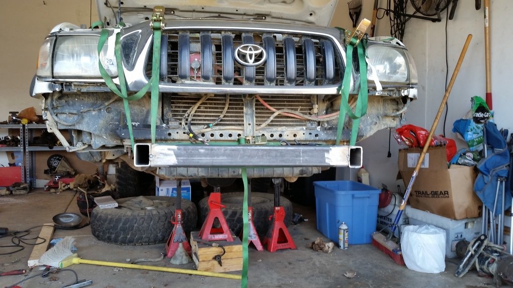

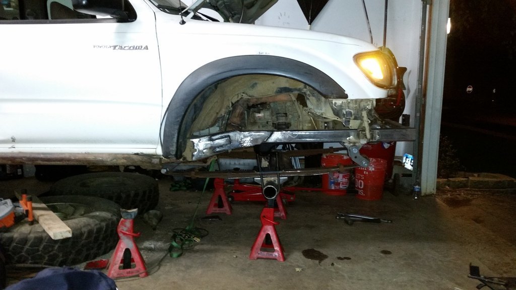

    My core support got the sawzall and angle grinder treatment and I fabbed a new one.
    The OEM core support did have quite a bit of structure on those body mount points though.
