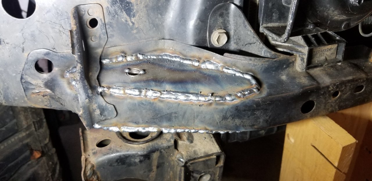

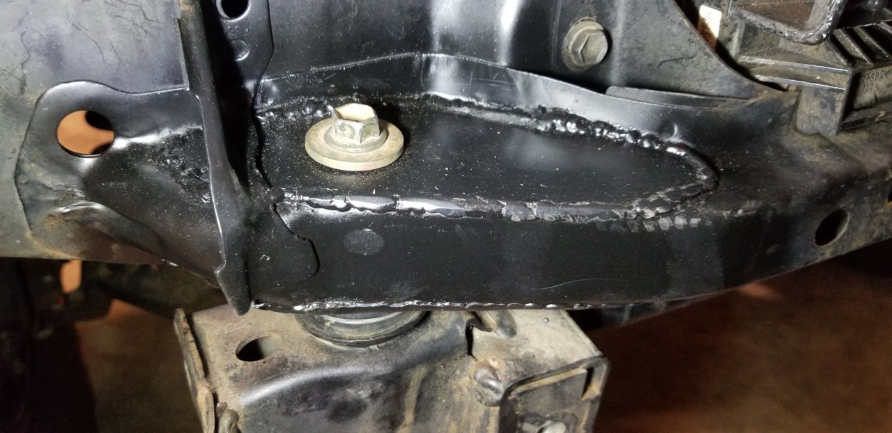

    Plated both sides of the core support body mounts today.
    If this fails again, i'm gonna chop off the whole lower section and put in some rectangular tubing. Pretty sick of dealing with this issue. Hopefully this holds up.
    18 gauge plates on both sides and sleeved between them where the bolt goes through.

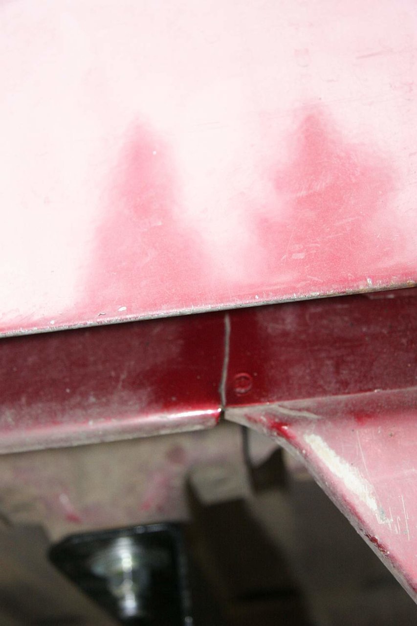

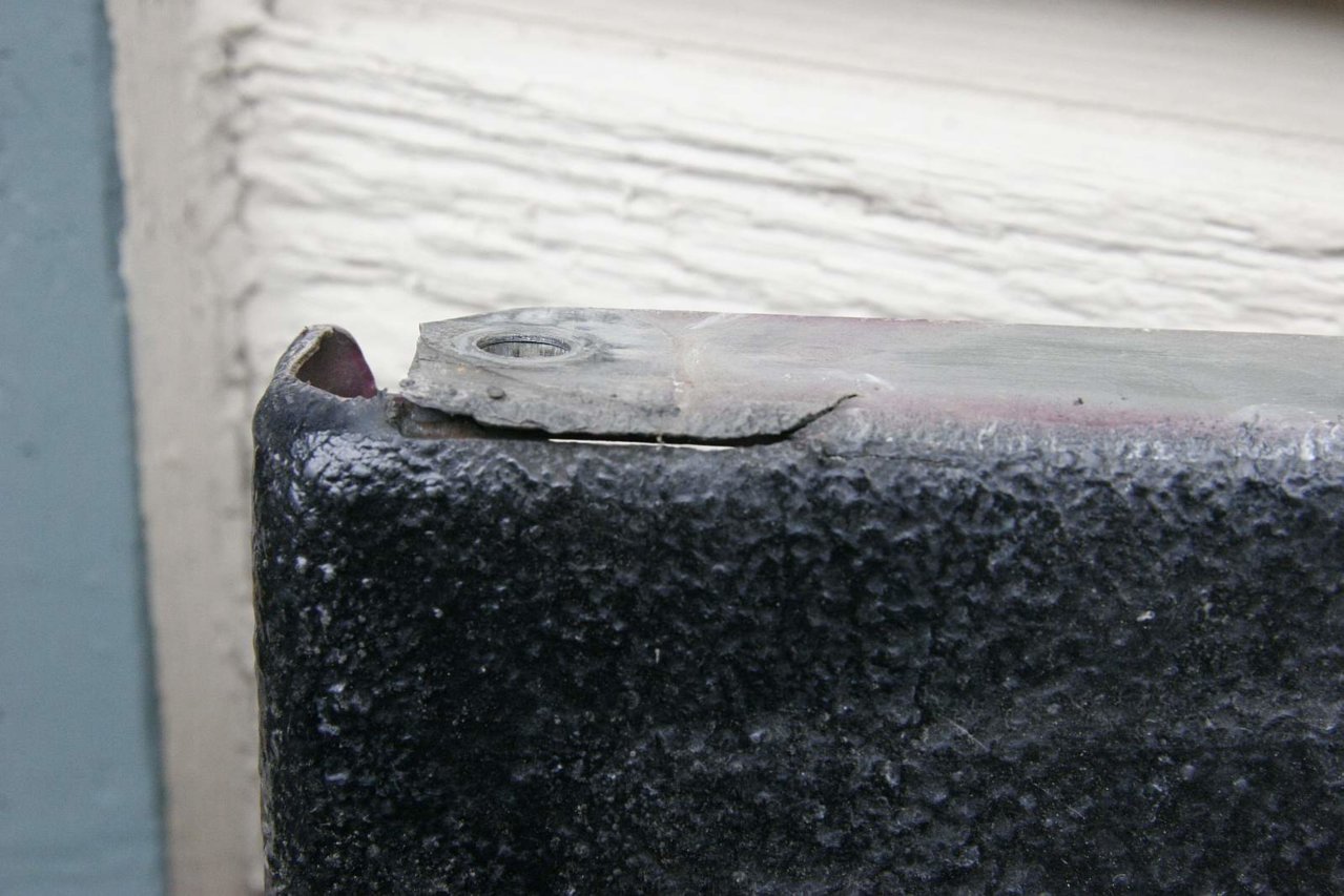

    Front corners of the bed. Should be an easy fix with some 1" flat stock and rivets for the upper rail to keep it relatively flat.

    #109
    drr
    drr Primary Prognosticator
    Oct 17, 2013
    #114681
    2,742
    Dan
    Seattle-ish
    02 4WD Tacoma
    We're attempting to reinforce this area on @Digiratus truck. Is that the front panel of the bed? Do you think the load from your canopy (if you still have it on) on the bed sides caused that tear?

  10. Mar 27, 2020 at 9:16 PM

    Will be watching what you come up with for bed mounts, Ryan. Mine is fubared. I can push up on the corner of the camper and get quite a bit of movement from this cracked mount.

  12. Mar 27, 2020 at 10:11 PM
    #112
    Reh5108
    Reh5108 Well-Known Member
    Feb 18, 2013
    #97832
    5,785
    Idaho
    2004 SR5 4X4 2.7L Extra Cab
    OME lift, 4x sliders, Demello rear bumper, custom front bumper, Engo 9000lb winch
    I'm sure that's the primary reason. There's 250# sitting on the rails swaying from side to side.
    Same issue you have. It's looking at it as if you were standing between the bed and the cab.
    Hopefully I can find the motivation to get back on that project tomorrow. My measurements were wrong on the 1st draft. Learning Fusion 360 as I go and keep finding better ways to draw. Hopefully I can make it so the drawing is easily adjusted to accommodate no body lift. I got a closer look today and it looks like Toyota does have those mounts reinforced so now I'm wondering if 10 guage will be enough...
    m3bassman[QUOTED] likes this.

    are you sure that's not from the frame flexing?

    That is probably a factor as well.

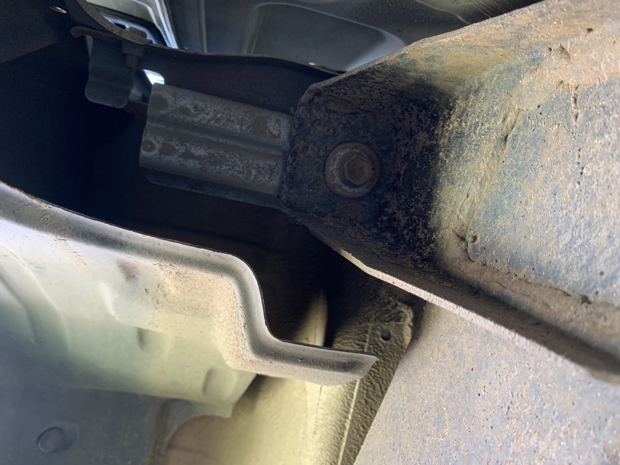

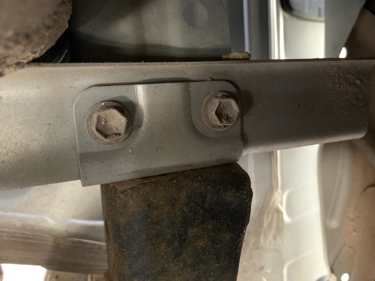

  15. Mar 28, 2020 at 8:41 AM
    #115
    JasonLee
    JasonLee Hello? I'm a truck.
    May 9, 2014
    #129454
    12,286
    Jason
    Q322+3C Denver, Colorado
    15 TRD OffRoad
    TRD Supercharger and more.

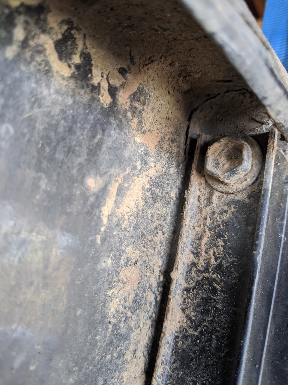

    I was just looking under my DCSB bed at this. It doesn't look deformed like @jubei 's first body life caused and it's not cracked like yours, but I feel that some of my flexing is from this thin stamped metal beam that mounts the bed to the frame. It's interesting that the short bed has an additional reinforcement at that mount around the thin stamp channel/beam. Also interesting with the short bed is because the wheel wells are all the way to the front of the bed, this beam is not supported on the ends by the actual tub of the bed.
    These photos are at the front of my bed on the passenger side. I'm realizing that maybe your photos are of the rear most mount.
  16. Mar 28, 2020 at 9:08 AM
    #116
    Squeaky Penguin
    Squeaky Penguin [OP] Nothing Ventured, Nothing Gained
    Apr 5, 2012
    #76340
    10,077
    Brett
    Steamboat Springs, Colorado
    '01 4WD, SR5, TRD & '13 TRDOR AC
    Lots of dust and custom dents, Check Build
    My picture was of the forward most mount. Obviously, they look way different than the double cab mounts.
  17. Mar 28, 2020 at 9:21 AM
    #117
    JasonLee
    May 9, 2014
    #129454
    12,286
    Jason
    15 TRD OffRoad
    I understand, just showing photos in case you see something that gives you ideas.
    The frames are pretty much the same though, right other than the body mounts?
    Most interesting that the short bed has an additional sandwich around the beam at the tower mount to the frame.

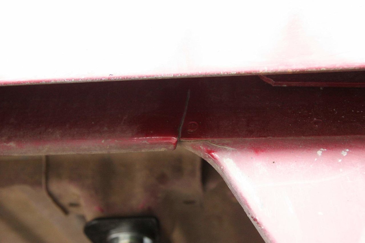

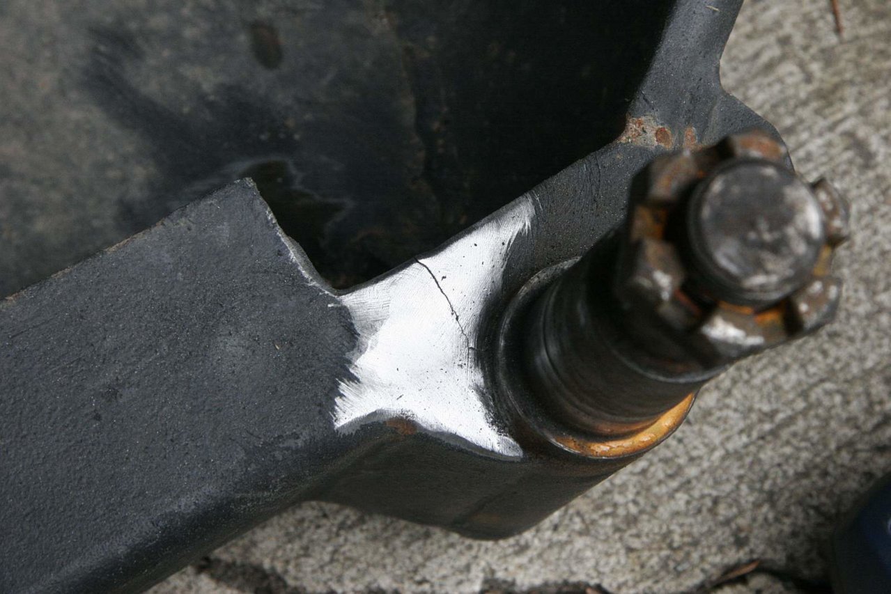

  18. Mar 28, 2020 at 8:56 PM
    #118
    Digiratus
    Digiratus Adventurer
    Mar 26, 2010
    #34006
    23,817
    Roaming the PNW
    The RedHead
    2002 XtraCab TRD 4x4 SCv6 AutoTrans With Lots of Mods ADS COs w/Compression Adjusters Camburg Uniball UCAs Whiteline Lower Control Arm Bushings Kartek 7" Limit Straps Plastics Guy Front Bumpstops Total Chaos Sprindle Gussets Custom Alcan Springs +800 lbs +3" ADS 10" Stroke Triple Bypass w/Resi Rear Shocks Custom Rear Shock Relocate All-Pro U-bolt Flip w/Timbren Bumpstops 4.88 Nitro Gears ARB Front Locker ARB Twin Compressor Black 17x8 Konig Countersteer Type X 285/70r17 Falken A/T3w Gunmetal 16x8 SCS Ray10s 255/85r16 Maxxis Bighorns Limited Edition (Relentless) Elite Front Bumper Smittybilt X2O 10K Winch Diode Dynamics SS3 Sport Selective Yellow Fog Lights in the Bumper Diode Dynamics SS3 Pro 4,000 Kelvin SAE Driving Lights with Clear Lenses on the Bumper Morimoto D2S Projectors XB35 Ballasts + 4300K Bulbs Badland Sliders FrankenFab Tire Carrier Swingout bumper w/kitchen BudBuilt Front & Bellypan Skids BAMF Rear Diff Skid Dometic CFX 55im Fridge/Freezer Alpha II Hardshell RTT Badland Custom Bed Rack Denso 210-0461 105 amp alternator Dual Northstar 24F AGM batteries BlueSea 7622 ML-ACR Battery controller Peak DBI Dual Battery Voltage Monitor Haltech IC-7 Display with Mako Dash Insert Haltech Elite 2500 Standalone ECU Magnuson MP62 Supercharger w/URD 2.2" Pulley Doug Thorley Headers Denso 650cc Fuel Injectors Aeromotive Stealth 340 Fuel Pump TransGo A340F Reprogramming Shift Kit OEM ECU Delete Full A340F Trans Control with the Haltech 2500 ECU 2.5" Magnaflow Hi-Flow CAT Magnaflow 18" Muffler w/Vibrant Resonator 13WL Brake Calipers with OEM Rotors & Pads Braided Steel Brake Lines Kenwood TM-71A Dual Band Ham Radio STI-CO Flex Whip VFH/UHF 1/4 Wave Antenna Midland MTX275 GMRS Radio w/Roof Mount Antenna Pioneer DEH-P9400BH HU Alpine Amps & Type R components (F) and coaxials (R) Wet Okole Seat Covers Weathertech Digital Liners Deck Plate Mod 1" Diff Drop Carrier Bearing Drop

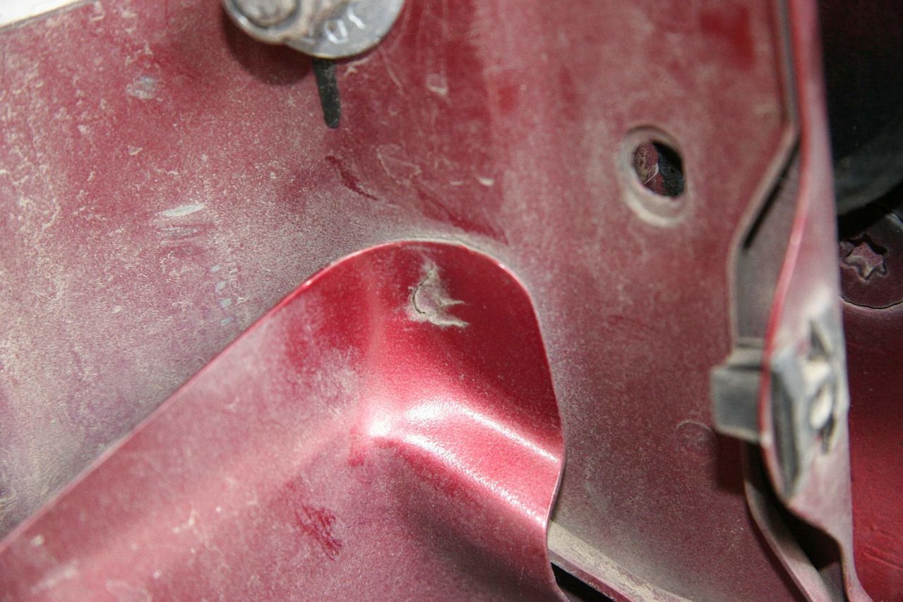

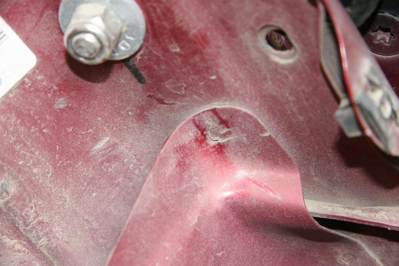

    Found these today. Broken spot welds inside the area behind both of the tail lights.
    This is on the bed structure below the tailgate on the passenger side.
    And this on the front bed panel on the passenger side.
    And then there is the bumper. While not OEM, it is there nonetheless.

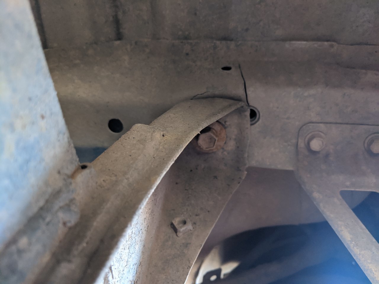

  19. Apr 30, 2020 at 12:03 AM
    #119
    Rockymtntacoma
    Rockymtntacoma Well-Known Member
    Apr 29, 2016
    #185663
    157
    Jake
    SLc,UT
    03 ext cab 4x4 v6 5 speed sr5
    Dual cases, triple sticks, 4.88’s, Harrop e-locked f/r, 35’s, boosted
    This thread motivated me to look further into my cracked coil bucket, and I’m sure glad I came across it when I did!
    Not sure it would have survived more than a few trips 37FA8945-0101-45C8-A9E0-391C697862AE.jpg 952403B1-F741-498A-9945-F6CEC9284286.jpgI ended up cutting and brake forming a piece of 3/16 to cap it off with legs running down the sides of the bucket, plug welded top and sides64F138A7-C51B-4F5F-92A7-4CE0EE02D17E.jpg

  20. Apr 30, 2020 at 6:46 AM
    #120
    Reh5108
    Feb 18, 2013
    #97832
    5,785
    Idaho
    I'm hesitant to go to performance coilovers in the front because of all of this cracking nonsense. Idk how mine haven't yet being that I beat the hell out of them on OME. Could be the relatively new frame doesn't have enough fatigue cycles on it yet.
