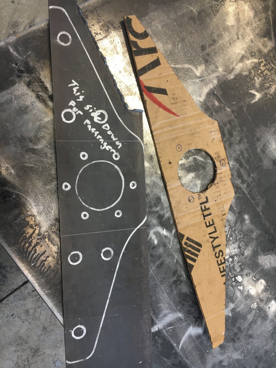

    Those were a failure waiting to collapse completely. Probably on the next outing.
    A very nice solution. The best I've seen yet. Curious how you determined fit for the wrap piece. Does it wrap over and down the engine side from the top?

    I didn’t really take any measurements other than the inside width needing to be 5 1/8”, I just pulled the coilover, made a cardboard template and traced out the holes from the bottom side. I didn’t get any pics before I installed, but I’ll post some some up when I get around to finishing up the other sideAD0C7948-8BC5-42A2-9ABE-AB7114507FDA.jpg

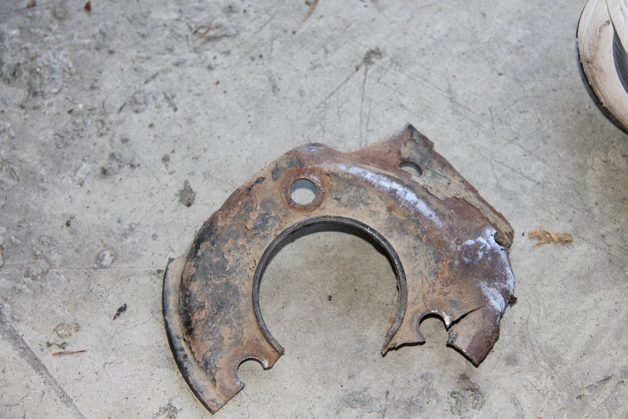

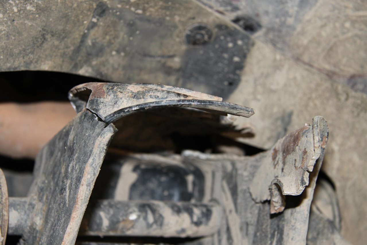

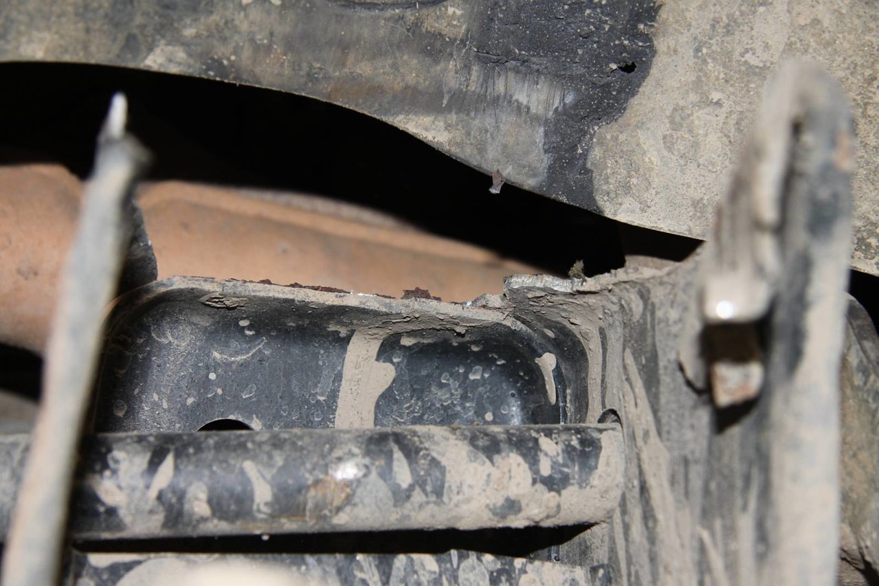

    You didn't say it but I just went back and looked at your first post again, this was the passenger side bucket that failed correct? Looks like it, based on the position of the schrader valve on the CO.
    I presume you have you taken a very close look at your driver side coil bucket and found no evidence of a similar failure.
    This is a pic of my passenger side coil bucket after my extended length King CO with 700 lbs coils pushed through it last fall.

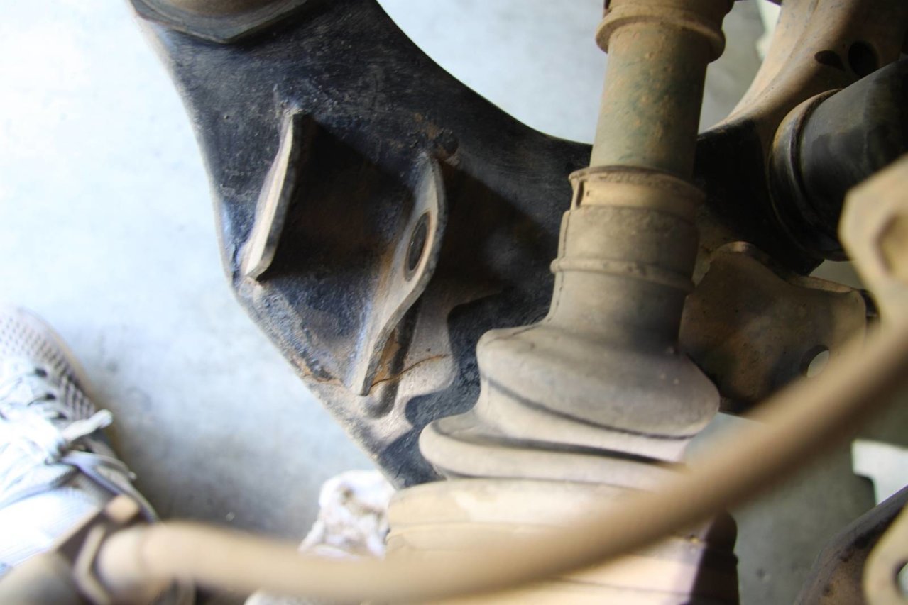

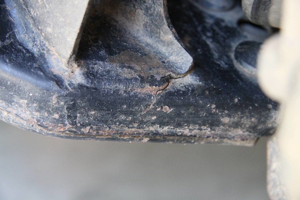

    I am curious if you taken a close look at the LCA, where the shock tabs are welded to the LCA? A few of us have found cracks forming there. I believe the root cause is the same for both failures.

    The 700lb coils strike again. High speed dirt miles, and I'm guessing no limit straps up front?
