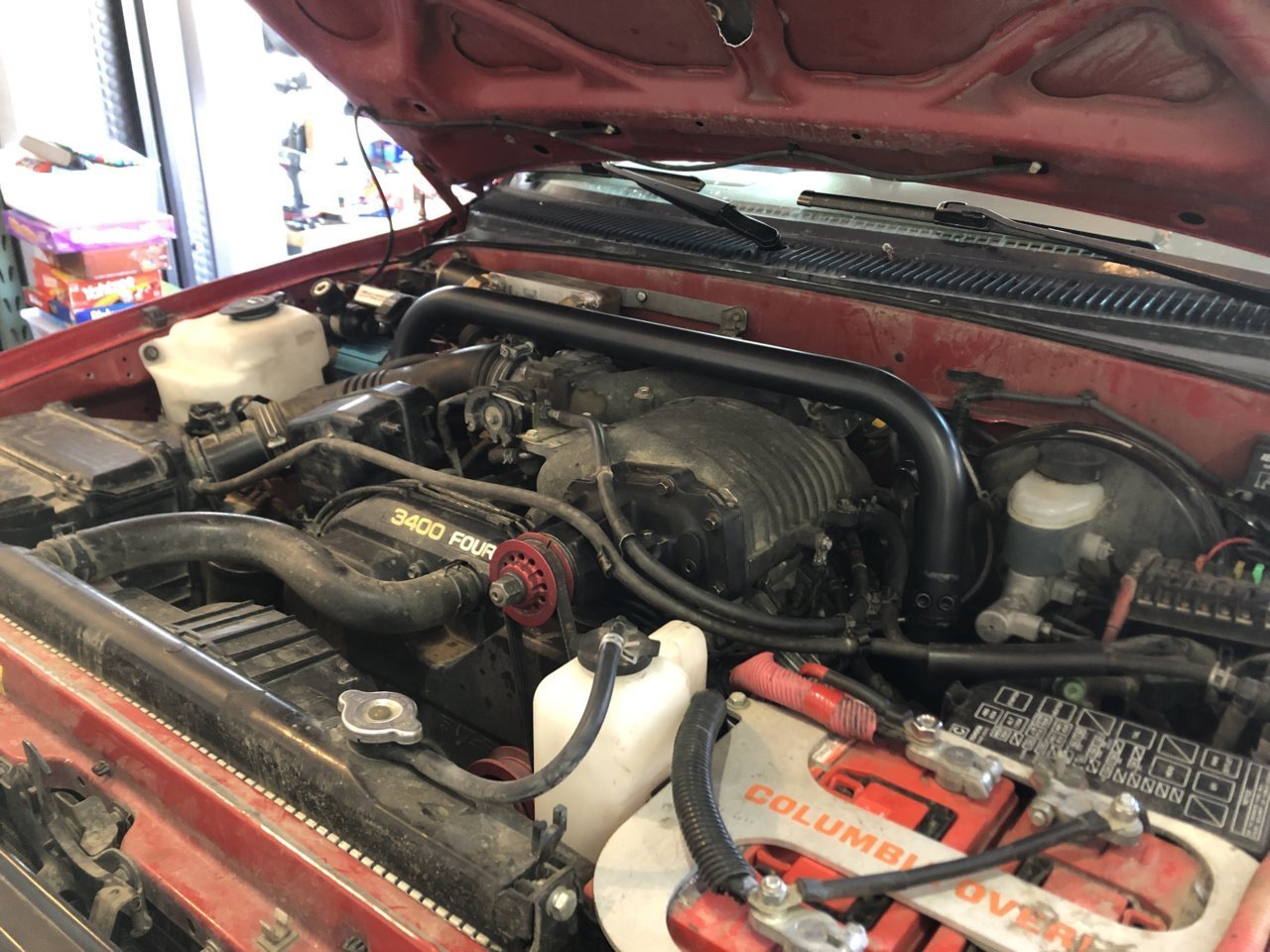

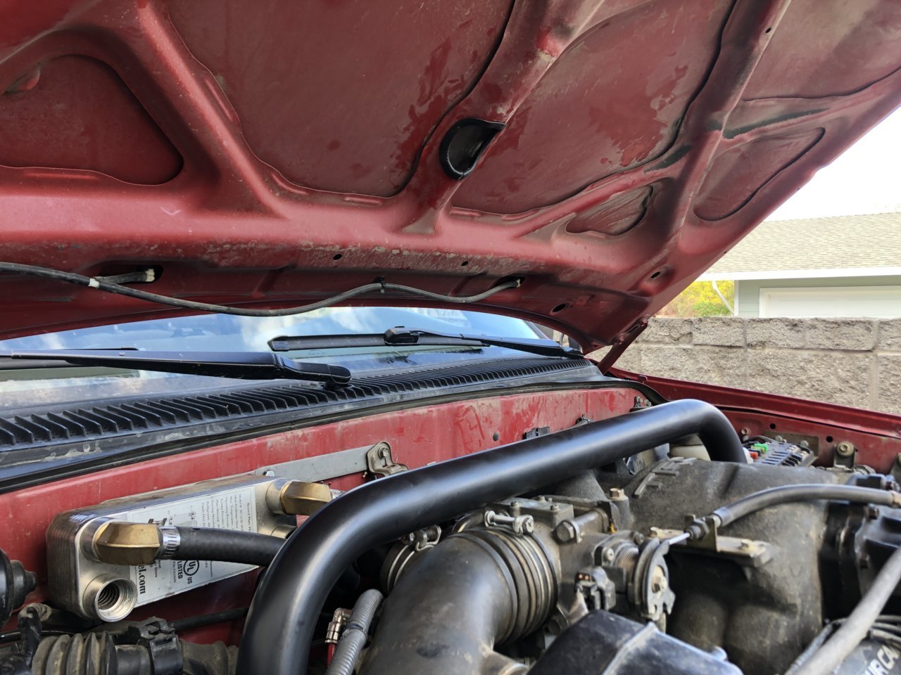

    @cynicalrider here's the one I built.
    I also thought about building a support tube coming off of the frame similar to the TC shock hoop like you mentioned. That or doing a full U shaped tube that wraps entirely over the coil bucket and ties into the frame on each side of it.
