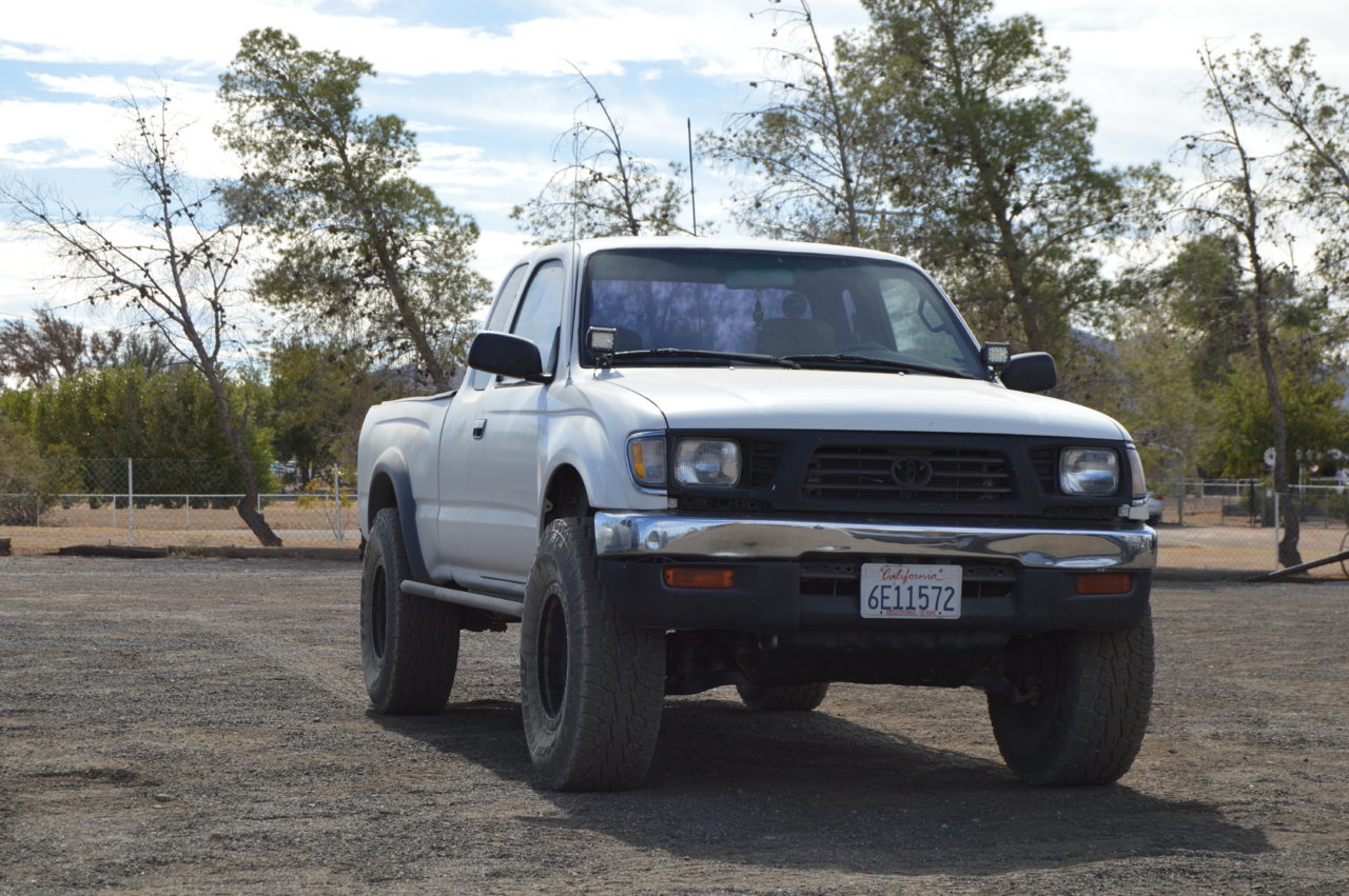

    im on 285s rn with 4:10s and I definitely feel the sluggish. Most hills I’m downshifting I notice the ect power button does help. Plan on armor and 35s so I’m going 4:88s if anyone has experience please let me know

    70 in 3rd?! Holy rippums batman, that's high in the band!
    35s and 4.88, I run cruise at what my speedo says is 60-65 (who knows my actual warp speed don't care) and in 5th. But not up a hill or mountain for sure.
