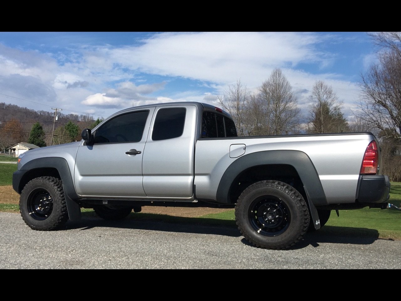

    I’m really liking my 32” 255/75/R17s on my 2015 MT, C-Load
    Just stinks I can’t hit 18MPG though, the slight mountains here in WNC mean you have to drive it a bit harder and shift more. I need to experiment with non-ethanol high test and non-ethanol 87. Both are available locally. I know the 2000 Land Cruiser loves the E-Free 93 at the QP. I get almost 14+ MPG lol...
    It’s worth it to me as the wife (not even close to being a car person) loves the way it looks now! Hahaha

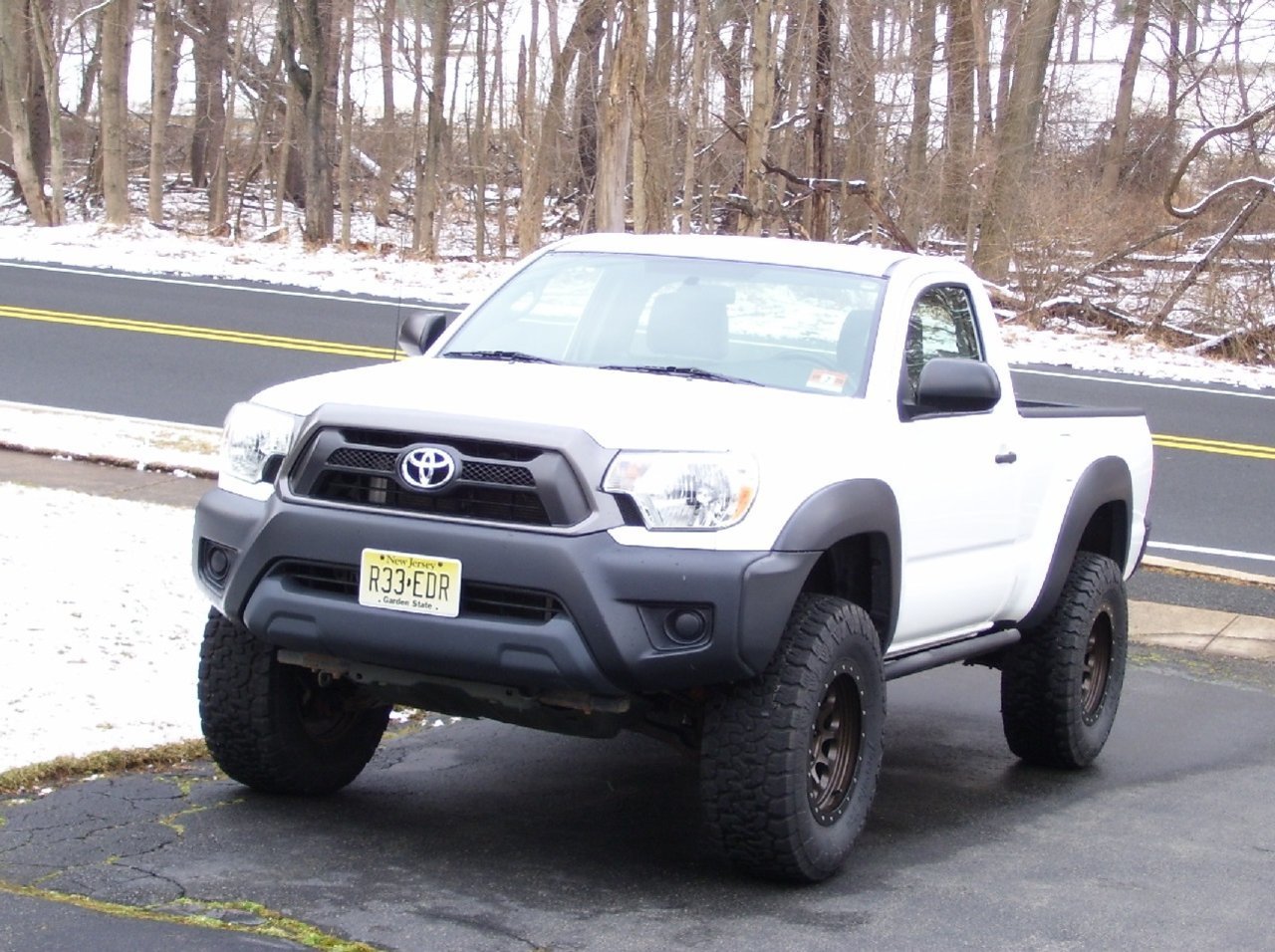

    I went from 285's to 305's and didn't notice any difference. I think the 33" height is what makes it chug along. Obviously, the heavier tires will hurt but I'm actually getting the same mpg or even a little better.

    I always like the way your truck looked with those tires. Maybe the next set will be the size your running. Always liked the stance. Just gotta prepare with control arms and doing a CMC before a new set I'd imagine.

    My truck has the SPC UCA's so I have them set at position C to push the wheel forward and I still get a little rub on the cab mount at full lock. I think I could grind a little of the mount and it would probably be almost no rub but it's not a big enough issue to worry about it.

    @whatstcp I really like what you did there. 2G, regular cab, the plastic fender trim is gone. I still have my old 2G, never traded it in when I got a 3G. I'm inspired.
