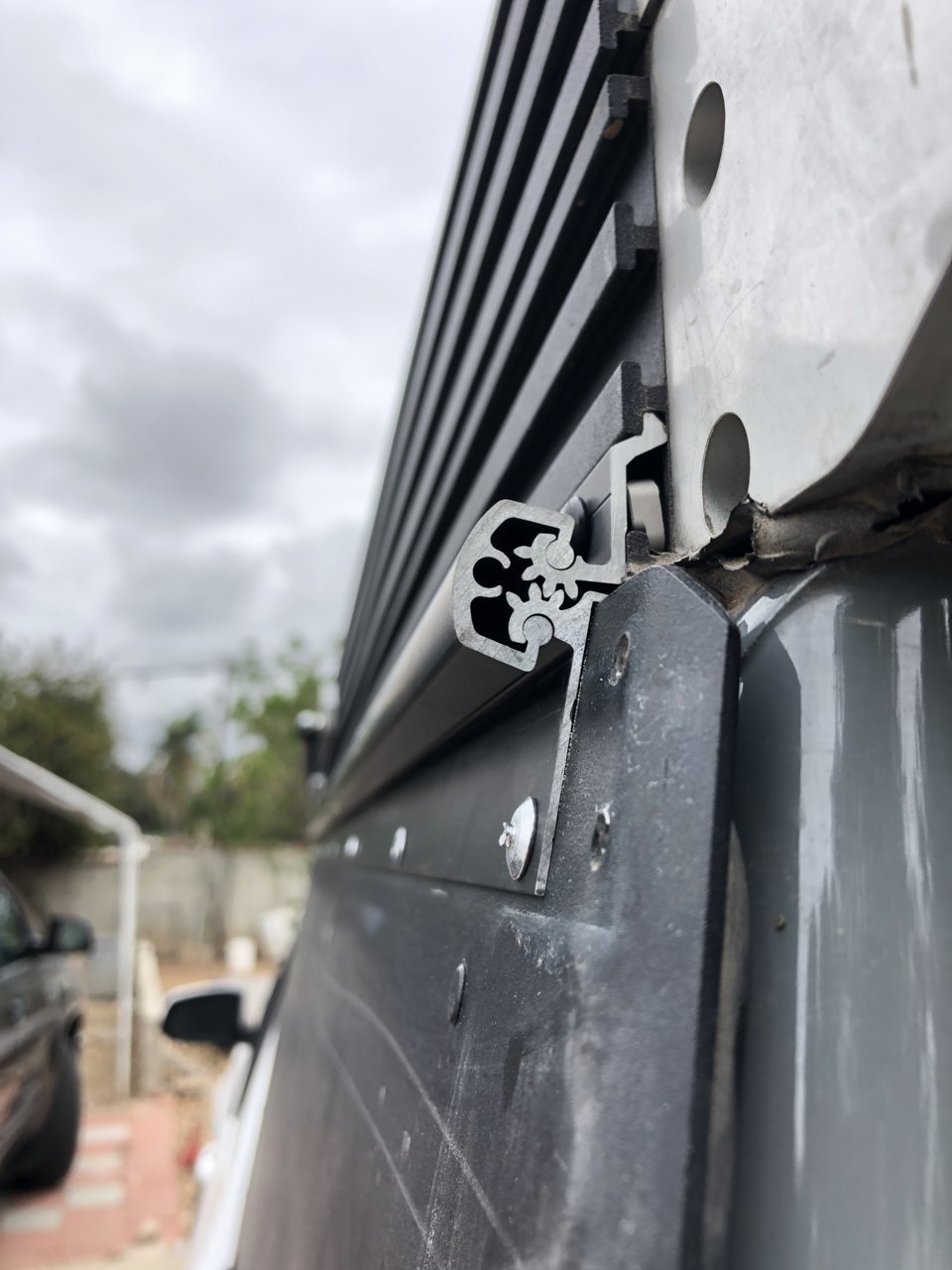

    How well did the living hinges hold up?
    And did you use anything for condensation for under the mattress?

    fyi - gfc has gone away from its living hinges as it appears the manufacturing process can cause imperfections - at least in the ones they used - resulting in catastrophic failures. not saying this will happen in every case - gfc had some pretty random failures - they moved to an aluminium “embassy hinge”
