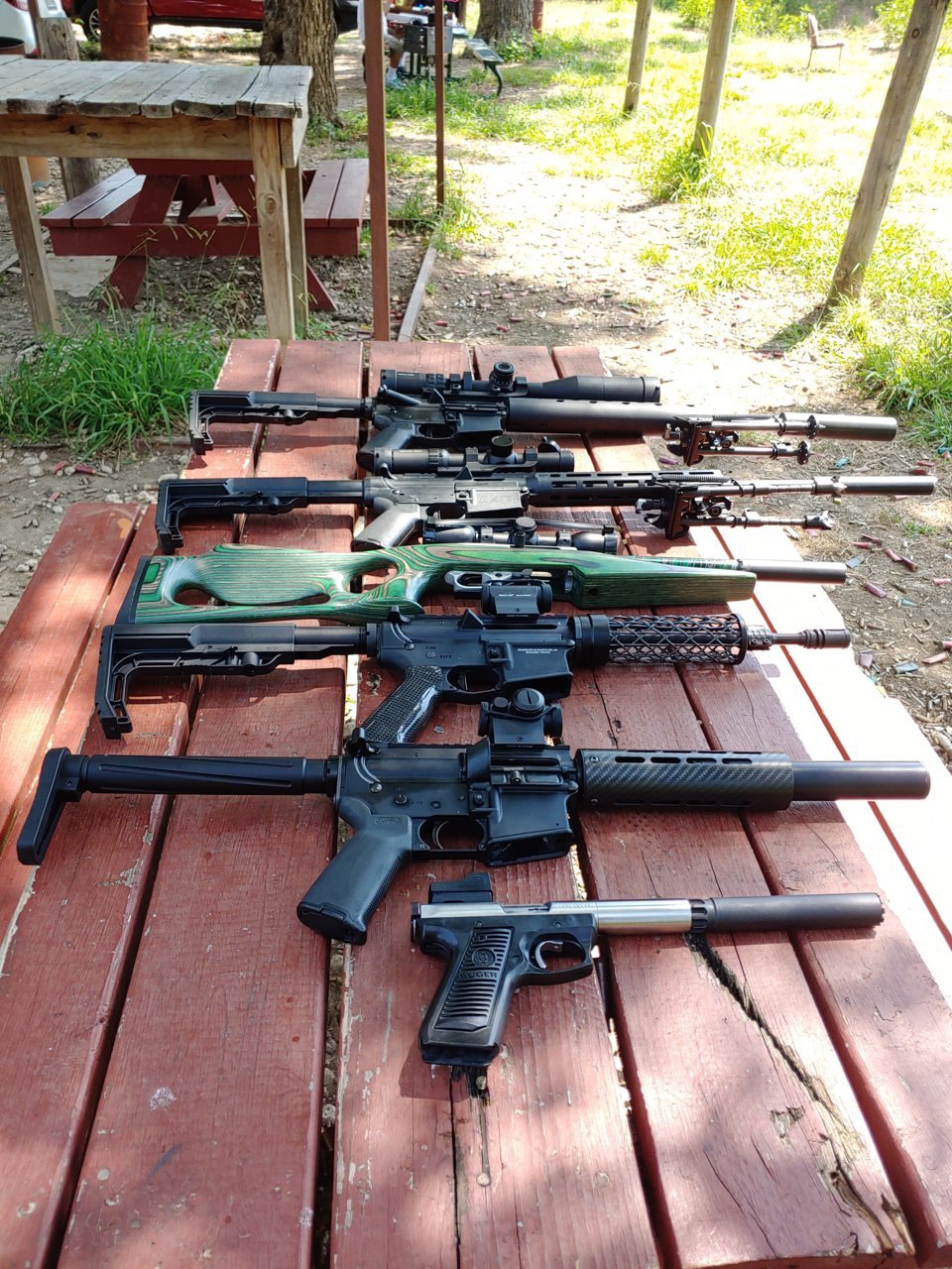

    5 silencers and 3 SBR's. I have a Maxim 9 in ATF jail, and an approved form 1 for an SBS waiting to be built.

    That’s awesome! I wouldn’t mind shooting those.
    I really want to shoot a maxim 9, it’s a cool and unique design.

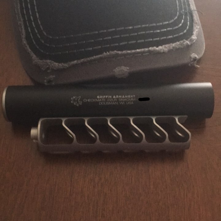

    2 years ago today this beauty was approved! my first foray into the suppressor world.

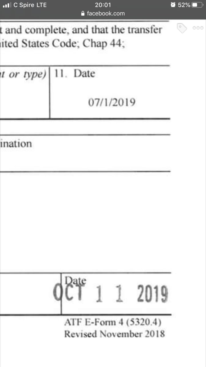

    Now is the time to submit your form 4’s people!!!!!

    WHAT? Is this on a trust???
