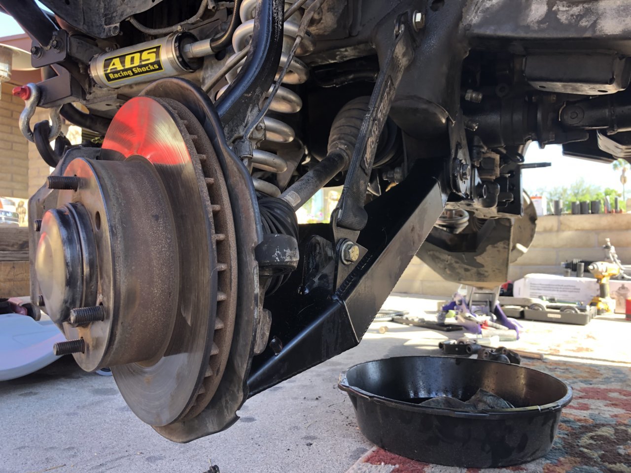

    4/4/2020
    Started major steering overhaul today. Mostly just took stuff apart and cleaned it today.

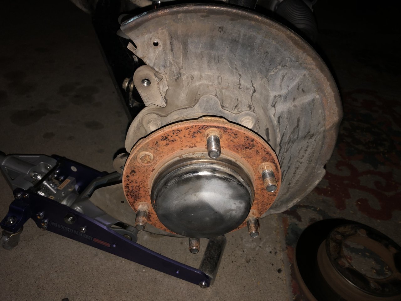

    Looks like you're missing a wheel stud there :anonymous:

    Nope. 5 lug conversion thanks to PepBoys.

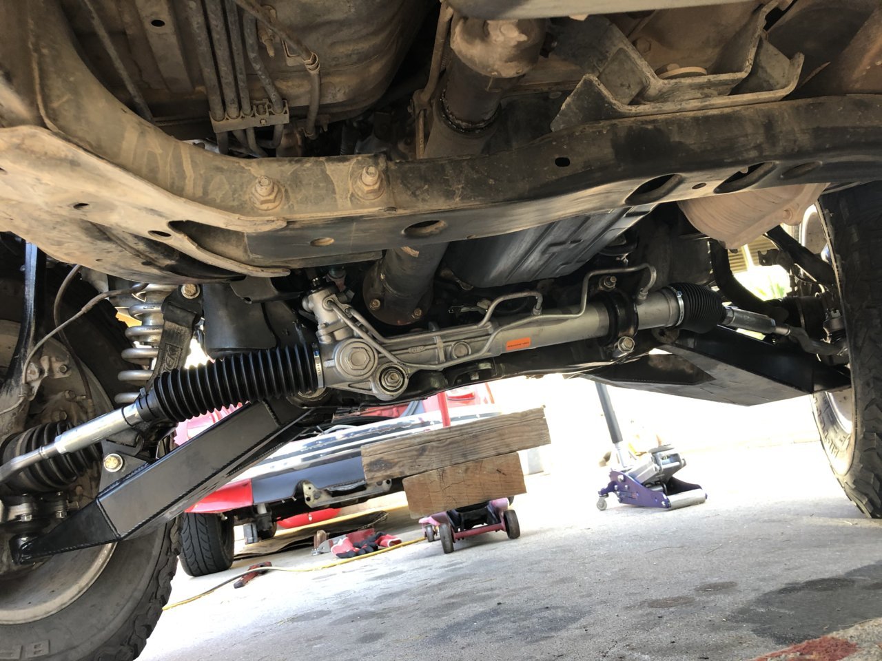

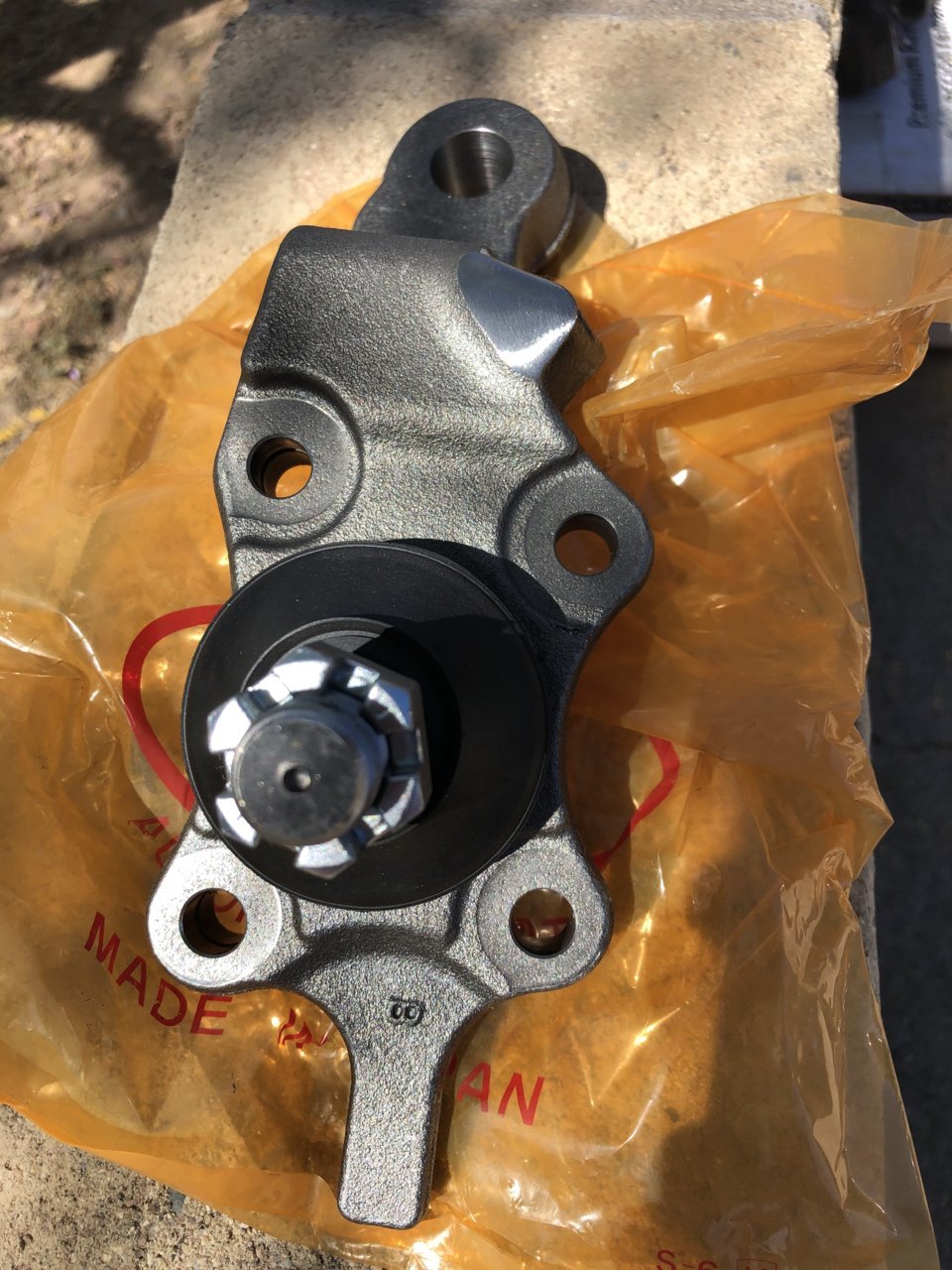

    Got all new steering parts in and alignment is done.
    New Inner and Outer Tie Rod Ends
    New/Modified 555 Lower Ball Joints
    Remanufactured Steering Rack from Low Rang Off-road
    Flushed and Refilled the Power Steering System with Royal Purple PS Fluid

    New rack looks good! I have the same 555 LBJ's and they've help up pretty well for me so far.

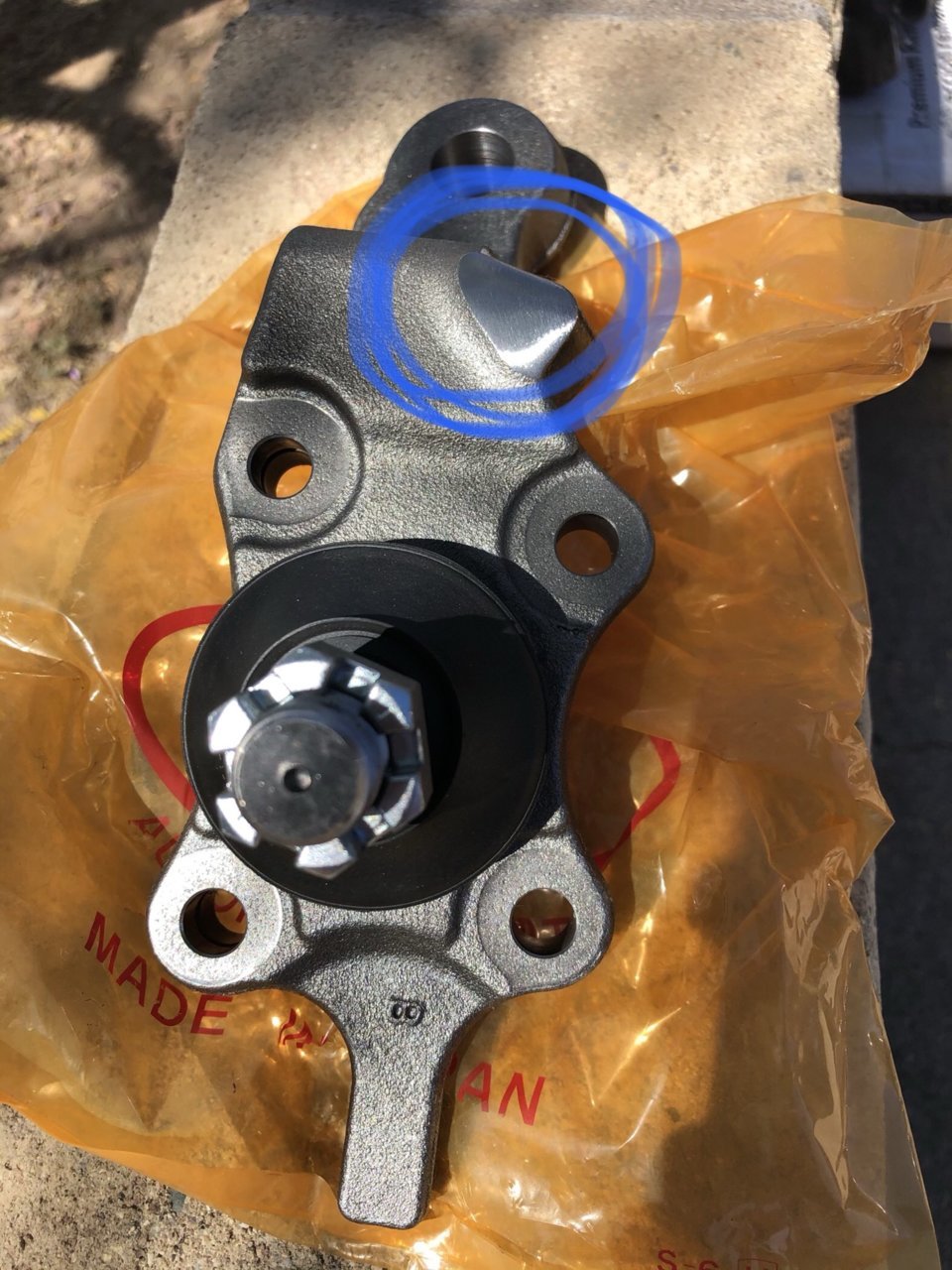

    What was motified on the 555's??

    The steering stop “horn” has to be ground/cut off to work with the MCM Fab kit. The part in the blue circle.

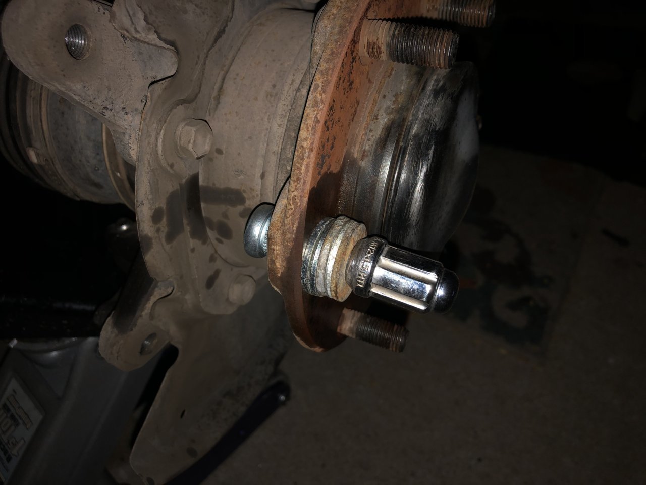

    4/7/2020
    So some months ago I took my truck to PepBoys for an oil change. They F-ed it all up and in the process of finding all of their mistakes I busted a wheel stud. I’m embarrassed to say that it’s taken me this long to fix it. Especially considering the fact that the entire repair took me less than a half hour. Regardless it’s fixed now. Thnx for the helpful reminder @betterbuckleup
    I used a stack of grade 8 washers to pull the new stud into the flange

    How did you push out the old one?

    A BFG usually does the trick for pounding them out

    I got a really cheap set of punches from Harbor Freight. Between those and a mini sledge, the busted stud popped right out.

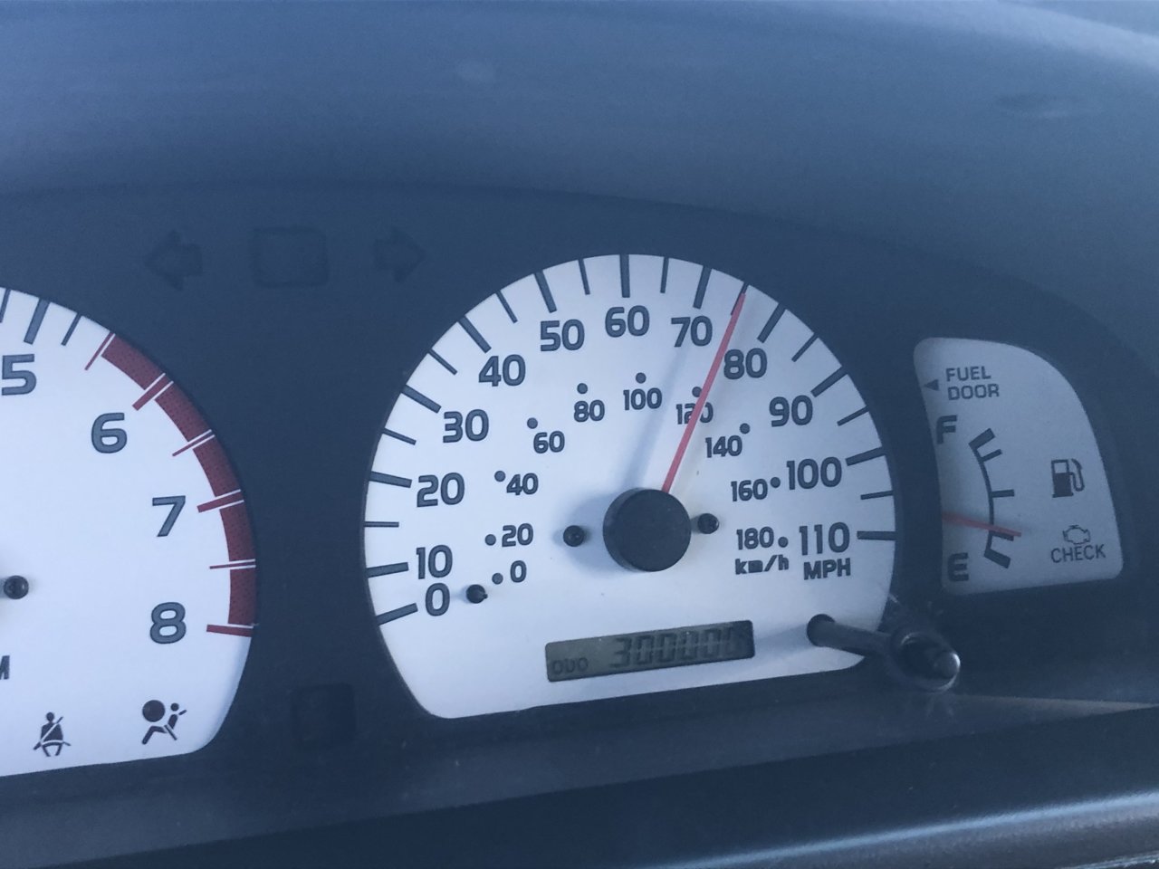

    June 10th 2020
    My truck joined the 300K Club
    So I got a commemorative patch cause why not?!
