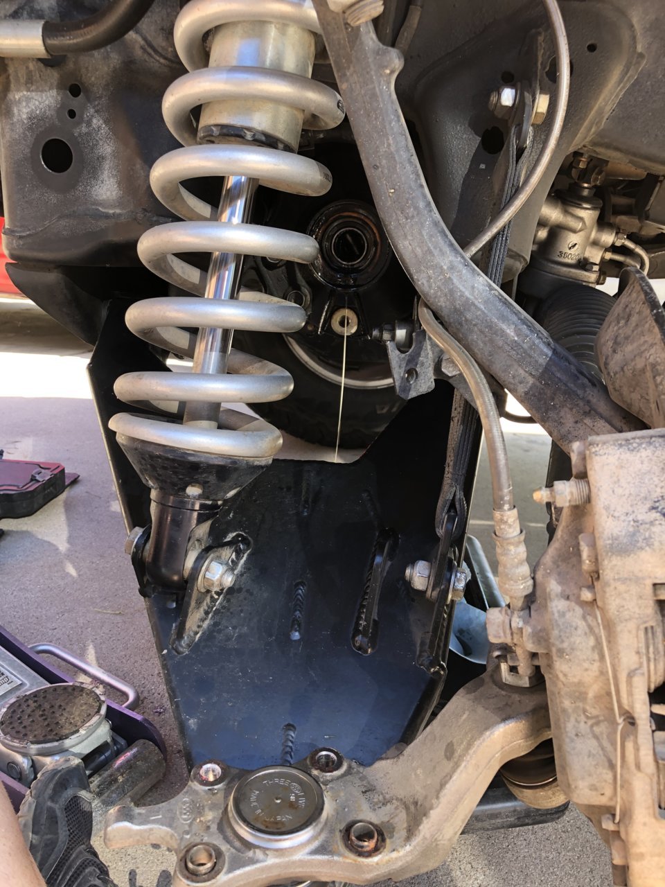

    Had to replace the driver side axle seal

    How have your 555 LBJ's not rusted yet :anonymous:

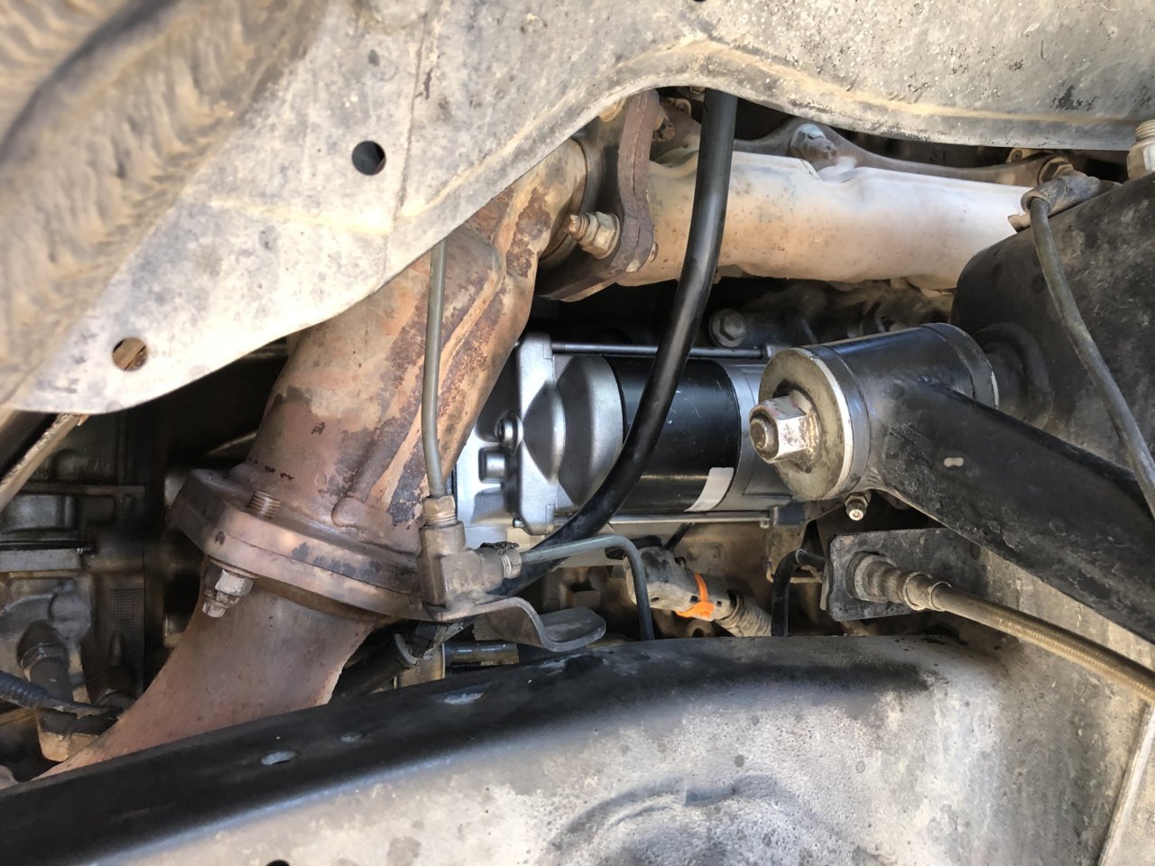

    My starter pooped out so I got a new one. Before I had a chance to swap in the new one, the original started to work just fine. So I procrastinated until this weekend since I’m sure my luck would run out soon.
    This job is a PITA, I ended up taking it out from between the steering rack and oil pan and stuffed the new one in the same way.

    Well they are pretty new and well you know we get almost ZERO precipitation here in SoAz

    Ah yea good point. That'll do it.
    Didn't take long for mine to start.

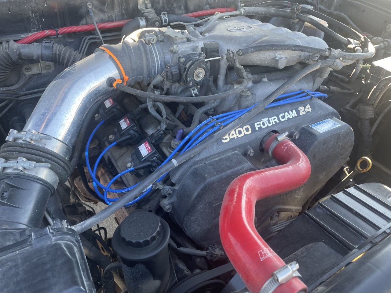

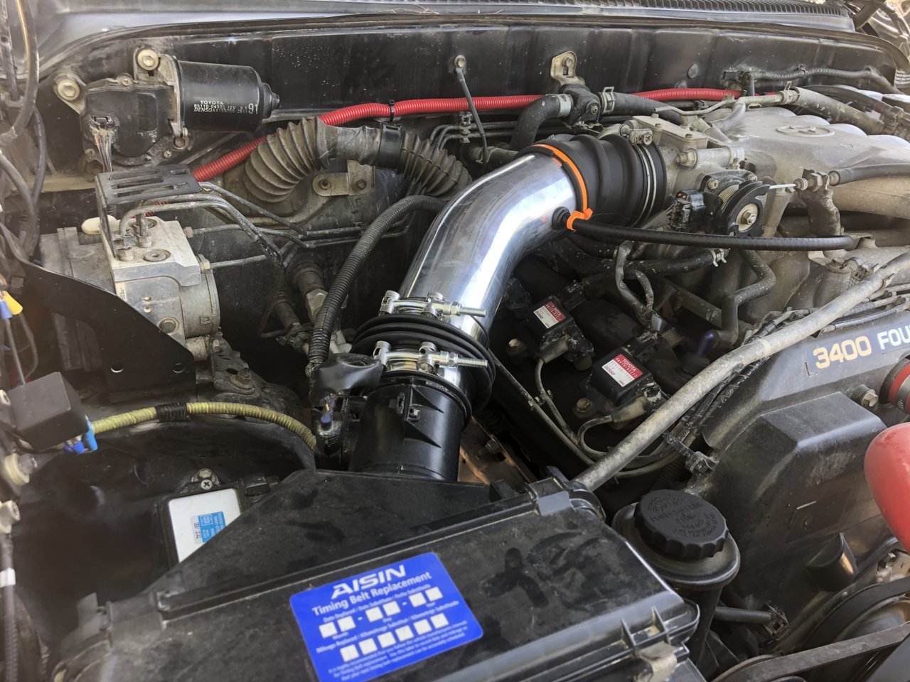

    I finally got around to installing and correcting the issues with my intake. The factory tube had a crack in it and I figured it was only a matter of time before I got a CEL for something intake related.
    I copied the install and parts from @mechanicjon
    Went pretty good except that I am short a few clamps so I’ll make the zip ties work for now.

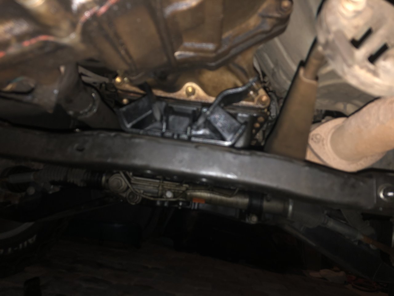

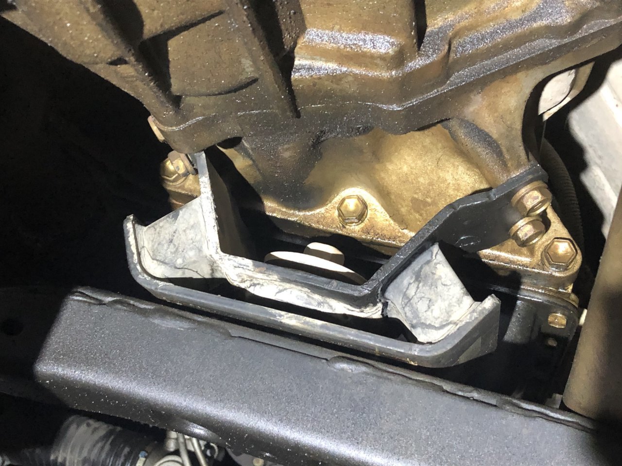

    Im embarrassed to say that I’ve had this transmission mount for the better part of a year and hadn’t gotten around to installing it. Took all of a half hour even with working around the driveshaft to get to two of the bolts. I got creative with two extensions and a swivel to make life a little easier. What a night and day difference it made, no more shifter slapping around in the cab.
    The 1st pic is the old one and with the trans jacked up you can see the separation on the passenger side of the mount.
    Captain Magma, chrslefty and Phessor like this.

    Yeah I used the OEM replacement. Went in really easy. Used a floor jack, block of wood and a few different wrenches. I still need to do my motor mounts as well. I got the bomb proof ones from the guy on here but have been lazy about swapping those in too.
