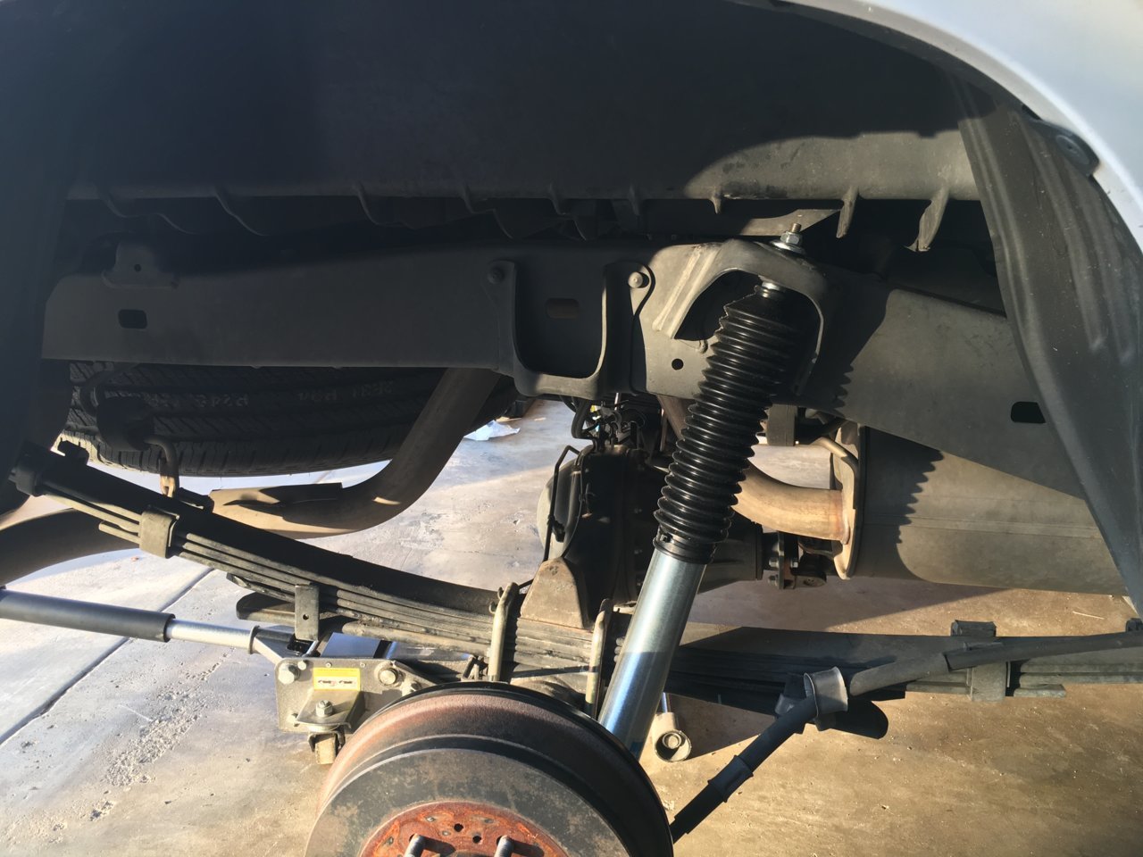

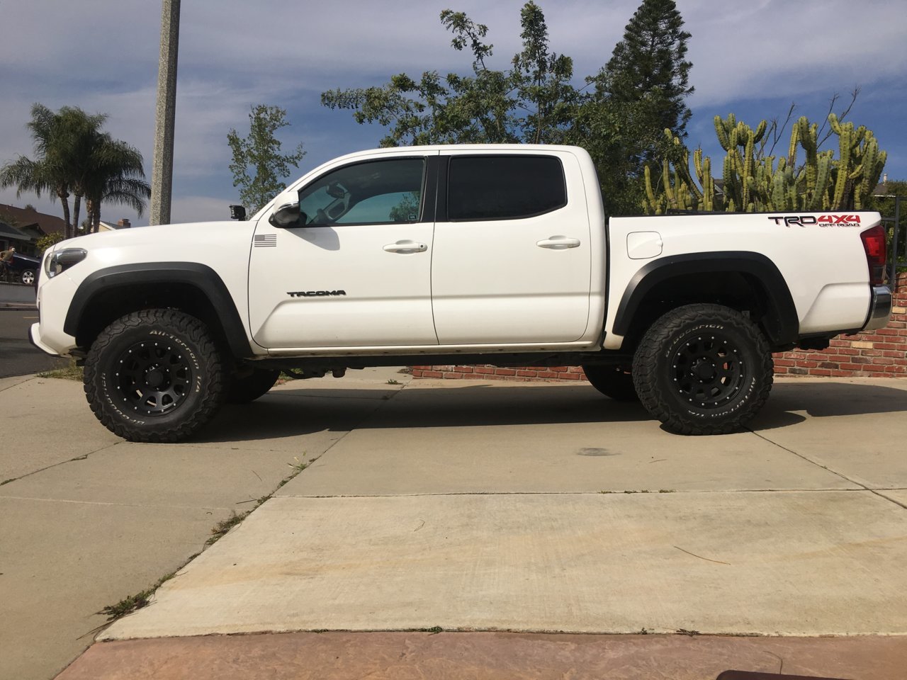

    @Noey: Was fun meeting Noey today and dialing in his rig, All parts are from @HeadStrong Off-Road. Assembled the 5100's at the home base with the trusty strut compressor. Ps: remind me to send you the seeds for that big ole tree :rofl::thumbsup:
    • Bilstein 5100's F/R @ setting 0
    • Ome 887x Coils
    • Deaver Single AAL (Badass AAL no cutting needed)

    Thanks a lot man!
    I'm sorry I was of no use! I got home and went straight to sleep... I didn't know I could get so tired doing almost nothing :anonymous:
    I will say I definitely noticed the ride quality on the way home. (Something I didn't think I would notice)
    Overall couldn't be happier with your work
    I'll send updated pics this week if I can finally choose a wheel/tire combo!

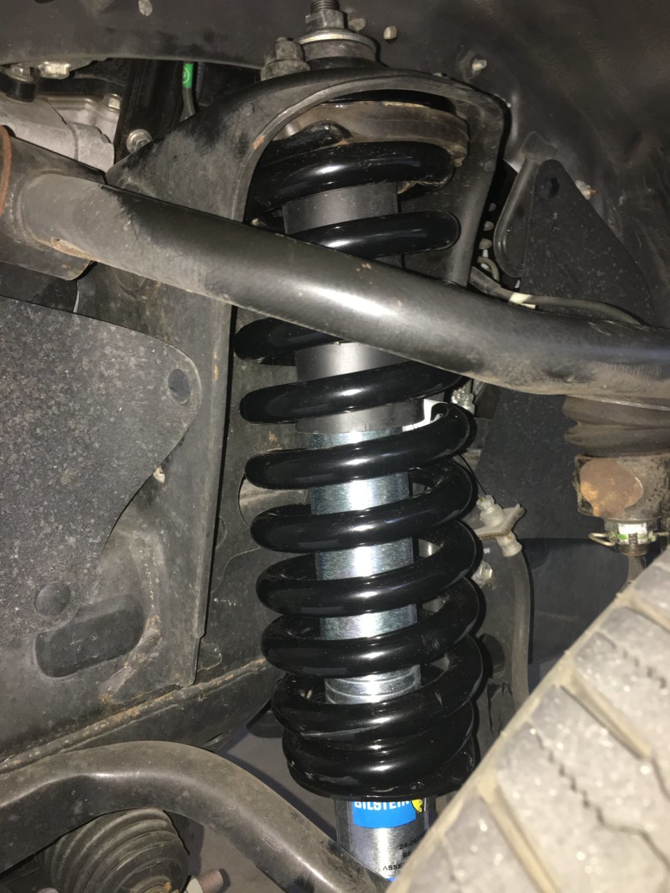

    IG: @Black_Tacoma: Dialed in a another 3rd gen the other day. So heres a catch up post did some front coil adjustments to compensate for the new rear Deaver j66's. Also added in some camburg Uca's which are prob one of my faves now due to the ease of install Plenty of spacer for the washers to go in and the large uniball is rad. Specs listed below!
    • Camburg 1.25" Uniball Uca's
    • 2.5 Kings Coilovers (Adjusted Preloaded)
    • 2.5 Kings Rear Shocks
    • Deaver J66 Leafpack :thumbsup:

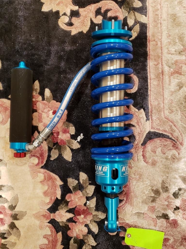

    IG: Mr.Pimp_Squeak: Dun Dun Dun the holy grail of OEM Bolt on shocks finally being installed on a customers rig. These Shocks are just rad to be quite honest. Super beefy and the ride is what you would expect from a shock that cost nearly as much as my schooling :rofl:. Well everyone enjoy the photos, customer was stoked. Only hiccup was missing hardware but thankfully lowes had the nylock nut i needed. Not sure if it was due to packing error or etc, Ran around town and found it so :anonymous:.
    • King 3.0 Remote Reservoir Coilovers with IBP & Comp Adjusters
    • King 3.0 2 Tube Remote Reservoir Bypass shocks
    • @TOTAL CHAOS Tubular 1.0" Uniball UCA's
    IMG_8537.jpg IMG_8531.jpg IMG_8530.jpg IMG_8532.jpg IMG_8533.jpg IMG_8534.jpg IMG_8535.jpg IMG_8538.jpg IMG_8563.jpg IMG_8571.jpg IMG_8569.jpg IMG_8582.jpg IMG_8590.jpg 7AF50221-293D-4DE9-A89F-4CA244EF0B31.jpg

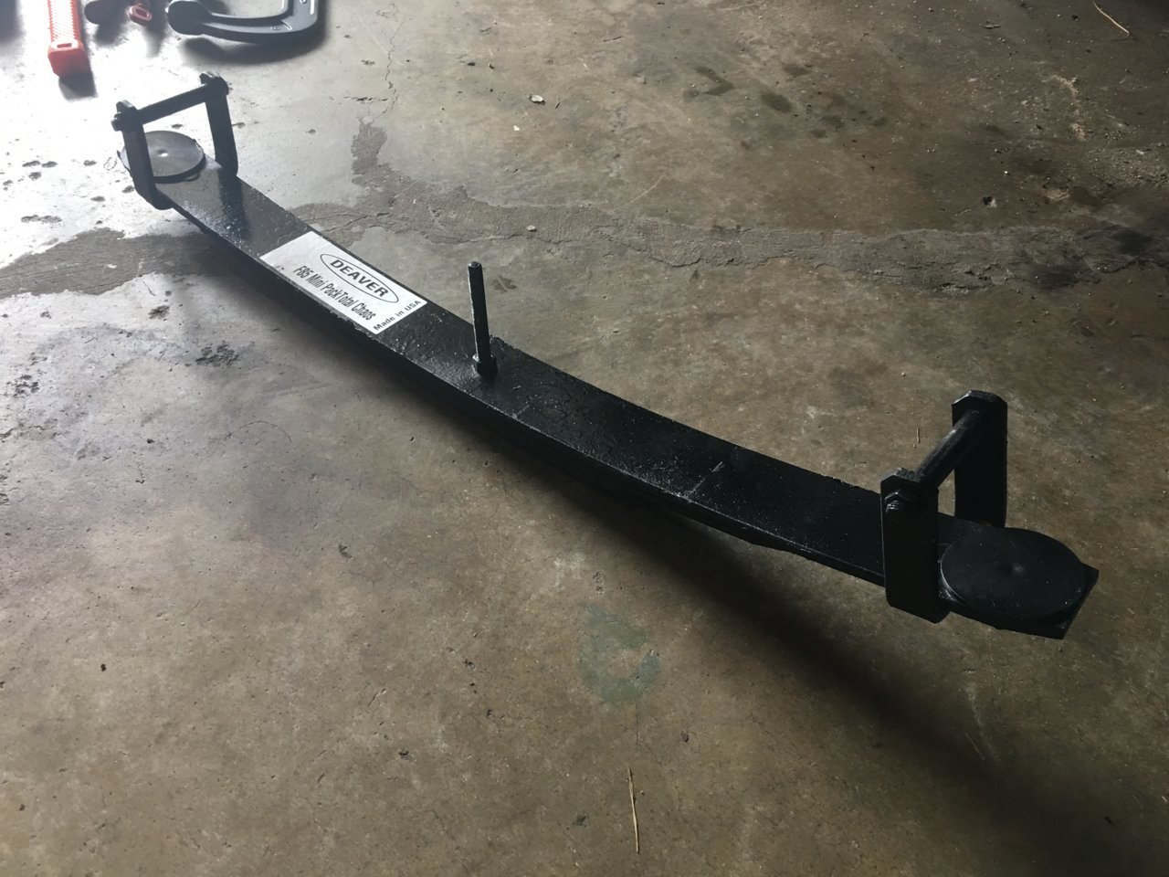

    TW: Junior trd: Ran some fox shocks on this setup and they ride great! However, ill be blunt they need to up the "quality control" involved with the sticker placemnt and the way the front resi's are setup, lines seem way to long. Besides that some cases the lower shock bushing & sleeve have to be pressed out and swapped. Overall though they ride great so thats what it comes down to :thumbsup:.
    • Fox 2.5 Remote Reservoir Coilovers with DSC Adjusters
    • Fox 2.0 Piggyback shocks
    • Deaver Mini Pack
    IMG_8640.jpg IMG_8626.jpg IMG_8614.jpg IMG_8606.jpg IMG_8601.jpg IMG_8638.jpg IMG_8609.jpg

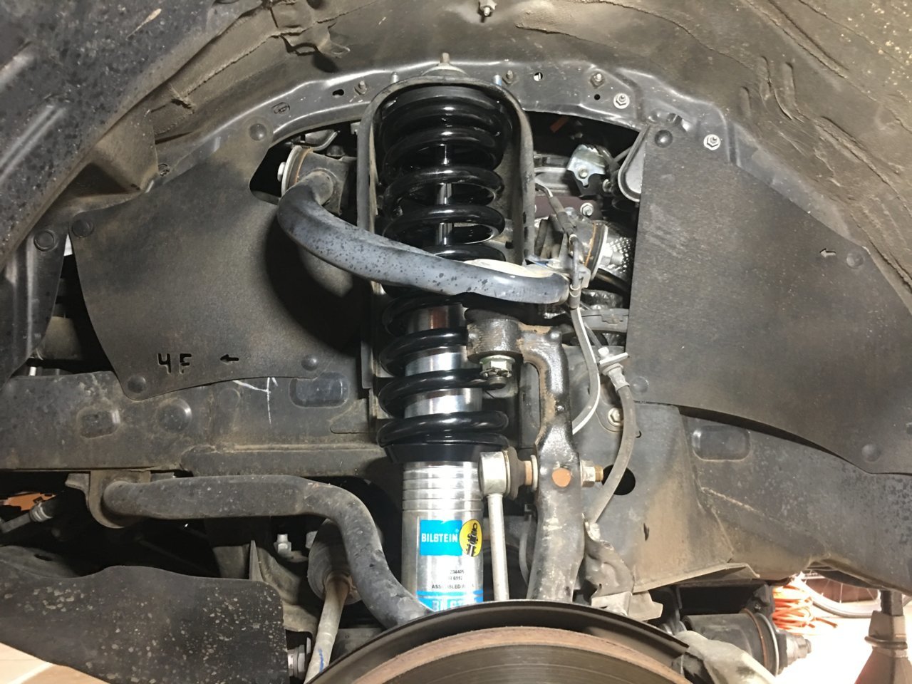

    TW: @Sirpopeington: Here we got another 3rd gen dialed in with a simple but effective lift due to the coil choice and opting to leave the Overload leaf out. Parts of course provided by @HeadStrong Off-Road and bam installed in a jiffy.
    Parts:
    • 5100’s front with OME 888 coils
    • JBA UCA
    • 5100’s rear
    • @HeadStrong Off-Road AAL Rear 2/ overload remove
