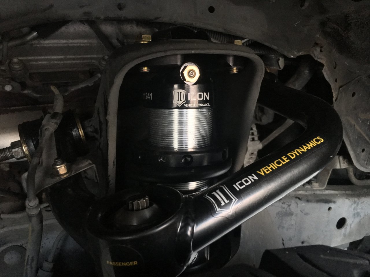

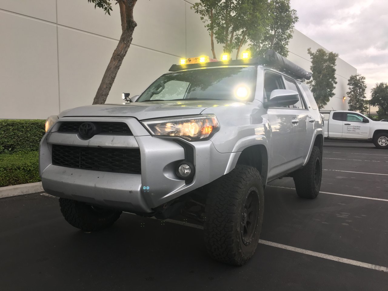

    TW: N/A : Something different from a Tacoma, digging the 4runner setup since we did a xreas delete after installing the lift kit. Happy with the outcome! Dm me for quotes sincei have plenty of slots open for now!
    • Icon 2.5 Front coilovers non resi
    • Icon 2.0 Rear shocks non resi
    • Icon UCA w/ Uniball
    • Icon 2" Rear Coil

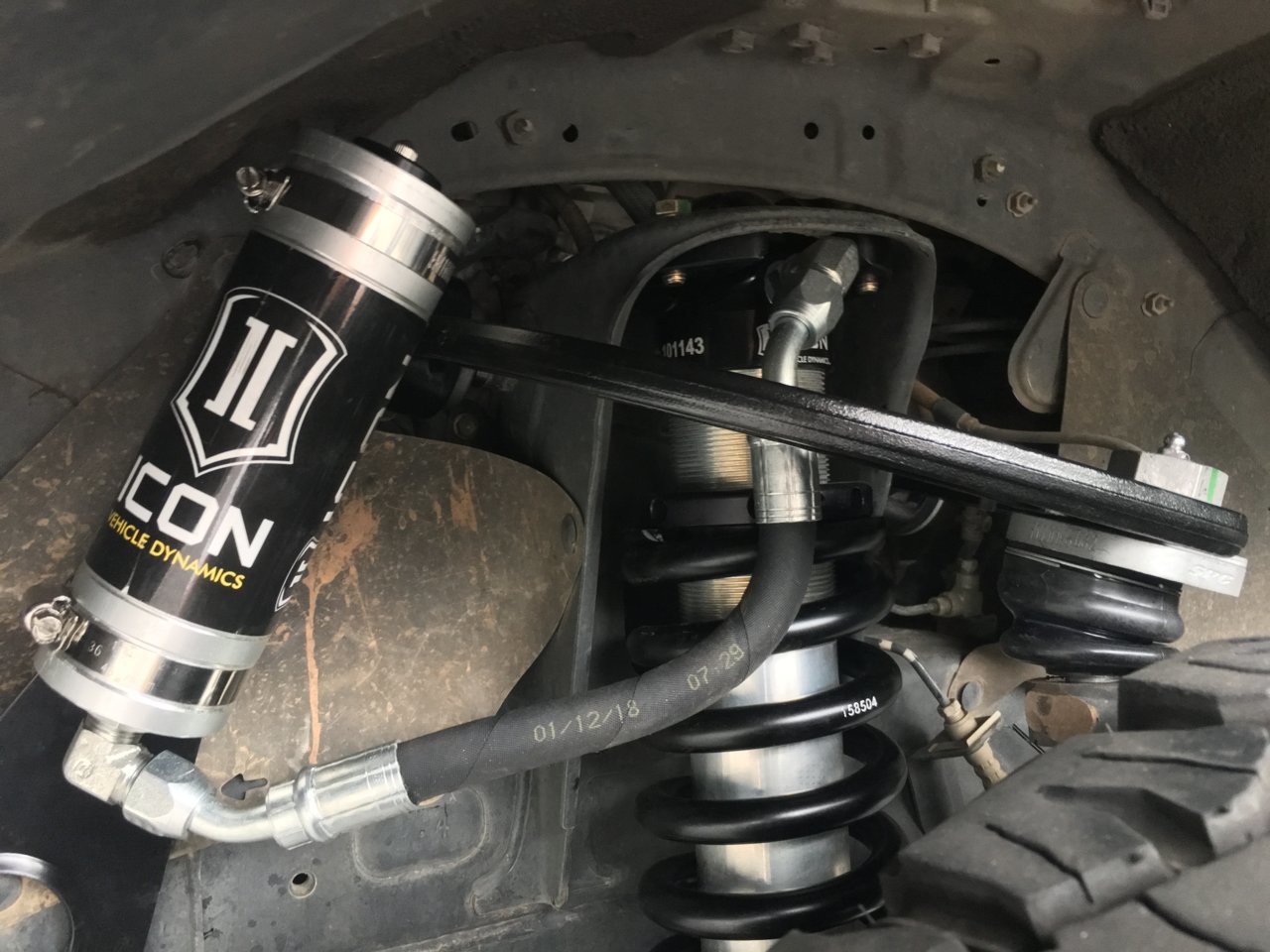

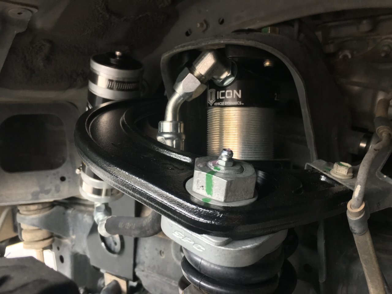

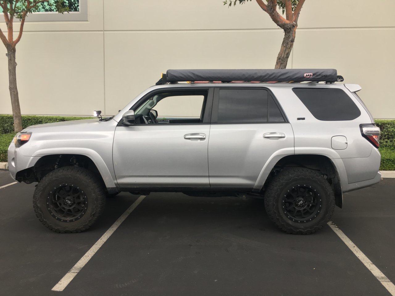

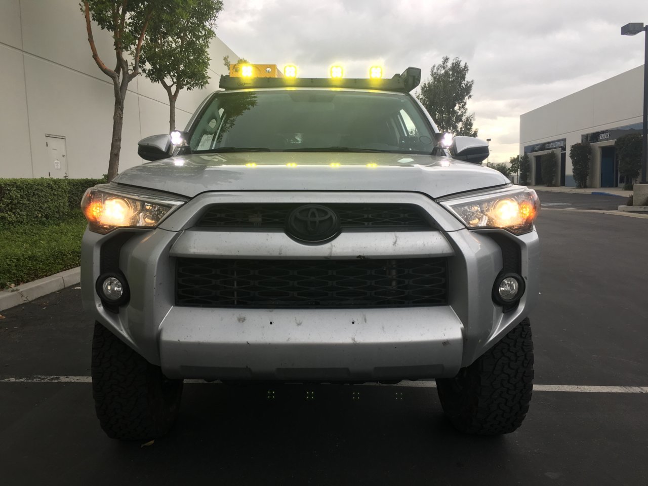

    TW: N/A : Another 4runner who actually came from the SD Region that got dialed in during the past weeks. Been busy with school but still doing installs so dont be wary to send private messages.
    • Icon 2.5 Front coilovers w/Resi
    • Icon 2.5 Rear shocks w/Resi
    • SPC UCA's
    • Icon 2" Rear Coil

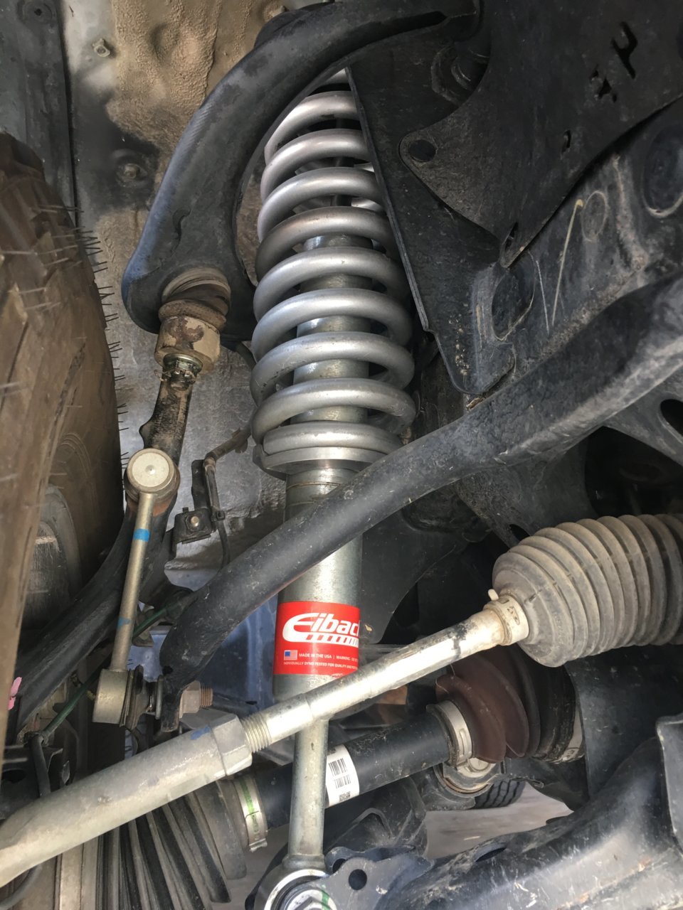

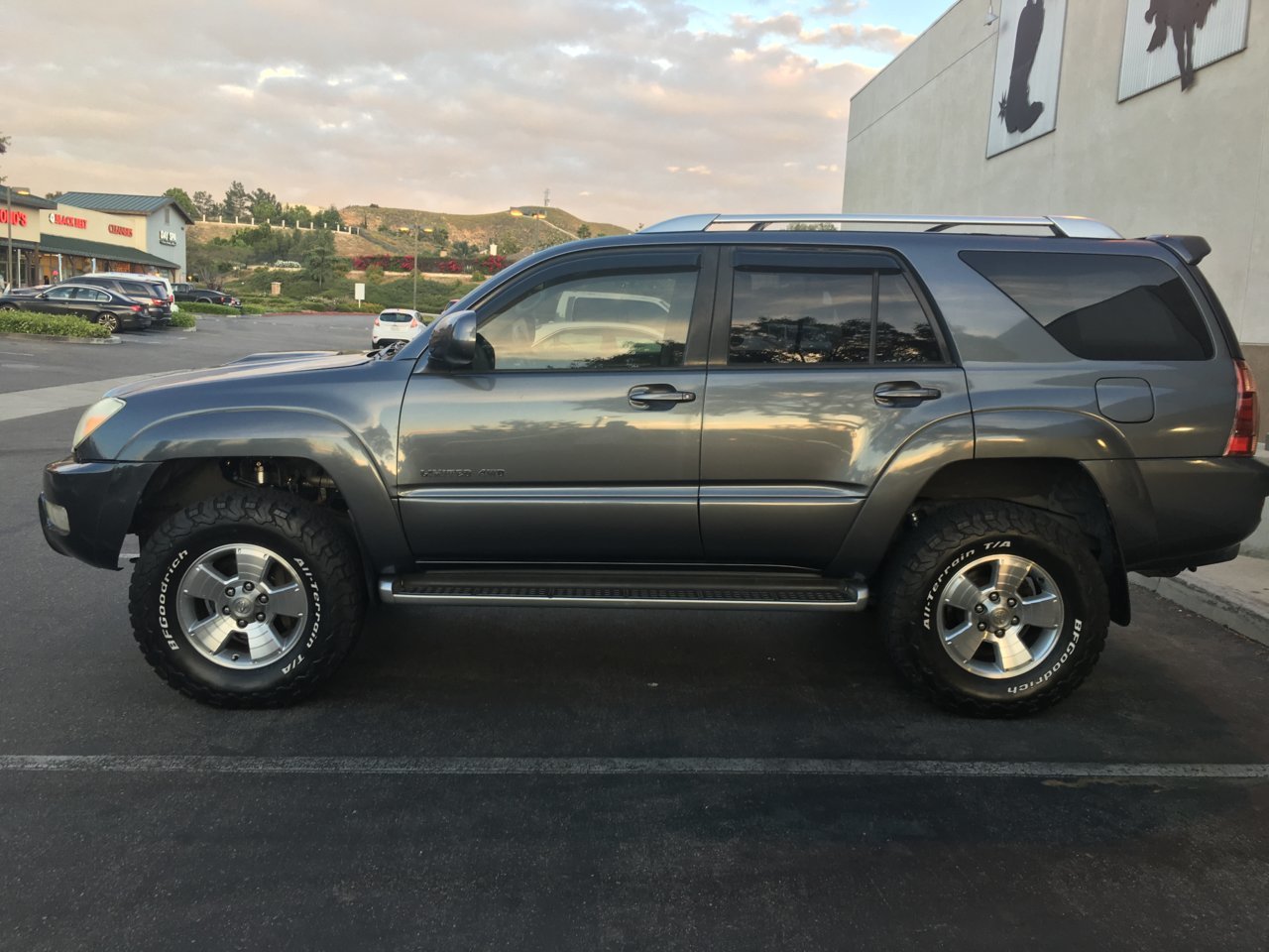

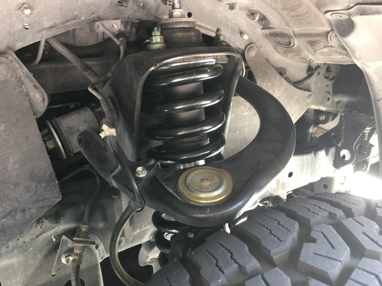

    IG: Alpastr: Another 3rd gen on the simple Eibach Pro lift kit. Install went smooth, and the alignment numbers after were as expected. Message for work on installs!
    • Eibach Pro Lift Kit w/ Coils
    • Deaver AAL (Eibach Spec)

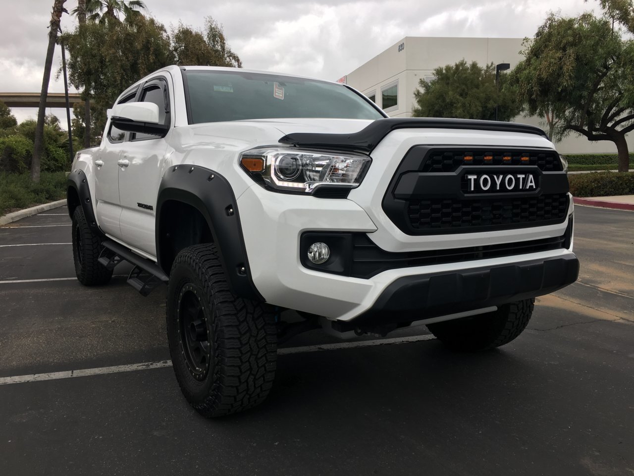

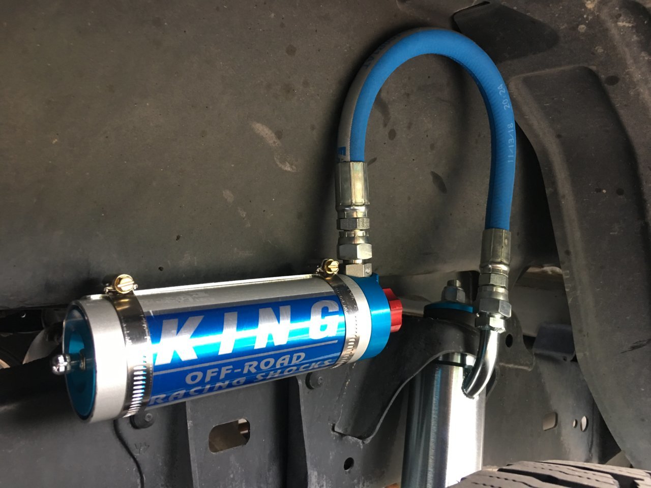

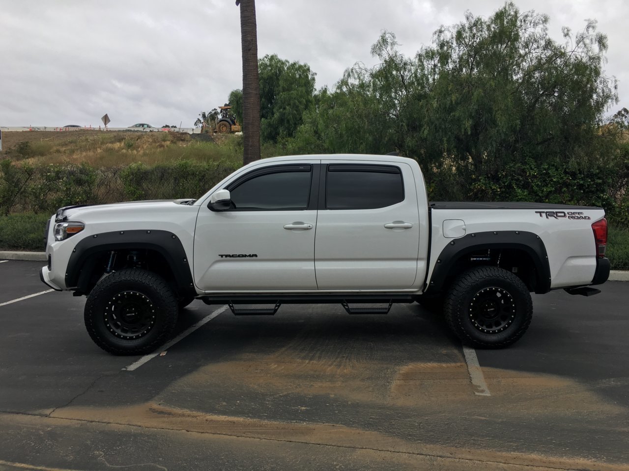

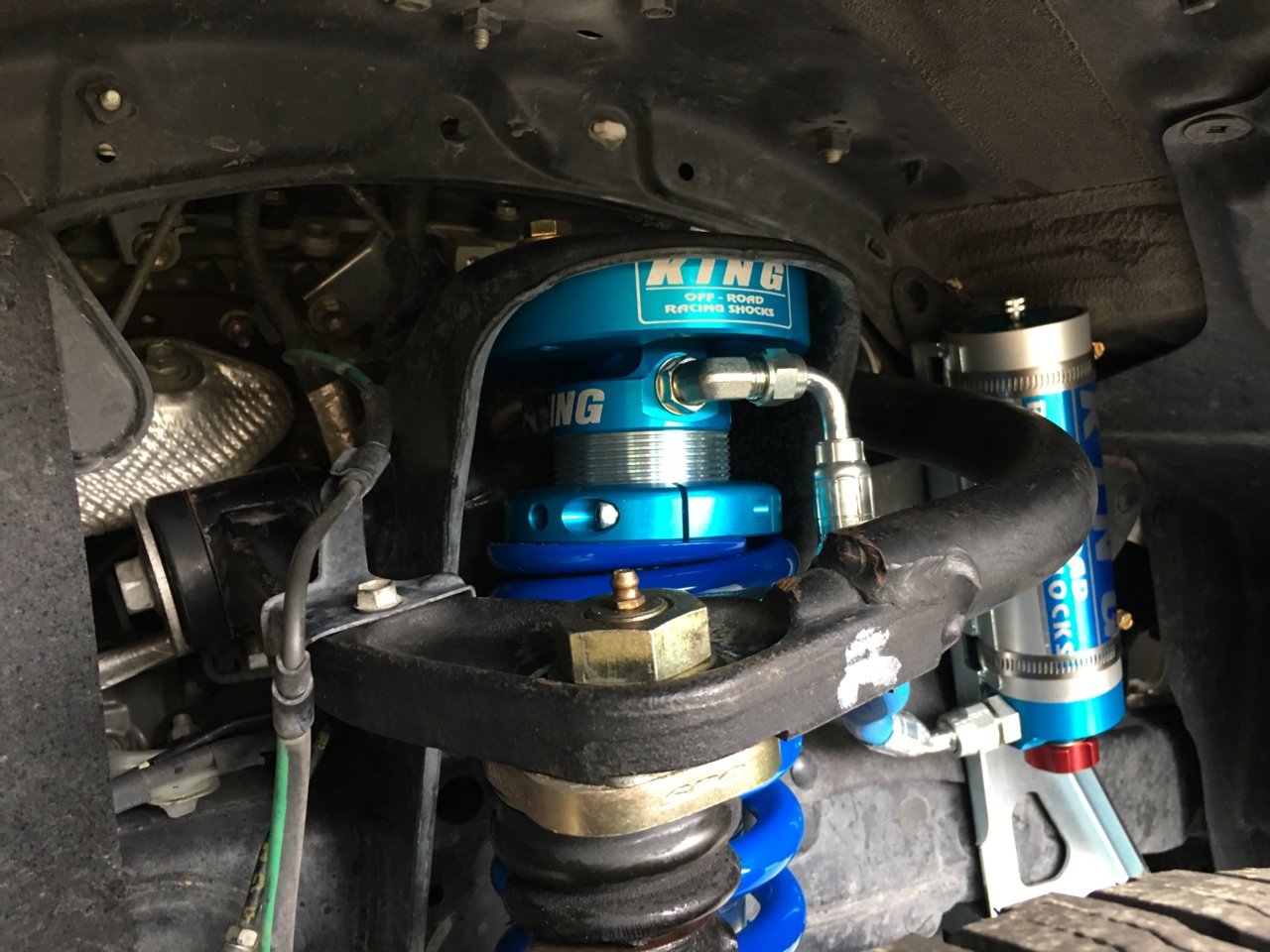

    IG: Stretch2323 : Did another install over the past weeks. This rig got dialed in with the parts listed below. Upper arms were used and acquired from another member. Overall though the truck rides great. He will opt for a better options such as an AAL Or leafpack vs the current block.
    • King 2.5 Front coilovers w/ Comp Adjusters
    • King 2.5 Rear shocks w/ Comp Adjusters
    • SPC UCA Gen 1

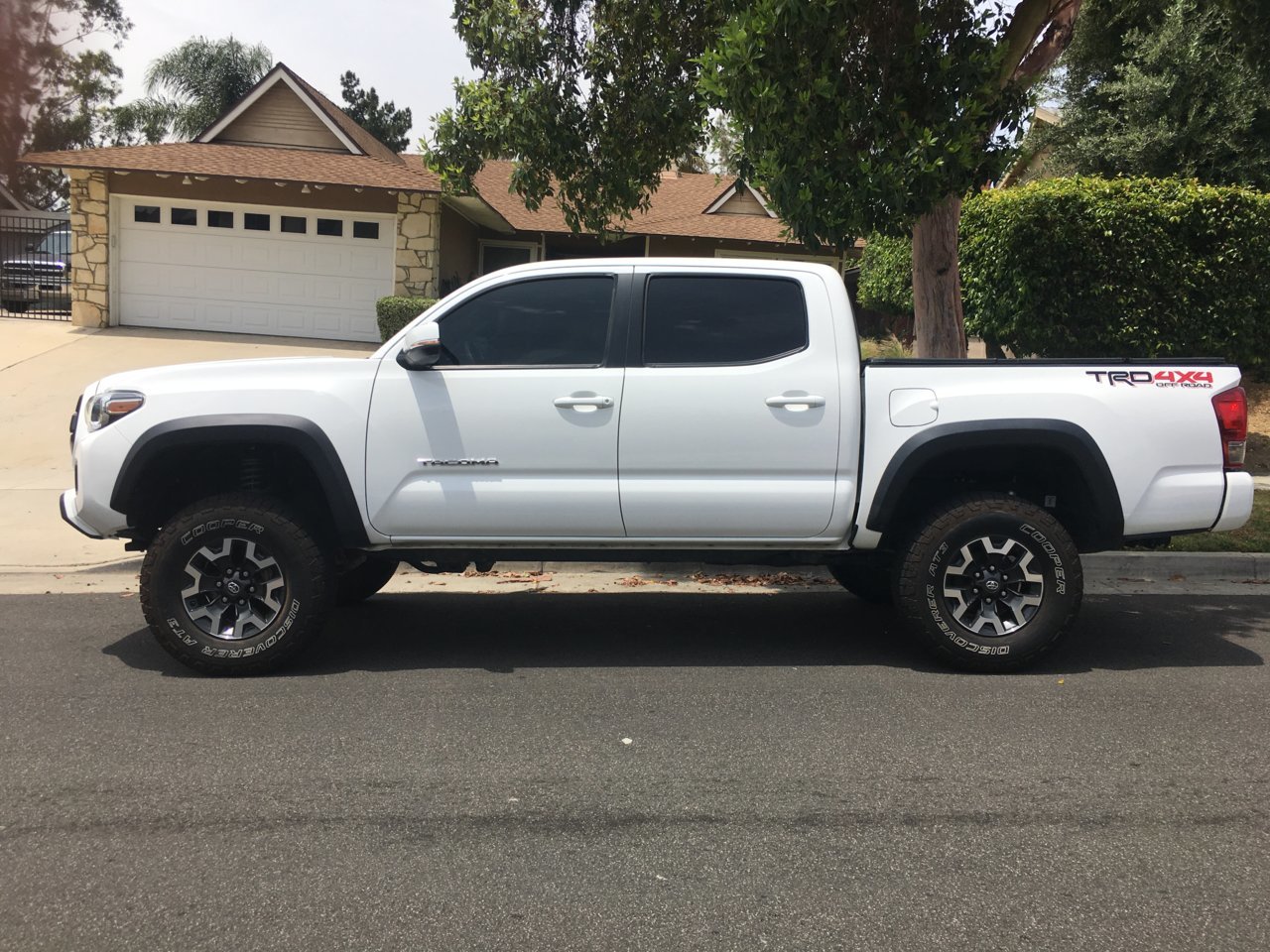

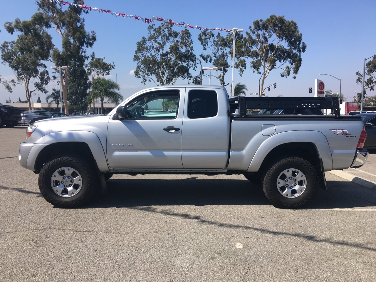

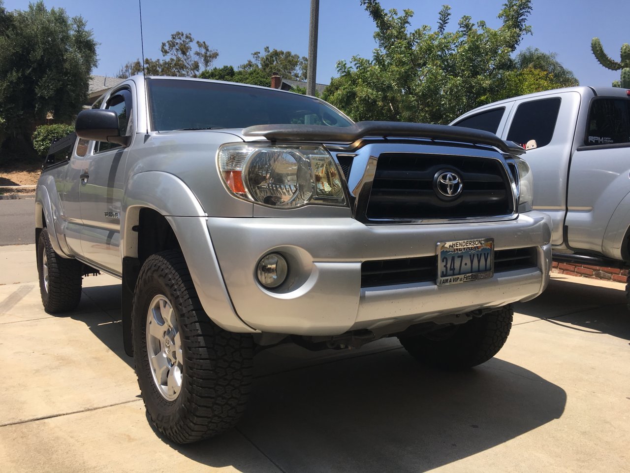

    TW: @rara114 : Had a great time meeting Rob here who came all the way from vegas! Big thanks to @Shmellmopwho for the referral! So all we did was swapped some OME 885 coils and added a Supreme Suspension single leaf AAL. Everything went in smoothly and we got ourselves a great looking and capable rig. Stop by anytime and ill be seeing you once you come back in town!!!!
    • OME 885 W/ 5100 @ 0 Notch
    • Supreme Suspension AAL

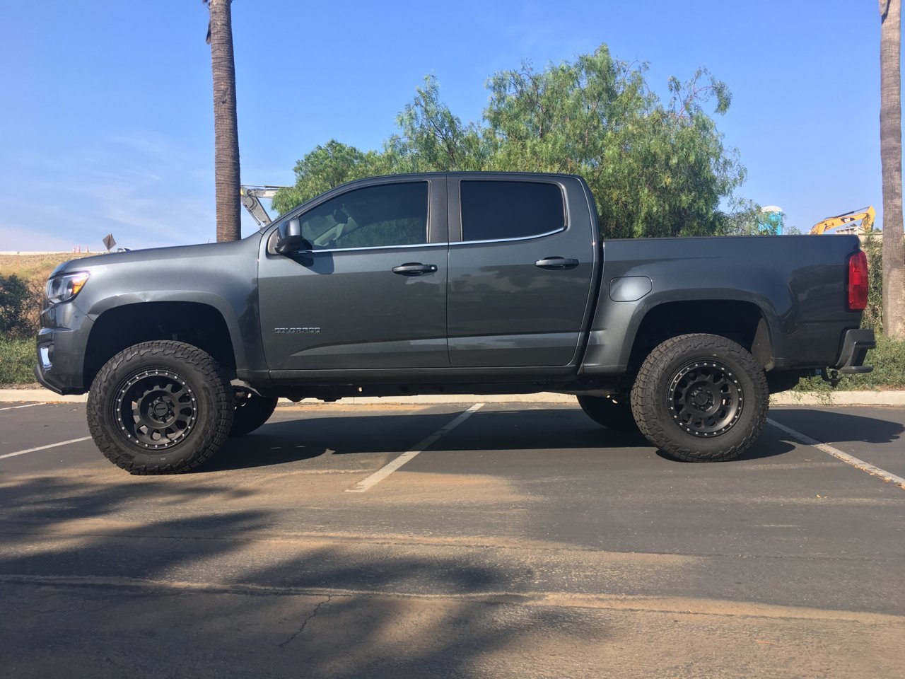

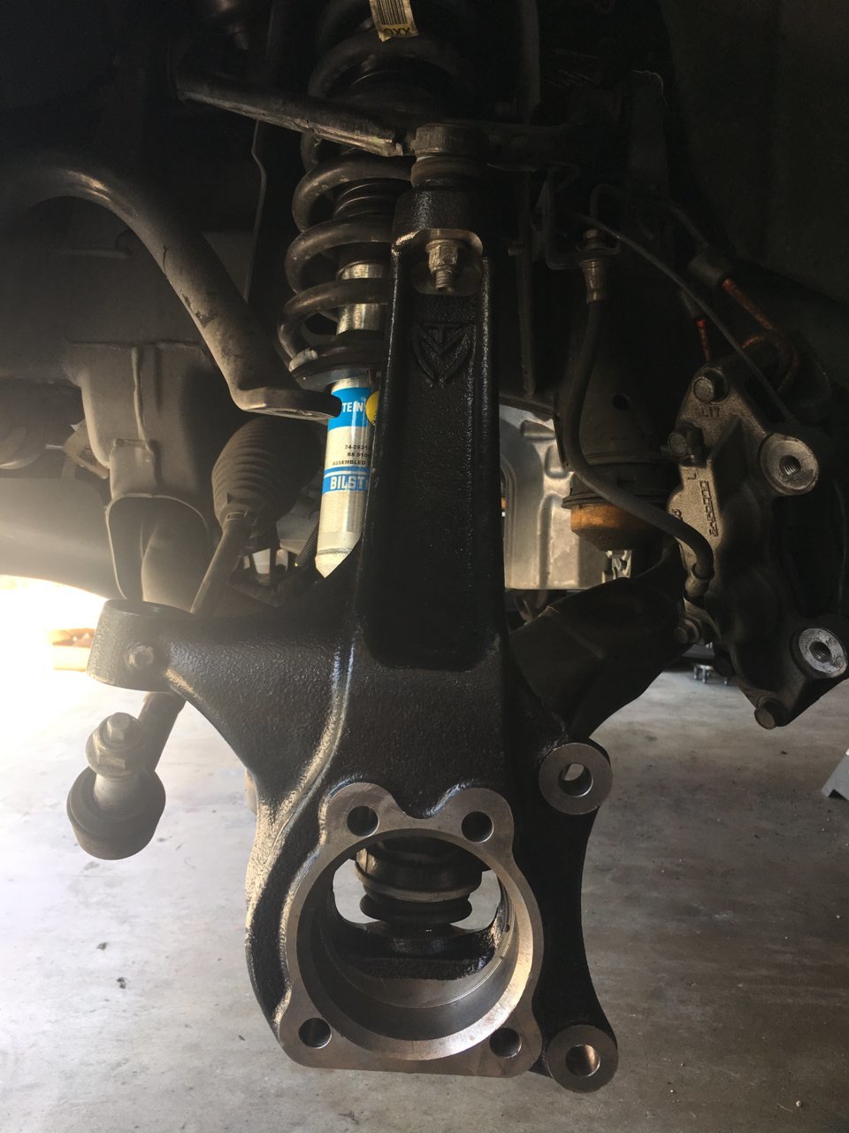

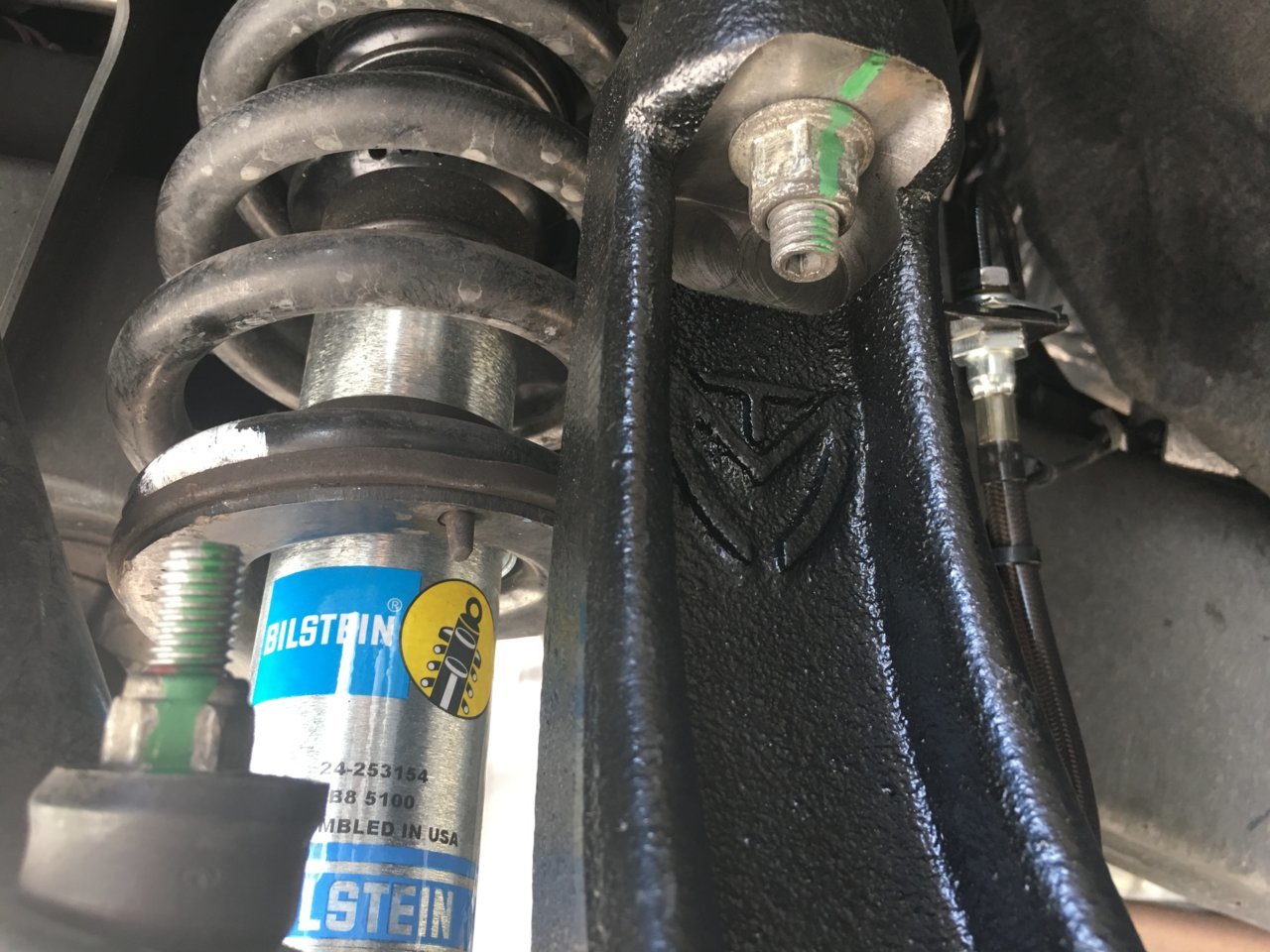

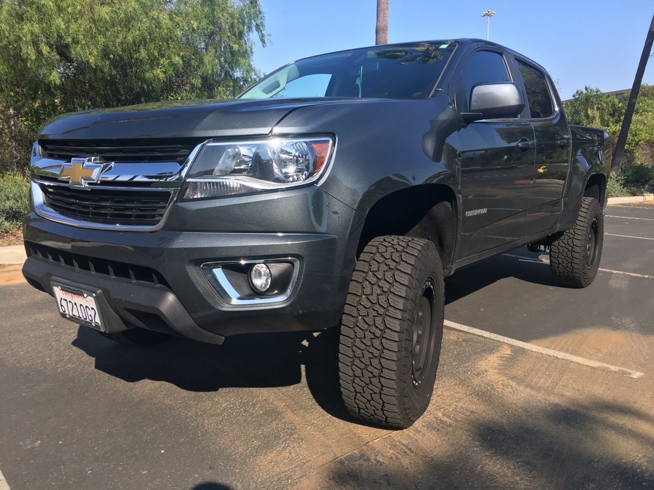

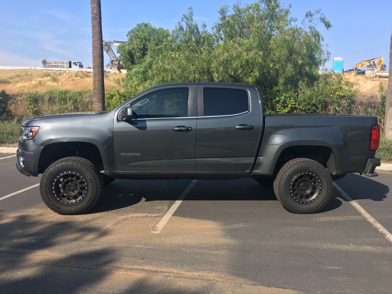

    IG: Chris_steinker : Oh boy it aint a Tacoma or even anything close to being a toyota . . . . . . but guess what its maxtrac spindle related so here you goooooo. 2017 Chevy that came in and wanted something that wasnt going to break the bank. Yet, the overall outcome was rad. If any work is needed go ahead and send a PM. These Spindle lifts on and 2wd trucks are the way to go, espcially for Tacomas.
    • Bilstein 5100's @ Notch 0
    • Maxtrac 4" Spindles
    • Extended Front brake lines
    • Rear 2" Blocks
    • Rear Maxtrac Branded Shocks

    Hi Nate, do you know what size tire that is?
    I like to do a spindle lift and am thinking about 285-70/17 but it seems like the wheels are sticking out quite a bit in this photo.

    The maxtrac spindles push the wheel down and they also make the stance in front about a 1/2 inch wider per side than when it is mounted on a stock spindles.

    So he is running a 285/75/16 tire setup with the 0 offset on the wheels if im not mistaken. However on top of the spindles theres wheel spacers from spidertrax. So he's 1.25" wider with the spacers added onto the spindles .75" thats nearly 2.0" of extra track width. Most wouldnt run the spacers on top of the spindle.
    mmhmm pushes it out .75" vs the .5". But Wider up front a tad bit :thumbsup:
