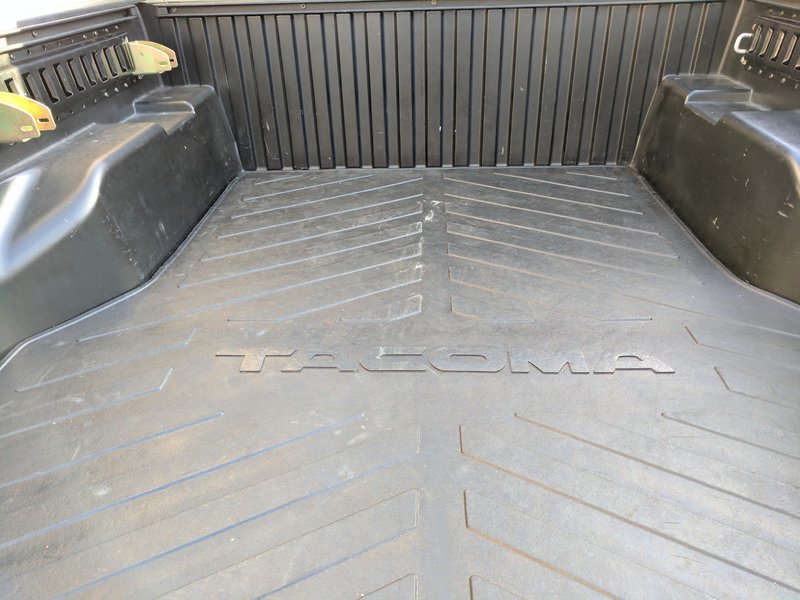

    Toyota - Bed mat (5/17)

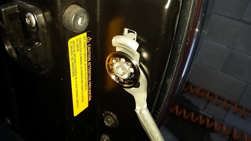

    Tailgate cable mod (5/16)

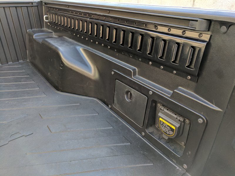

    E-track - Bed Rails (6/17)

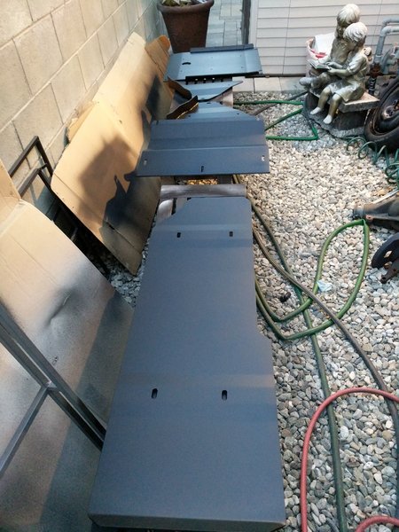

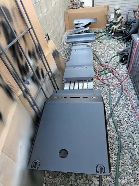

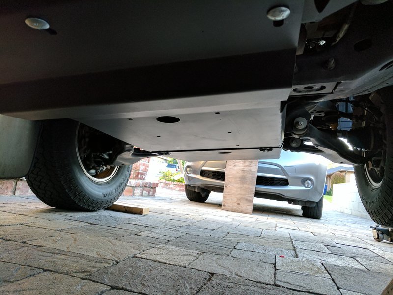

    0515 Tacoma Fuel Tank Skid Plate
    0515 Tacoma Transmission Skid Plate
    0515 Tacoma Front Skid Plate
    0515 Tacoma Transfer Case Skid Plate
    0515 Tacoma Rear Differential Skid
    0515 Tacoma A-arm Skids
    Slight modification on the branding, sorry RCI (I like the skid though)

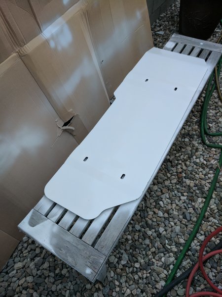

    Got started on clean metal primer. Used the airgun from HFear.. not the greatest gun but worked.
    Skids are ready to install, just did the upper sides after work, will let them cook in the sun tomorrow. 6/23
    IMG_20170624_151027.jpg unbranded the rear skid sorry again RCI
    All skids are installed

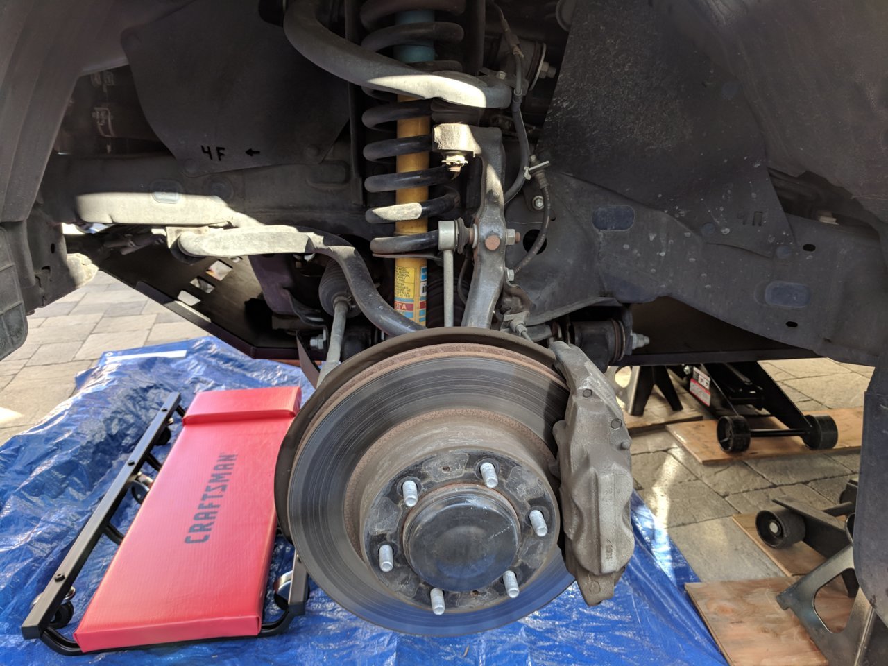

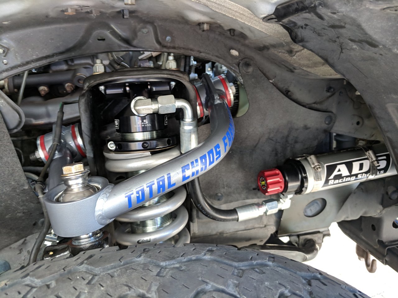

    Total Chaos Uniball UCA's
    Swapped for SPC's

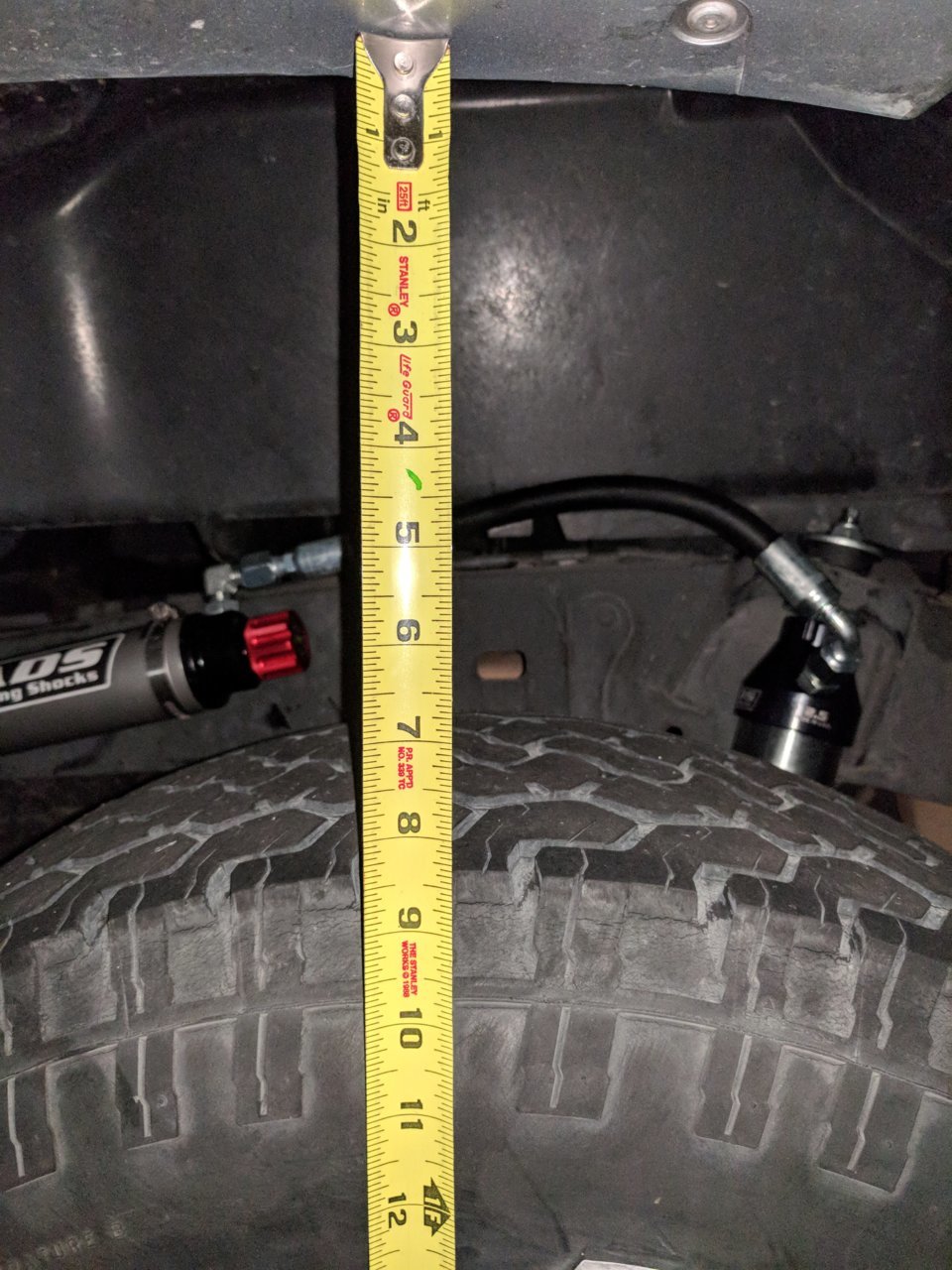

    ADS 2.5 Extended Travel w/Remote Clicker's 700 lb. Springs
    Oldman EMU HD Leafpack, removed the third leaf to make it a medium pack. Did not want to bounce down the road.
    Installed 5/28:
    IMG_20180527_162705.jpg rear
    IMG_20180527_162717.jpg front

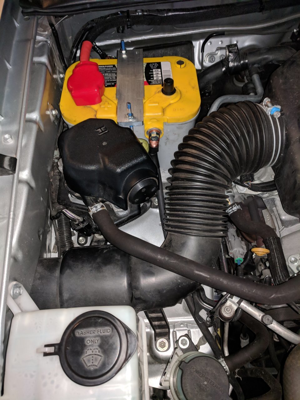

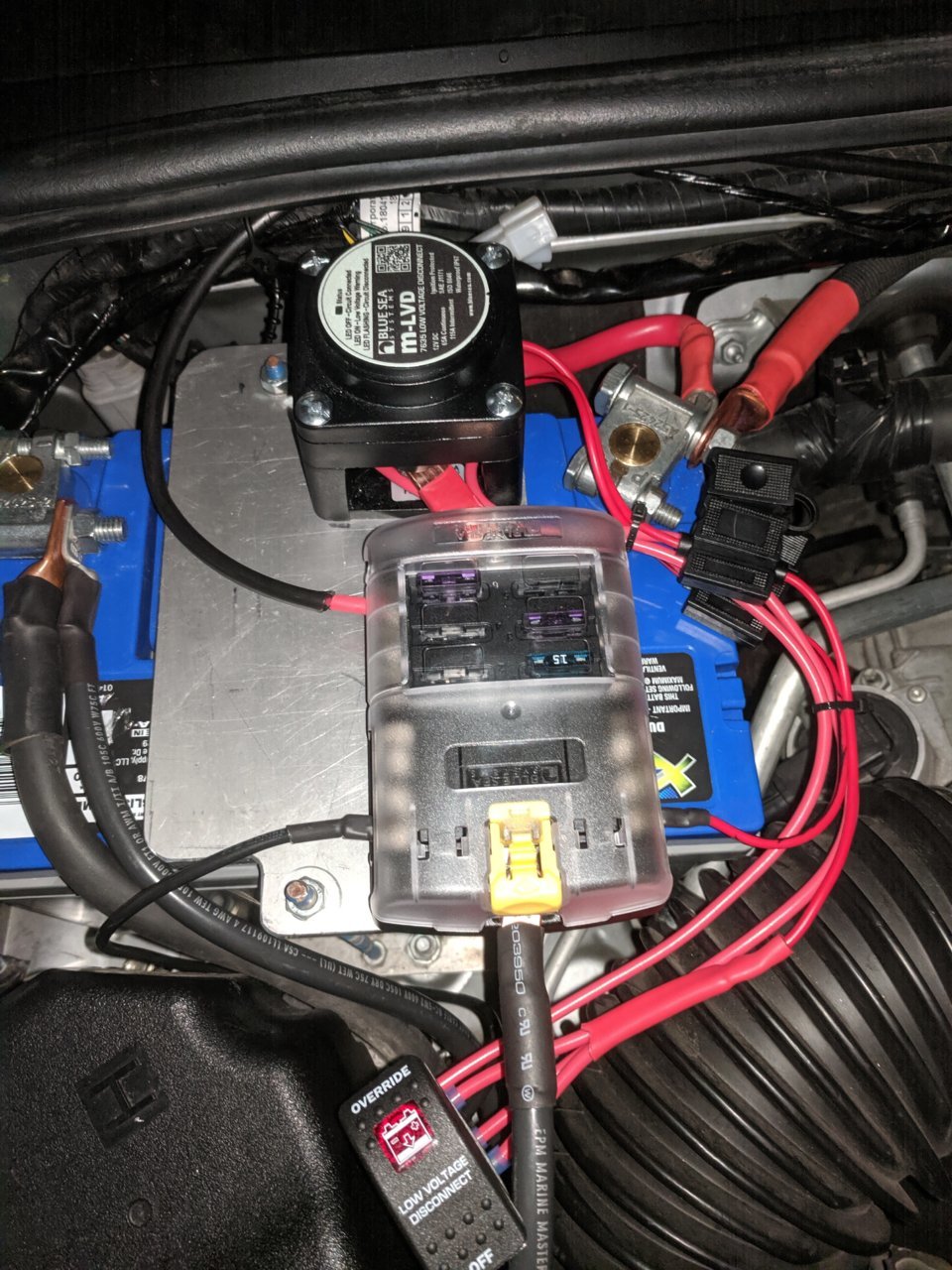

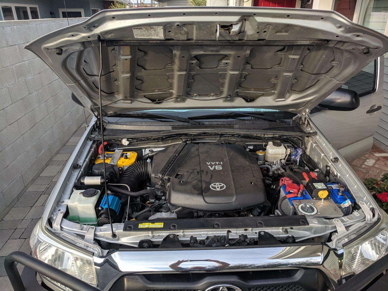

    Battery Mod:
    Updated
    Just temp hooked up the low voltage dropout. Have to build some wire Though it is a deepcycle battery I do t want to kill it
    https://www.tacomaworld.com/threads...voltage-booster-upgrade.604478/#post-20368718
    Updated the Charge Voltage on the batteries DIY super cheap
    Ended up making this with a fuse tap, 2 100v 3a diodes and a 3a fuse, probably for about $2 and it did not take 6 weeks. Wrapped it with 3M 600v electrical tape
    Twin mount
