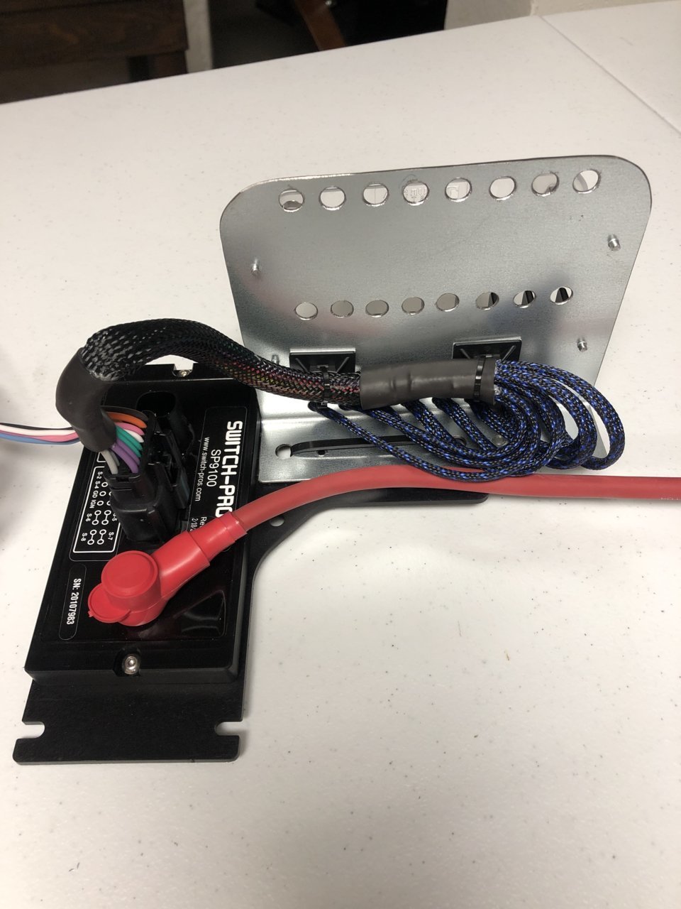

    So I'm no electrician, so I'm genuinely asking because I don't know, but do you not need each circuit fused? Does the main fuse for the whole switch pro provide the circuit protection?

    The main fuse adds protection for the module. Each circuit is protected by MOSFET fault protection.

    Just like @Skydvrr said, if your looking for a affordable way of adding accessories then your basic switch and relay Is what your wanting. With this being said, you’ll be running wires through your firewall and under your dash everytime you add a accessory, not to mention, finding a location to install switches. With the switchpro you eliminate the work. Just one 4 conductor harness goes through the firewall and plugs into a switch panel and that is good for up to 8 accessories. Then everytime you add something all the work is done in the engine bay.

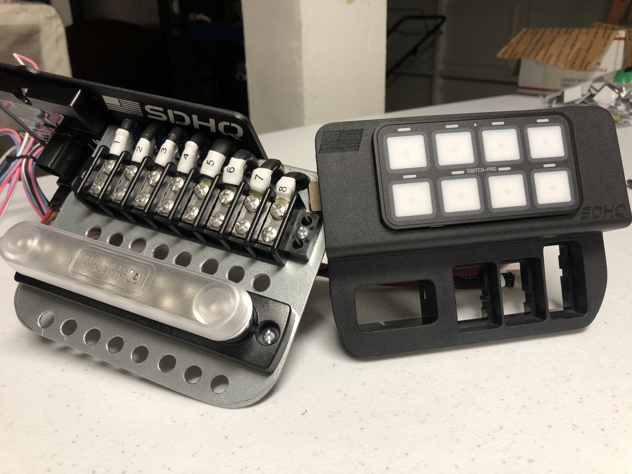

    Nice job Aaron! I like the way you loom all the wires and label them. Saw one in person last week when doing a few things on FishN'Tacos truck. The loom really keeps it super clean and the labels are a really nice touch. Looks good bud!

    That is some seriously nice work Aaron. What label maker are you using? Mine just makes tags on the wire. Yours is much cleaner!

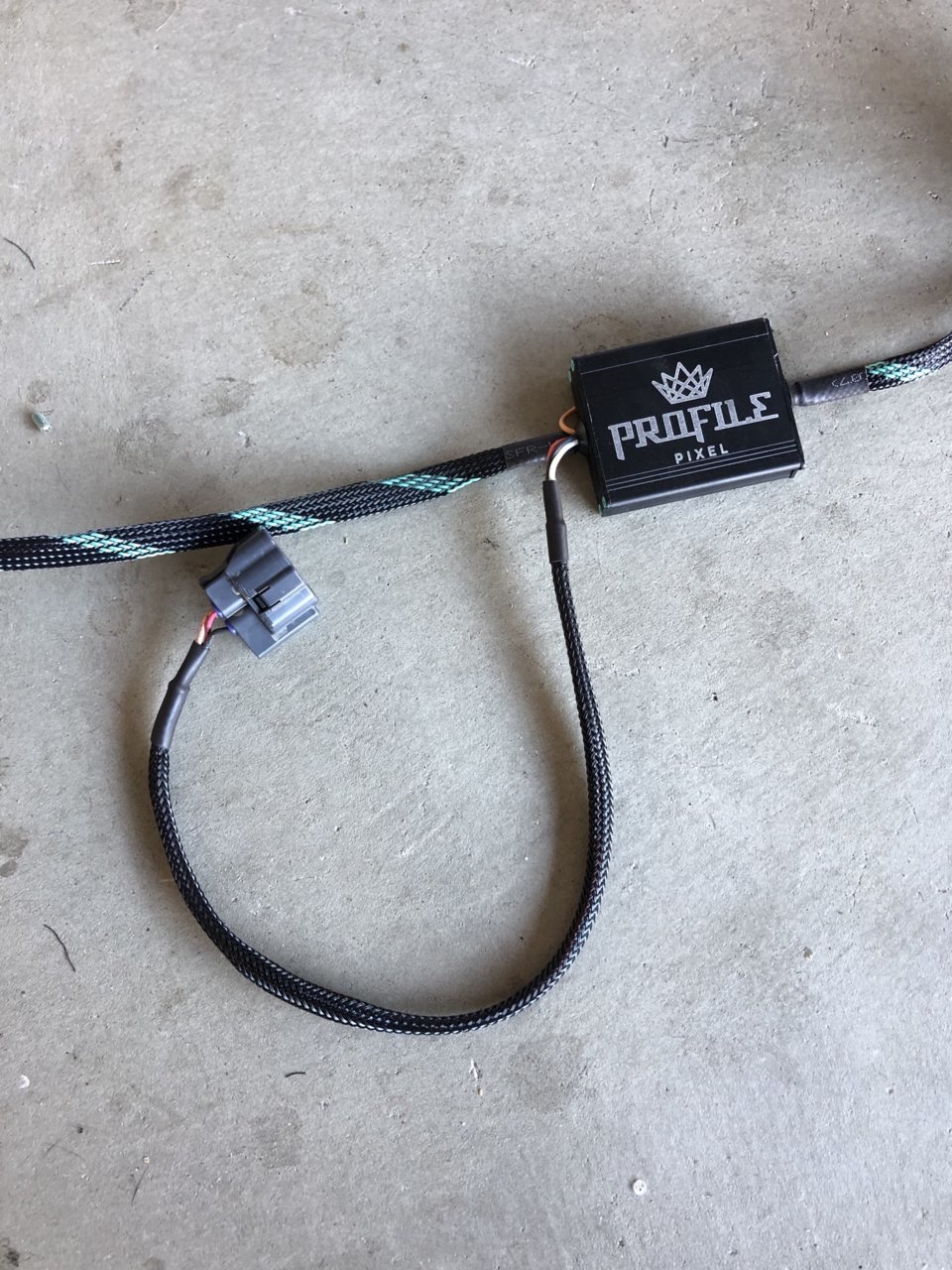

    Installed retrofits on my truck, decided to make my DRL RGB harness’s plug n play for easy removal and cleaner look. Similar to my switchpro setup/installs
