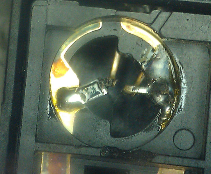

    Easy... remove the Bulb. Then use a 5mm Through Hole LED and bend the legs at 90 degrees. work the led into the bulb hole and so that the led aims at the front of the switch. then solder 1 leg to the bulb mounting pad. Dont forget to check the polarity with a meter first. then you will need to add a current limiting resistor to the other leg. The value depends on the LED you are using. I used larger surface mount resistors to make it nice and clean. Ill pop one out for you and post a picture later.

    lol thats exactly what i was doing :thumbsup: n i always thought about it but never got around to doing it until someone finally demanded it :rolleyes: haha
    thanks man!

    Sorry .. I just checked... 3mm LEDs not 5mm. I used 500 Ohms for Blue.

    yup, 3mm...i had 3 laying around n they work. thanks again :D

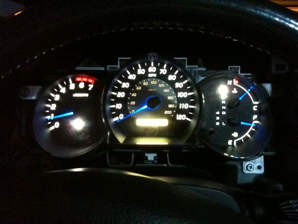

    With the help of jerez and multiple pm's i finnaly was able to finish my led swap, thanks again man and sorry for bugging you with all those questions.

    Just one thing, why is your speedo needle so low? It's suppose to be around on the line

    Thats where mine was when it turned off, not sure why its like that. But after i did some messing around with the needles it sits perfect now

    Ah ok, cuz I know that the rpms n mph needles automatically recallibrate themselves. But it looks good.

    No they don't. None of them do.
    You have to turn them in a cirtin direction until you feel the pressure then set it where want it.
