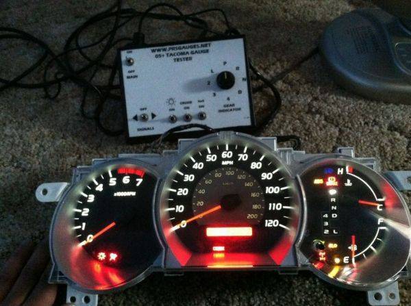

    If I'm doing the cluster with buttons, I can probably have it all done like in around 3-4ish hours
    While I'm waiting for the needles to dry, I can work on the buttons real quick

    Sweet!... you can safely power the clusters throughout the process. so i check before i put the face/LCD part back on.. then use it on and off again to get the needles perfect. With power on and no signals is the true home/zero of the needles and that is when they need to be lined up just right. which is not always exactly the same as where they stop with no power.

    yup, thats true...ive used it twice already...so much easier to test them this way :thumbsup: you sir are a Guinness!!! :D
