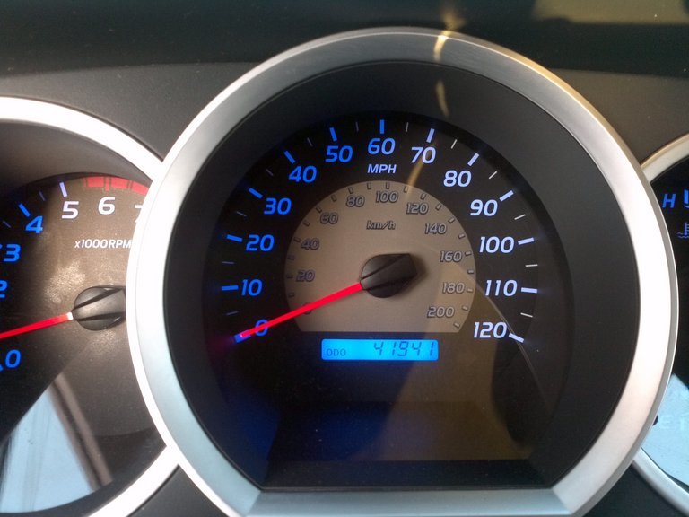

    When you pull the stock bulbs out of the back of speedometer do you have to melt the existing solder, remove the bulb, then attach the led with the existing solder or just completely re-do it?
  14. Aug 8, 2012 at 8:18 PM
    #1094
    Hiatt1991
    Hiatt1991 Well-Known Member
    Aug 19, 2010
    #41917
    7,985
    Hiatt
    Ventura, CA
    2022 Toyota Tacoma SR5 DCSB 4x4
    4" Bodylift 20" Offroad shock spacers Turbo Encabulator
    Melt the solder, remove the led, then resolder on the new led on.
    Correct me if Im wrong Rodger.

    yes and no...melt, remove led, clean, then reapply solder on one pad, add led and heat that one side then let it cool then add solder to the other pad and done

    all pms replied...this was dead for a while a bunch of people have been hitting me up again :spy: lol
    one from this weekend
