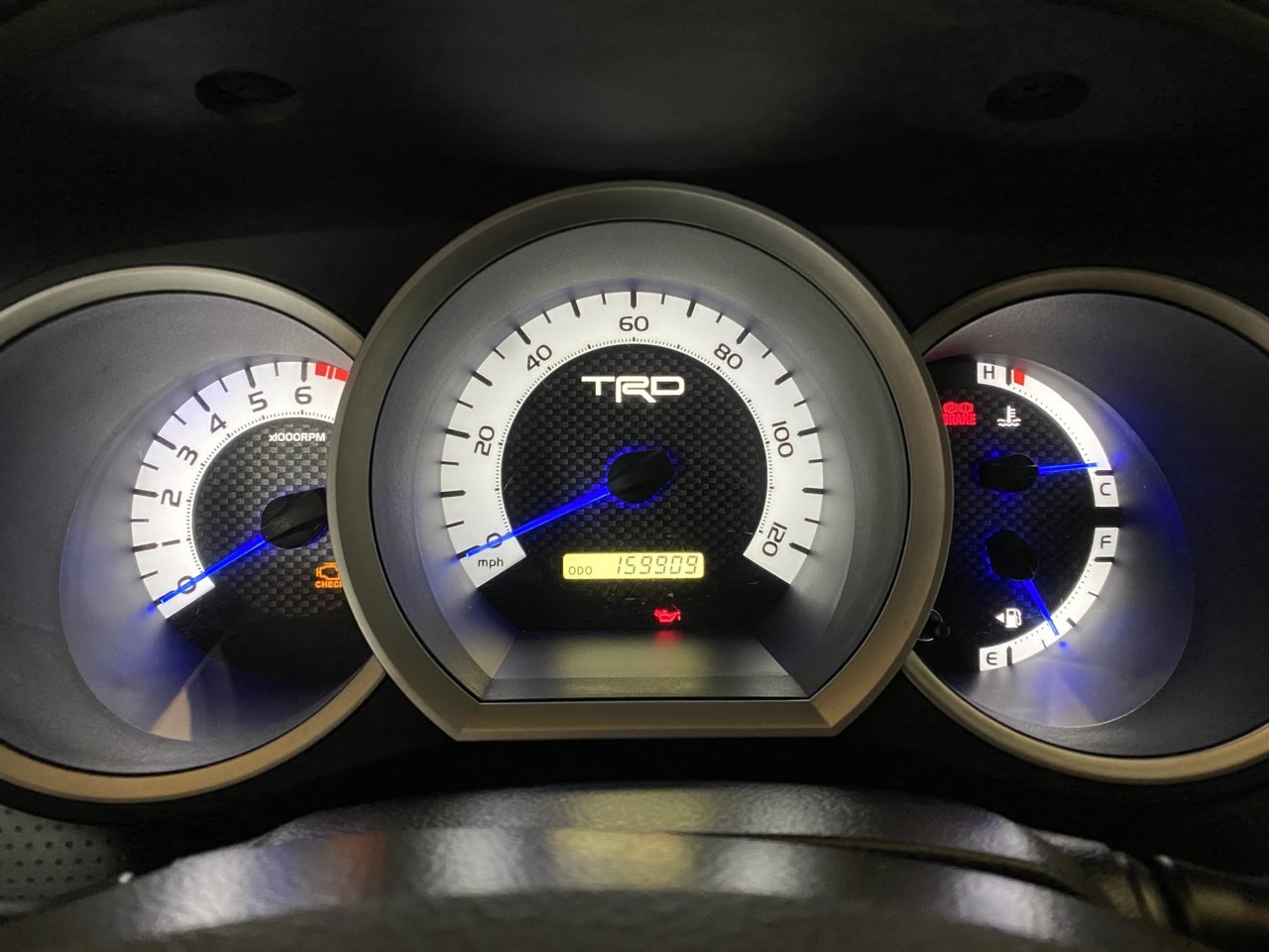

    @Jerez (or anyone else) - is there a drawing/diagram of all the LEDs and the stock colors? Asking because I plan to try this myself on my 2015 and I might want to change some of the other lights besides the backlight. Figure if there is a drawing out there it would help plan. So far I haven't found one, and I've tried to read all 89 pages of this thread but didn't see one here either.
    Or alternatively if you just have a photo of the 13-15 circuit board and then we can make a drawing. I'd go take mine apart but it's my daily and I can't take it down for fun (plus it's about to be negative degrees here soon so yeah).
    Thanks in advance if you have something like this!

    I’m sorry if this isn’t really any help, but if you take your gauge cluster out, the piece with all the numbers for you gauges is just a thin plastic piece, and the part where the light shines through is somewhat see through. So if you hold it up to light, you can see how many other LEDs you’ll need to replace. As far as color, I think they’re all either green or orange, aside from your high beam indicator which is blue. I ordered 100 LEDs, fried a few, and still have about 30-40 leftover after doing the back lighting and every indicator. Can easily be done in one night if you’re confident in yourself lol

    Thanks but this isn't what I'm looking for. I understand I can take it apart and look at it myself, I'm trying to see if there are photos available so I don't have to take it apart multiple times. I worked at an electronics factory as a technician for many years so the soldering part is child's play, not concerned about that.
    Thanks appreciate anything you can find. Closest I found in this thread was post #1149 but it's difficult to make out due to the resolution. Again appreciate anything you have, I'm just trying to plan ahead without taking my dash apart multiple times. Cheers.

    @Jerez Sorry to keep bugging you but I have one more question. I swapped out all of my acc switches to led bulbs except for the A-Trac under the climate controls. It appears to have a surface mount led in it. Do you know what size it is? I assume its a 1206 but wanted to see if you knew.

    I believe on the 09-11 trucks its the 1206 and on the 12-15 its a different led (smaller too) i think 0503 (dont quote me i lost my note pad with all my info :facepalm:)
