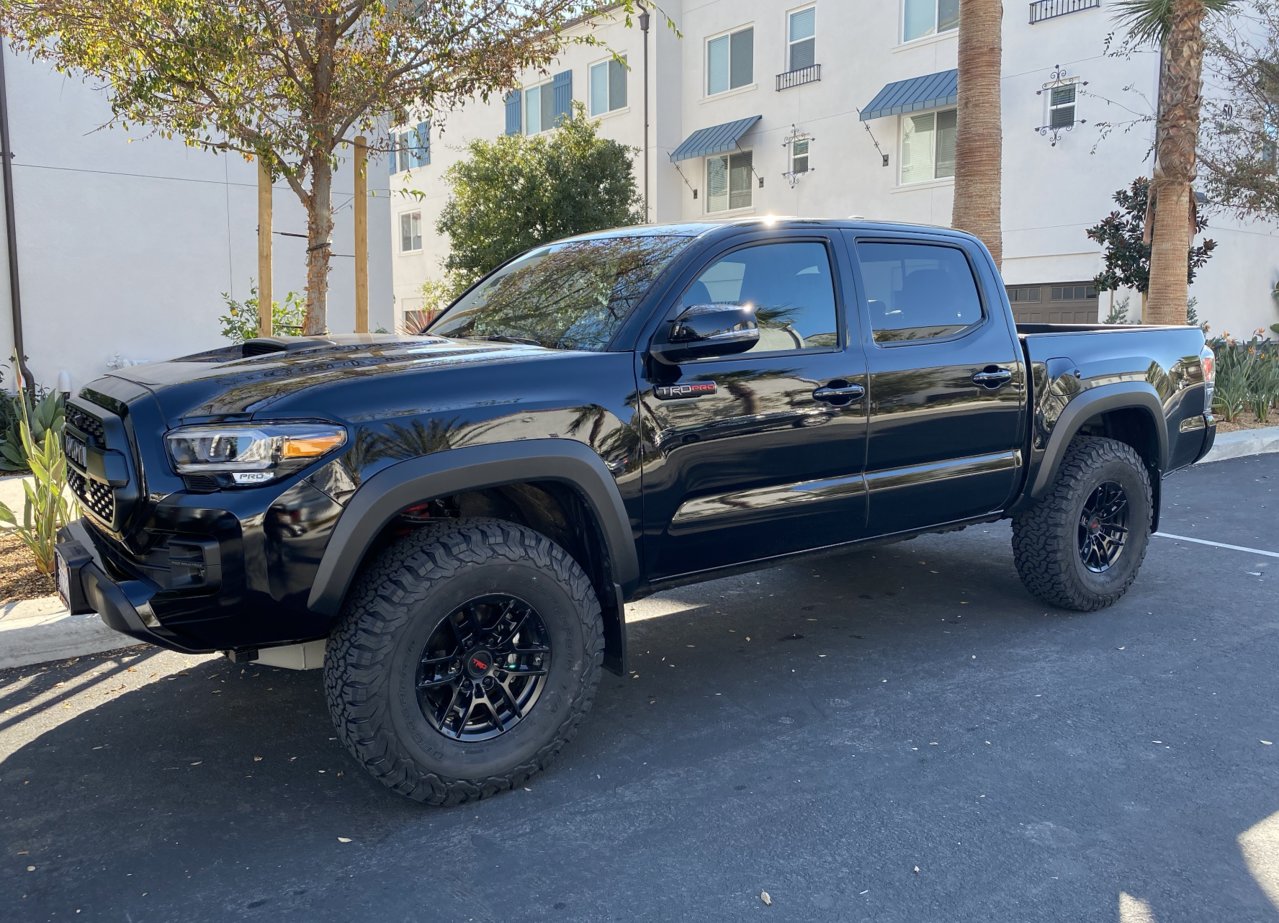

    Whats Up Fam!
    Hope everyone is doing good!
    New owner of a 2020 TRD PRO and looking for suggestions on lifts -- I would like to keep it as STOCK as possible but do want a bit more ground clearance was thinking 2" lift -- I am not too familiar with where to start and open to suggestions of what to get, and PICTURES would be rad.
    Only modifications so far are upgraded tires 285/70r/16 BFG Ko2's -- daily driver, light camping and road trips nothing too crazy... yet. :p
    I live in Chino Hills, CA -- so looking for a shop in the Orange County area -- all suggestions welcome!
    Thank you!

    The TRD models come from factory with a 1" lift, so if you stick to a mid travel (1-3" lift) you really will only be able to get an additional 1-1.5" lift. Just my $.02, with that nice of a truck, you may want to look into a nice set of shocks. Not only can they be tuned to ride amazing on and off-road, but will last nearly the lifetime of the truck since they can be rebuilt. Happy to answer any detailed questions if you have any, shoot us a PM. We are in Carson CA also and do installs all the time.

    I am a Pro owner as well. You mentioned you can only get 1-1.5" lift but if I gut the Fox suspension for a Kings lift kit can I get ~2.5"-3" of lift?

    The Fox/King coilovers that are available for Tacomas 0-3" lift, are based on a standard Tacoma not the TRD Pro. Since the Pro comes with a 1" lift, you will only gain an additional 1.5-2" lift.
