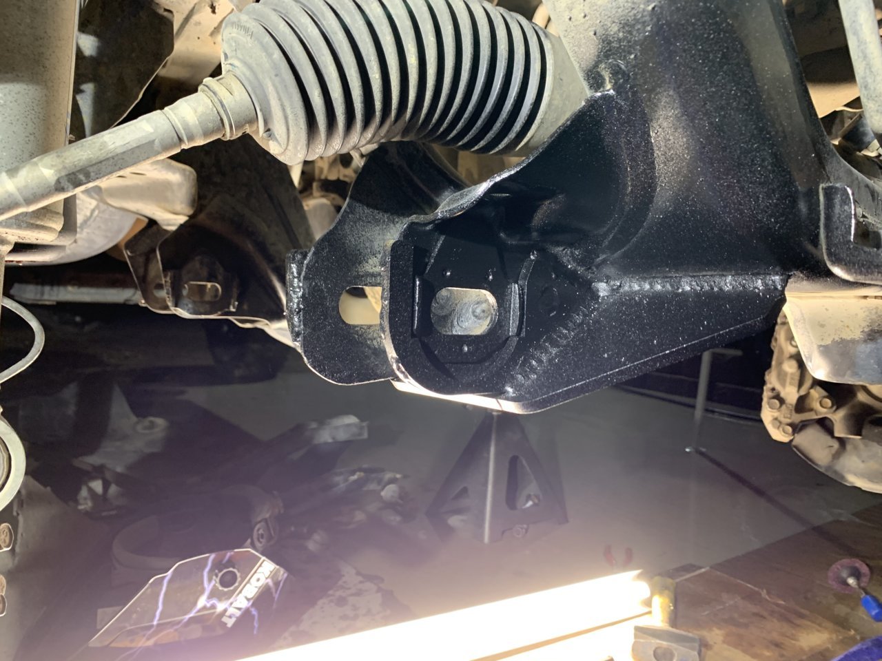

    A CMC I did recently, finally got the right cable to get the damn pics off my phone, haha...

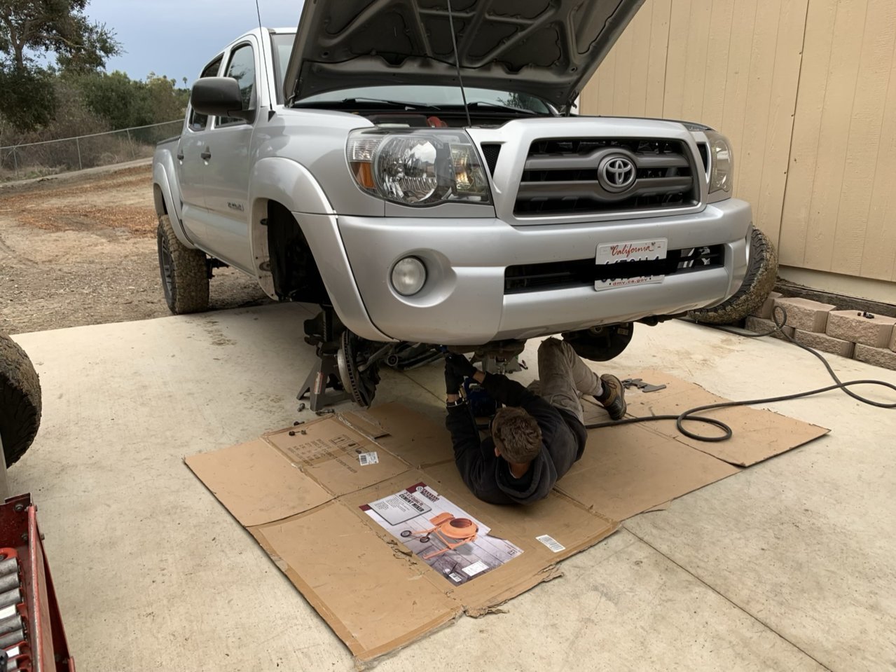

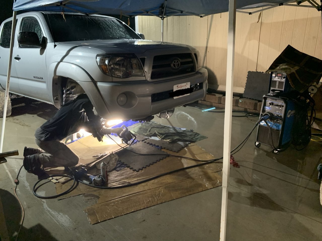

    Went to Speed Freek for a quick CMC today and it came out awesome! Super stoked he managed to squeeze me in and get er’ done despite all the rain we’ve been having here! Looks great definitely plan on going back for future projects!! Thanks dude!

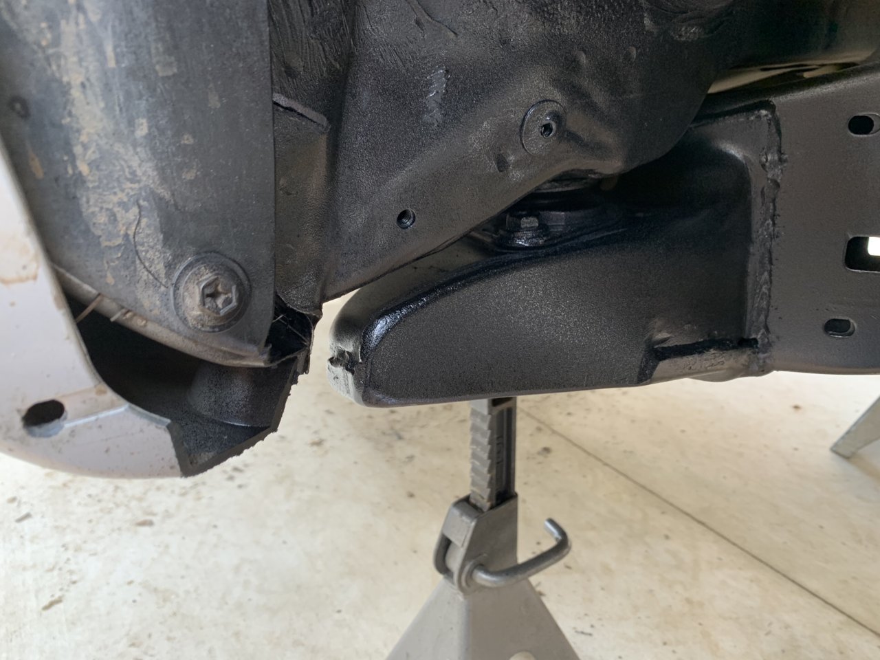

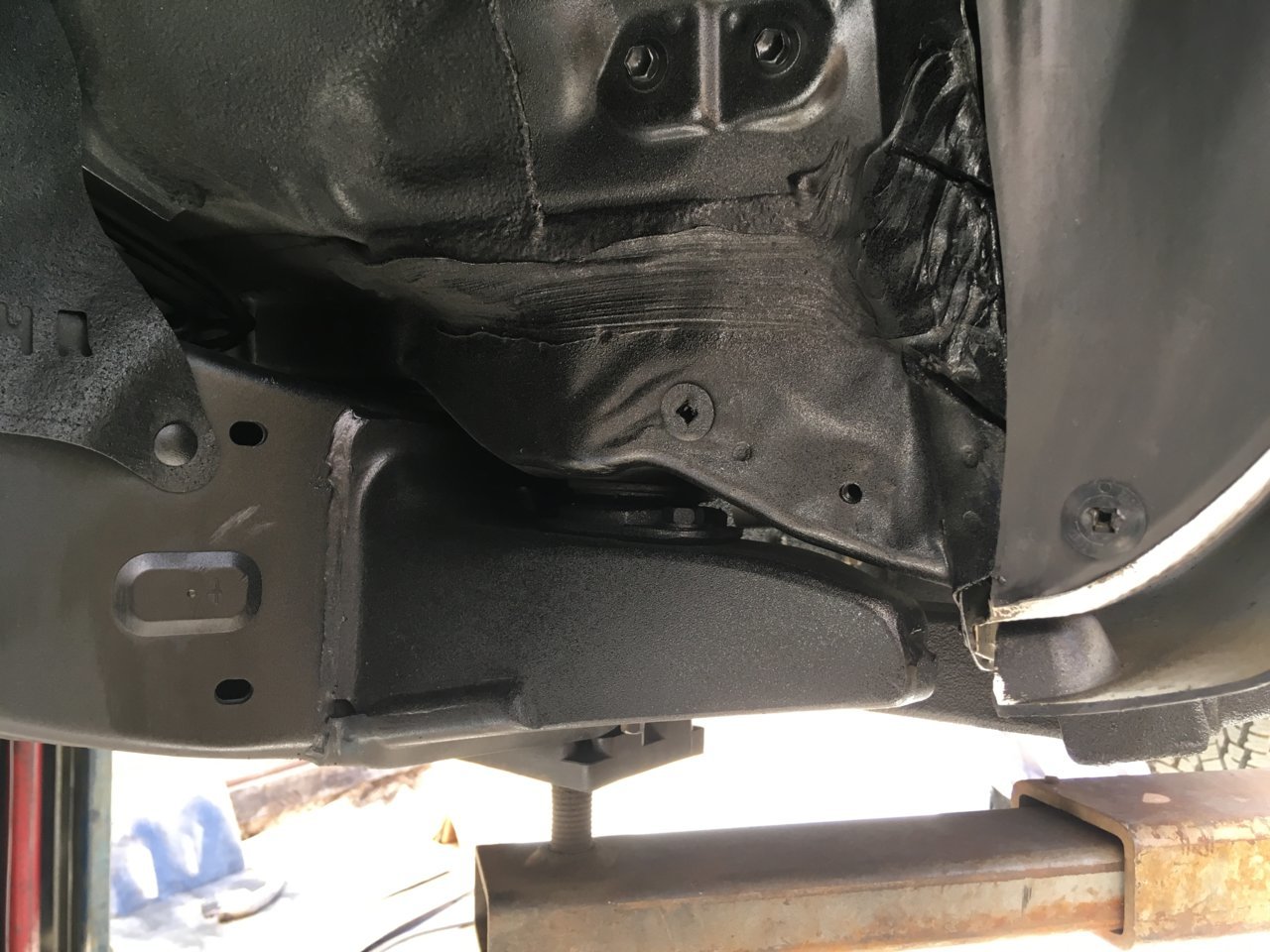

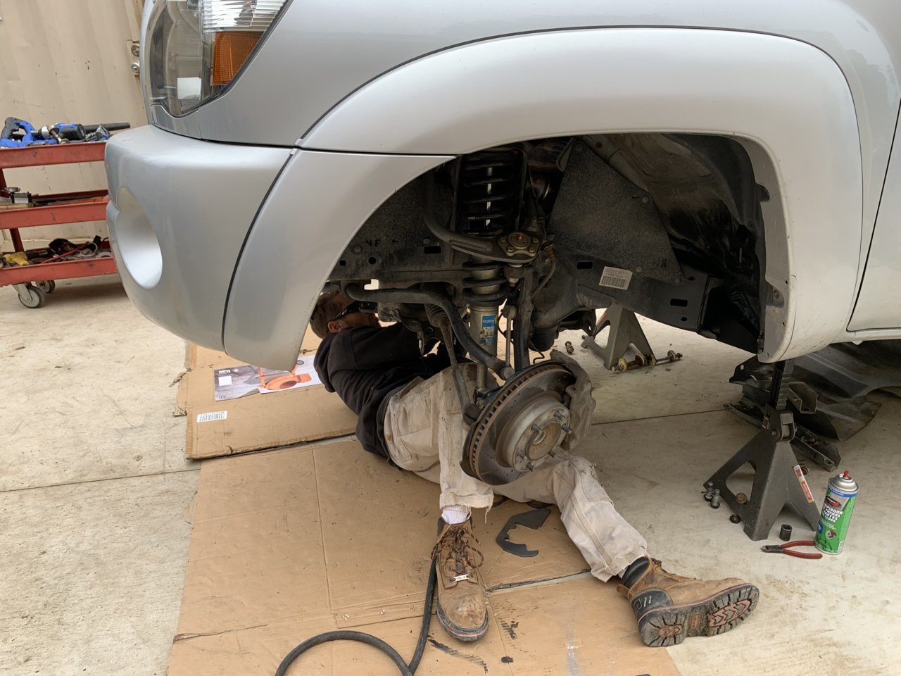

    @Speed Freek Great to finally meet you Jason and get some quality work done on my ride! You persevered through the bad weather conditions and got the work done. A+!!
    I needed a CMC done and the @Marlin Crawler HD LCA Frame Brace Kit installed. Jason had never installed one of these LCA kits before but he tackled the job without hesitation and did an awesome job. While we had the lower control arms off, we went ahead and replaced those as well so I could get new bushings and lower ball joints all at the same time. After an alignment the next day, the Taco is feeling Supreme!
