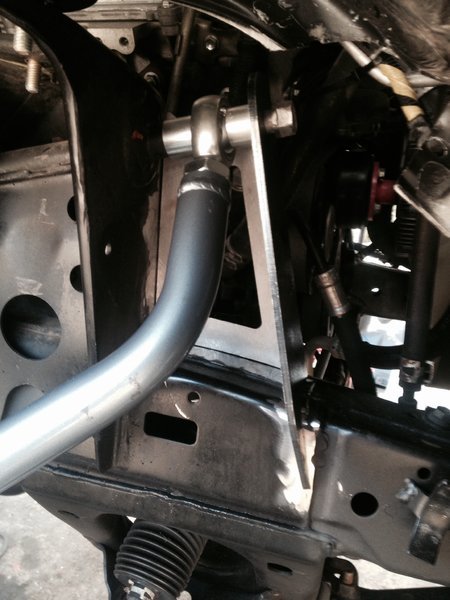

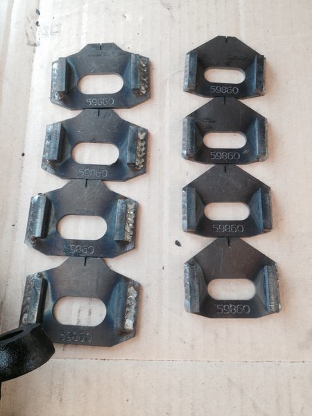

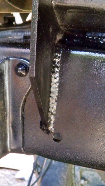

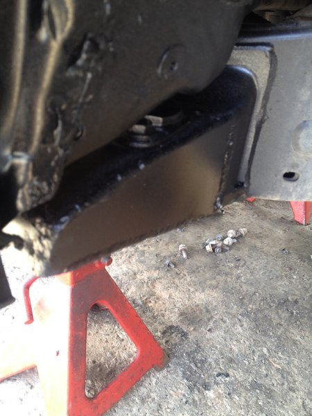

    Yesterday's job, didnt get pics of the whole truck or job but Ill try and get some, it was dark and got finished late but here is what I got when I could!
    Full FOX 2.5 front and rear with adjustable reservoirs, UCAs, Dakar leaf pack, Fabbed in some Cam tab gussets and the race style Spindle gussets, braided lines front and rear, etc...

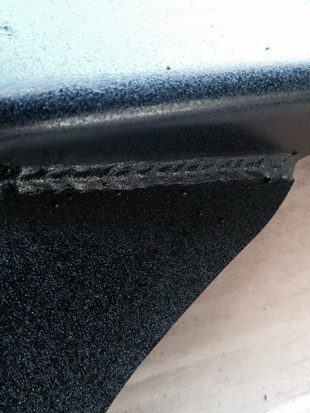

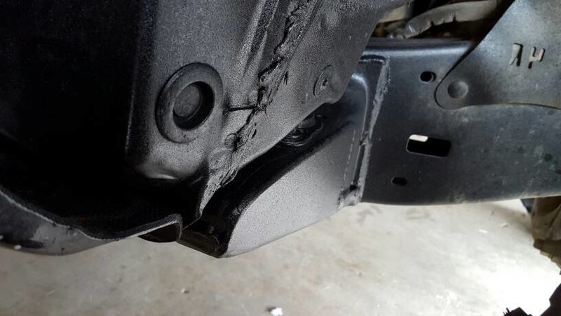

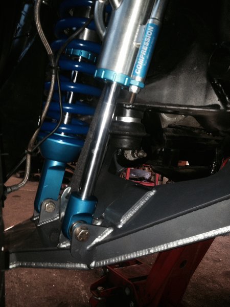

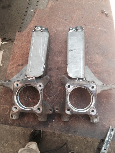

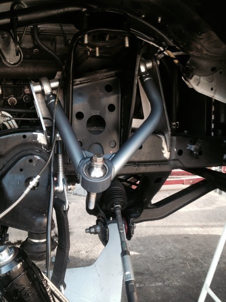

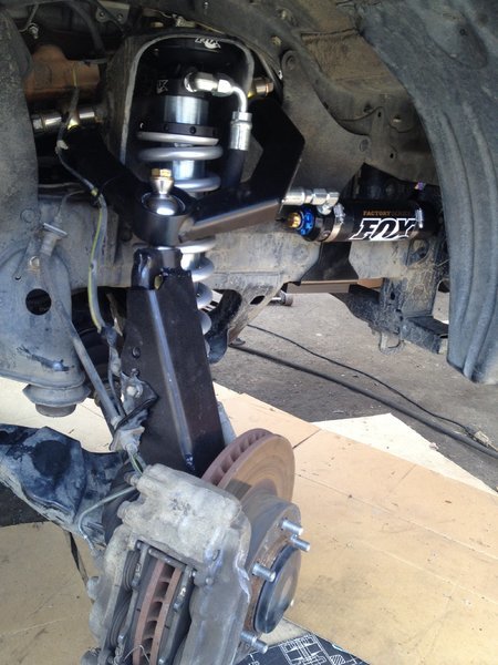

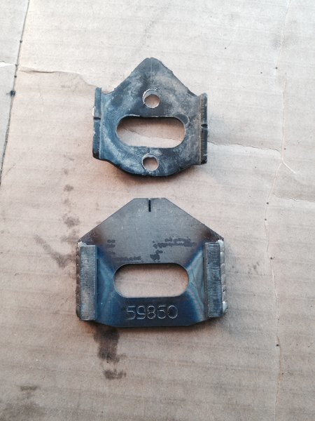

    Just finished up this last night. Pre runner LT setup.
    Fabbed in tower gussets, cam tab gussets, and a rear shackle flip kit, etc...

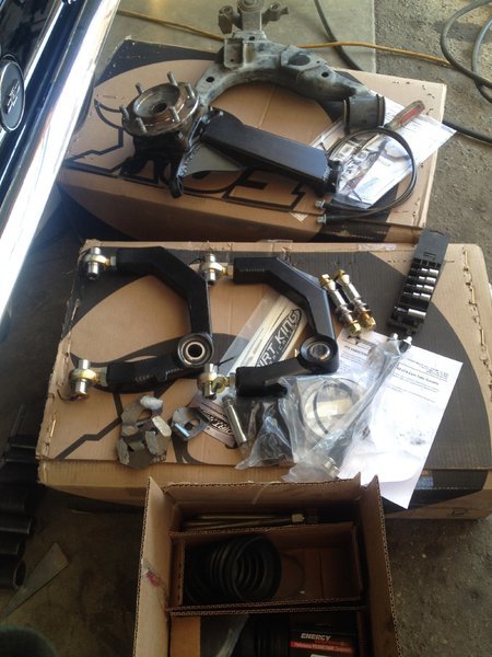

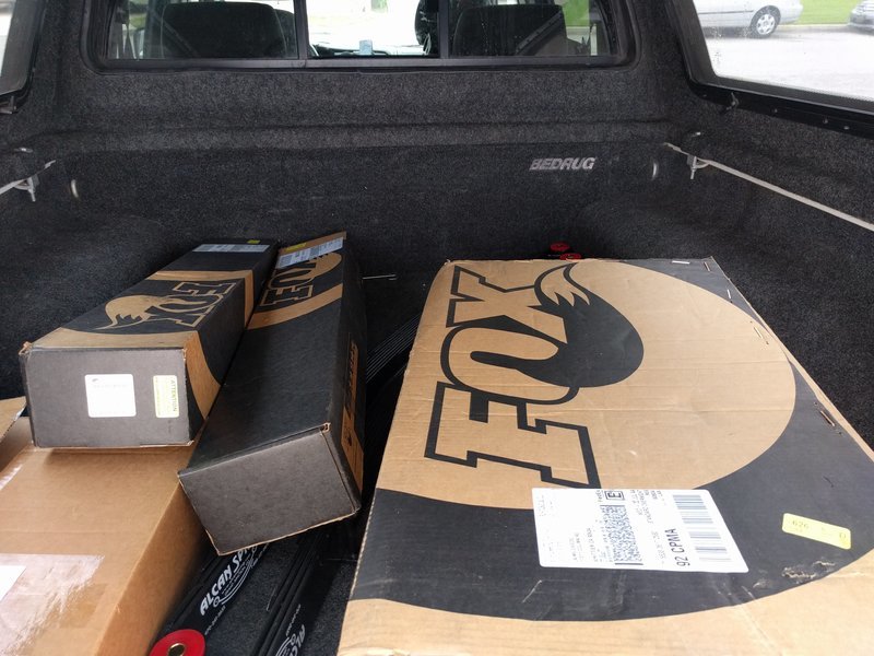

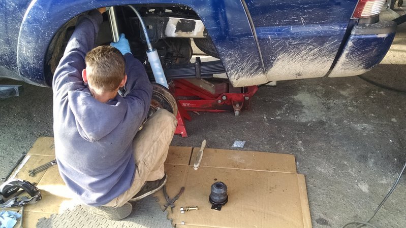

    this was done a couple of weeks ago, just wanted to follow up with pics....
    and that's all the pics I have.

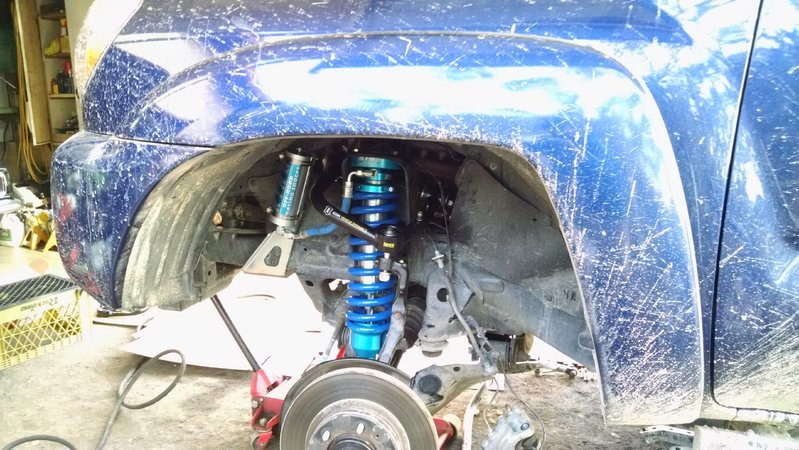

    A tale of a 1.5 day install party:
    Jason's magic struck yet again. What went down? A BAMF shock relocation kit which in and of itself just about takes a full day and believe me his finished product on that makes the mount kit look factory, fresh off the production line. A true welder.
    What else? ECGS clamshell bushing install, Icon UCA's, 12" King RR rears, King coilovers, Dakar leafs, steel braided brake lines, ubolt flip kit, Timbren bumps, carrier bearing drop kit. He certainly gets things done, done right, and at a very reasonable price. It was worth the hotel stay in Escondido and Uber trips to and from his house while my rig was safely out of commission at his pad for the 1.5 days he worked his magic. Thanks, Jason.
    IMG_20160502_173931210.jpg IMG_20160502_170821770_HDR.jpg IMG_20160502_125109700.jpg IMG_20160501_181737261.jpg

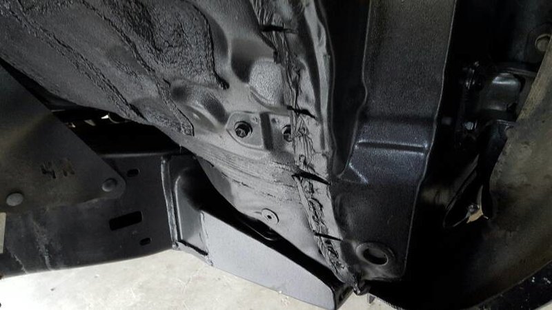

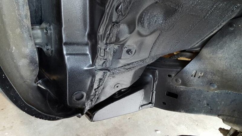

    Thanks Oskar for coming out, hope it all clears well now with the CMC and pinch weld mod, and now you have both your rear brake lines instead of one, not sure what that shop was thinking, lol. They really boogered up that stock flare side and rounded off the head of the flare nut! Glad I was able to get it installed, I cant let you go down the road with only one braided rear line, haha.
    Was nice meeting you and let me know when you are ready for part 2!

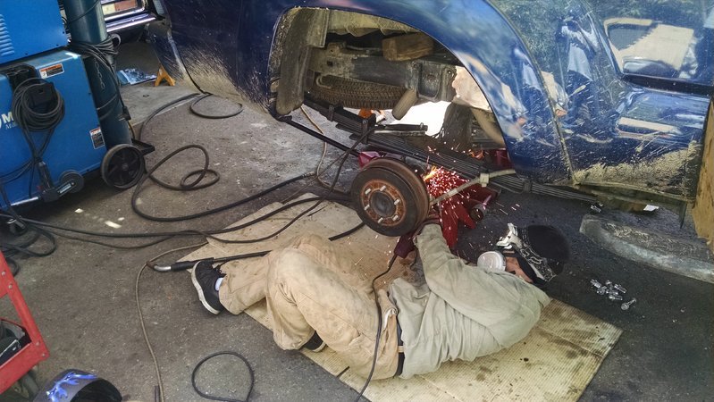

    And on Friday I had to work on a Yamaha Rhino, the rear diff ripped off, had to re fabricate all new mounts and boxed in the frame where the control arms mount and sleeve all the crossbars so the mounts dont rip again. I get quite the diversity in my work, I can fix just about anything, not huge into European cars though...mechanical is fine but diagnosing odd issues can be daunting!
    Tomorrow I have a Chevy fullsize truck for all 4 front balljoints, uppers and lowers.

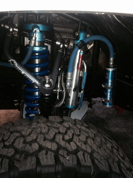

    For sure, you beat me on posting lol. You did a great job, I'm glad I took my truck to you for that job. I'll be in touch for part 2. It was nice meeting you. Thanks again.
    uploadfromtaptalk1463422611384.jpguploadfromtaptalk1463422614746.jpguploadfromtaptalk1463422623447.jpguploadfromtaptalk1463422670731.jpg
