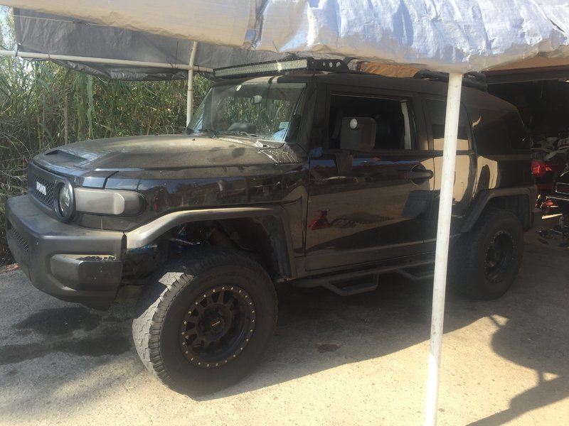

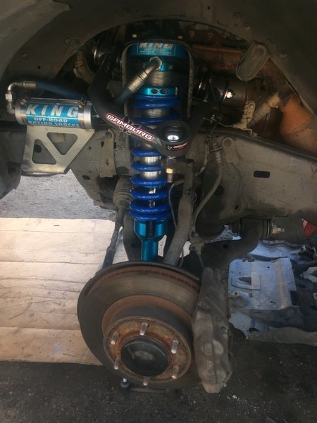

    Here are the photos i took.

    :thumbsup: Good looking FJ! Good pick on going with Jason! He's always a solid guy to get work done with!

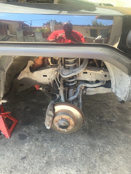

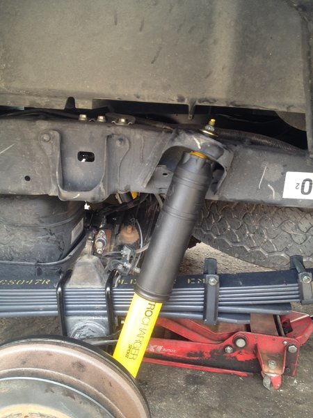

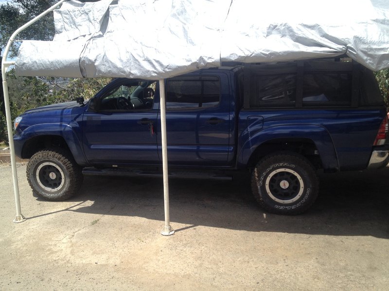

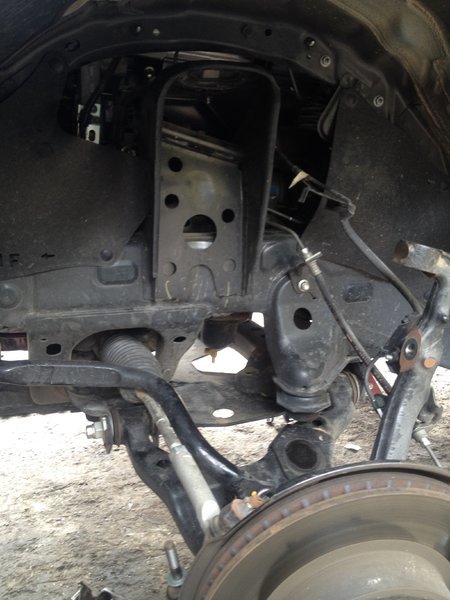

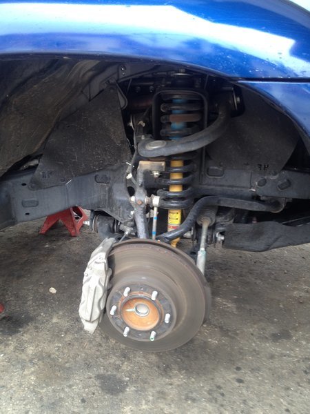

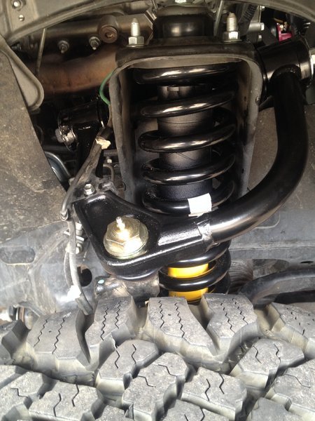

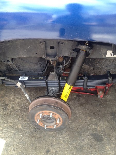

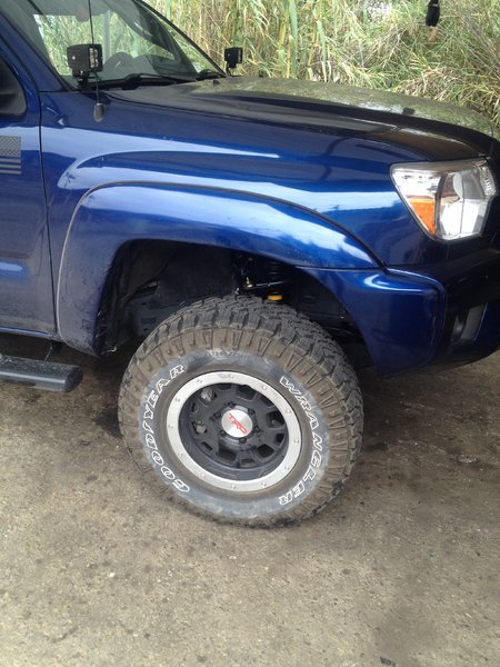

    Did a lift today, OME 3" and Dakar spring pack. Came out great!!
    Thanks for choosing me for the service, I go the extra mile grinding lower mounts for shock body clearance, greasing all bushings inside and out, tightening all the spring bolts when at ride height to make sure there is no weird spring preload ( the front spring bushings are molded to the spring so they have a limited amount of twist and they always try to go back to "home" position).
    It's all these little things that I do that make the difference! And it's attention to detail that keeps my customers coming back and hopefully recommending my work to others.
    Anyway here's what I did this morning!

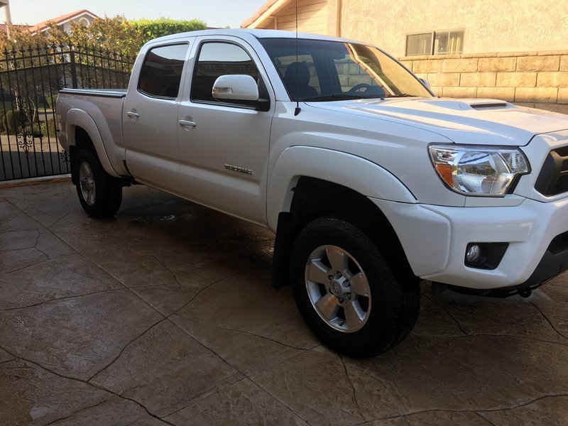

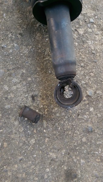

    Did another OME lift on Monday, this one really needed it stock shocks, were completely blown and the lower bushings on the front coilovers were totally smoked! Definitely was time for an upgrade..
    Did the OME 3" kit with full leaf packs, I stole this pic from his post but Ill upload some of my own from my phone later on.
    If anybody needs lifts or other work just let me know!

    Holy shit! Yeah that bushing is toasted!

    Yeah, it was beyond done..

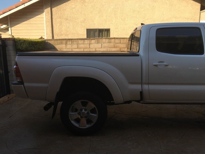

    Just wanted to give Jason another 5 star positive +++++ review.
    was on the fence of using a local tire shop which would have been cheaper. but still couldn't trust that the job would have been done correctly or with hidden cost.
    jason took care of my baby and answered all my questions.
    ended up removing one of my overloads since i currently dont run any added weight on the bed and she sits good and level on the eye.IMG_0471.jpgIMG_0472.jpg
