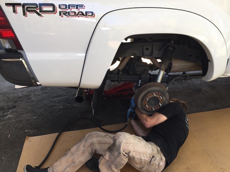

    I installed a snorkel into a 1st gen this morning, turned out great although those dang nuts and washers can be difficult to get to back behind the fender when doing the final tightening! Just takes some time and trying to fish out the nuts and washers when you drop them into the inner fender, haha.

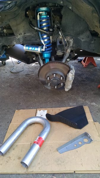

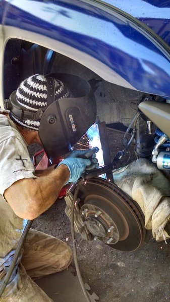

    Thanks, Jason. Kick ass job as always today!
    TC spindle gussets, exhaust reroute, bamf LCAs

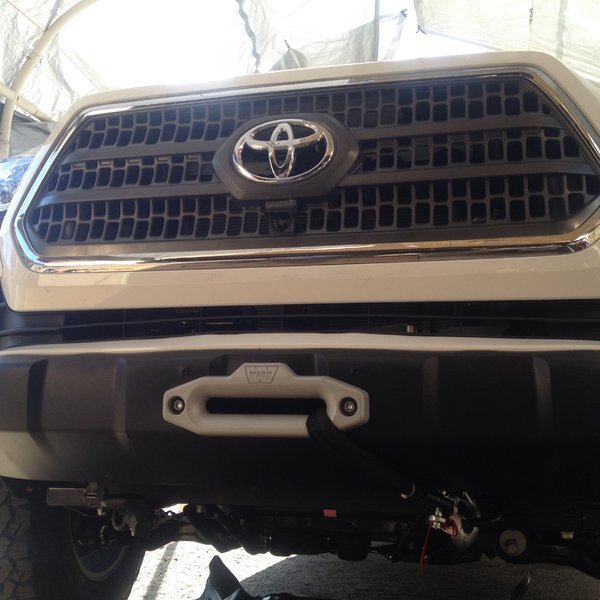

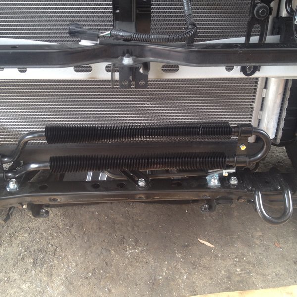

    Here's the Hidden winch setup from Pelfreybuilt that I installed last week, this pic shows the small brackets that relocate the P/S cooler rearward for more clearance
    Here is a shot of the setup without the bumper during install (you will remove the discard the stock crash bar)
    A pic of the finished product, pretty awesome having a full sized winch behind a fully stock looking front bumper, keeping it looking unmodified and saving money if you dont want/need a bumber.

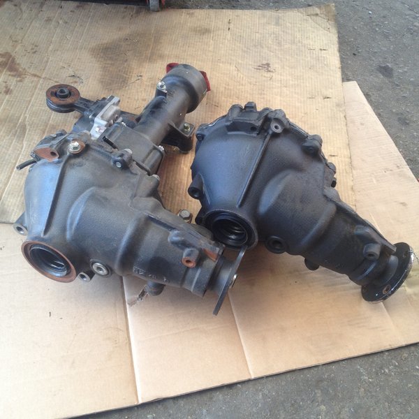

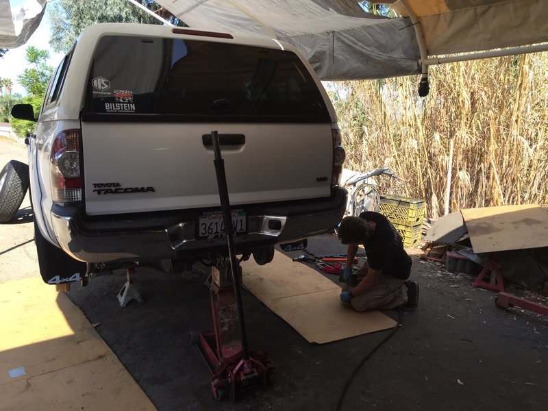

    I replaced front and rear stock 3rd members with a pair of ECGS pre-assembled units equipped with ARB lockers with 4.56 ratios front and rear. Turned the truck into a Hot Rod! Still need to install the OBA system with air tank and gauges, Ill be sure to get pictures!

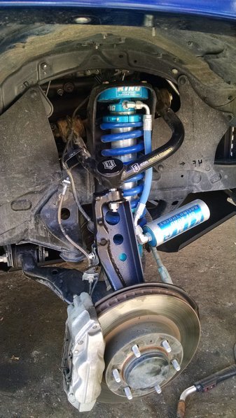

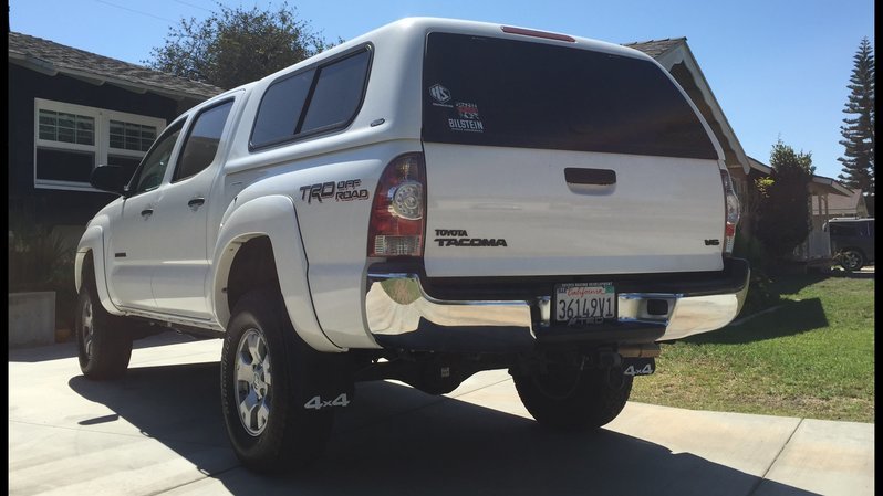

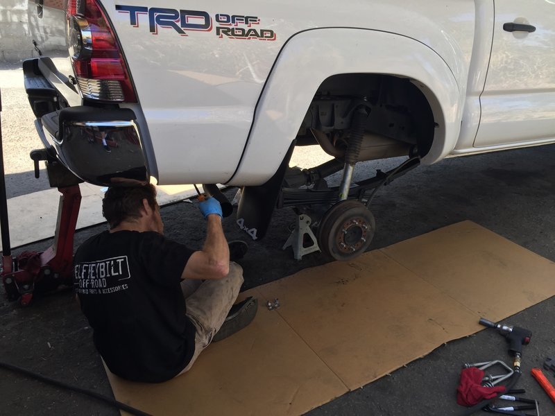

    Another job I did a couple weeks ago, I just stole the pictures from his thread, ha. Mainly because I didnt take any (Again)
