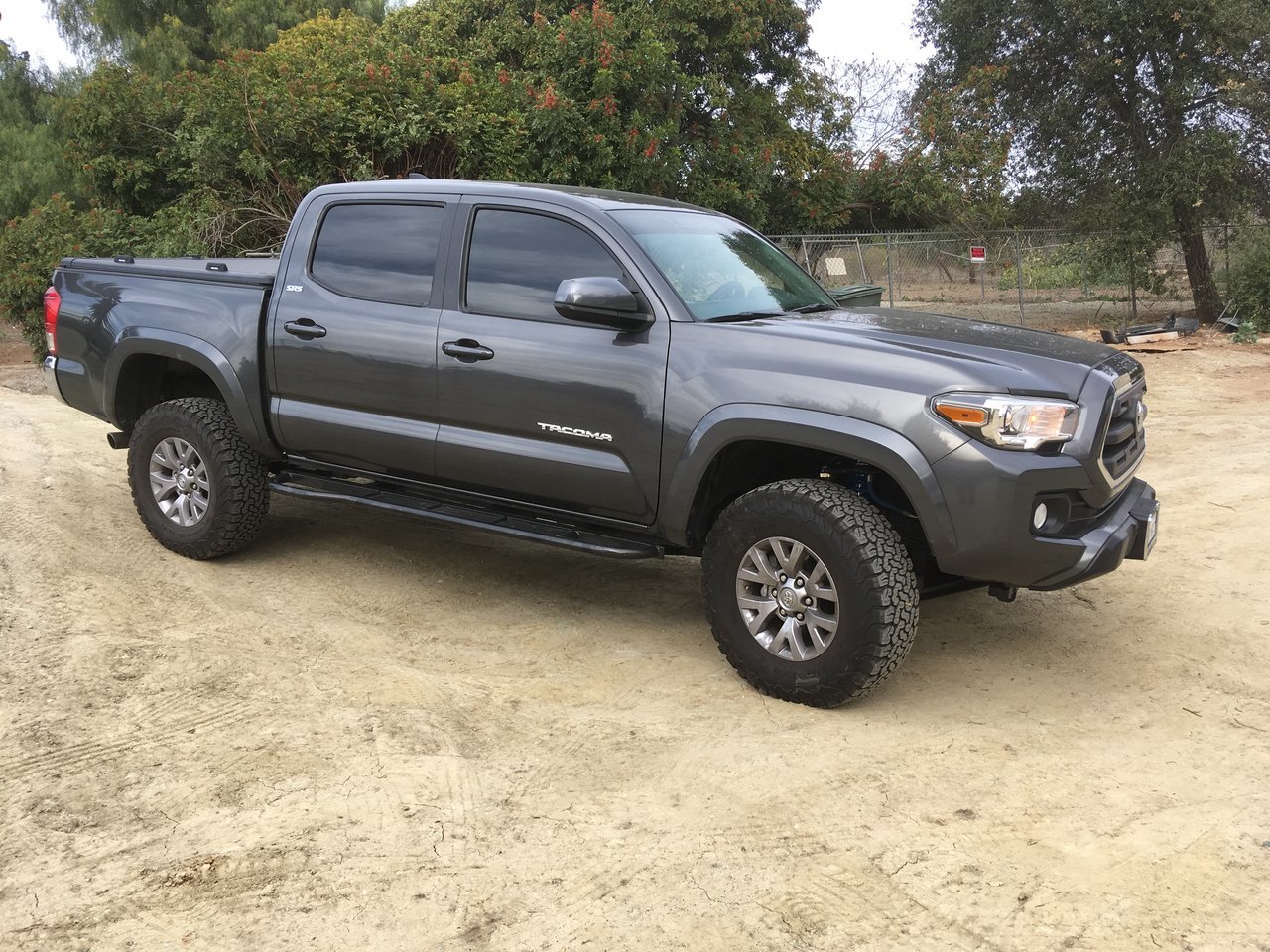

    Some pics of stuff!! I have about a million pictures I have yet to post!

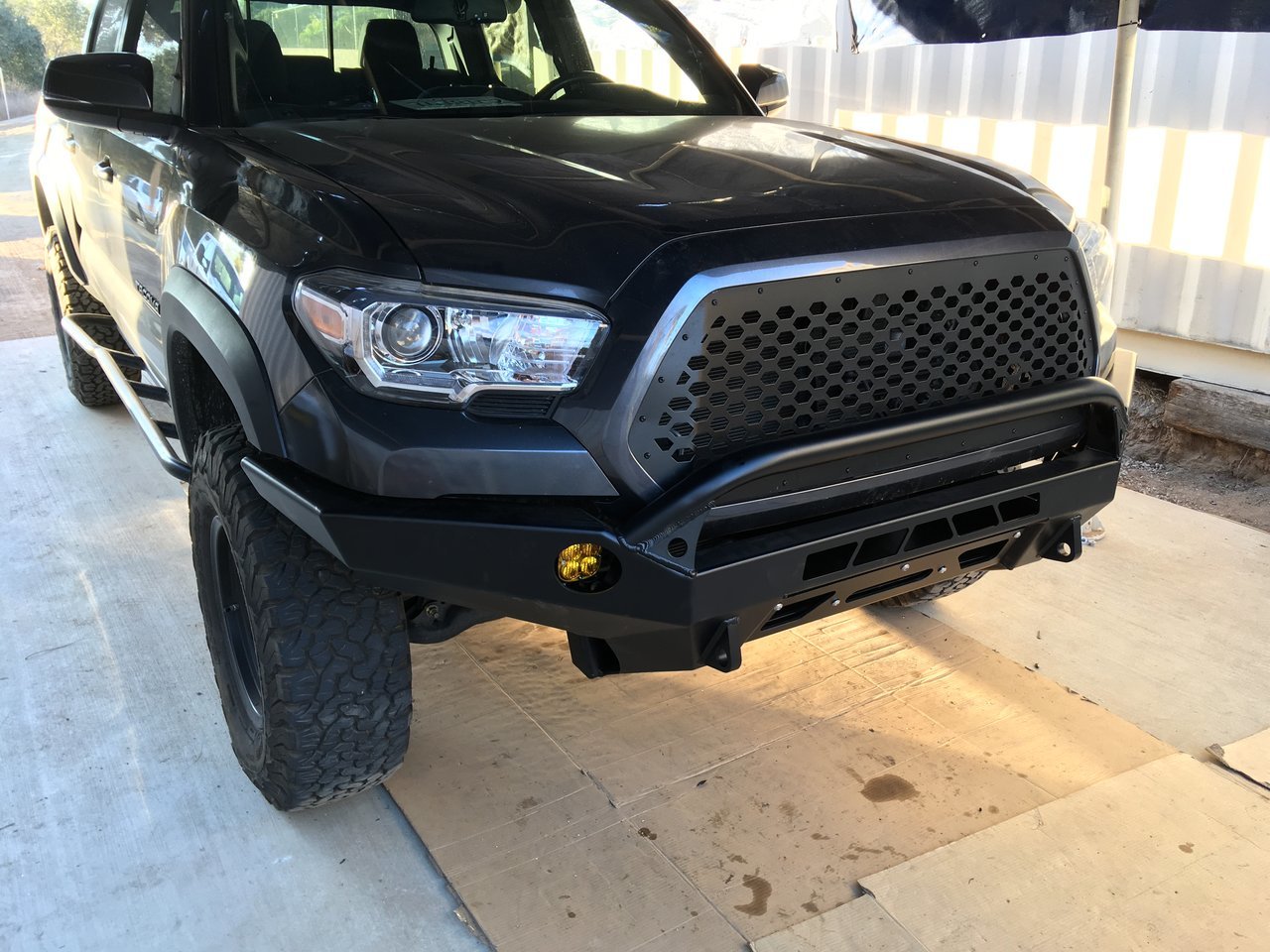

    IMG_5866.jpg Front bumper on a 3rd gen, looks pretty slick and low profile..
    IMG_5871.jpg A super custom CMC for an FJ with 35" tires!

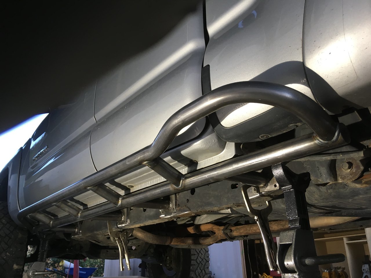

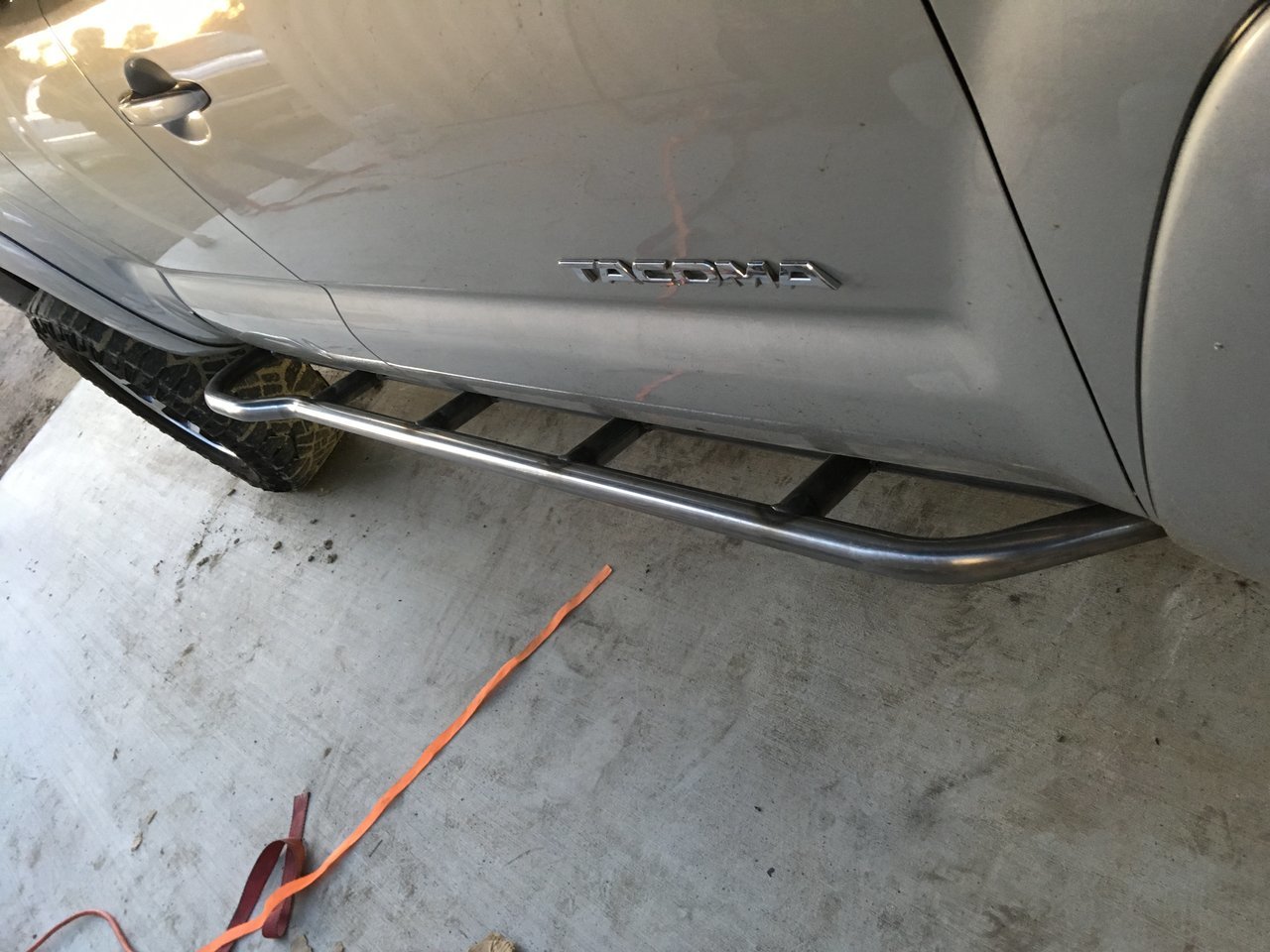

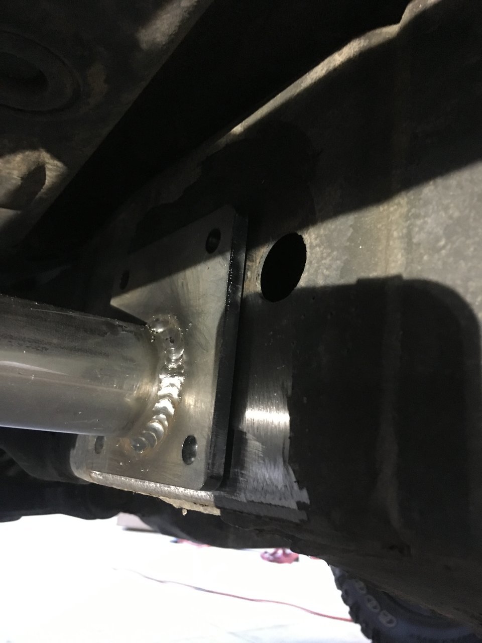

    A DIY Slider kit I welded on recently. Came out great!

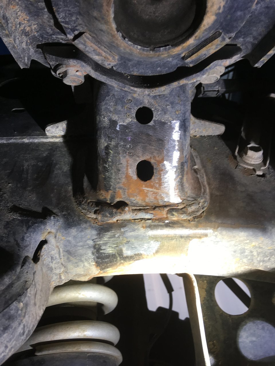

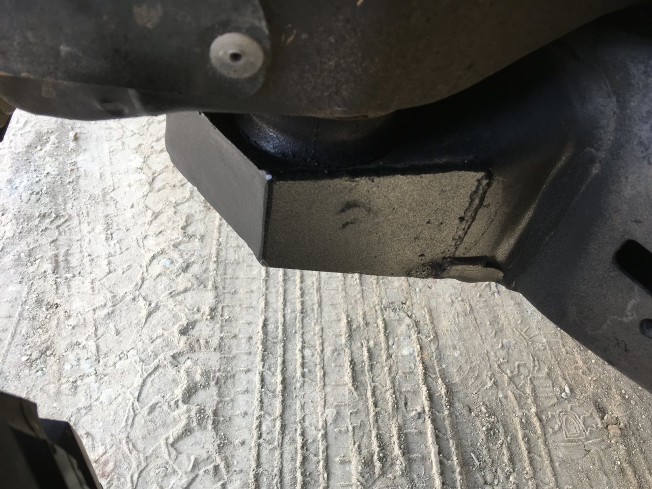

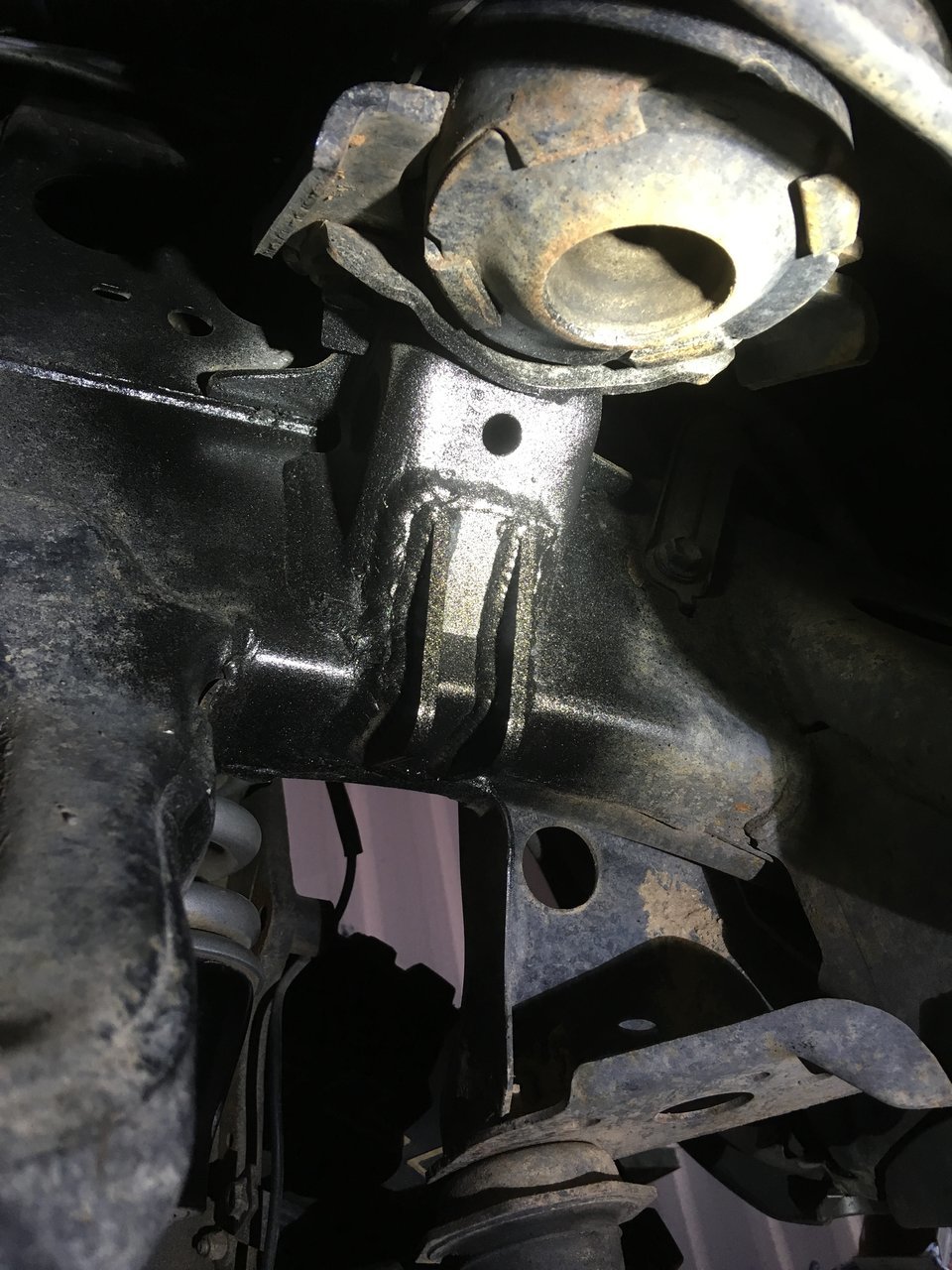

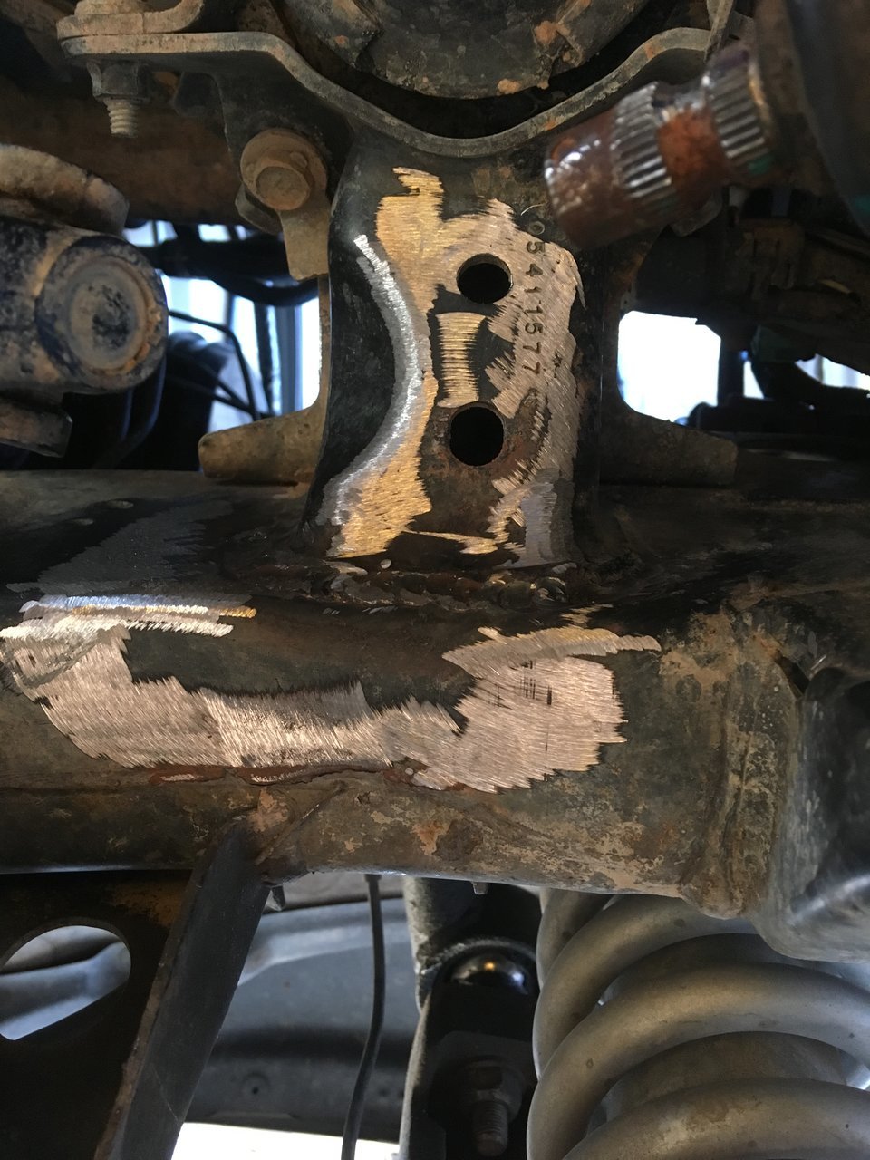

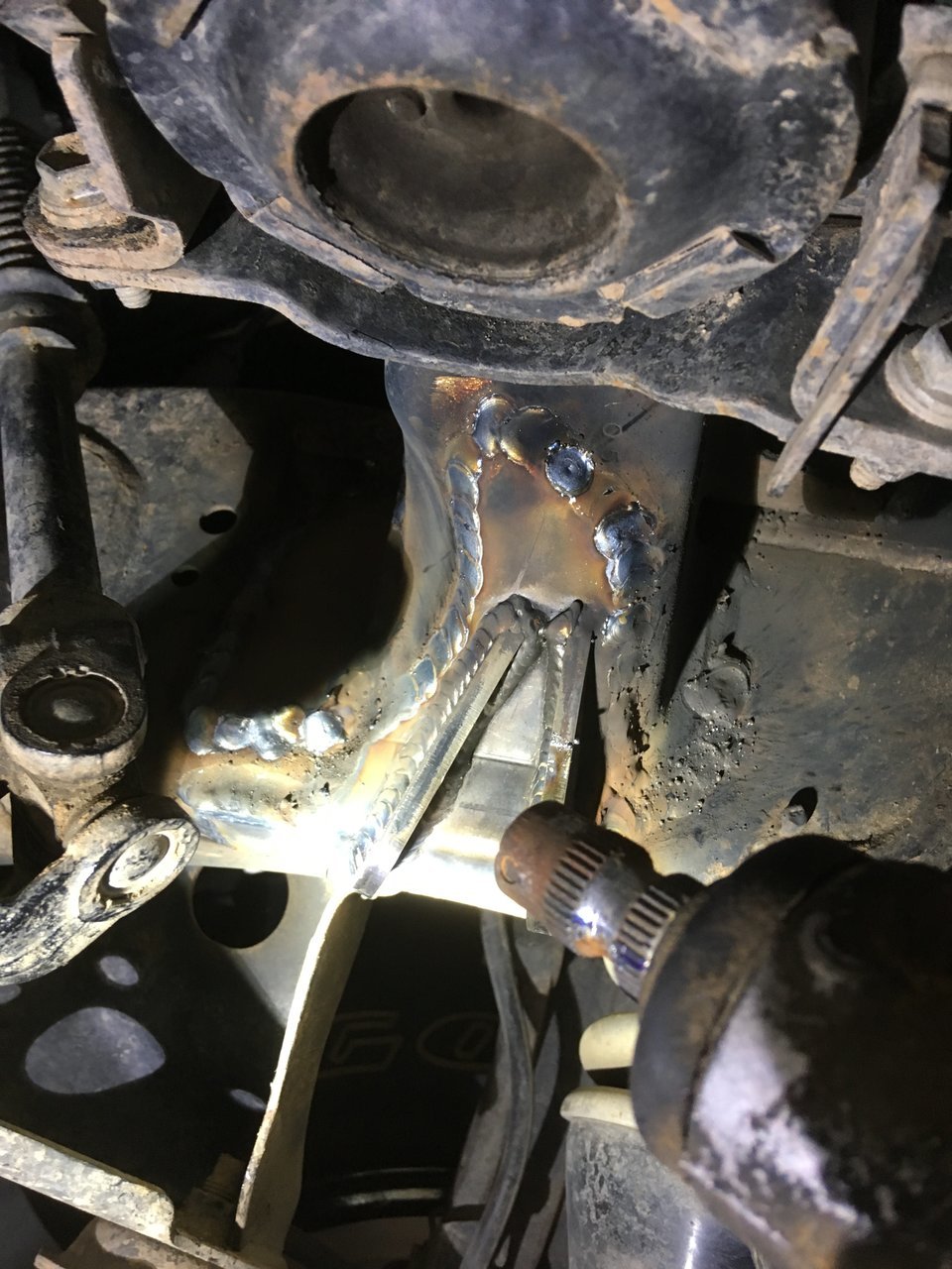

    The dreaded 05-06 Frame perch failure, repair and gusseting, now we know it wont ever happen again. Been doing a few of these lately!

    Did you make those sliders also? They look nice.

    Thank you, but not really, it was a kit that needed to be welded together and you can adjust the strut length and slider angle before finish welding. I was just the monkey welding them together! But they do look pretty nice.

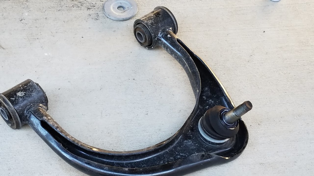

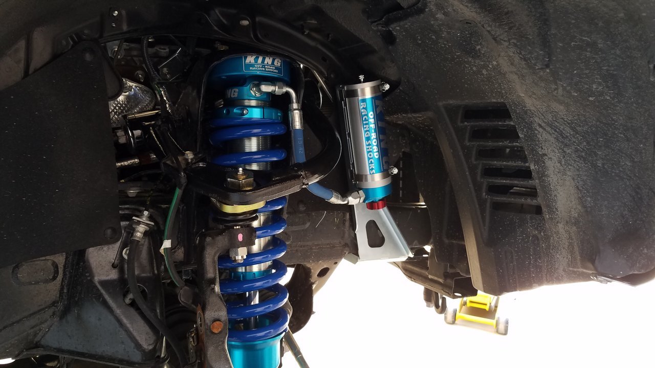

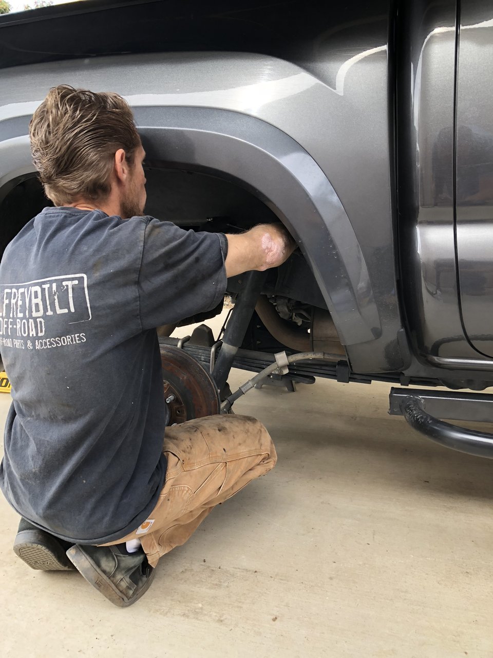

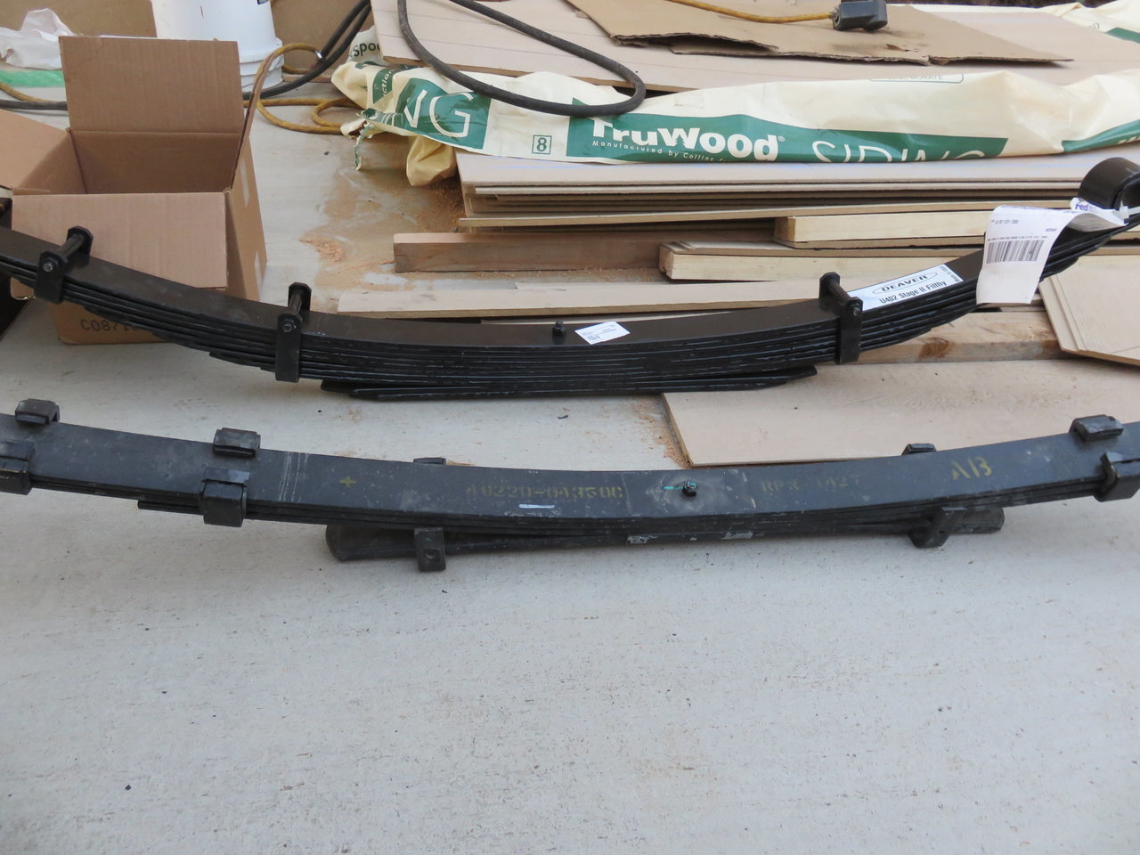

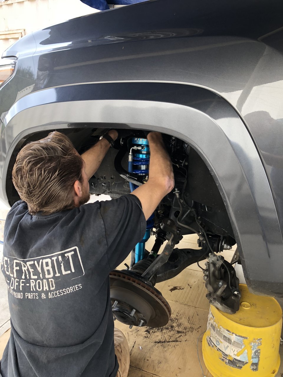

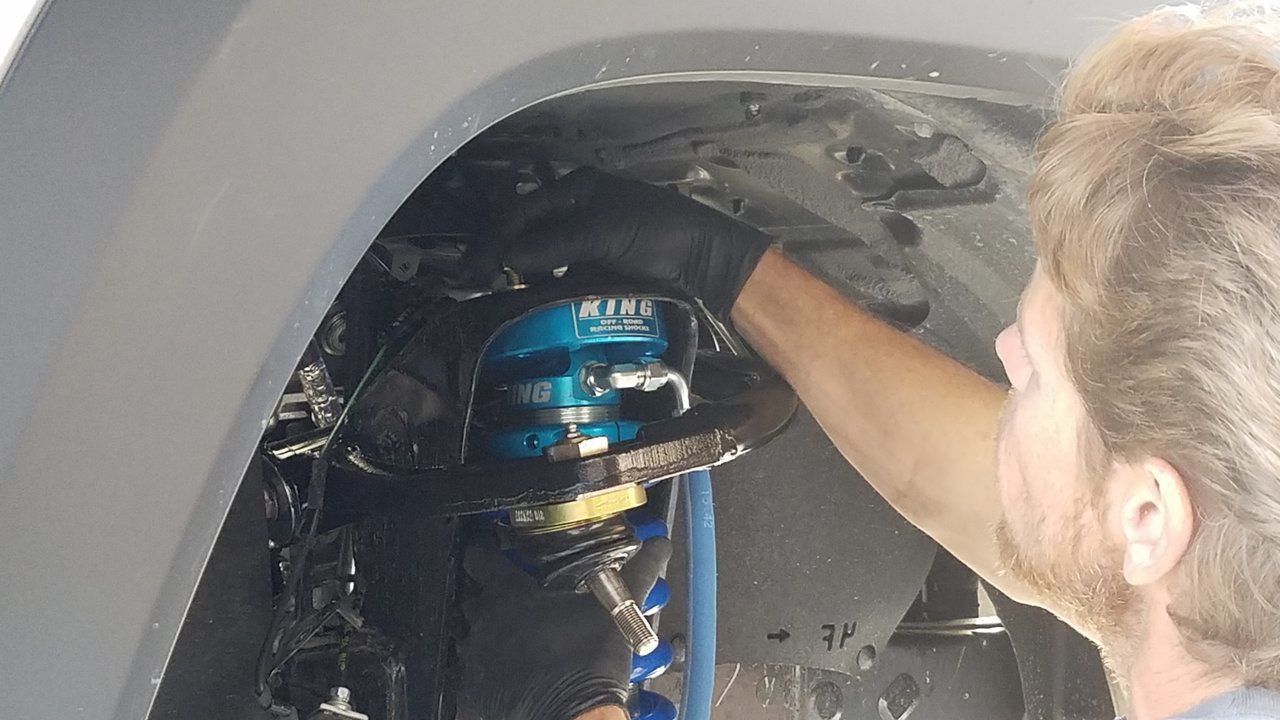

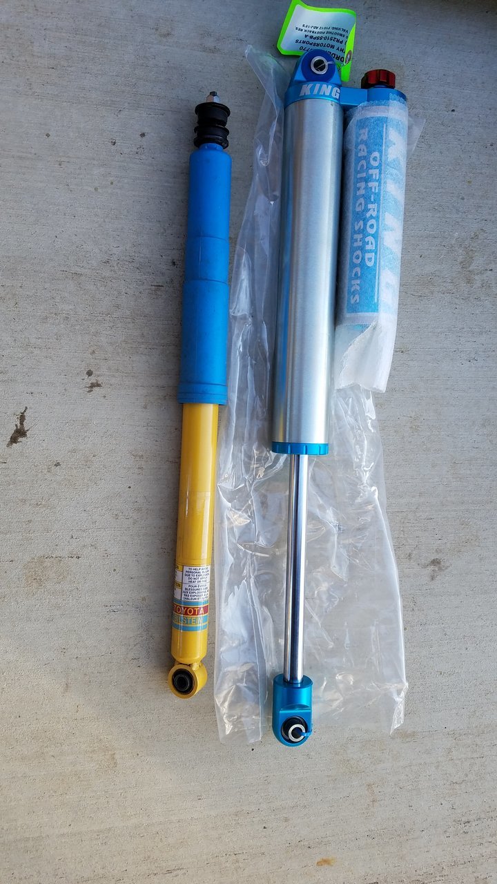

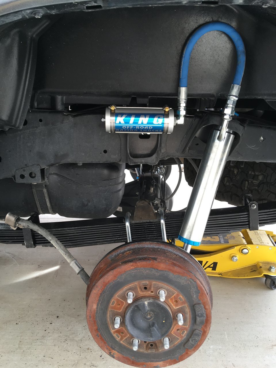

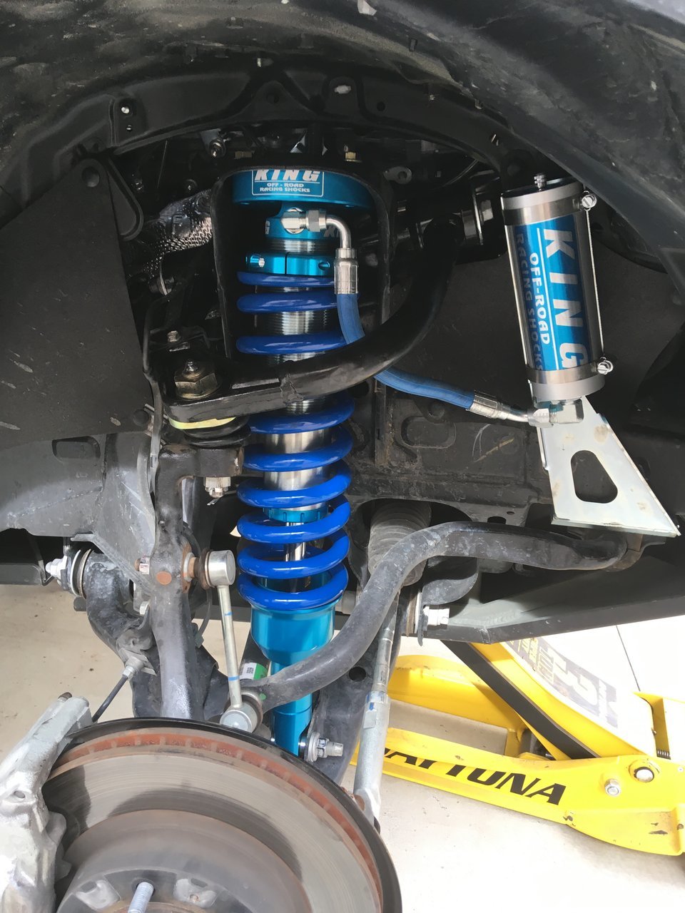

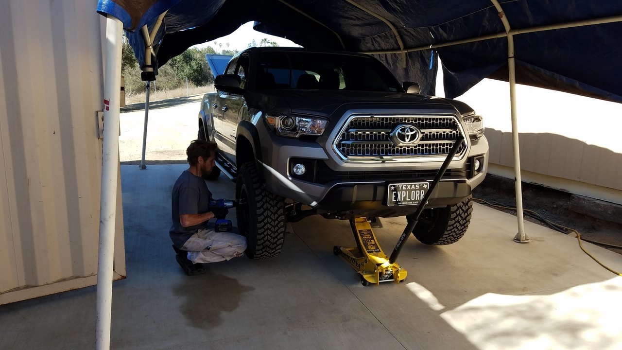

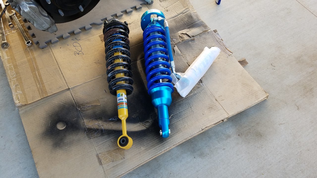

    Did a full install including the ECGS bushing front and rear Kings with reservoirs, SPC UCAs, Deaver leaf packs and carrier bearing drop yesterday.

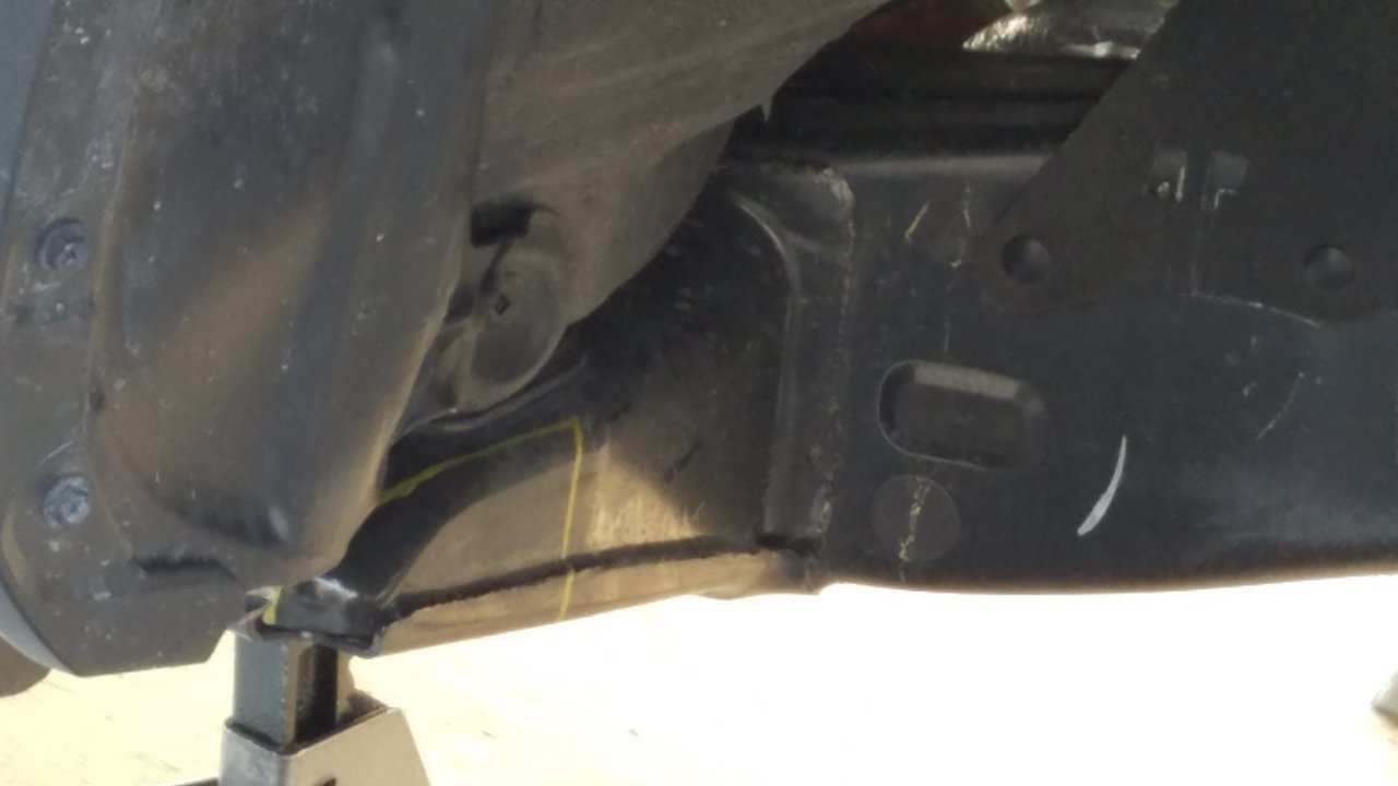

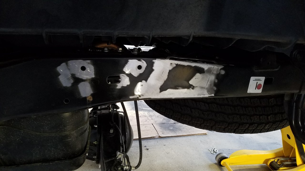

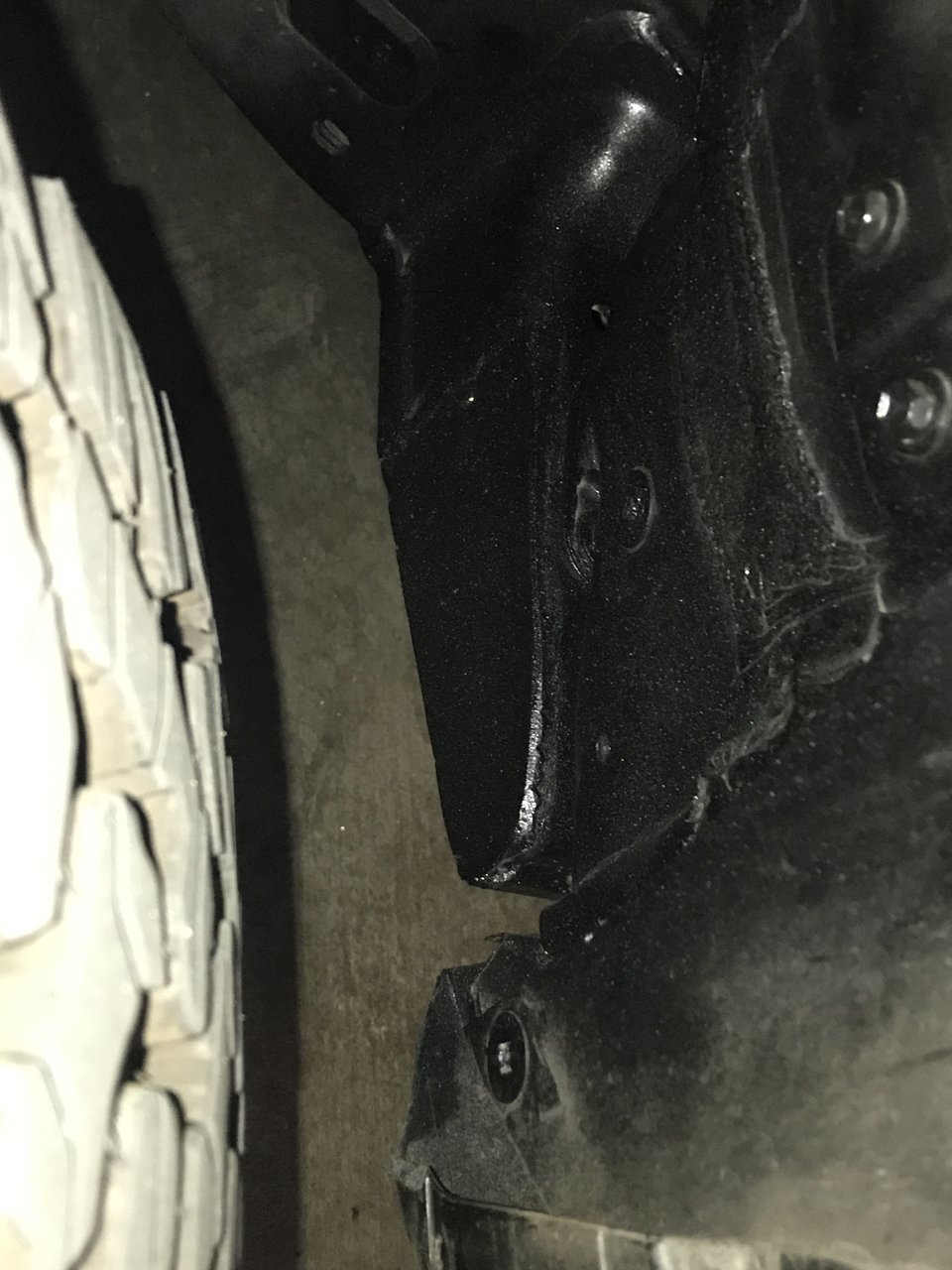

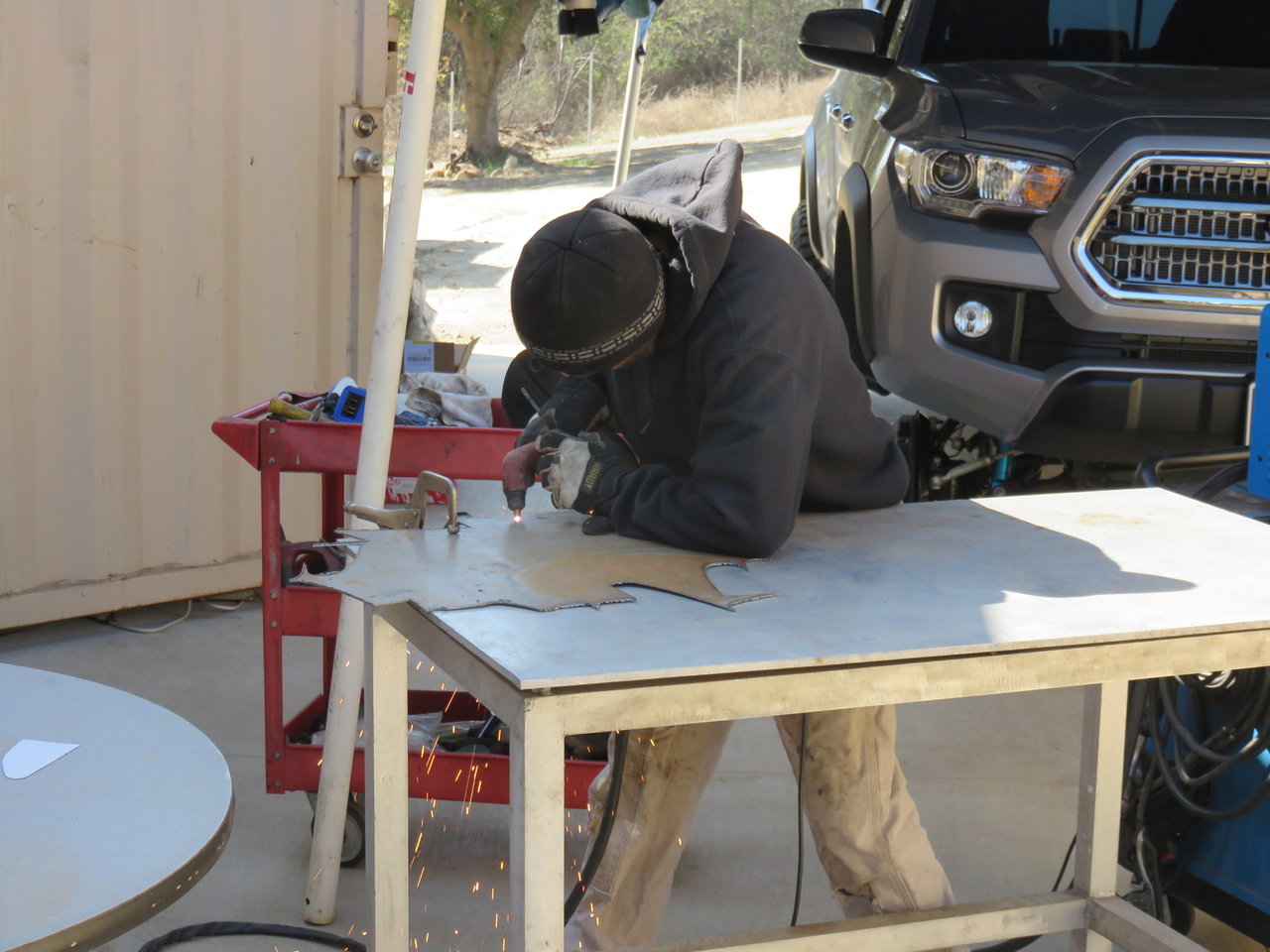

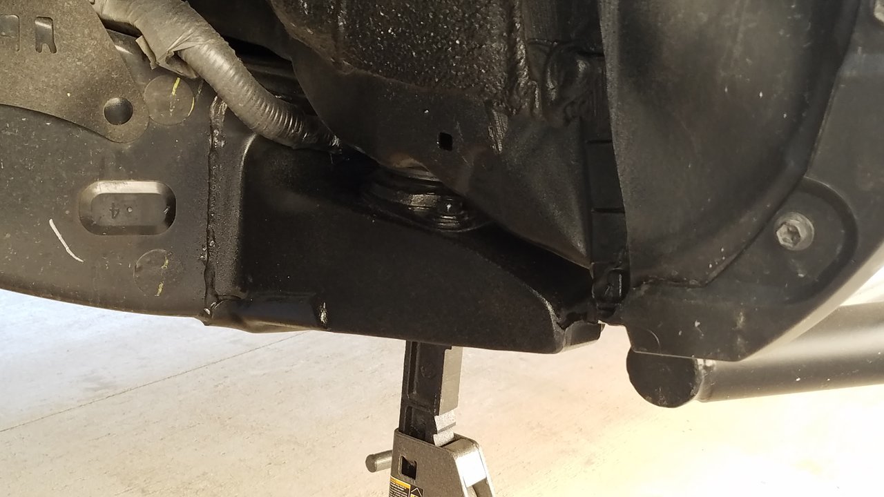

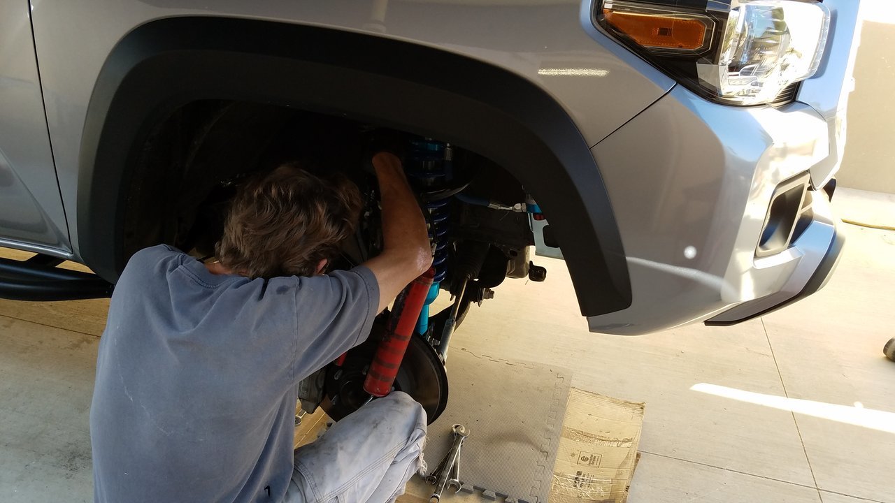

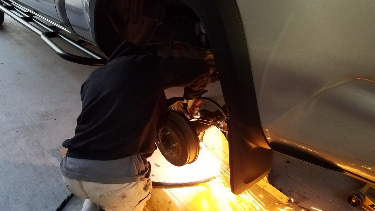

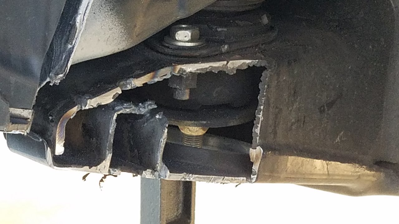

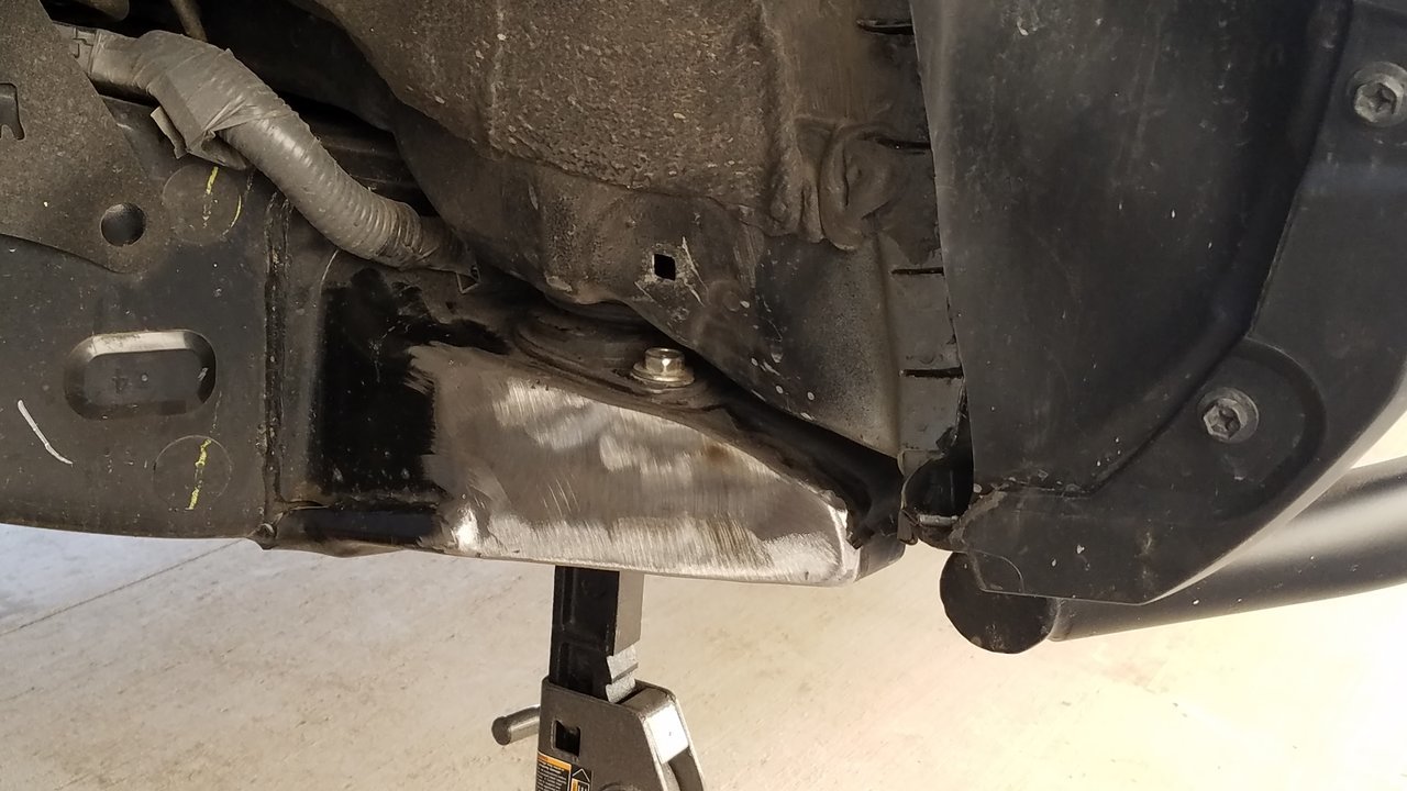

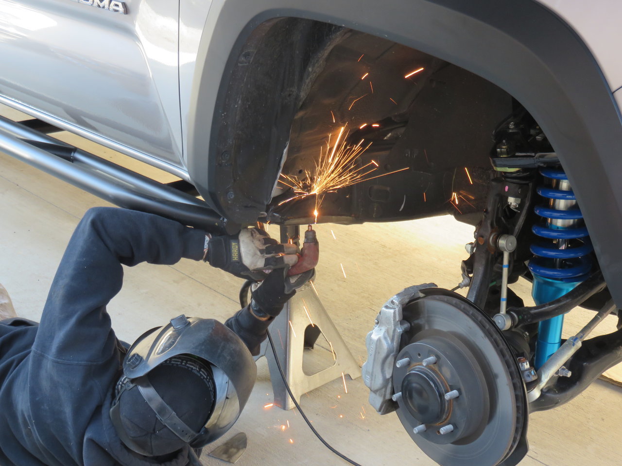

    Jason @Speed Freek has been busy today.............He got the front done with the CMC and got a good start on the rear before the dark. I can not say enough about the outstanding job he does. His attention to detail and quality of work is the best I have seen. His Cab Mount Chop looks like it was done by Toyota at the factory..........

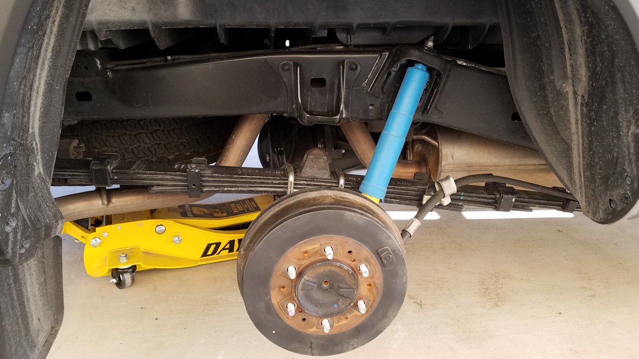

    Fox coilover shocks with reservoirs, Camburg UCAs, Fox rear shocks with reservoirs, and the Icon RXT Leaf Pack
