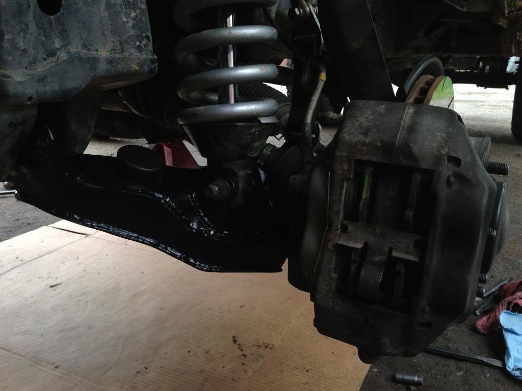

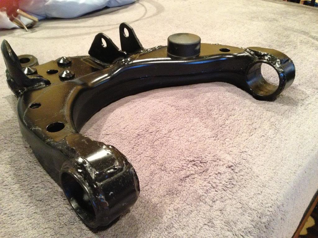

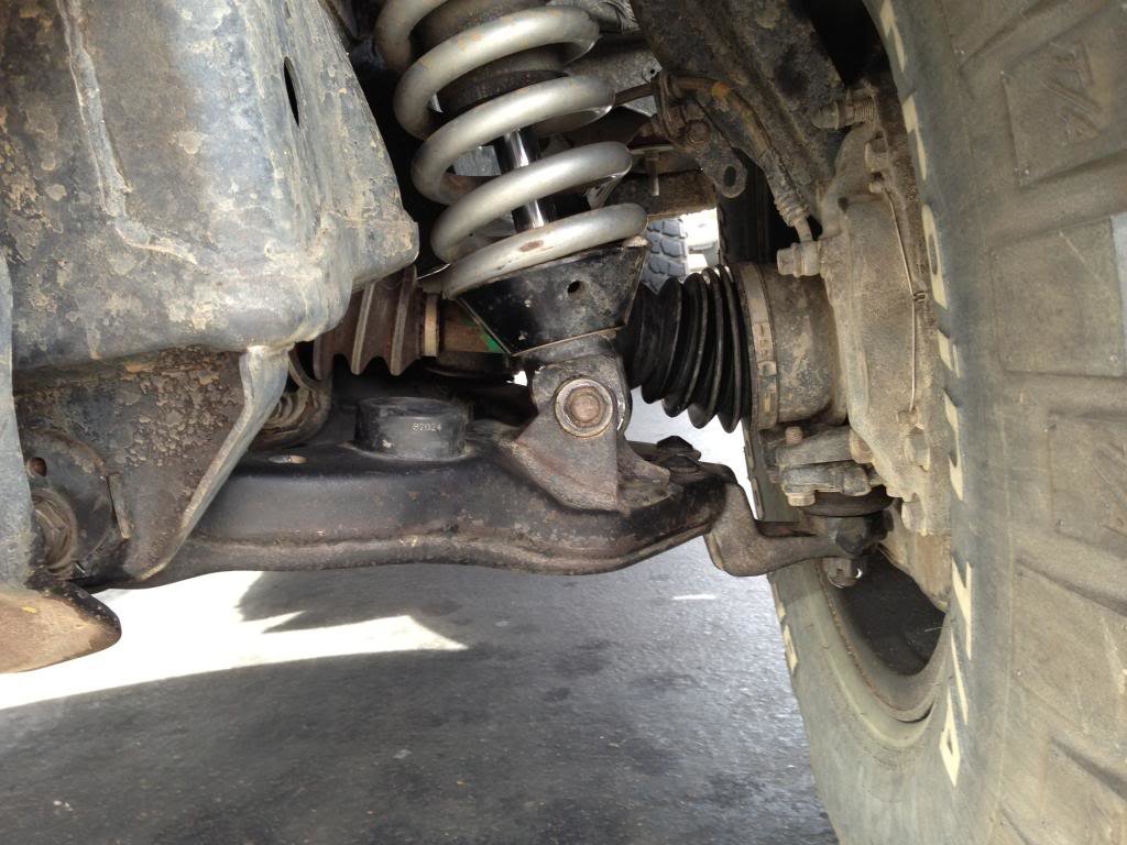

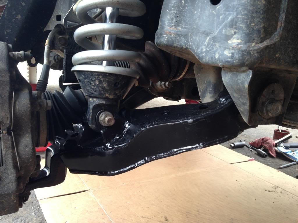

    This happened today.
    Have to order new bump stops from energy suspension directly cause its a factory replacement part that NO ONE stocks in San Diego.
    Jason replaced the old stock lower arms for some that have been modified to be stronger and have brand new OEM bushings installed.

    Prepare for a long day, lol. Bring something to do, the rear kit takes a long time and tons of grinding and cutting, gotta pull the bed, etc. But I can have it done in a full 8+ hour day.
    Hey, thanks for the pics Micah, ready for some desert action now, now you got the goods, lol.
    Glad we could get it on the 2nd time around....damn bushings. Does it feel any different due to the new bushings?

    Actually yes, its smoother and more responsive.

    Awesome! Glad it feels better after the swap. Dont have to worry about bending those suckers.

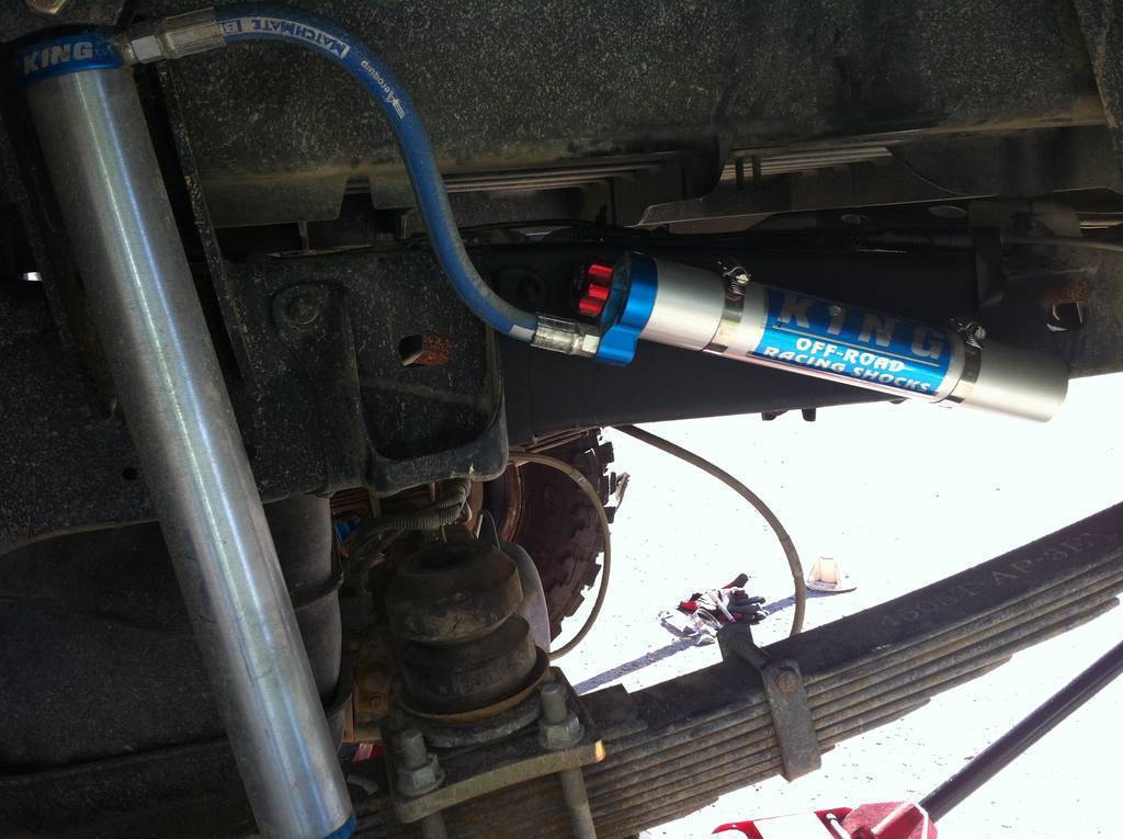

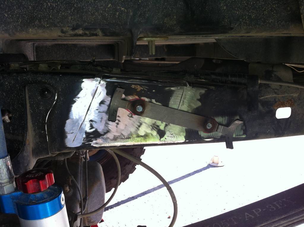

    Visited Speed Freek today for a quick wrap up of the rear suspension with some resi mounts :D
    I bought this set from Poly Performance by Synergy: http://www.polyperformance.com/shop...Bolt-On-2.0-Reservoir-Mount-Pair-p-25984.html
    They have some different options too:
    http://www.polyperformance.com/shop/Synergy-Suspension-Weld-On-Reservoir-Mount-Kit-p-783.html
    http://www.polyperformance.com/shop...Weld-On-2.0-Reservoir-Mount-Pair-p-25986.html
    Here is the finished install, thanks again for superb work Jason!

    David, are those Ride Rite or another brand of air bags I see in the photos of the rear King shocks?
    I still have my Ride Rites (in a box) that were installed on my '05 for the 'Harsh Ride' issue (bottoming) my dealer (Toyota Carlsbad) refused to fix (asked from 2005-2007), so in 2007 I dished out money to Off Road Warehouse for the Ride Riites and Bilstein 5100s in the rear... worked like a charm! My 2010 (Dec. 2009 +) does not bottom out (yea, better springs, but still just 3 leafs)... so I never re-installed the air bags, but have them, just in case!

    Absolutely Jason, your work and prices are great! Unless that nick on my frame starts growing.... :devil:
    Pretty sure they can get something similar. These were supposed to be for Fox, but any 2.0 mount should work fine
    They actually aren't bags, they are Timbrens
    I never even attempted much on my stock non-TSB springs, went straight to a progressive pack instead of AAL.

    They looked different, but I thought I saw an air tube in your photo! LOL Thanks!

    oh yeah, those are the rear brake lines. One of them kinda looks like it connects to the bump stop but it's an optical illusion, they are about 12" apart.

    The Truck Shop stocks poly bushing sets for both 1st and 2nd Gens for factory LCA replacements. $50 a set, just incase anyone else needs them and asks you Jason. Save a few hundred over dealers for what Micah paid.

    I have the bushings, its the sleeves that no one sells
