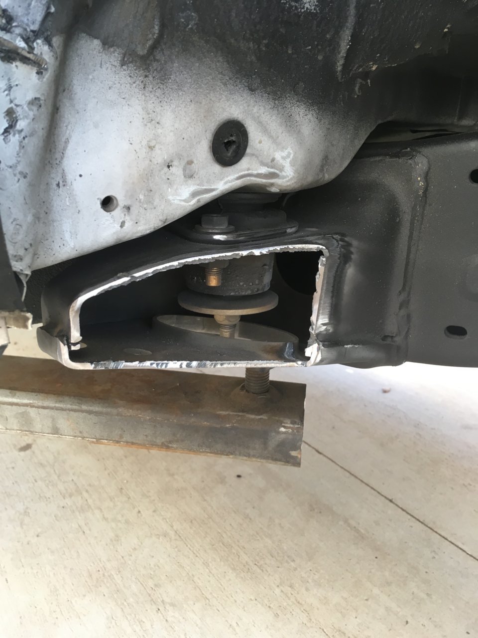

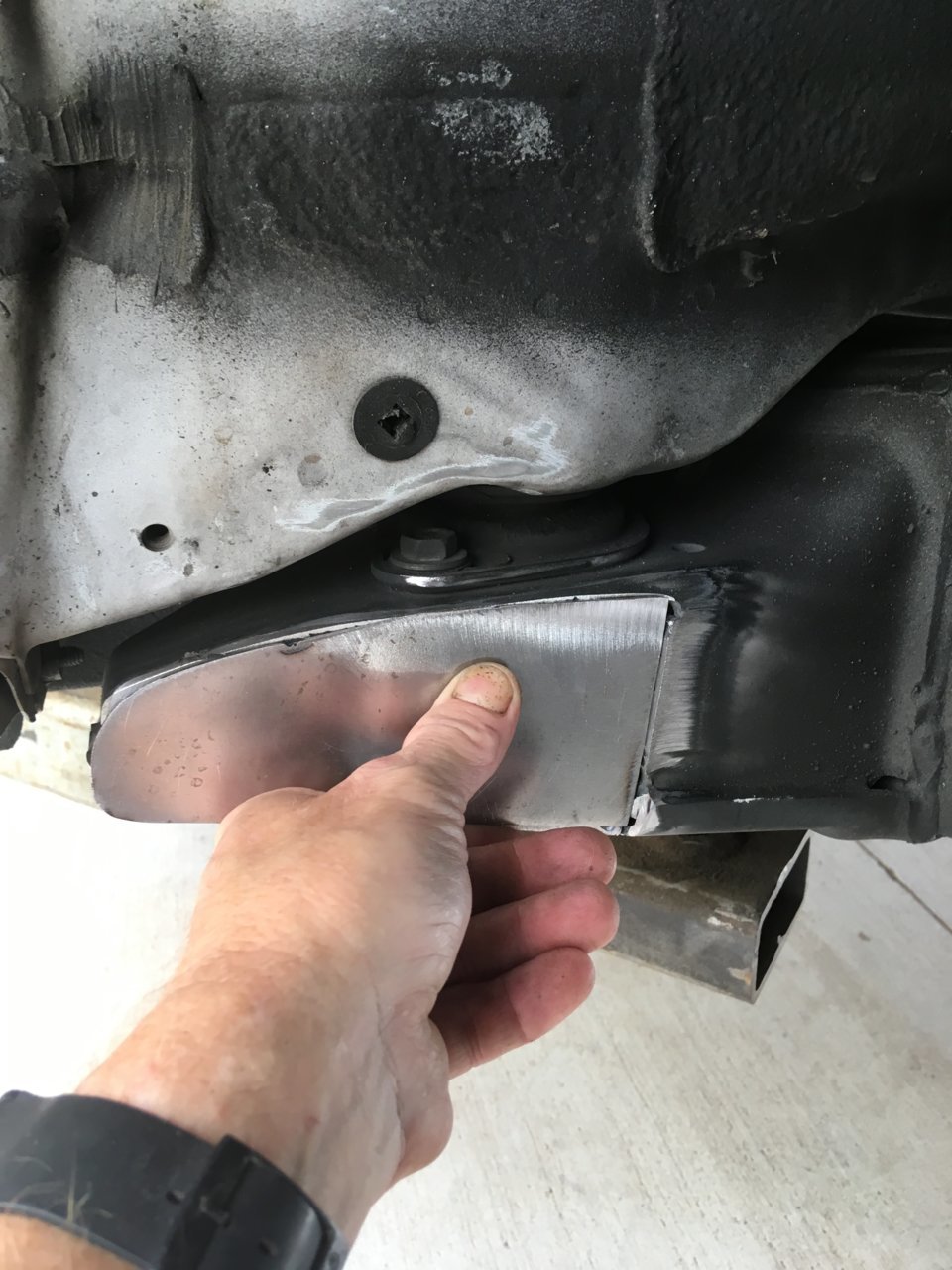

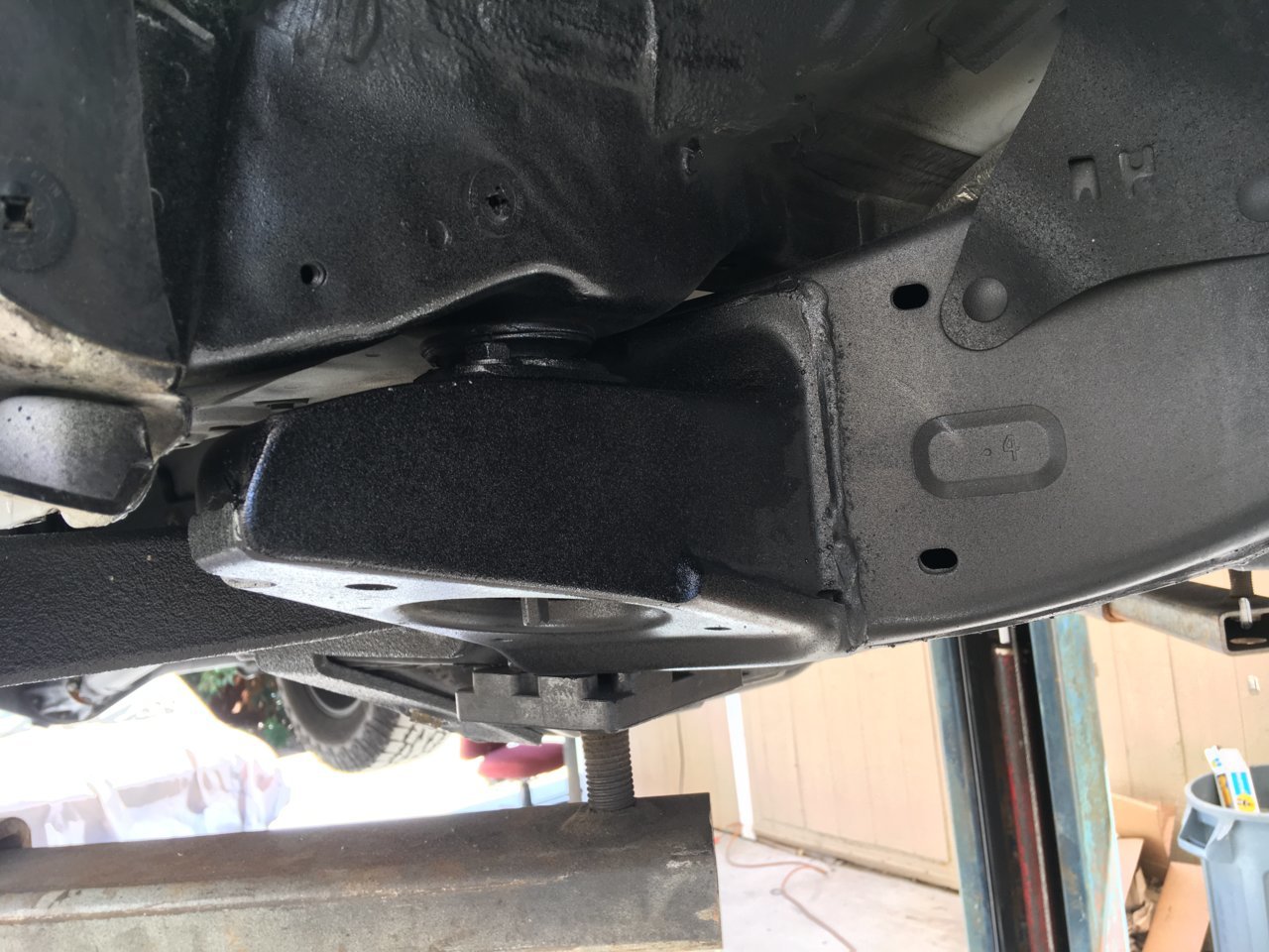

    One CMC out of 7 I've done in the last couple weeks. Must be season, people are getting their rigs all dialed in for playtime, lol.
    Figured I would give a picture of the stages of work and how I do them. I try to keep them as stock looking as possible.IMG_8355.jpg IMG_8357.jpg IMG_8361.jpg

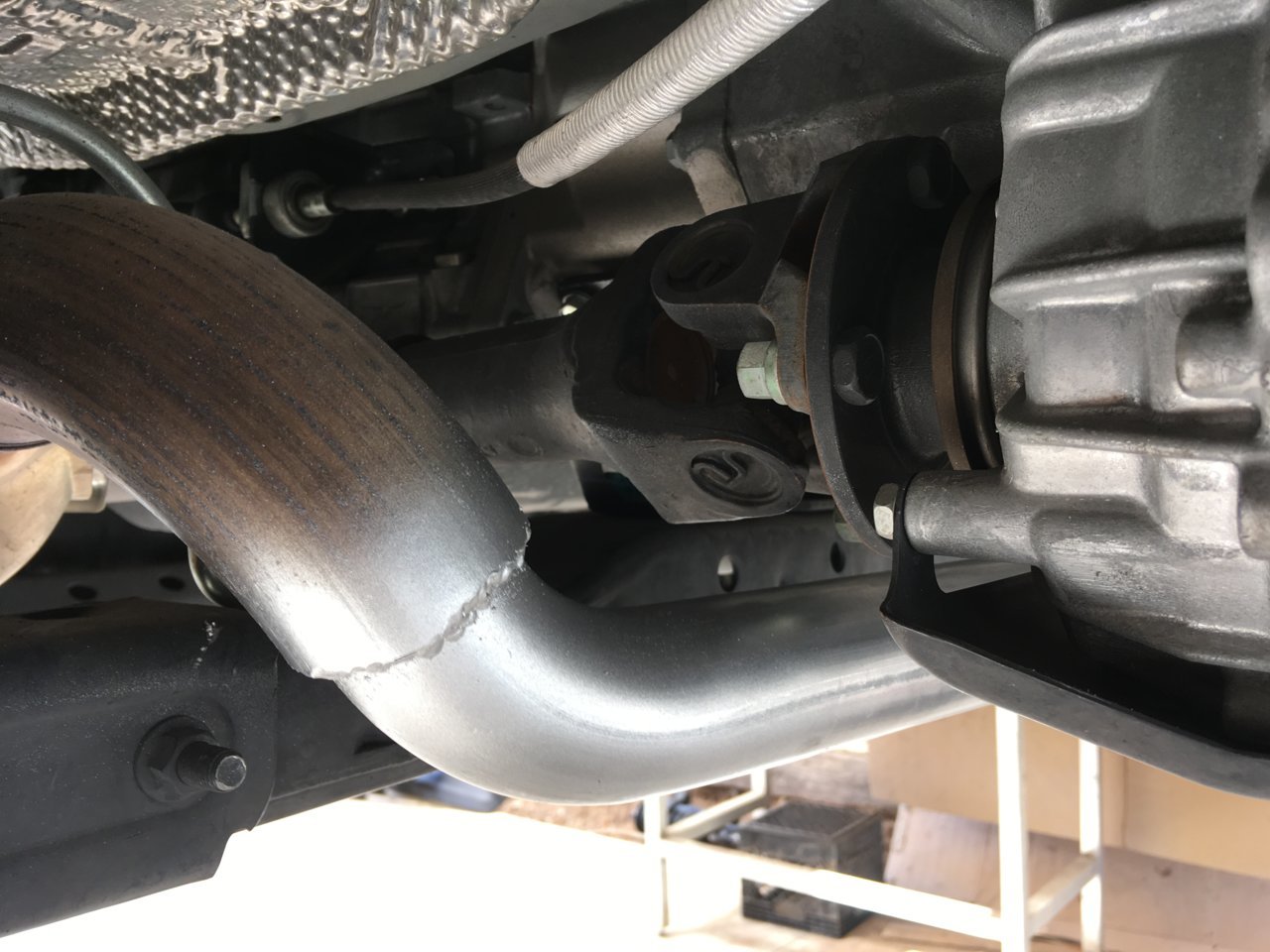

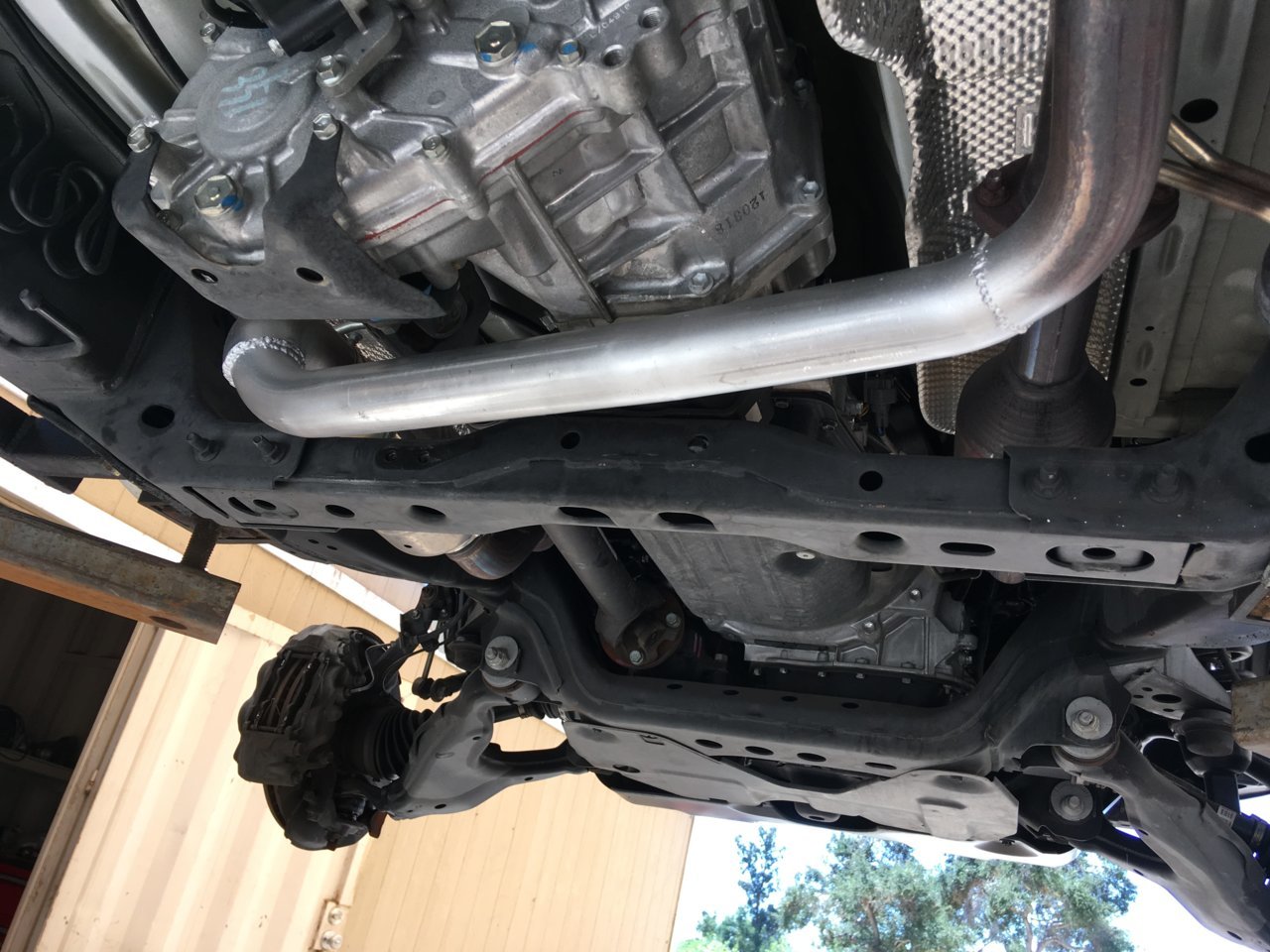

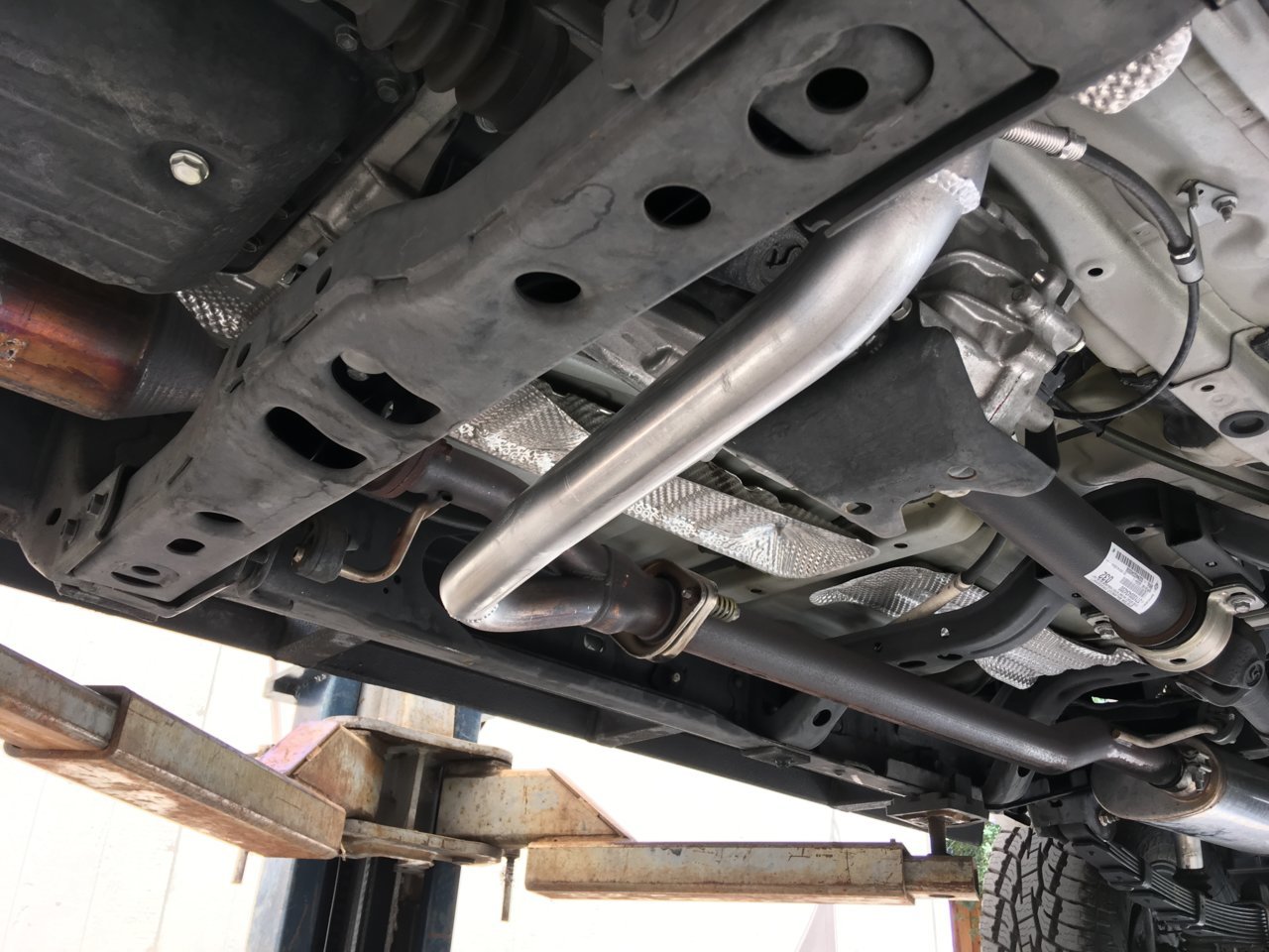

    And a reroute for a flat belly TC case skid...I use mandrel bends in order to keep the bends flowing 100%, as a matter of fact this flows even better than stock since the factory uses double wall flattened tubing in that particular spot!IMG_8376.jpg IMG_8373 (1).jpg IMG_8366.jpg

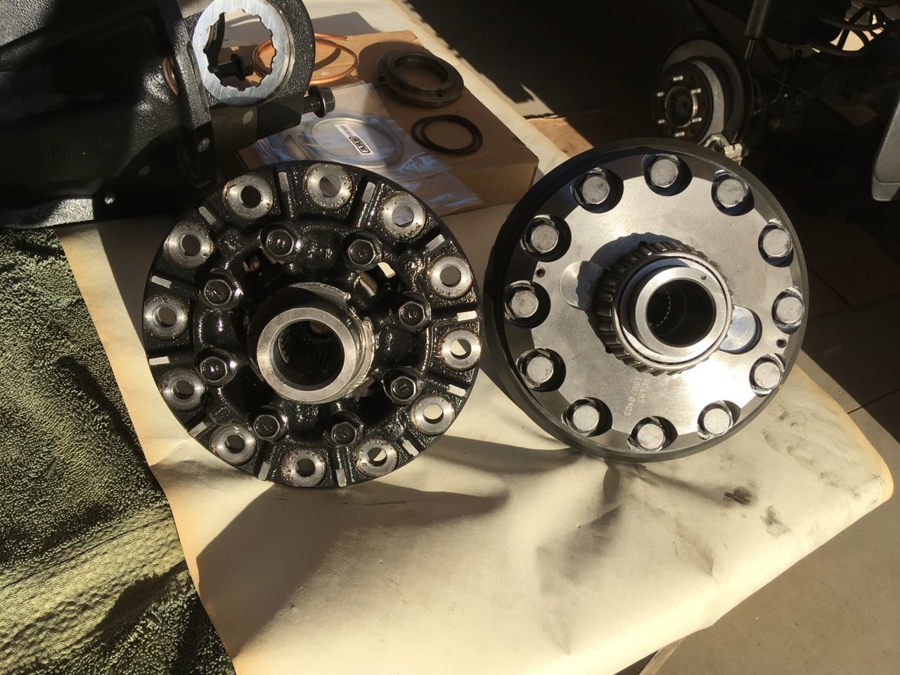

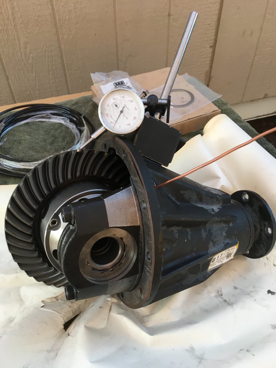

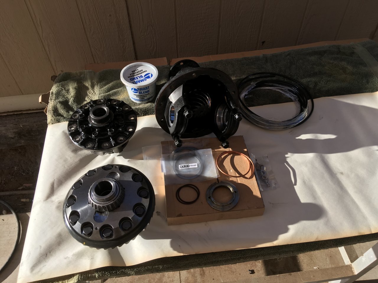

    A few pics of an ARB locker install, I should have taken more pics of how to drill and tap the 3rd member, but just got too busy working...
    Anyway, hope you all have a great weekend, looks like its gonna be a warm one! :bananadead:

    Wow! That's the cleanest CMC I've seen!

    Thank you! I've done over 700 of them now. Iv'e had a ton of practice.
    I created custom templates that I use to cut the steel plates out for all the different chassis, I make them for all full frame Toyota vehicles (Tacoma, 4R, Tundra, FJ)

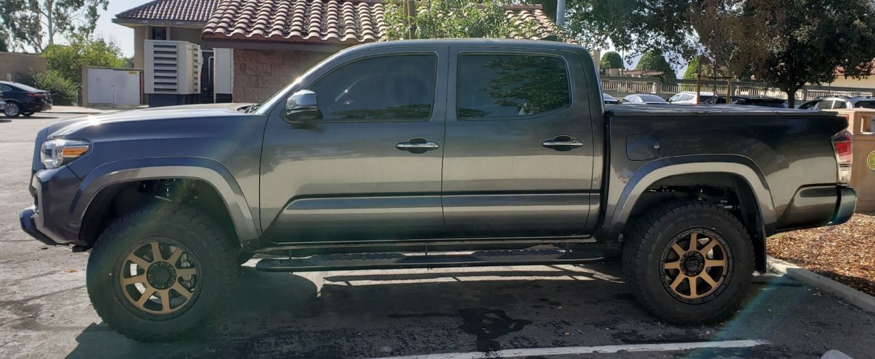

    Ok now gotta do some more stuff on Rhy's build (its a LOTTA work), Ill snap some pics of his rig, its absolutely amazing and set up very well. Now its under the knife for a C4 fab rear HC bumper w/swingout, dual battery setup, racks for cab and shell, and a whole bunch of lights.
    Already did an ARB front bumper and BP-51 shocks all around, UCA's, etc...this thing is gonna be an example to follow, that's for sure!
