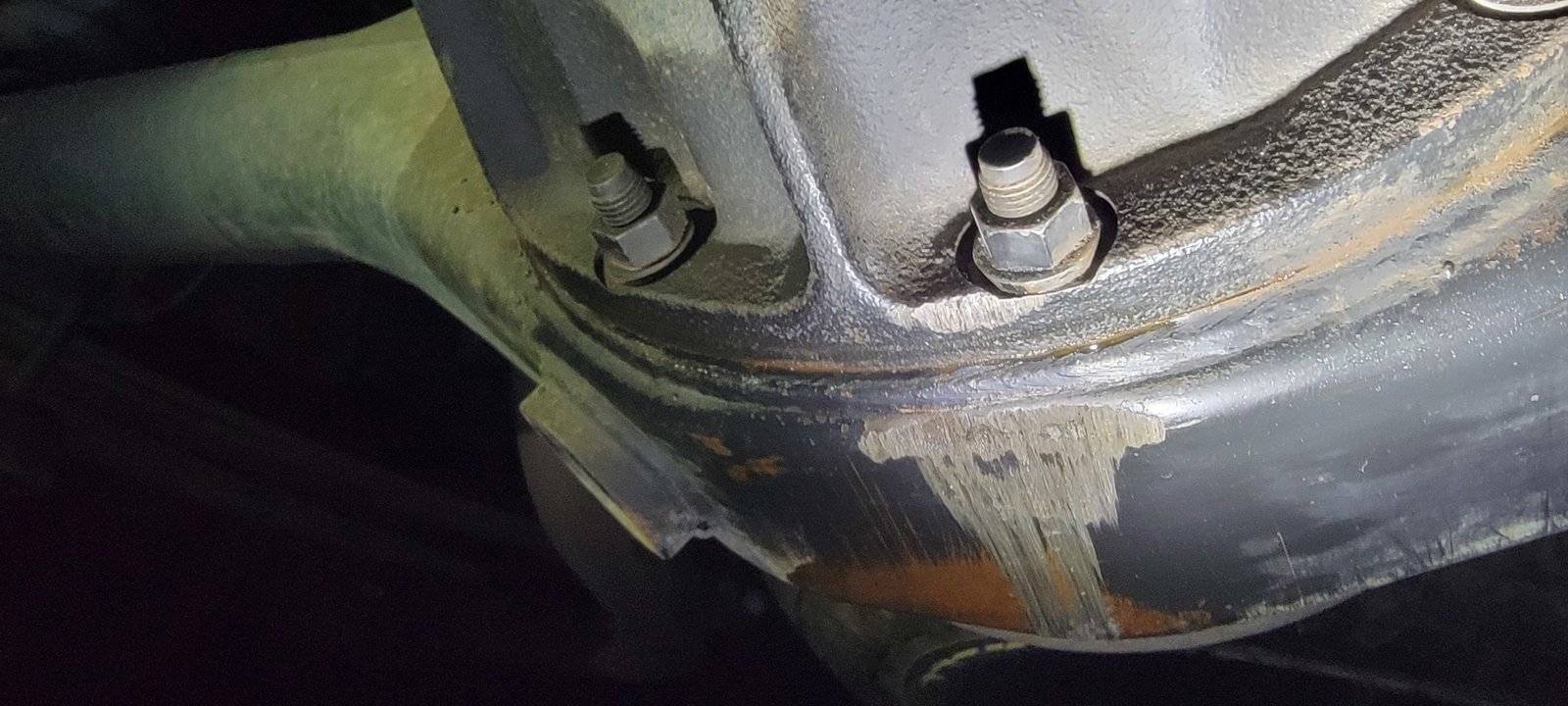

    Once at the campsite, got under the truck and saw this:
    Missed the bolt by just 1mm but still broke the seal on the gasket between the 3rd member and differential housing. We couldn't do anything that night we threw a bowl underneath and went to bed.

    Are the bolt tight?
    At this point you're home.
    But tightening the bolts (nuts) might have slowed it down some.

    Forgot to mention that! Yeah, I tightened what bolts I could but I didn't want to strip any nuts so it was just a slight nudge. Maybe it helped maybe it didn't, not too sure because it's still leaking. Leak is progressing though so it's looking like I gotta borrow the family Camry for a week until I get the time to do this. Been refilling about 1/2 quart a day since it happened and its honestly just annoying having to check often and top it off.

    I don’t know if anything else is compromised.
    but either way sealant is not gonna seal if there is gear oil on it. Diffs are sealed putting them together after they are cleaned and dry.

    I never followed up so here's a quick wrap up update.
    Got everything repaired in one day, a couple months ago now. While I did pop the seal when I hit the diff, none of the studs were affected nor were the two mating surfaces.
    Chocked the truck, took off wheels, undid driveshaft bolts, unbolted axles and diff. Pulled axles to the side, pulled out diff. Hardest part of this was just keeping the axles out of the diff but a buddy helped with this. With the diff pulled. we used a fine wire wheel to clean the mating surfaces and housing. On the diff, the original paper gasket had to be cleaned away first. I used a pocket knife and carefully picked at it without etching the surface. With the paper gasket gone, we used the wire wheel to clean the surfaces to a nice shine. Applied a Bead of RTV Black to the housing and fit the diff back in place. Torqued everything and reassembled, waited 24 hours to cure, and refilled diff. Drives like nothing ever happened.
    The take away is it wasn't too bad to fix and only took like 3 hours with a buddy. No more leaky diff. The problem is I have no mechanical sympathy for this vehicle and will probably do it again.
