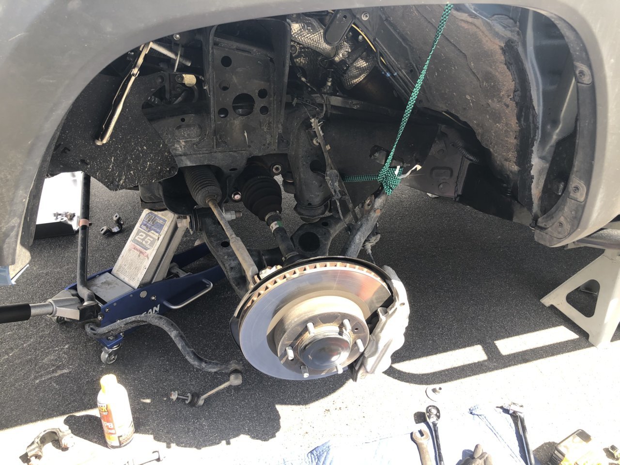

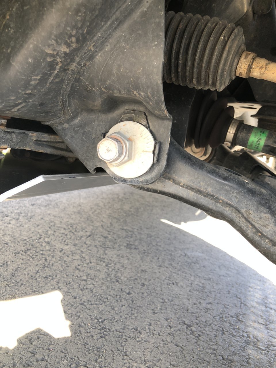

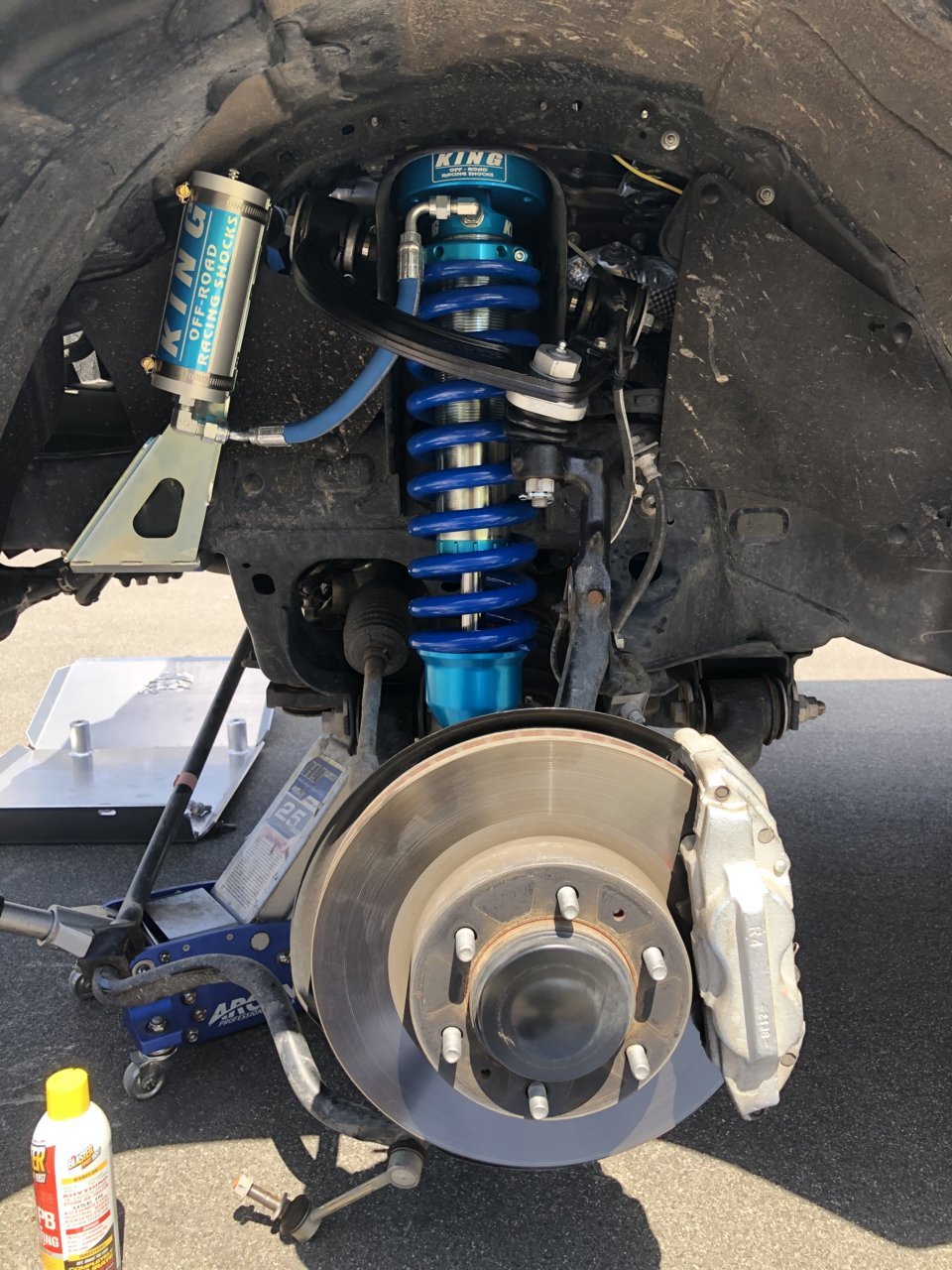

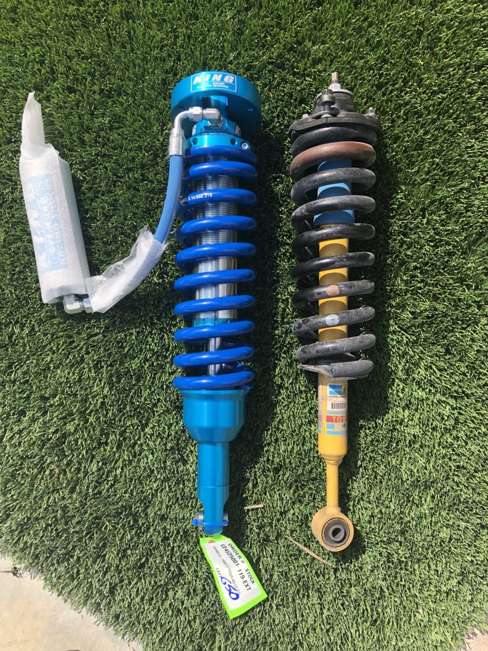

    QUARANTINE TACOMA MOD DAY
    Got the Kings and SPC’s installed today!
    Kings vs. OEM
    Everything taken out and ready for the new parts!
    Sway bar removed and everything installed! Adjusted preload and it’s good to go.
    C1323543-8484-4E2B-8499-A1E7A8ED943D.jpg FBC91707-603E-4F0E-850B-D18AB9C7DE47.jpg
    After install, I set the lowers in the proper positions and dialed camber in with the top adjustment on the UCA. I set the balljoint in position D, with the SPC logo facing outwards. If anyone can chime in if it should be in a different position, that’d be awesome! @Ripcord ?

  5. Mar 30, 2020 at 10:11 AM
    #145
    Ripcord
    Ripcord KM6PIM
    Mar 31, 2011
    #54120
    1,465
    Jim
    Northglenn, Colorado
    Spruce Mica 2013 TRD-OR
    Such a nice looking truck you have going!
    SPCs on position D with the lower cams set to max caster will give you a F-ton of caster. I have mine set to F and alignment reports show that to give me around 2.7deg of caster. Which is really good for driveability. Adjusting the lower cams is where your tire clearance mainly comes from, so just go for driveability with the uppers. E or F would be my recommendation, and torque to spec!
    JKU3000 and socalexpeditions[OP] like this.

    Thank you man I appreciate the info! I'll switch it to E and see what difference it makes. On position D and no alignment I clear the cab mount quite well.

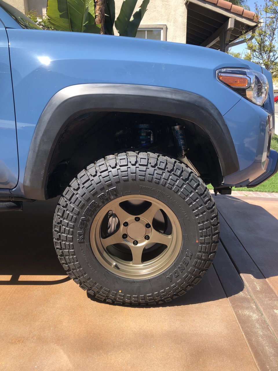

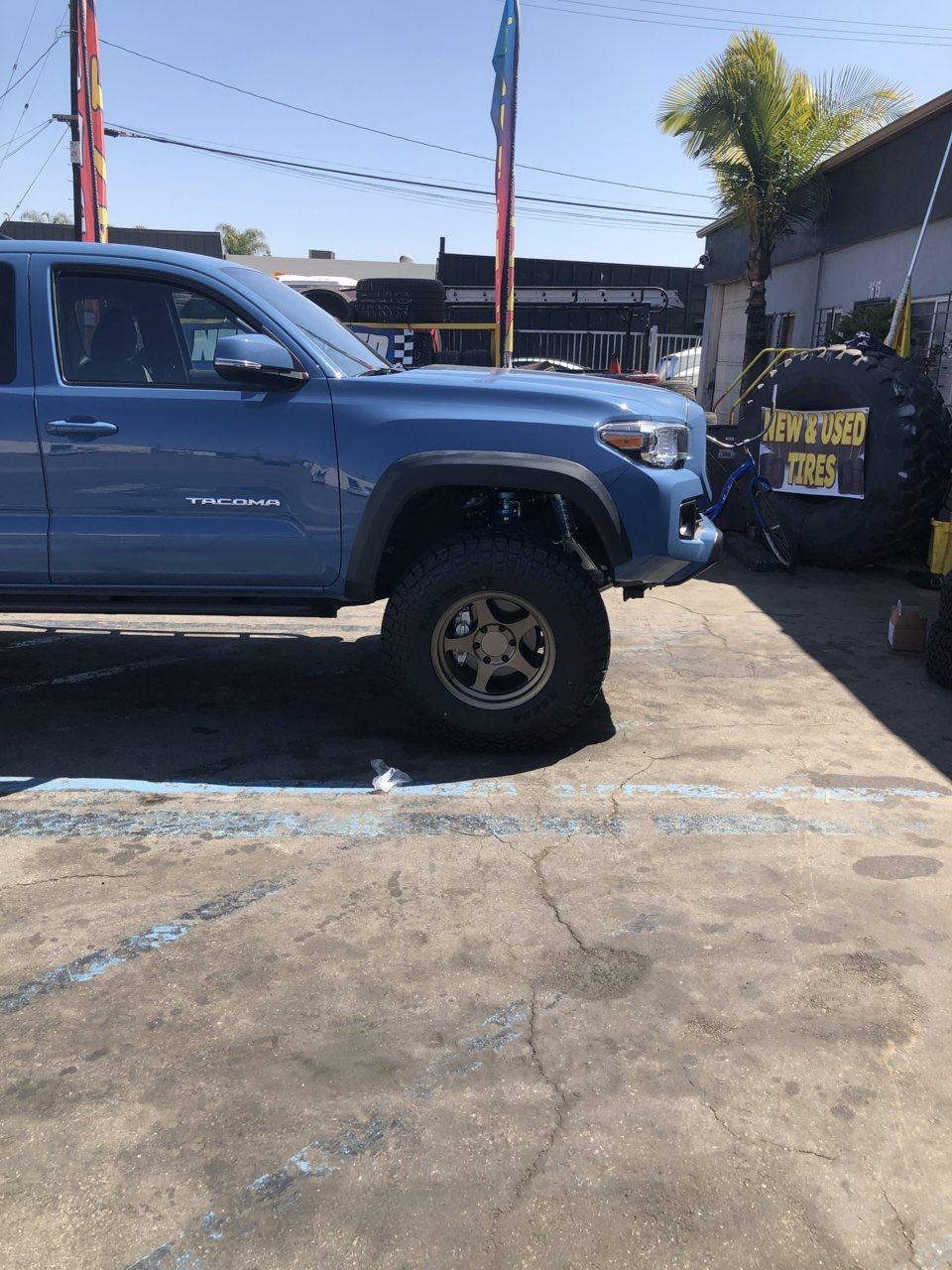

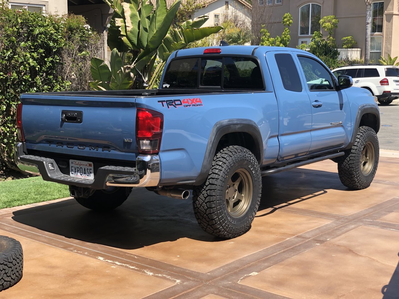

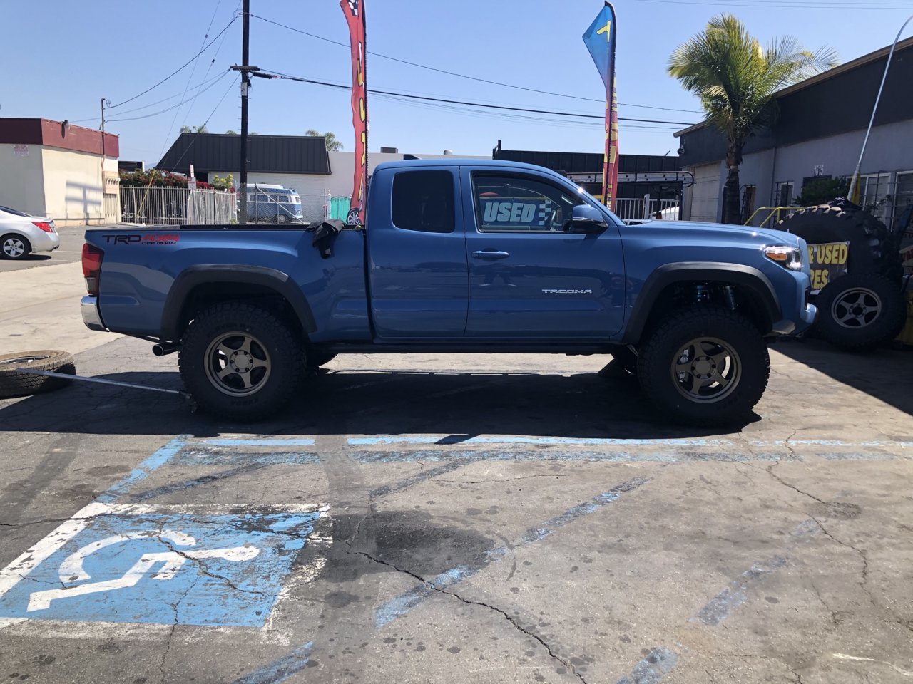

    Today I stopped at my local tire place and got the new tire + rim combo all mounted up. The last picture shows my front lift - I will be turning it back down a few threads. I forgot to take before measurements, so I had no baseline. Still waiting for the rear leafs to get here!
    Kenda Klever RT's in a 35x10.50x17 on a 17x8.5 FN Five Star in Matte Bronze.
    60728778798__38031154-3E71-4B47-96CD-2D2A89C6AE53.jpg 5du%soKAQBKxosqKAz6EAg.jpg 2xaaunX0S8KKMG2d2WFV1A.jpg 60729256337__0027C3EE-8CFE-4186-BC47-38BAA5DB4866.jpg
    My clearance to the cab mount

    2013 White DCLB TRD sport
    Bunch of stuff
    Clearance was all good with the new tires?
  9. Mar 30, 2020 at 7:08 PM
    #149
    socalexpeditions
    socalexpeditions [OP] IG: @socalexpeditions
    Sep 22, 2017
    #230791
    5,244
    Yes I only rub the flare in a weird spot. Need to cut and it’s good to go!
    Shmellmopwho[QUOTED] likes this.

    Yeah these tires being skinny help out a lot too. I was surprised to see they still are 34.6" mounted.

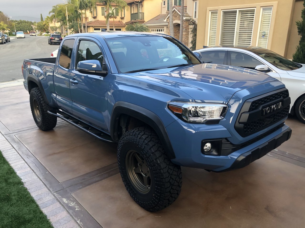

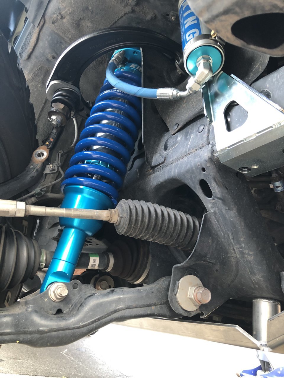

    Today I went ahead and lowered the truck to 22.75” center of hub to fender and spent time dialing in the camber from the UCA. Pretty much got it near perfect based on my level.
    Front looks much better, and drives much better. On the first test drive, one of the clamp-on wheel weights on the inside of the rim that they used (which I’ve never seen used) launched itself into my wheel well and conviniently landed on my UCA. Will make a pit stop to get them fixed tomorrow.
    Threw on a TRD Pro grille and got a message from Dustin @ FN Wheels that he has some other center caps I can have since these don’t fit my taste.
    B30DB7CE-D92D-420C-8E59-F7E79457E8C8.jpg C468E829-13CA-44FF-BC2D-54B6FE7D7374.jpg
    TRD PRO GRILLE W/ AFTERMARKET GARNISH
    Not the biggest fan of the grill as OEM looks sleeker to me, but this helps move the sensor down.

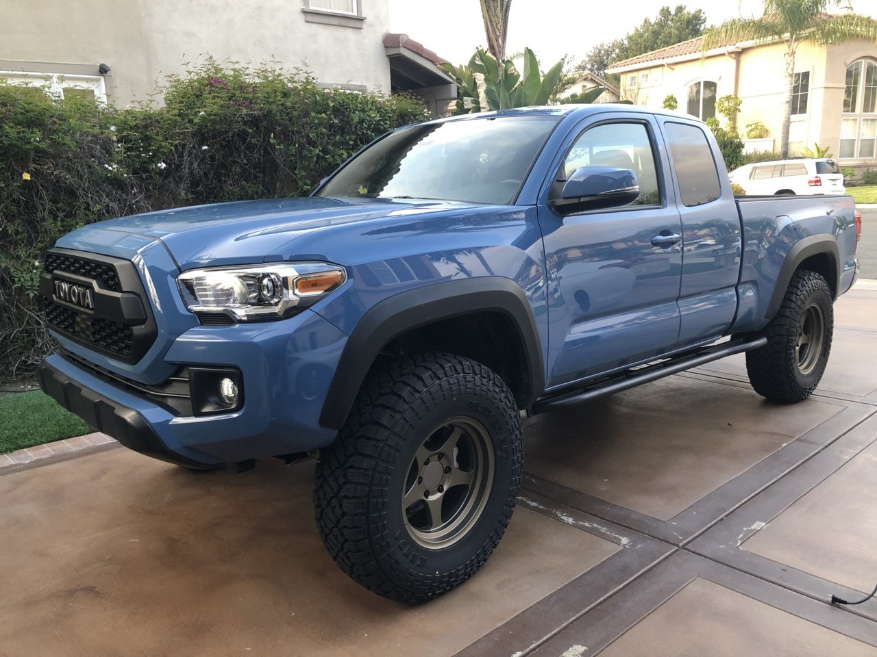

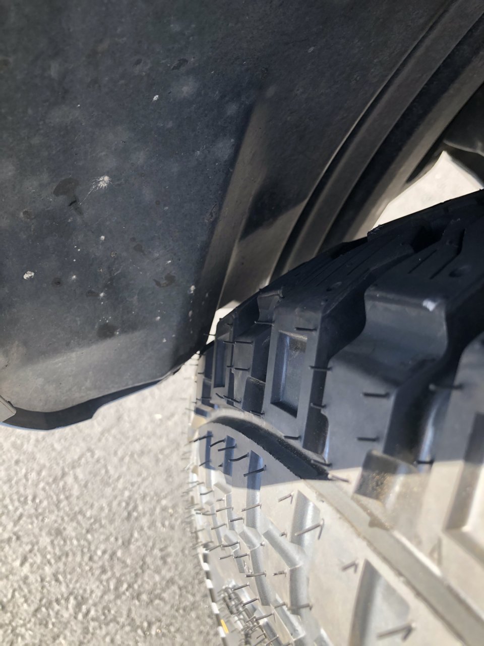

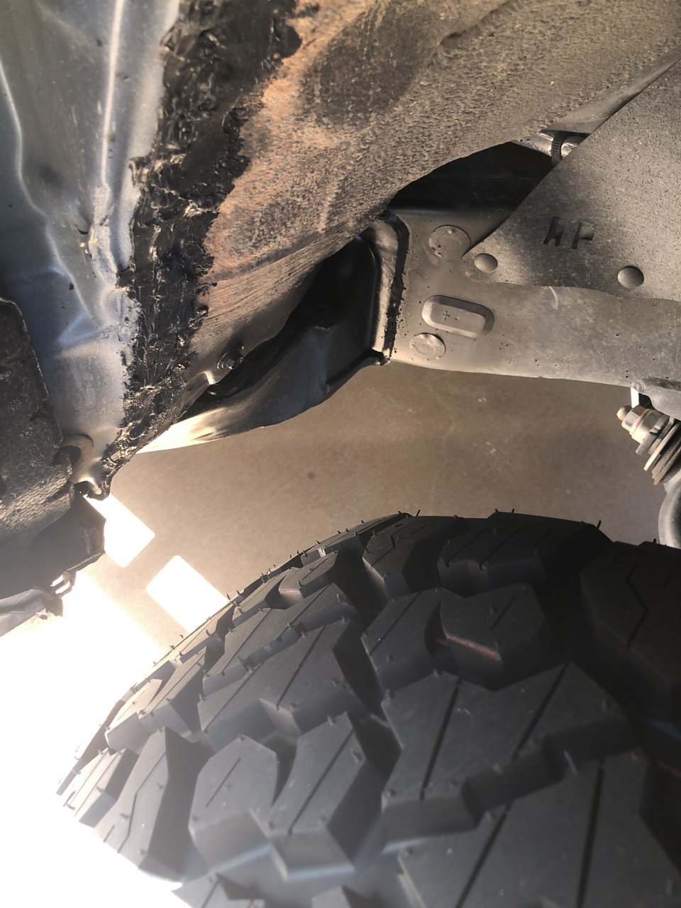

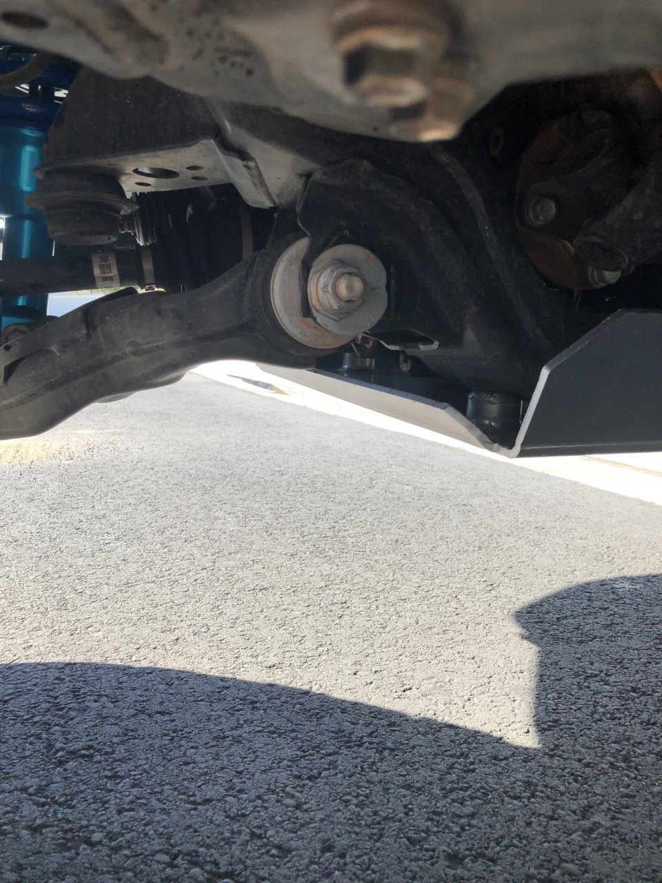

    Went ahead and checked the cams, moved the SPC’s to E. Trimmed the fender liners and no more rubbing.
    DS LOWER REAR
    DS LOWER FRONT
    Rubbing Front
    Cred92 and smw62891 like this.

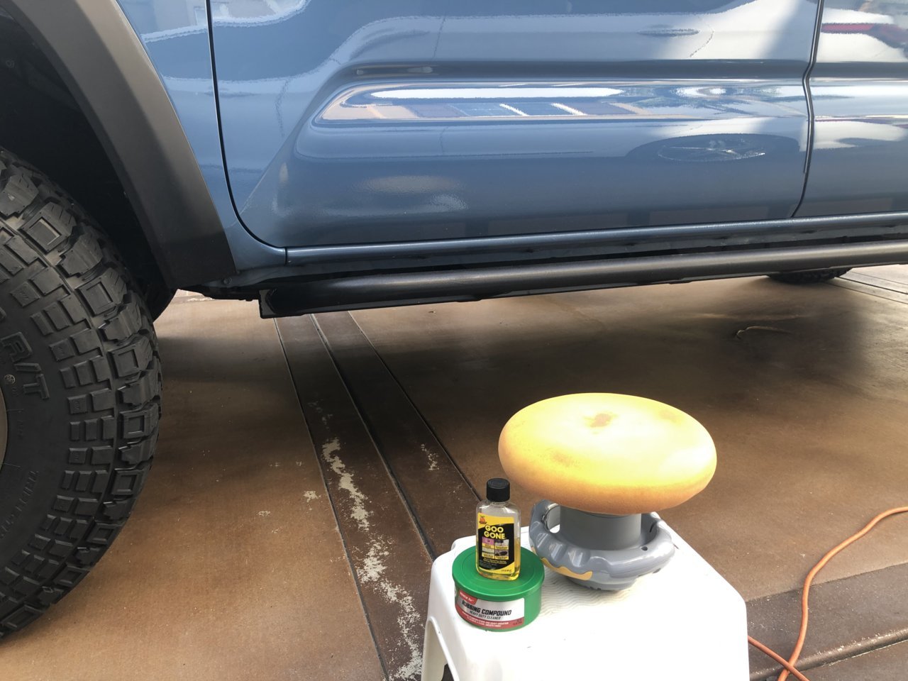

    Today was simple and just removed some emblems and did a full paint correction, polish, and sealant. Truck looks better than when it came off the showroom floor.
    Emblem Removal done with string, compound, and goo-gone.
    8B538522-B618-45F6-BEEC-FA4A1163ECF1.jpg 0BF7AC2E-0E1D-4E75-8911-ED2D4C85B16E.jpg
    Truck after sealant
    CACACB60-5C5C-40ED-ABFD-24A7FD66C3A0.jpg 49693F97-6D6C-45E3-9B73-B8A38E435BE6.jpg
