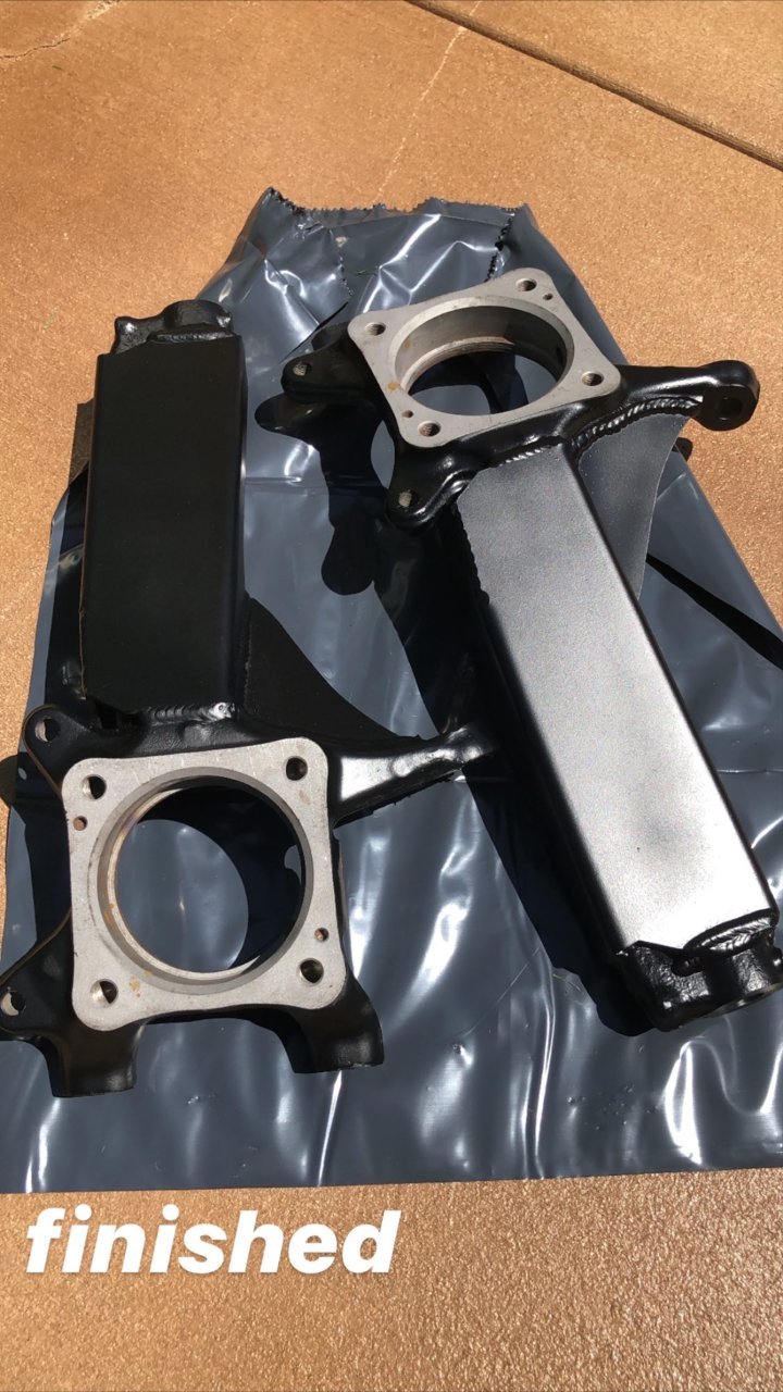

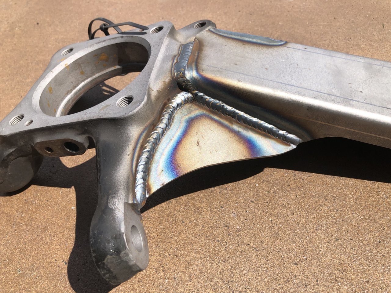

    QUARANTINE TACOMA MOD DAY
    Gusseted spindles have arrived and today I went ahead and got them painted. Will hope for an install tomorrow!
    Before Painting
    Finished product after 3 coats of primer and paint...

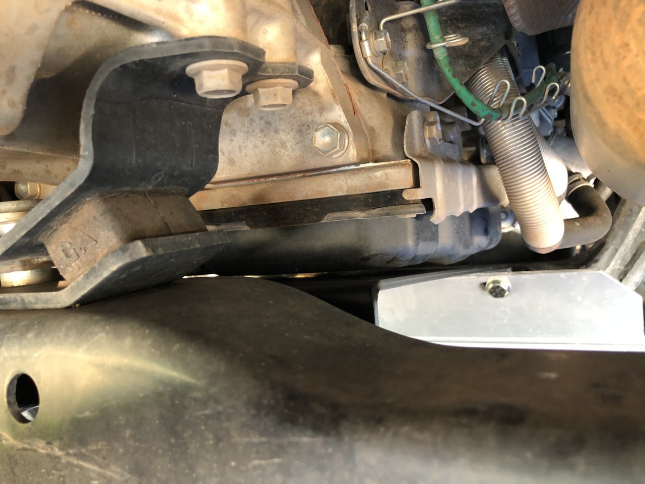

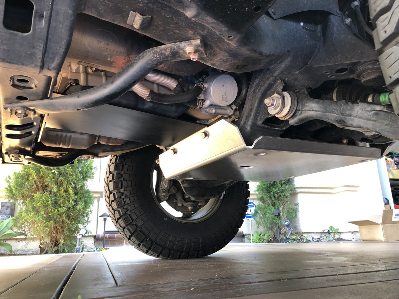

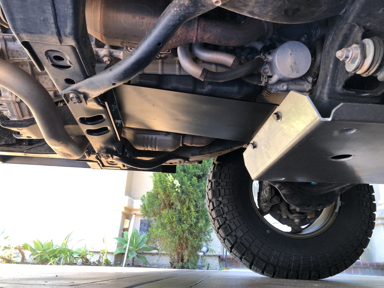

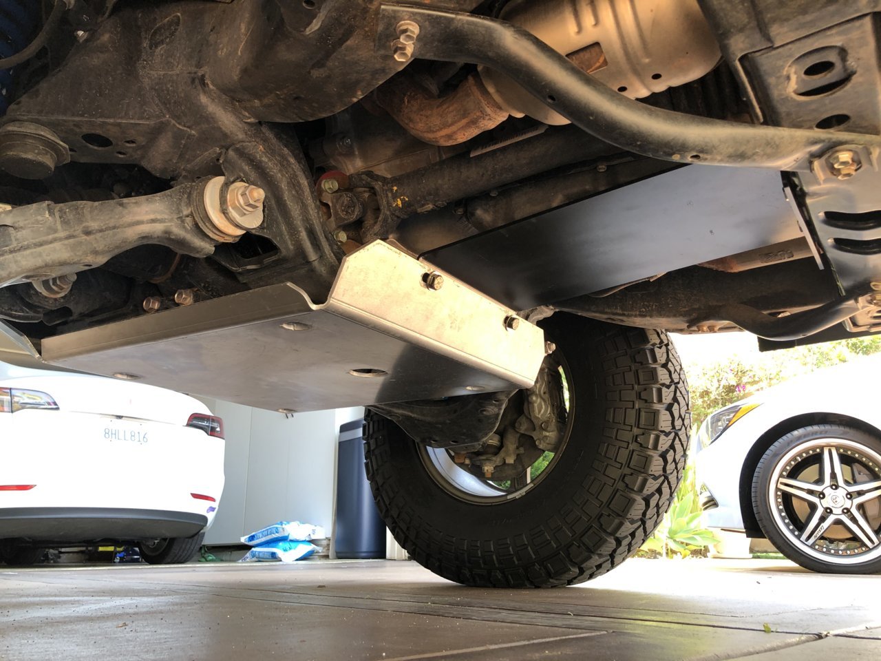

    I should comment on this All Pro Mid Skid.
    Definitely not a fan of it, but for $44, I didn’t expect much. It’s about .5” too short (or the bend is at the wrong angle). The bolts included look like they’d snap in half if I did happen to land on a rock. I swapped them out for some other bolts I had laying around.
    Also, why is it so high? I can’t fit my finger between the transmission pan and the skid. Maybe great fitment, sure, but it makes it a PITA and also a concern. Oh well, it fits.
    I’m a huge fan of the alum. IFS skid from AllPro, but I’ll be purchasing a different T-case skid than what they offer.
    Pictures of AllPro Mid Skid
    A8905725-D34D-42BB-91CB-95EB278AE002.jpg EB1BF2B0-A1FC-4AF8-B784-2335B791480E.jpg B8E4D1D7-9BB1-423B-9B5F-137E8B2846B0.jpg
    Very small gap...

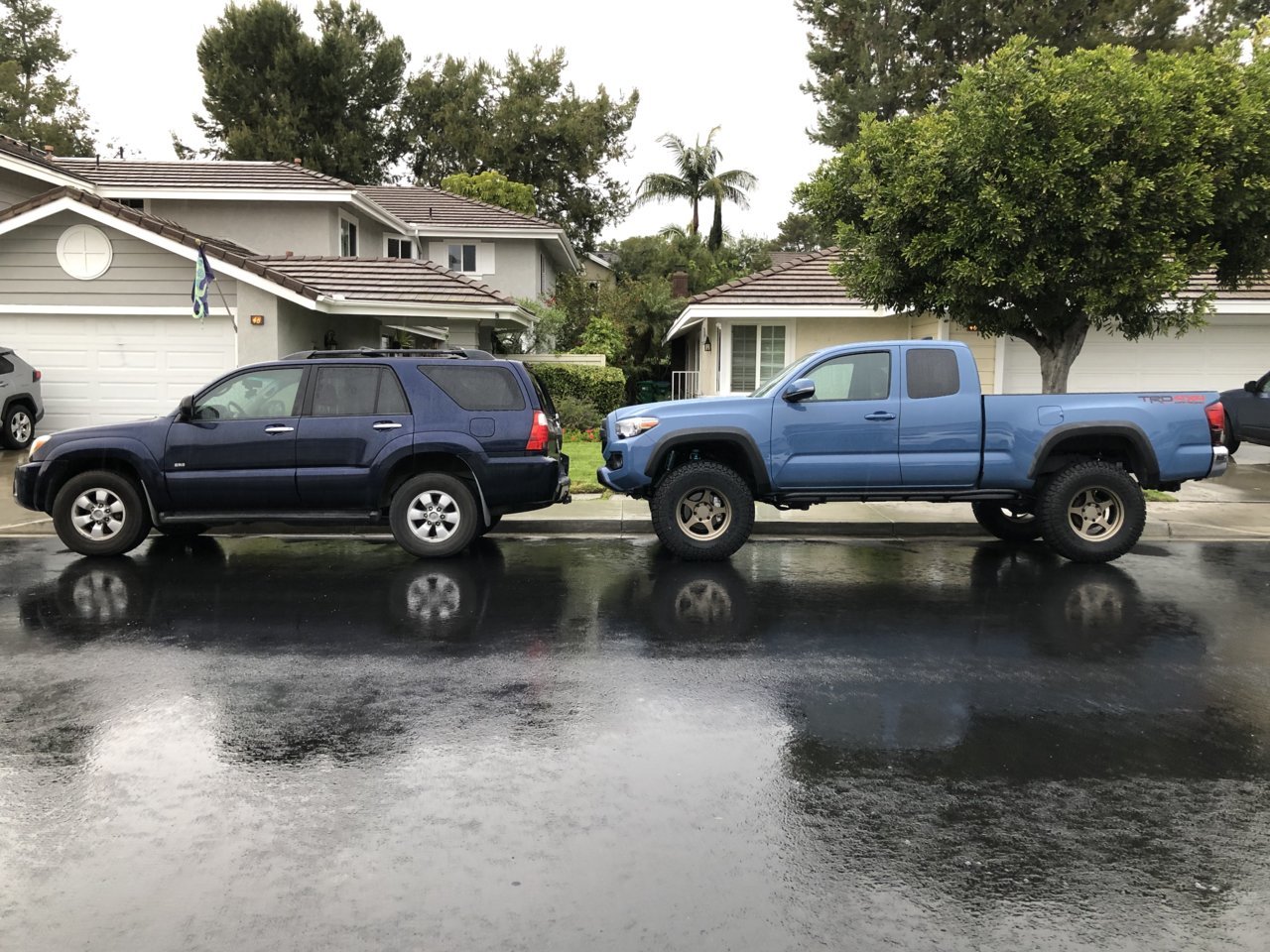

    Snapped a few more photos today of the truck. In the booty pic you can see the real width of the tires - These suckers are narrow. I'm netting around 18.3 corrected mpg mixed city and highway, so around a 3-4 mpg drop. Not much, I'll expect another drop once the bed is carrying some weight.

    Damnnnn. Those 35x10.5 are growing on me lol. Can’t beat that price either.
    my 2.7 would appreciate a skinny 35
    socalexpeditions[OP] likes this.

    it’s so strange these look like they run small when I think I saw a measurement on the forum they came out to 34.7” mounted. Maybe it’s the Dakars sitting tall on the AC.
    if I run these, may just go AAL as I don’t want more than 1.5-2” in the front anyways.

    My truck sits stupid high, thats why they look small. The rear has settled a little more than in this picture, but I still need the truck to drop 1” in front and 2” in the back. Once I add bumpers it’ll do the work.
    I measured my set to 34.6” @ 33 psi cold mounted on the truck
