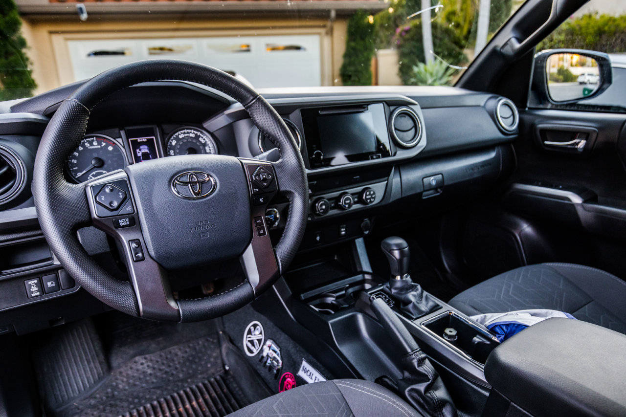

    Really loving the interior in this truck. I think it has to be the biggest upgrade coming from the 2nd gen. The steering wheel...god I love buttons that work! One thing I've noticed though is that the audio volume only gets so loud...I feel like I can have it maxed out and it's definitely loud, but not even close to any other car I've had before.

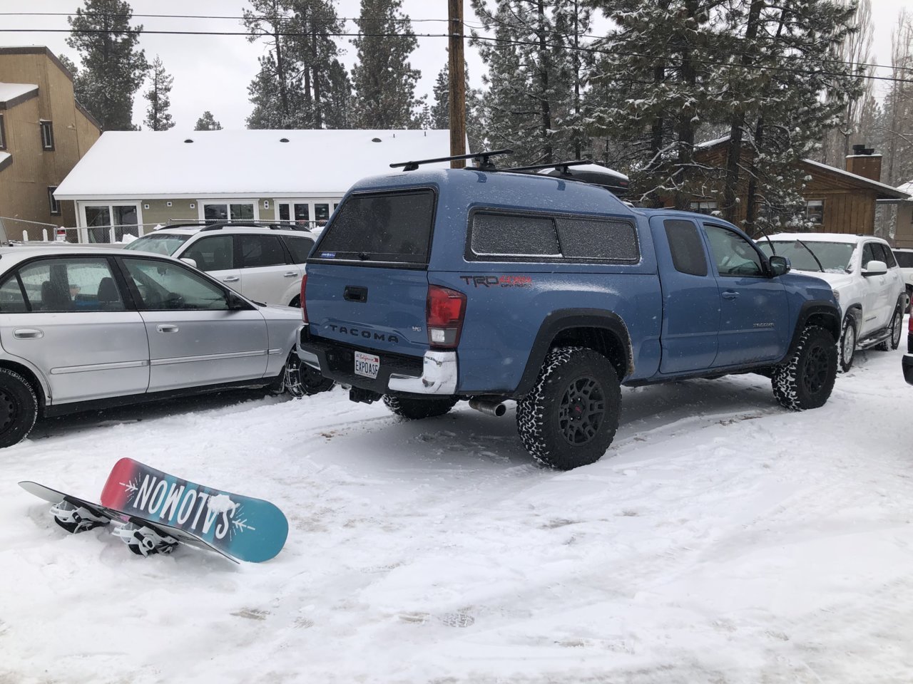

    Took the truck to Big Bear today to get some laps in. Was very happy with how the KO2’s did in the snow!

    Nice. I heard they got a little snow. Nothing like smashing up to bear in the morning, shredding, then heading out to the desert to beat on the truck , mercilessly , that night.

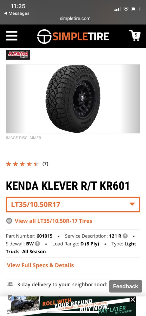

    A competitor to the Falkens I was previously thinking about buying.
    Not much info out there on it. Seems like ~63lbs, ~34.25 actual height, and load range D.

    4Runner
    @TacomaDad18 pretty sure you run that exact tire?
  12. Feb 11, 2020 at 6:54 AM
    #52
    TacomaDad18
    TacomaDad18 overlanderrr asf
    Dec 7, 2019
    #312698
    1,111
    Jason
    1uz 2018 SR5
    Hard round things Soft round things Metal bouncy things Shifty thing Locking thing
    I do!
    Great tire so far. Quite a few wheeling trips on them. On road they are quite, off-road they get traction. You have to air down pretty low to get a wider footprint though as their sidewall is strong.

    5,405
    Have pictures? What do they measure out to? Thanks for jumping in :thumbsup:

    I for sure don’t miss my 2nd Gen interior compared to my new truck. I’ve noticed the volume thing too. Looking forward to this build, loved your last truck!

    No problem!
    Check out my YouTube channel- TacomaDad. I have a video talking about the tires. I have pictures but no specifically of the tires. They measure out at (without load) is 34 3/4”. With them under load- 34 1/8”
