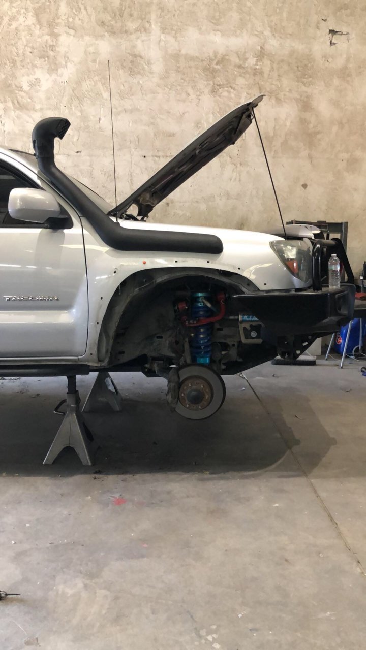

    Hey brother! @desertjunkie760 actually did my fender and flare trimming. He cut 2.5” off my stock flares and fenders. Here’s a picture.

    #70

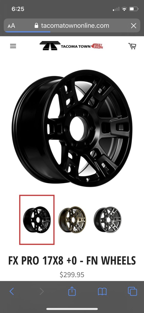

    Oops! I forgot to mention the 4.5 BS @ 0 offset was talking about the rims I’m looking at!
    17x8’s. So your calculation is correct!
    Looking at these FN FX’s. I’ve had them before with a 285/75/17 and cleared my JBA UCA. I should be an inch thinner with a 35x10.50. $450 for a set of 5x brand new from FN

    2017 MGM OR DCSB
    Ahahaha literally looking at the same thing :rofl:
    Where are you finding 450 shipped ?? I'm seeing 899 for 4

    So Cal
    2014 DCSB TRD OFFROAD 4X4
    265/75/16 AT2 BILSTEIN,SNUGTOP MBRP,SPC UCA
    Wow that’s awesome. Didn’t realize it was so strenuous to advance the stock fenders! Thanks for sharing.

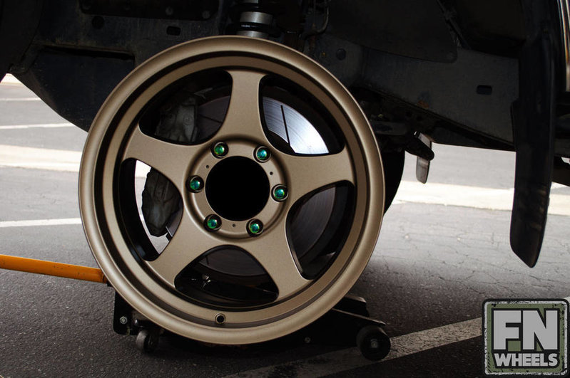

    So I believe I have found the new rims I want to run! I've always ran FN wheels from Dustin, and I've laid eyes on a set of these :D Yet to pick the color though, bronze or black?
    FN Five Stars in a 17x8.5 -6! I believe this will be the perfect combination to run those 35x10.50's. These beauties only run 23lbs each! The tires weight 63lbs each.
    So with my math...
    23 + 63 = 86lbs per wheel
    If I had Falkens AT3W's: 23 + 73 = 96lbs per wheel
    Difference is 10lbs between the two. With all four wheels on the truck, it's a 40lb difference. Using the 4x multiplier for rotational mass, I'm saving 160lbs of weight total!

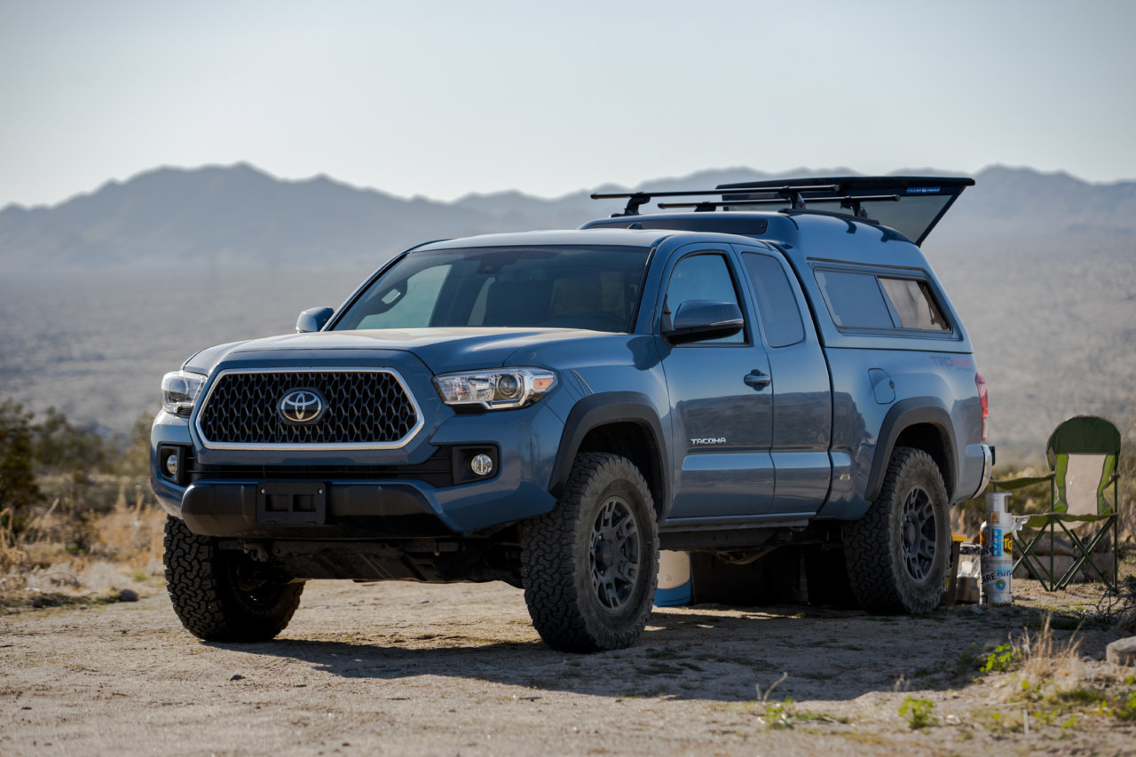

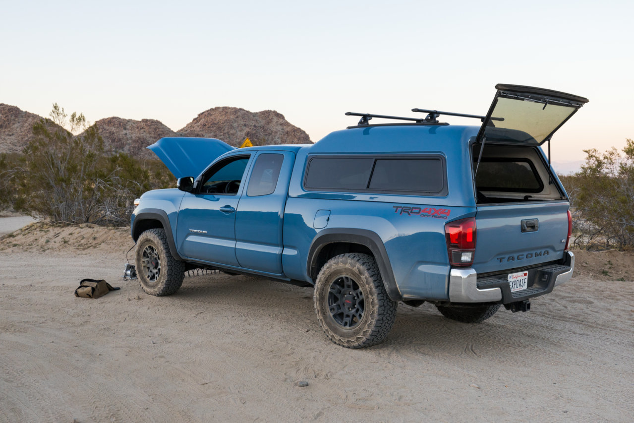

    First time offroad with the new truck! I have been here with my old truck multiple times, and have never felt like I was driving so slow! The road to the mines are fairly smooth, with just some washboards. The truck in stock form required me to stay around 25-30mph to not be an absolute rattletrap. Any faster would be too rough, and same with any slower. In my old truck with +2, I could easily do 60+ mph and it felt like a cloud. Quite a difference! I was pleased with how well the truck felt on stock suspension - It felt miles better than my 2nd gen stock. I'm not a big fan of KO2's from my previous experiences, but I've been impressed this time around.
    After finishing the mine trails, we aired back up and headed over to catch a few pictures before it was pitch black. These 275/70's air up from 18 to 35 with my Viaair 400p in under 1 minute! Onto the silhouettes - I'm not a big fan of taking them when there's a mountain in front due to casting a shadow on the lower portion of the body unless shot from extremely low, but I had my girlfriend jump and we got some cool pics! I was using the wrong lens/shutter speed (why she looks blurry in the first shot).
    We then headed over to find our campsite. Right outside of Joshua Tree is free camping for up to 14 days, but unfortunately we don't have that much time on our hands! We picked out this spot by this huge electrical tower as the lot was big. The next morning I realized that we had a fire right under the tower...Lets ignore that part, even though I don't think there was anyway that a real fire could occur. As the night went on, we decided to try out some light painting as I've always enjoyed them!
