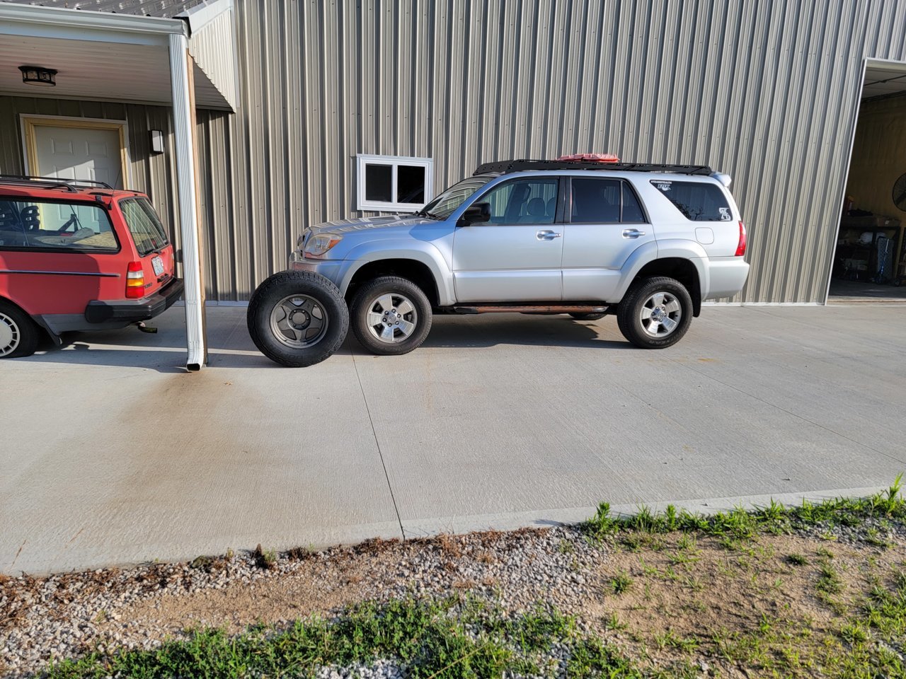

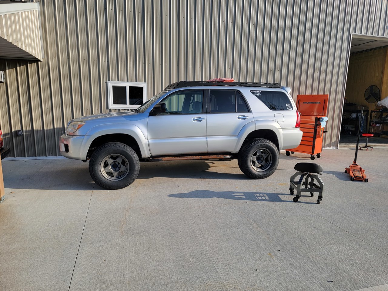

    So.....light duty time went by the wayside this monday. Mowed the grass the first time since then, drain field kicked my ass.
    Bouncing around still feels like getting punched in the guts. Anyway.......so the last couple days have seen progress on the wagon.
    Hopefully back on the ground tonight.
    Also, this happened......
    Looks so strange with stockers
    With spidertrax
    And a little playtime testing
    Still gotta install new front coilovers and rear links, and "Fit" the dirty threes.......

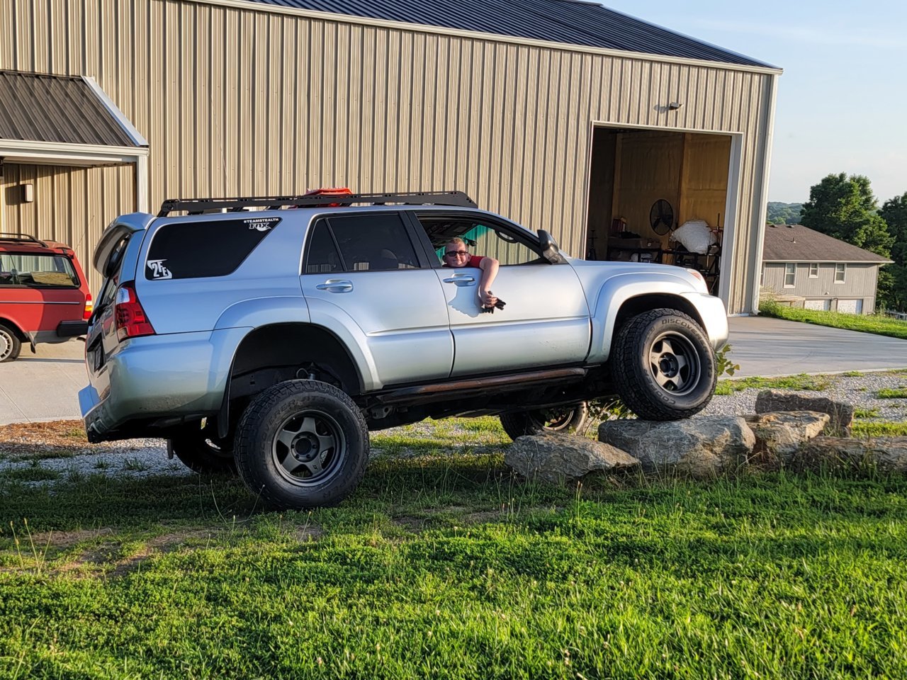

    DropBear readdiness......along with fitnes.....
    For 285's.....
    Also that im getting old and using alll tools at my disposal.

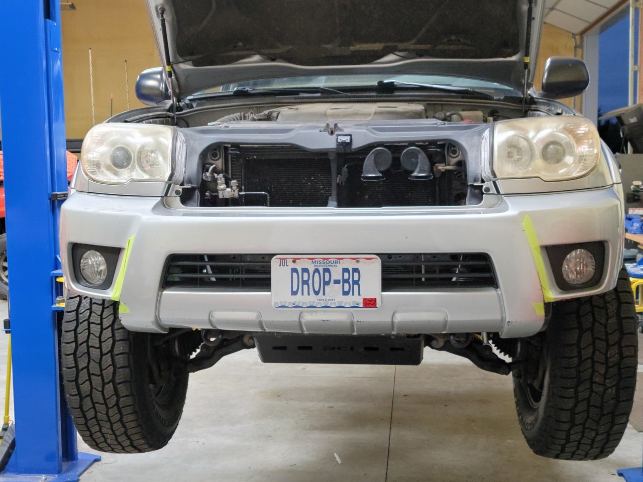

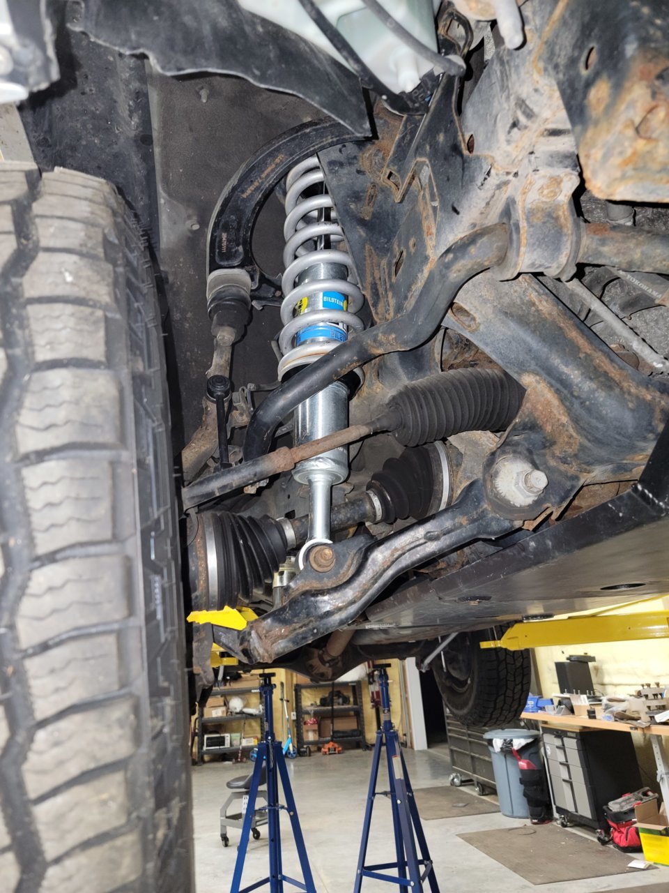

    Non-corroding 6112's with fox 650lb springs installed. Arms upper and lower set for max caster....fitting for cab mounts and bumper cutting tomorrow.

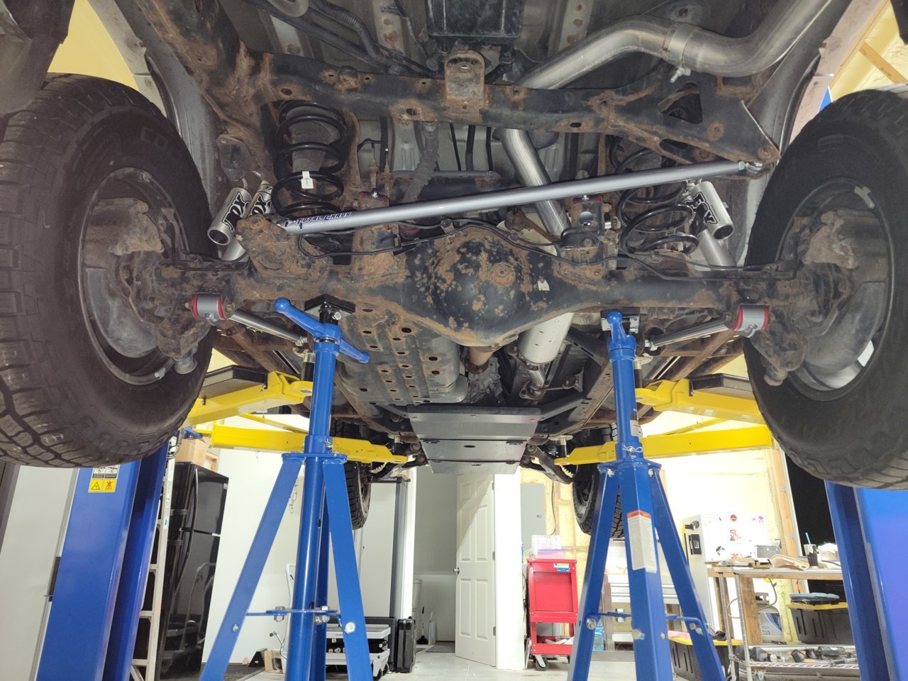

    Also, while i had some more time this eve after dinner..........after 18 months.
    TC anyone???

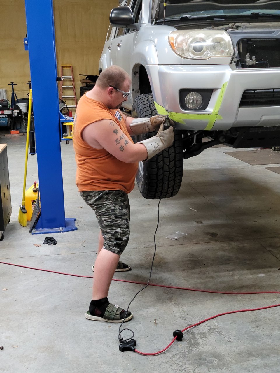

    Fat guy at work. "Viper cut", check.
    Gonna trim back the cab mounts a bit soon and hopefully.....well y'all know how this goes.
