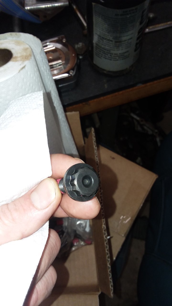

    Ok, doing my first Taco clutch and have a dumb question...
    The flywheel bolts have a 12 point pattern on them.
    Is there a special socket, or just use a standard 12 point socket?
    Thanks,
    Andy

    Standard 12pt socket is what I always use. Be sure to have a good grip/directly straight on the bolt head, not crooked or catawampus. I've seen them strip pretty easily.
