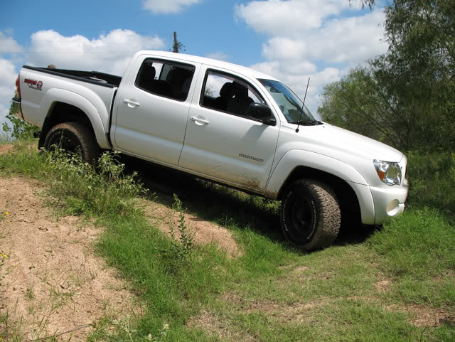

    some shots of the truck from the TX meet up in College Station 9-26-09
    my buddy David in the bed

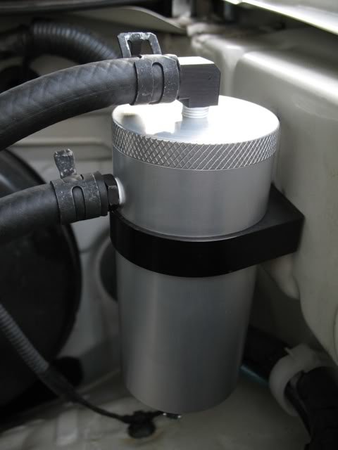

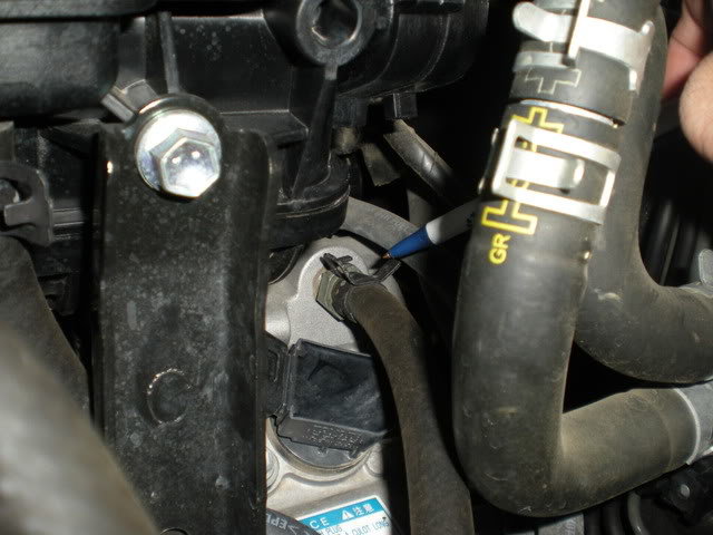

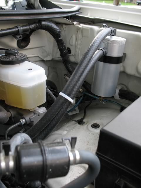

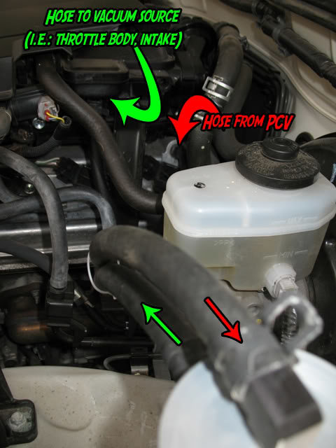

    installed my catch can from Accurate Machine Works
    very easy install.
    these next 2 images show better where the lines attach

    Forgive me for the dumb questoin. What is that catch can for? What does it do? Whats the benefit of it?

    AMW PCV Catch Cans are designed by automotive enthusiasts for those who expect a higher standard of performance from their vehicle and wish to help extend the life of their engine by decreasing oil contamination from the intake tract to the combustion chamber. Months of research and testing has provided AMW with a unique and functional kit that has worked flawlessly on many makes of vehicles, from turbo applications, imports, late model domestics, to early model muscle. The internal design of the AMW catch can is superior in function to other catch cans on the market. Oil vapors and other contaminates are first caught and condensed by a stainless mesh and then dropped to the bottom of the can where a series of under-cuts in the walls prevent the oil from climbing back to the top and exiting back into the intake tract.
    Oil contamination derives from the positive crankcase ventilation valve common on most internal combustion engines where vacuum is pulled on the crankcase by the intake or in some cases the throttle body. This contamination occurs when oil vapors exit the crankcase via the PCV valve, enter the intake tract, and create adverse effects such as carbon build-up on valves, pistons, and plugs, as well as cause harmful detonation. Detonation in many cases causes the ECM/PCM to retard timing, thus creating a reduction in horsepower. Power adders such as turbos, blowers, or nitrous can benefit greatly due to the removal of oil contamination in the combustion process. Poor emissions could also be traced back to high levels of oil residue being burned in the combustion process. By removing this oil, a clean burning engine could help the environment as well as improving the performance of a vehicle.

    Looks good sock, now we just need to give it a couple thousand miles & see what you catch.

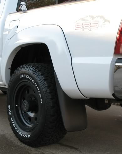

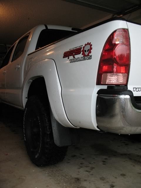

    trimmed up the mud flaps
    (rainy, dirty pics)
    original length:
