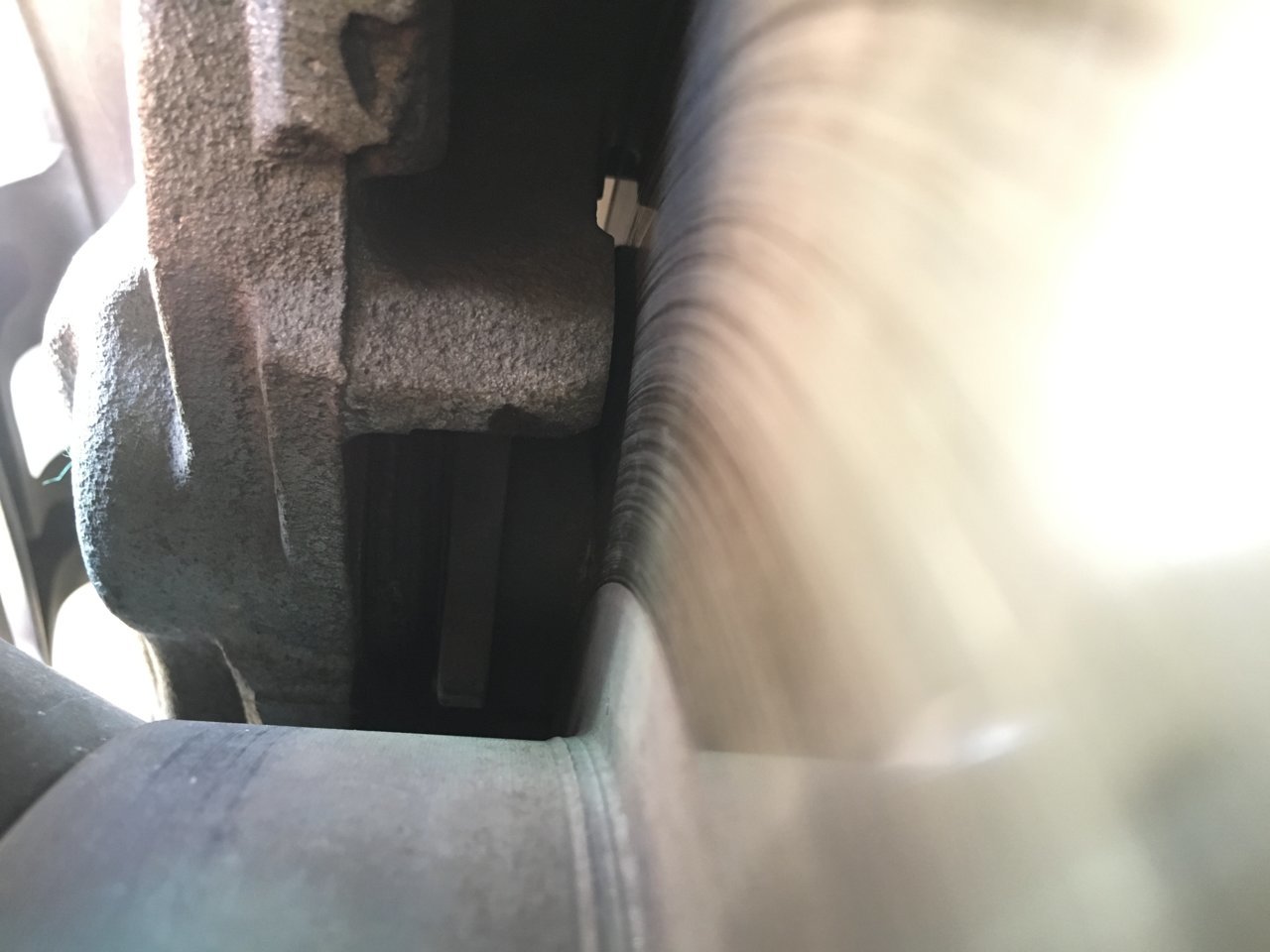

    Alignment was done the morning after, no alignment issues as of now. I haven’t taken my truck off road or in mud for a while, all brakes are clean. I looked closer today and noticed that my front passenger brake pad was touching the rotor while the vehicle was jacked up. Is this normal? The wheel still spins free when its in the air.

    Got a picture or two for us?

    This is with the wheel on the ground
    I want to add that my brake pedal initially feels soft, like the first half of it being pressed. Closer to the floor it feels harder but still not as firm as before. I also notice a slight vibration/wobble coming from my front passenger wheel when braking, signs of a warped rotor?

    Looks normal to me! Pads resting on the rotor surface is normal. If the wheel turns freely then you are good.
    Hmm not sure about the second part. Could be a few different things. Hopefully someone more knowledgeable chimes in.
