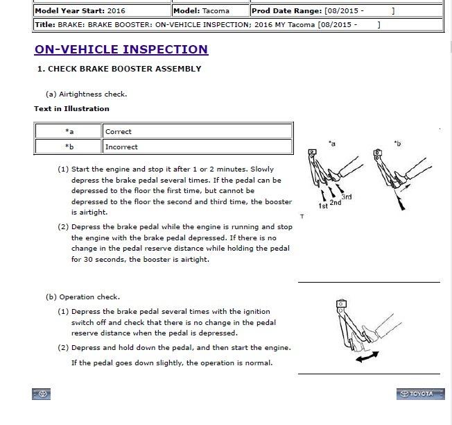

    I have a 2017 trd off road after the truck sets a few hours and I go to start it the brake pedal pumps up. Is this normal?

    Its pressurized by an electric motor or some voodoo magic, and yes this is normal.

    If you're trying to check the booster...

    Thanks for the replies :thumbsup:
    One less trip to the dealership works for me.
