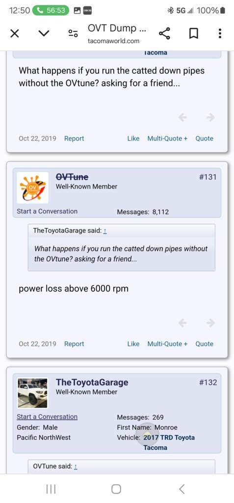

    that was talked about in the ovtune dump tube thread. yotawerx still offers a dedicated dump tube when i asked last year. i believe vftuner may aswell. no idea about ott

    very hard to find old ov stuff as his profile has been banned and alot not accessible. the main thread is gone as far as i could see. i did see one mention in a comment tho
