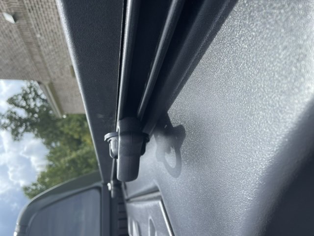

    E8948C91-6F29-46E5-A45B-27B5E0283234.jpg F87747C0-511A-4EE0-8F6A-7B8815754FD0.jpg Just to give everyone an ideas of how close the boxes are to the utility tracks

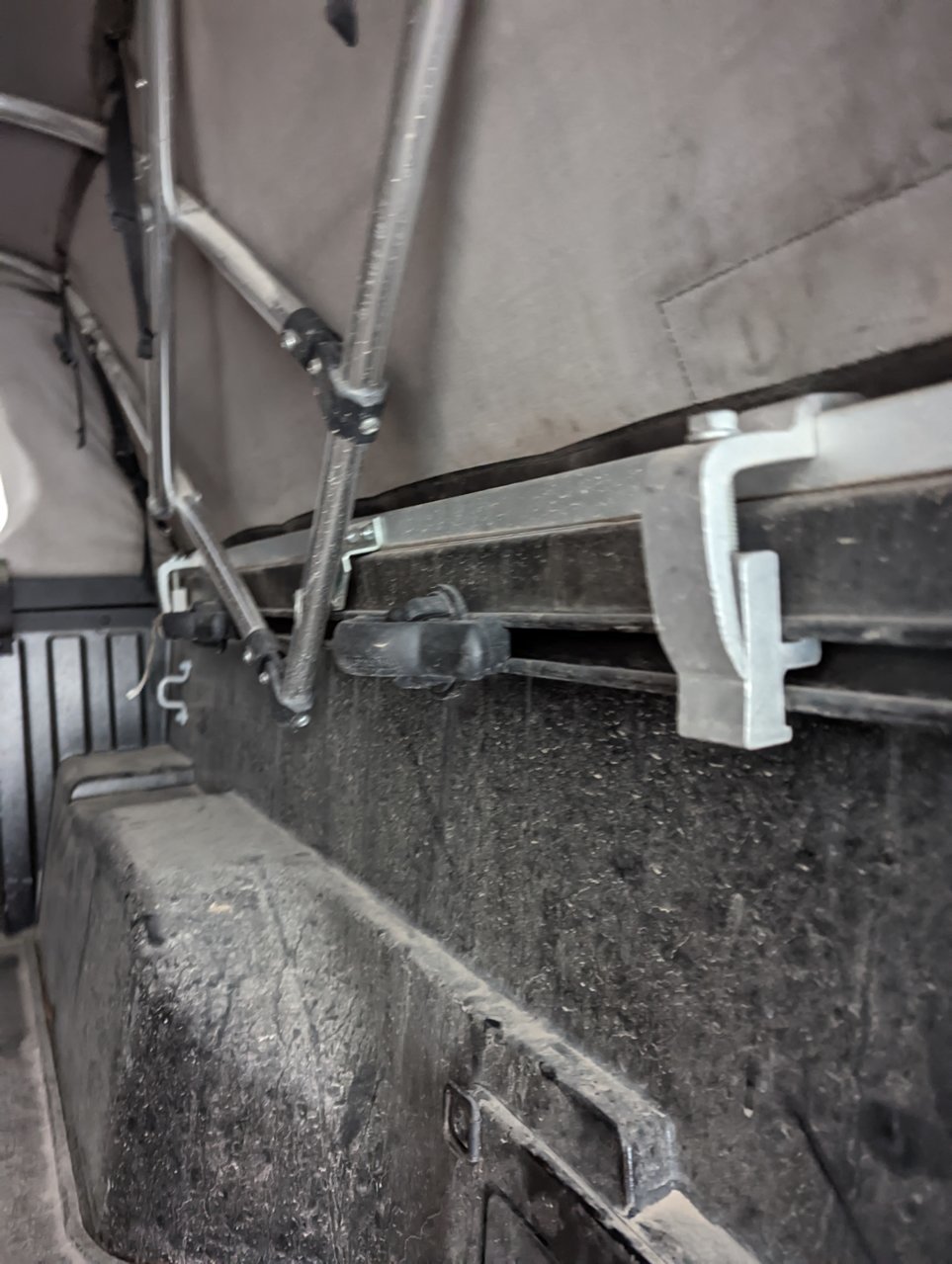

    For the curious:
    The rail clamps don't poke down at all on the softopper. However, the hinge and frame mechanism absolutely would interfere with the trail boxes.
    Damn, I really need to wash down my bed. :anonymous::anonymous::anonymous:
