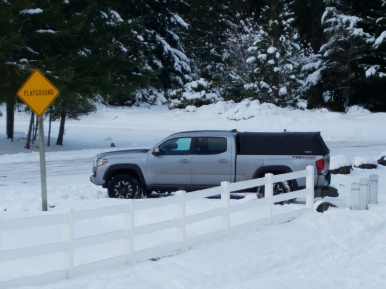

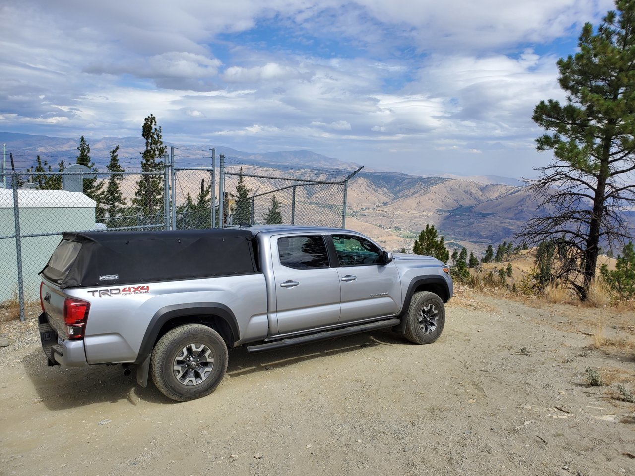

    Mine stays on year round.

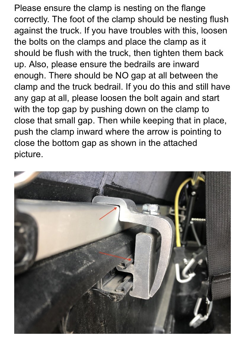

    I thought I would share how to fix the issue with the bars not lining up at the junction . Soft topper responded to my email. It fixed my issue. Once u do this the bar should sit pretty flush . F6259206-114E-4B0E-98E0-63D115850D5F.jpg

    I'll try that, maybe mine are too far out. Only when I snap the top down it bows.
