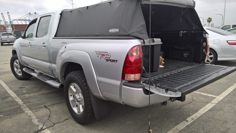

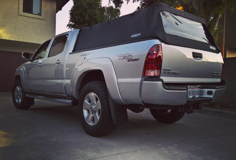

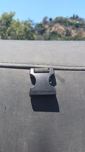

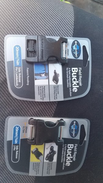

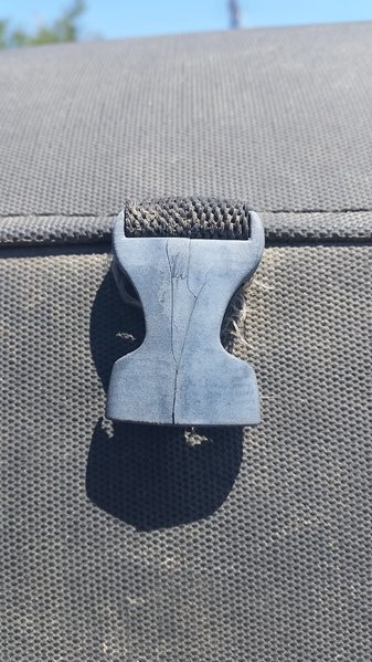

    5 years of sun exposure have taken its toll on the buckles, everything still works but they are getting brittle. This the only one that has cracked
    So I found these replacements that have a removable pin
    I got 2 because I plan to add an awning on one side, using @mountain mike idea.
    But you need to replace both ends for the softopper, and threading the webbing is not easy. I will have to wait, its 102 right now.

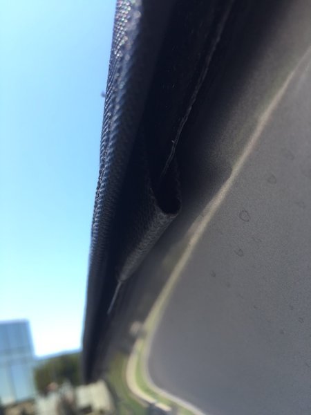

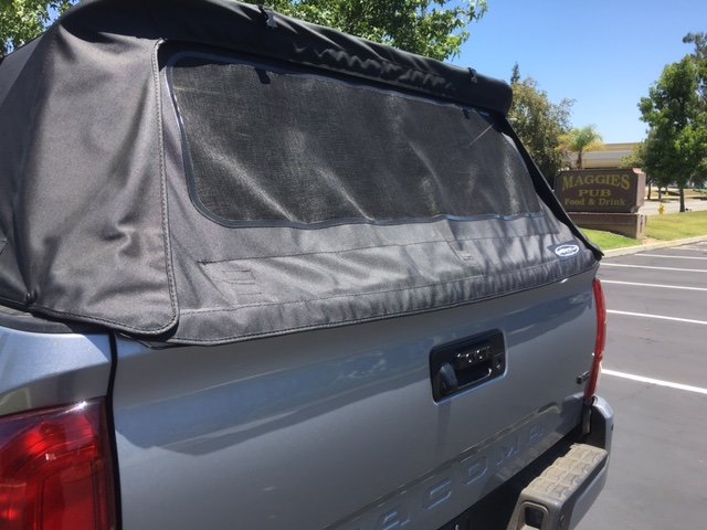

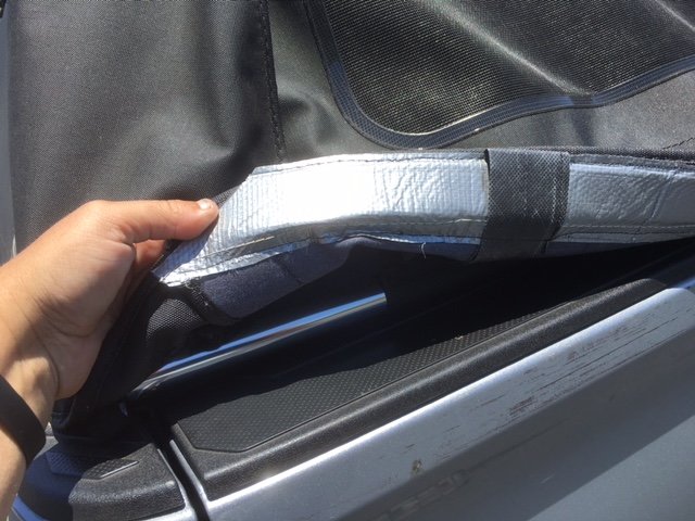

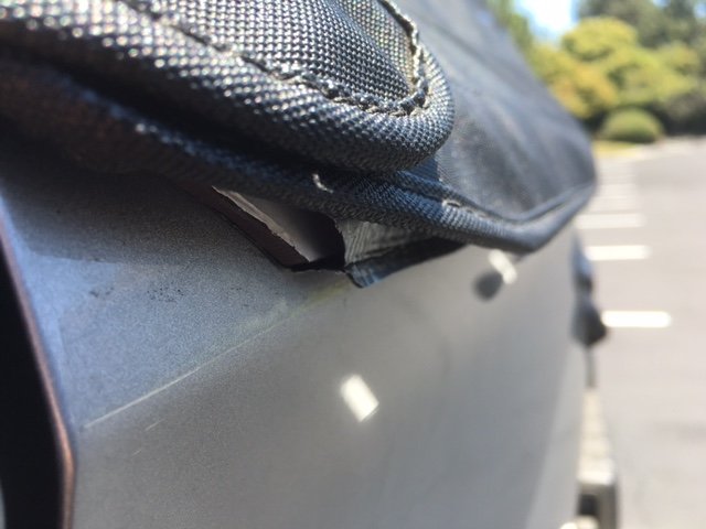

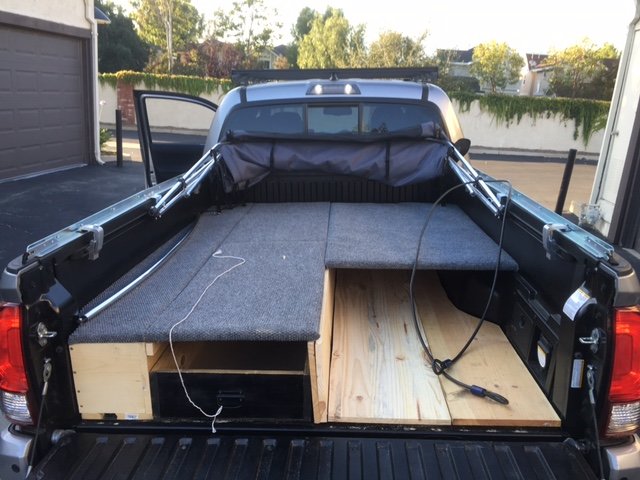

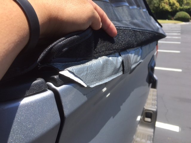

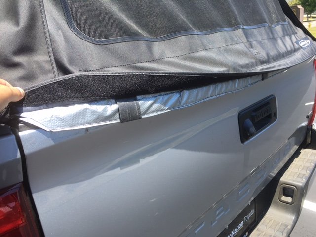

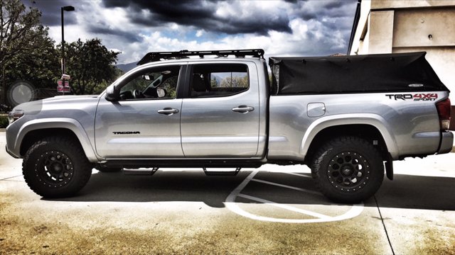

    So I've had a few questions on my ST that may be helpful to others.
    - how did you secure the cab panel? I didn't. The moment I put the Prinsu rack on, I had no flapping problems whatsoever! Win!
    - how do you secure the tailgate panel? I tried many ideas (no offense to anyone here). I found that the magnetic strip stuck to the Velcro strip failed after about 3 months/hotter temps here in SoCal. I ended up with a "pocket" sewn into the top line of the Velcro on the panel itself. This pocket holds the magnetic strip and it works very well. I won't be needing anything else to fuss with. Win!
    The following pics were taken just after installation so they are a bit unprofessional looking. I still need to trim up some of the pocket material (tarp like material) that is very weather resistant and seal in the magnetic strip.
    It works very well and I have not had any flapping of the tailgate side even though the pocket isn't sewn on top and bottom. You can still see the adhesive left over on the tailgate that needs to be cleaned up (so over it!)
    Also, I did notice that the mesh panel has a bit more of a sloppy look where it connects to the tailgate, a wavy pattern of sorts due to the material vs the vinyl window "tightness".
    I have had the ST on the freeway without a tailgate panel without any problems.
    Can run storage and sleeping platform without any issue as well.
    I LOVE THIS THING!!!
    Any questions, let me know!
    @Paul631 here ya go!

    Thanks for posting this. So I just bought a used softopper and most of these buckles are cracked and broken. I was going to see if softopper sold replacements but these seem to work well? Where could I get these from as well? Thanks :)
