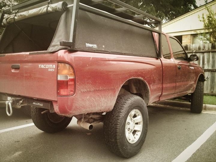

    I'm going on 4 years with my Softopper so I thought I'd share some of my thoughts:
    I've taken it through a handful of automatic washes and through Hurricane Irene with no problems. I have driven maybe ~110mph with it. (Downhill only: truck doesn't drive that fast.) Its basic design is sturdy.
    I laced the doggy door shut using a hole punch and 550 cord. If you have the doggy door that is absolutely necessary if you are going to drive it through severe thunderstorms. I tried velcro on the vinyl first but summer heat melted the adhesive.
    Although the top leaks less in severe weather than my previous Leer top, I built a plywood shelf with skids (72 x 40 inches) in the bed that pulls out. The shelf keeps everything elevated an inch or so off the bed and bone dry. It also helps me load and access items deep in the bed. The shelf has a lip to hold things on it as I pull it out.

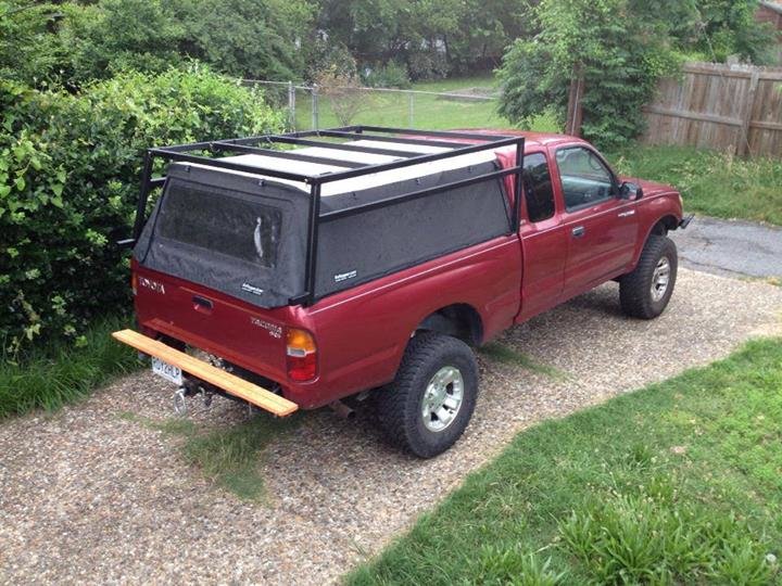

    I originally planned to replace the plastic brackets that hold the rear door bar in place with metal brackets. Instead, I incorporated step pegs on a cargo rack that also protect the brackets. (See picture.)

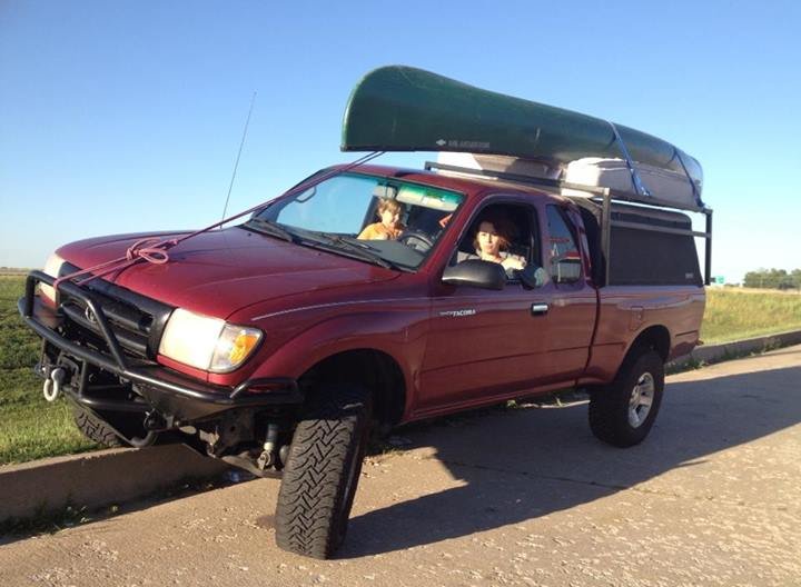

    I had an overhead rack built from 1.5" square tube, with four removable cross bars and a platform on top for camping on the roof, and stake pockets on the side rails to extend the rack upward if necessary. The rack is half the weight of the only quality commercially available rack I found for this application (Kargo Master). I might still have the plans I drew for it if anyone is interested.
    I trashed the bed clamps and screwed everything straight to my bedrails with sheetmetal screws. This keeps the aluminum base bars from bowing outward in the middle. The whole top fits and looks better now.
    I had a white panel sewn in on top instead of getting an all black Softopper. (You have to catch them at time of manufacture to do this.) The white panel makes it cooler for camping but it is a PITA to keep clean. It currently has a lot of mildew staining on it that I need to clean off.
    My fuel economy has suffered about 1 to 1.5 MPG with this setup. Interestingly, that loss was BEFORE the rack went on. The rack hasn't significantly impacted fuel economy.
    The top offers little security for items in the bed and poor visibility, but you already know that. You buy it for its versatility, and hopefully you buy some stick-on convex side mirrors too.
    My only major complaint is that the mesh and the vinyl windows are on two separate doors panels. This is a PITA when traveling cross country through rain storms and camping in the back, when you need the functionality of both panels, but have to change the entire door out to either let the top breathe or protect your cargo. Softopper should really offer a 2-in-1 option.

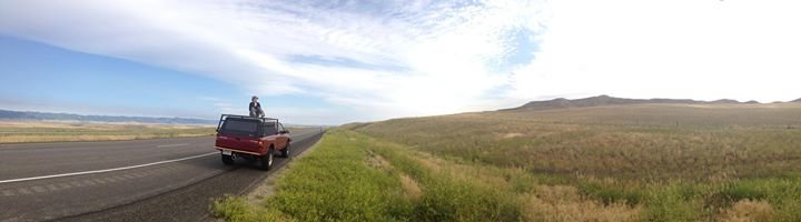

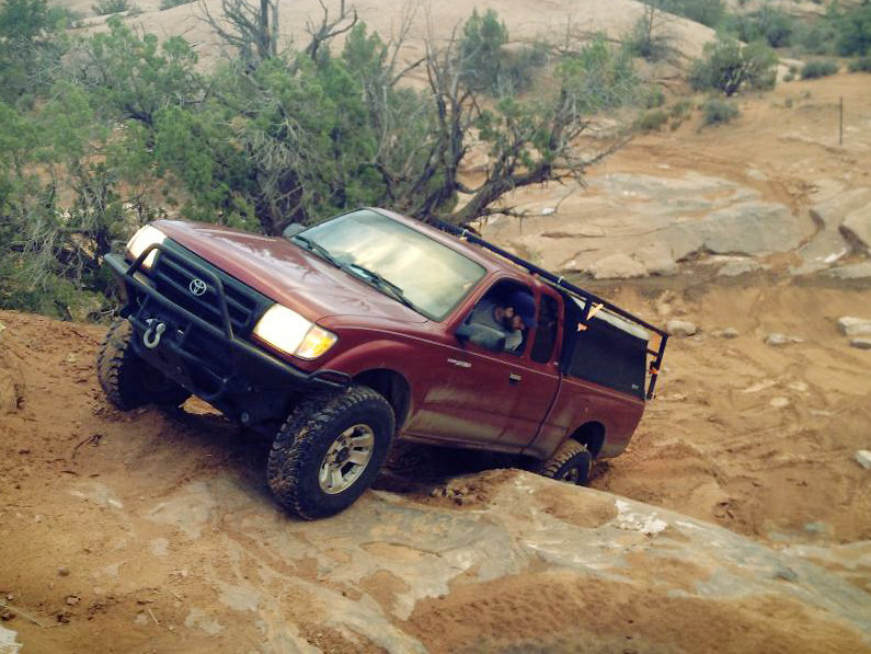

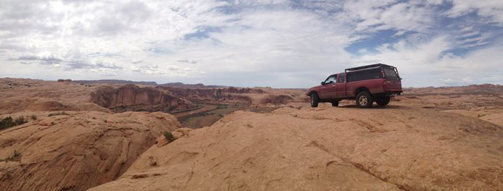

    Here are some pictures from Hell's Revenge trail in Moab and other parts of the West. Since these pictures, I gusseted the front corners of the cargo rack, changed the rear bumper to one made of 6-inch C-channel on a 45 degree angle for clearance, and put in a Powertrax No-slip.

    Nice write up!
    I put a tarp down at the bottom for the leaking issue, like you said the water runs down the channels and the stuff on top stays dry.
    I didnt go with the mesh window for the reason you gave, I didn't want one more thing to carry and swap out.
