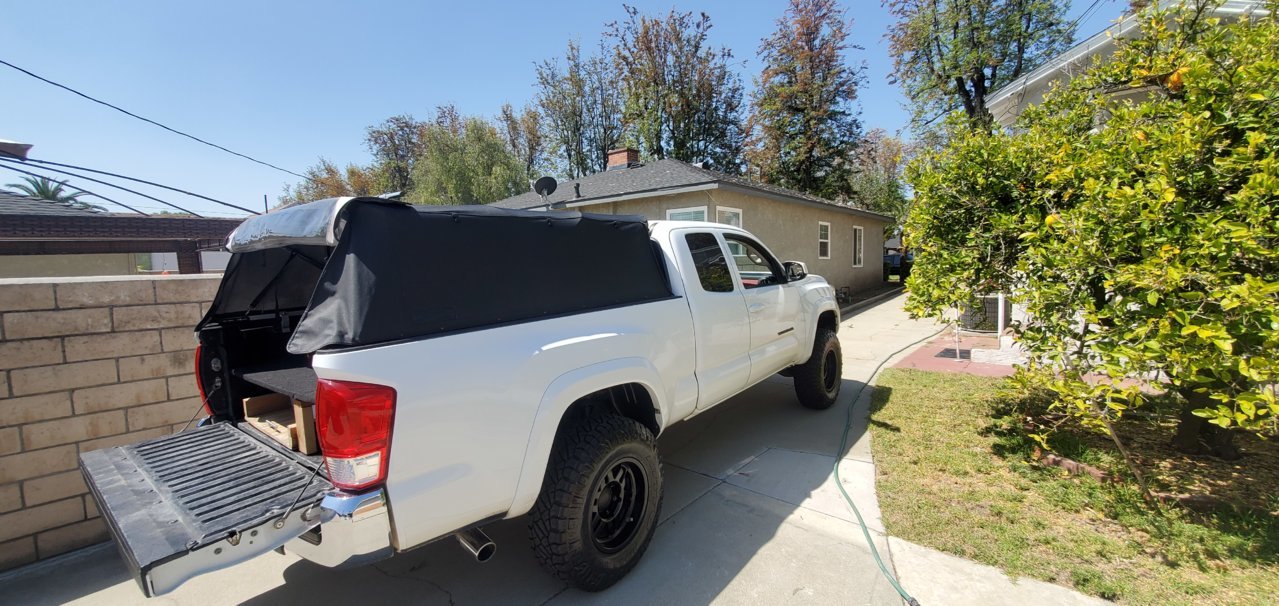

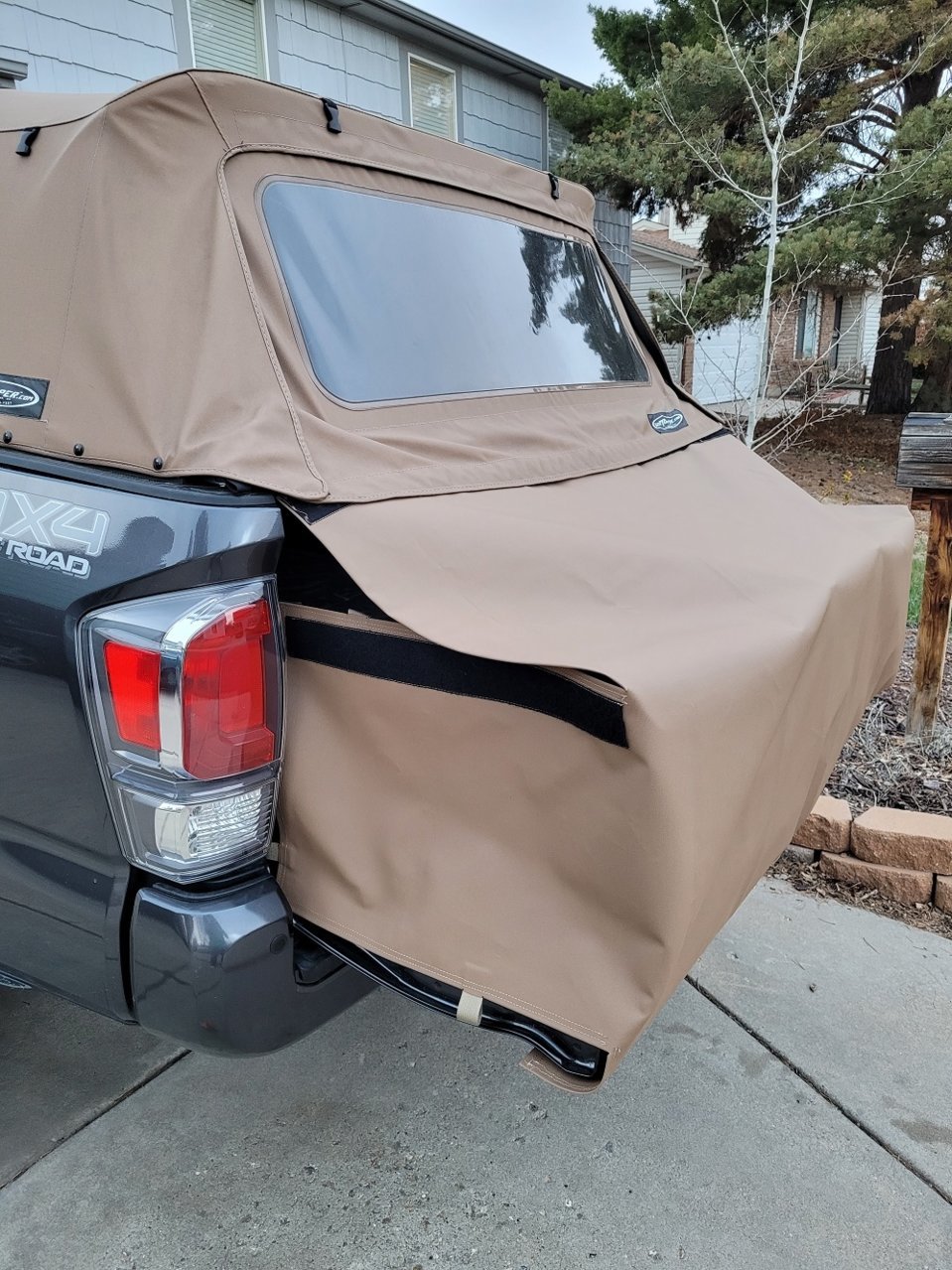

    I made a little extension for mine out of the same material (Softopper will sell you material at cost if you just ask.. They're a solid company.) Sleeps just fine for two people, and I'm not even that small. I'm a bit over 6' and 215lbs and my gf and I slept in the bed just fine under the topper. The tan keeps you a bit cooler, too.

    That looks good! How much did the extra material cost you from softopper?

    $25/yd. Typical fabric sizing, 36"x60" for that price, and I bought 3 yards and used most of it. So the whole extension cost me $75 in fabric and maybe $20 in straps and velcro.Letsdoit.jpg

    If you got more pics, I'd love to see them. I've been toying with this idea and I really like how yours turned out. Well done

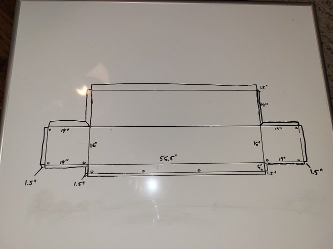

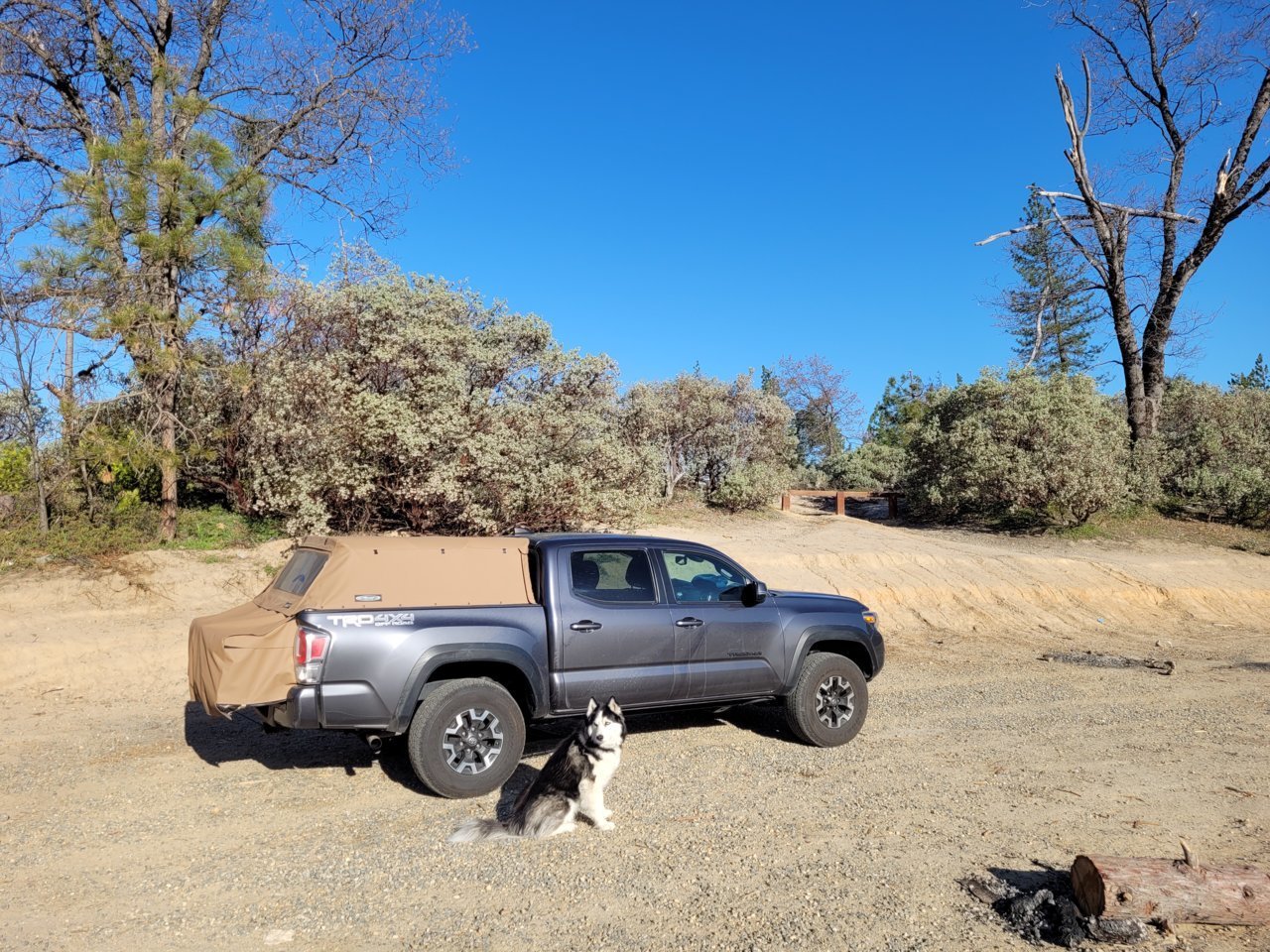

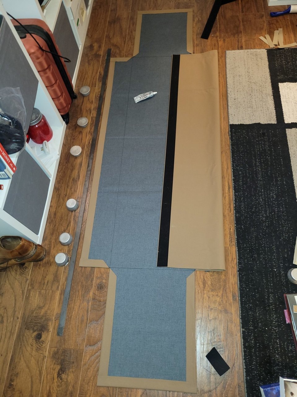

    This was the plan I used for this first iteration. Honestly, knowing what I know now, I would go back and do it differently. The current version has a bed extender on the interior to give me that 16" of vertical, which makes it pretty roomy. The downside of the bed extender is that it makes it annoyingly more difficult to get in/out. I'm probably going to get some more material from Softopper and do a simpler setup that just goes straight from the velcro on the back of the topper straight down to the end of the tail and excludes the bed extender entirely. Maybe throw a zipper up the middle for easy in and out.

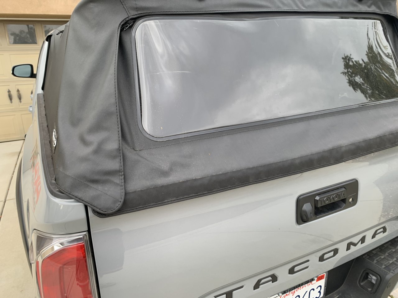

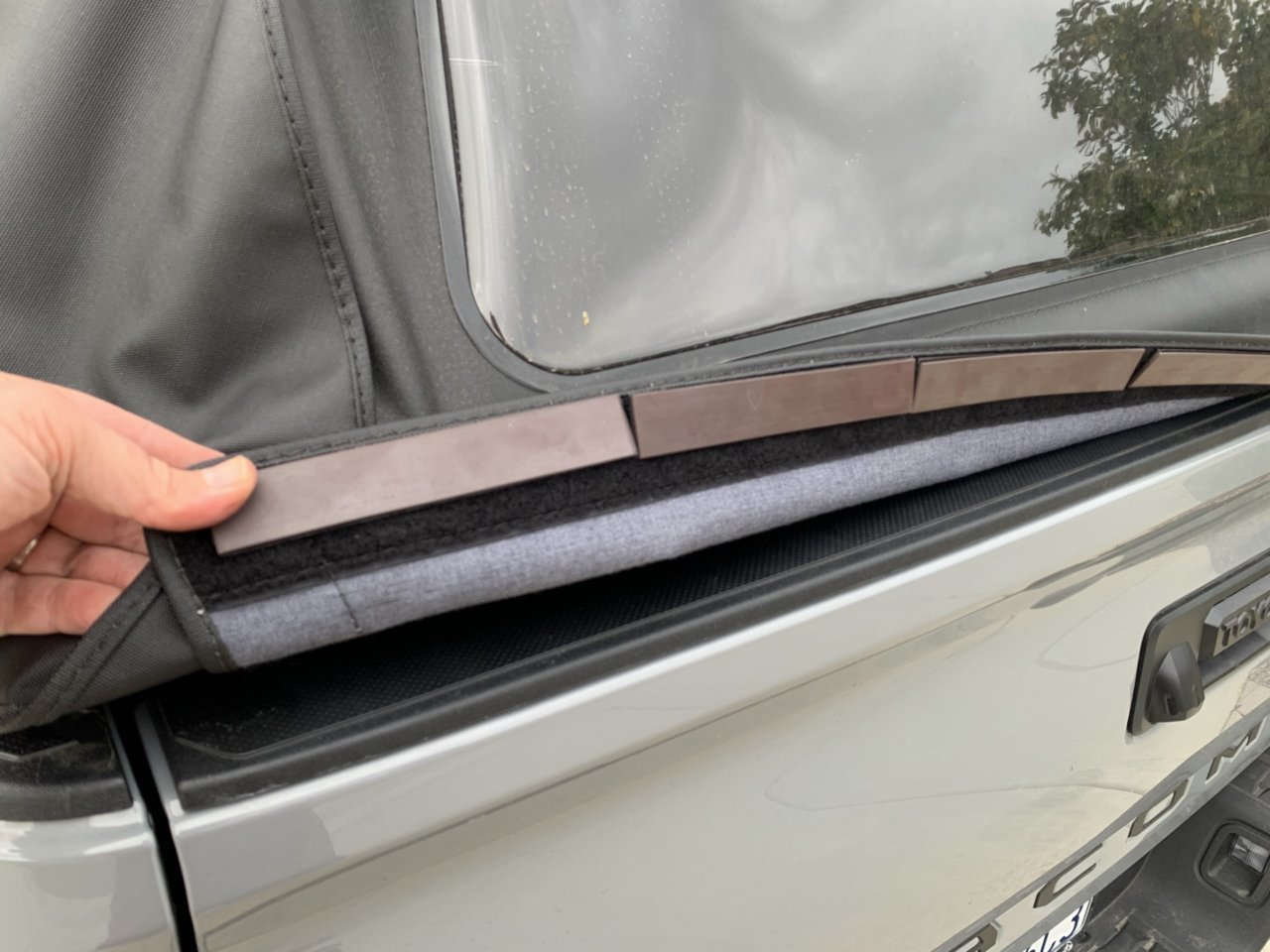

    I added some magnets to the Velcro adhesive strips. Fits snug, no more flapping on the freeway.

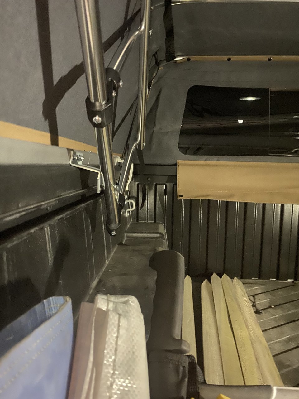

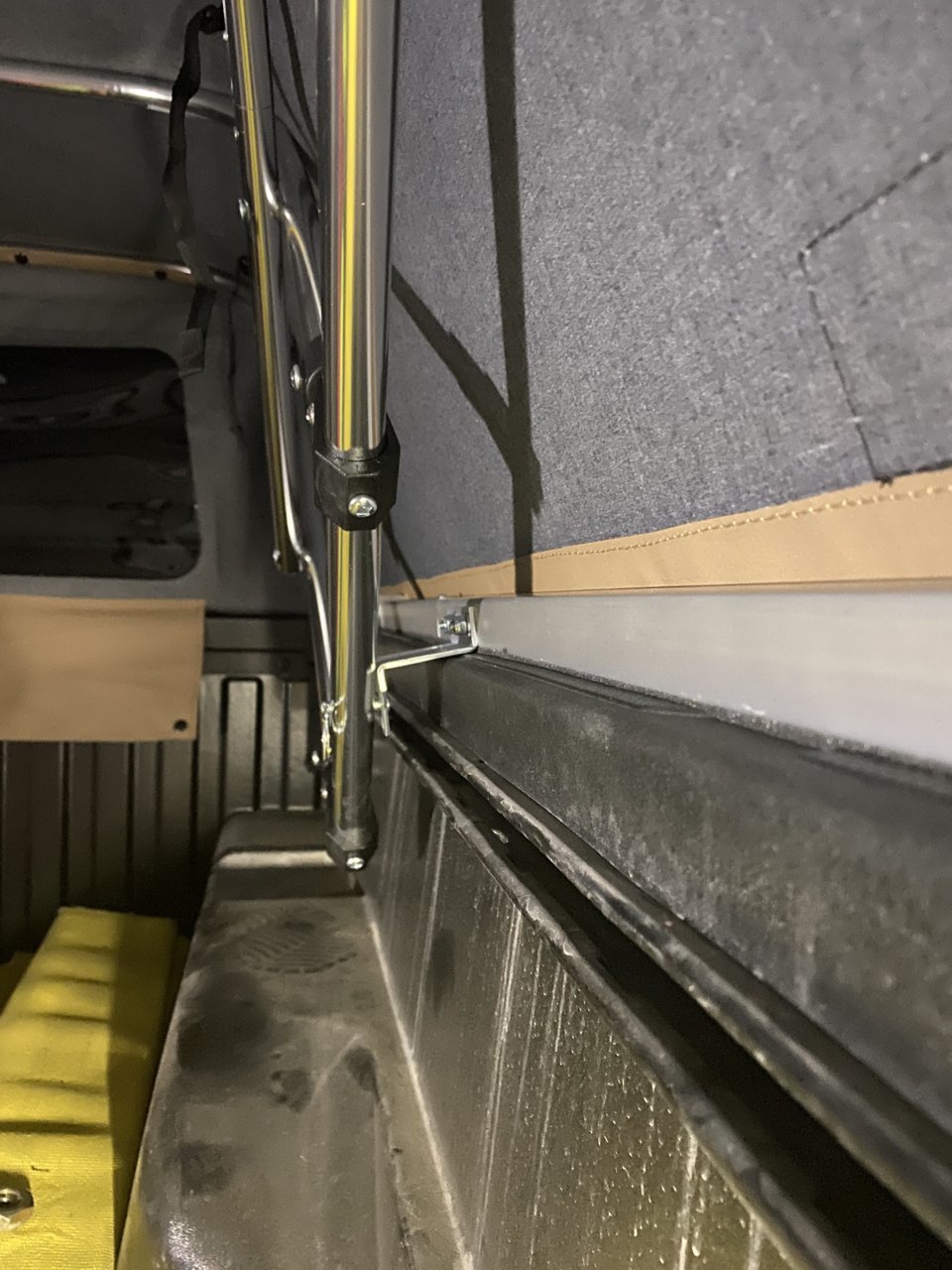

    So I installed my softopper tonight. It went well my only concern is are these mounts supposed to be bent/twisted like this?
