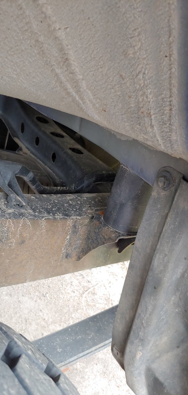

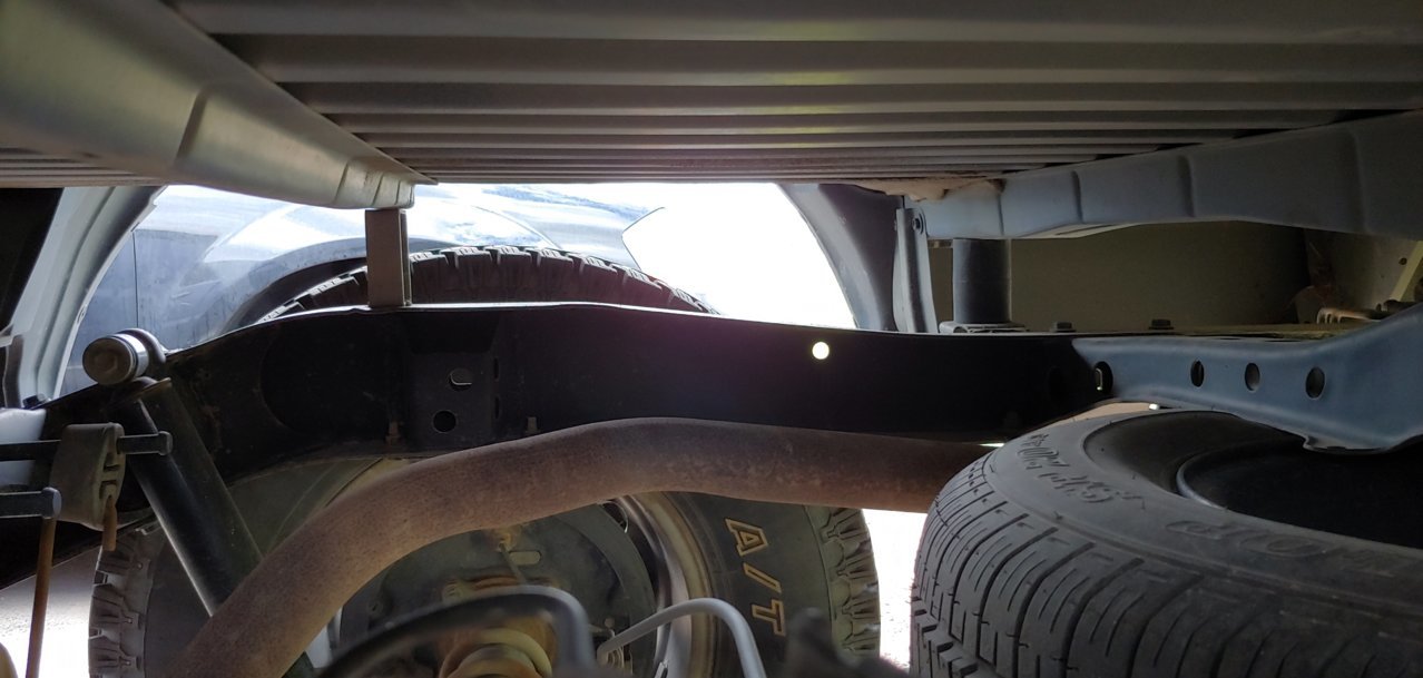

    Okay. So removing the body lift, would make the ride softer? I'm gonna attach some images of my body lift. 20190425_145554.jpg 20190425_145547_HDR.jpg

    Holy hell that's a body lift alright, and it will help a little

    Curious if the front still has any bushings or if it's just blocks like on the bed there. The front has bushings stock which helps absorb some of that stiffness

    Yeah body lifts go all the way around, and there's no bushings in the front so definitely adding stiffness that way, and yes ^ add some pics of the front suspension

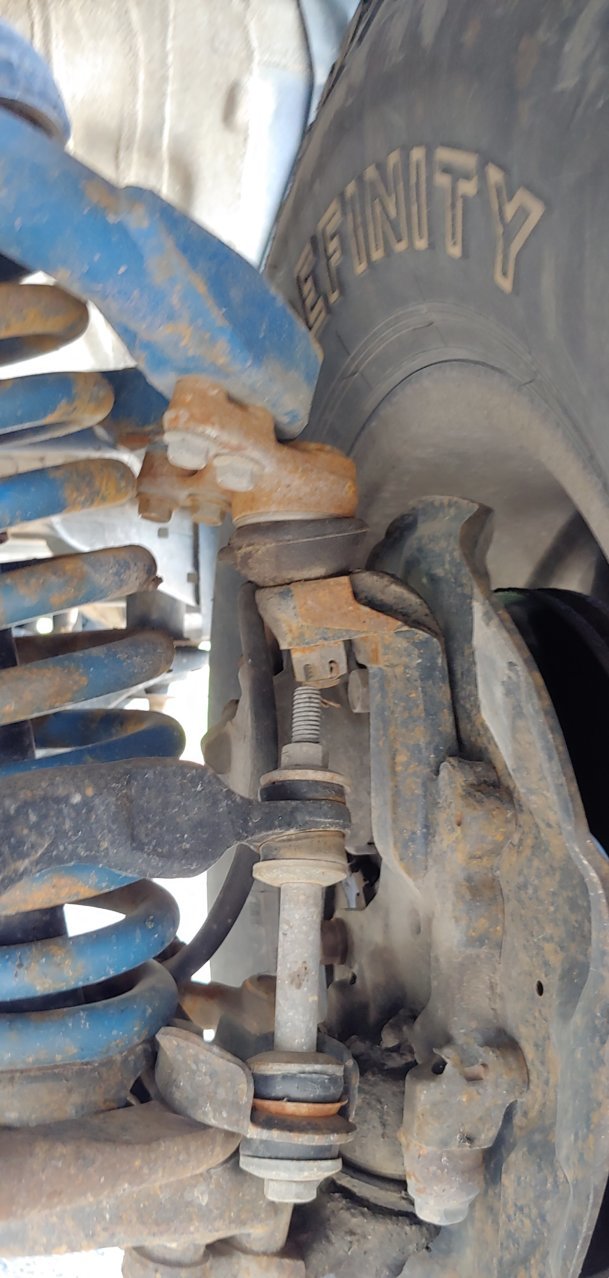

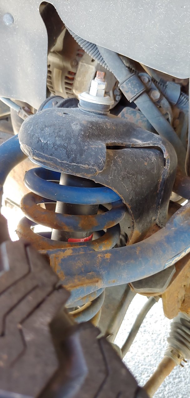

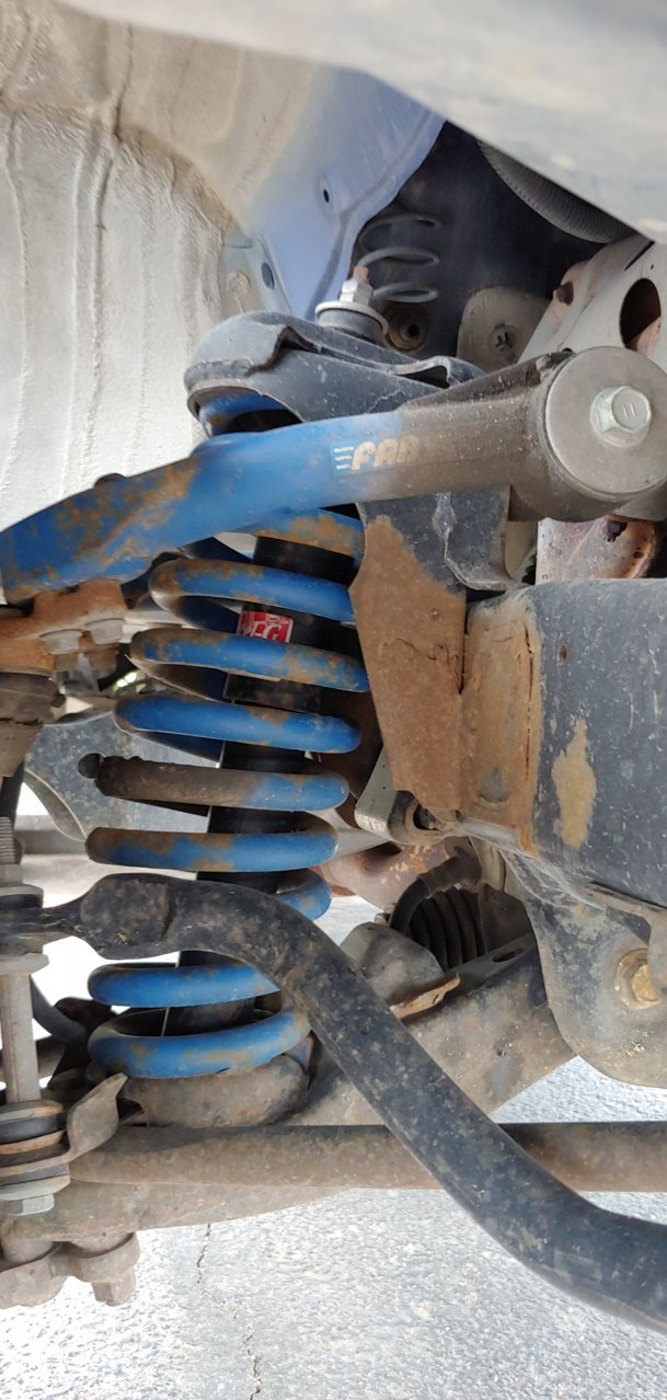

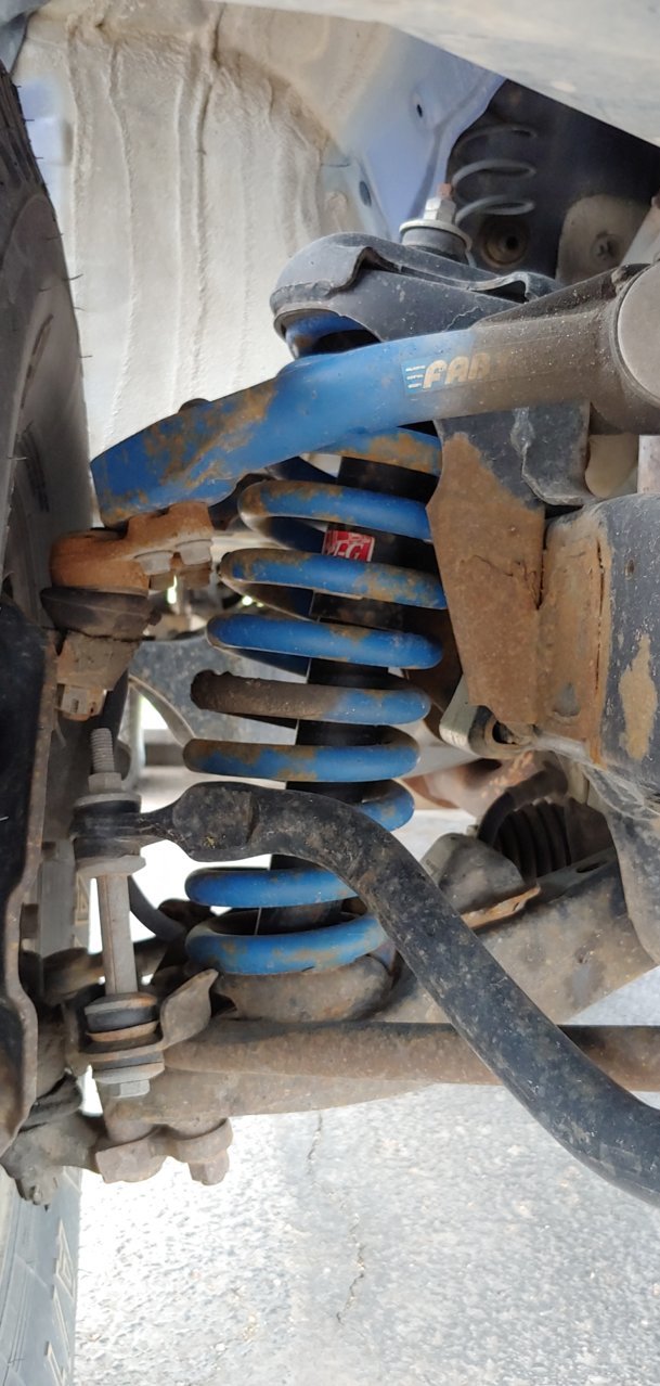

    With a body lift like that, something tells me it's still on factory suspension

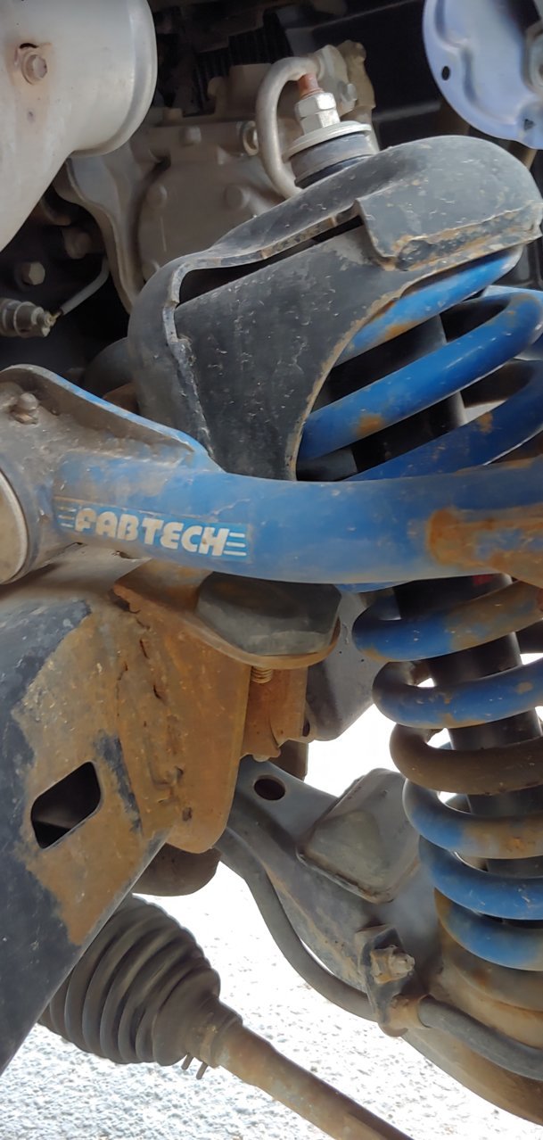

    I can see some fabtech uppers

    ah! good eye

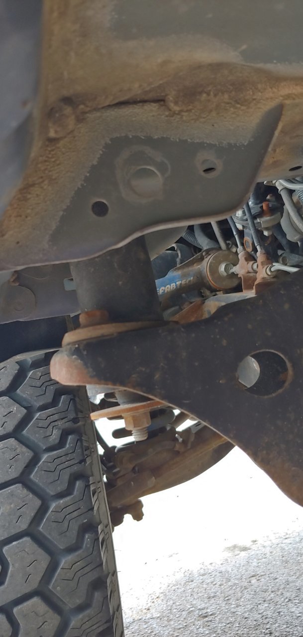

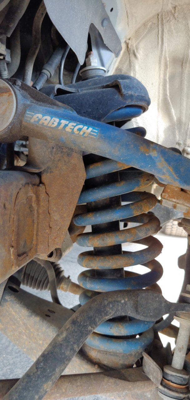

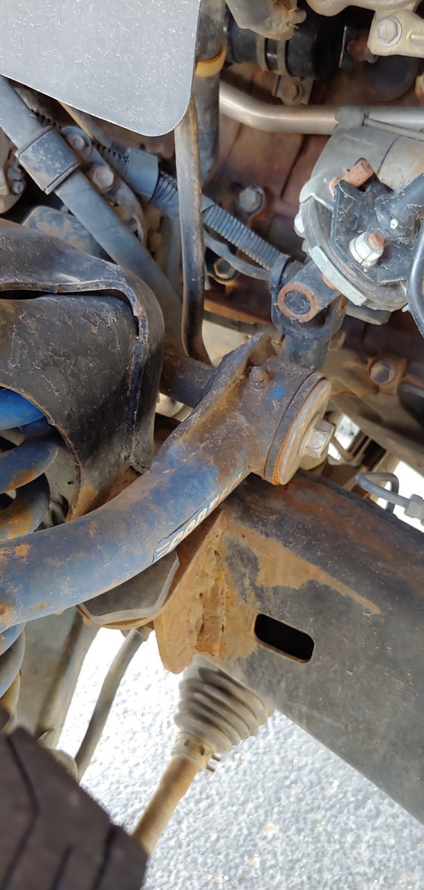

  20. Apr 25, 2019 at 1:43 PM
    #20
    Jpowers24
    Jpowers24 [OP] Well-Known Member
    Mar 15, 2019
    #286738
    50
    Jake
    1999 Toyota Tacoma 2.4L
    Here is as many pics I could get of the front suspension
