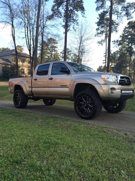

    stock is most likely going to be your best bet. when i ride in a stock suspension tacoma compared to mine (which is a fine ride to me) it feels like I'm riding a cloud lol.[​IMG]
