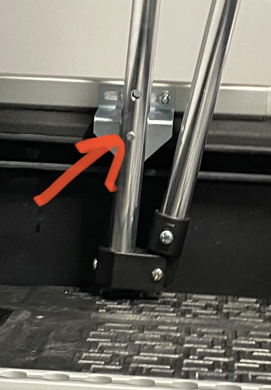

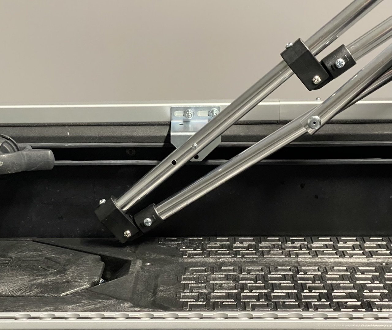

    I wanted to share my experience with combining the Decked storage system with a softopper.
    I already had the Decked system installed, and did a decent amount of research into the compatibility of these two systems before pulling the trigger on a Softopper. Or so I thought.
    What I found was a handful of instances where people said the two systems work together no problem. It wasn’t until attempting the install that I realized that wasn’t quite the case.
    As you can see in the first image, the frame doesn’t have enough room to pivot into place because it is blocked by the top of the Decked bed.
    The solution is relatively simple, although I was initially hesitant to drill a hole and alter a brand new price of gear in case I wanted to return it. I basically just drilled a second hole in the frame about 1.5” below the existing hole. When it’s time to open/close the topper, I just have to put the “pin” on this second hole. This creates a new pivot point and allows the frame to swing into position.
    Unfortunately, I can’t leave it in this hole all the time, because it raises the frame 1.5” away from the rail that the canvas snaps to. The canvas doesn’t stretch enough to reach the snaps. However once the frame is open, I’m able to return the pin to the original hole in about 20 seconds.
