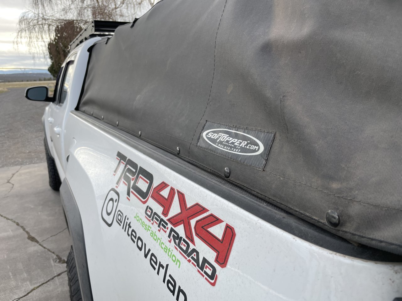

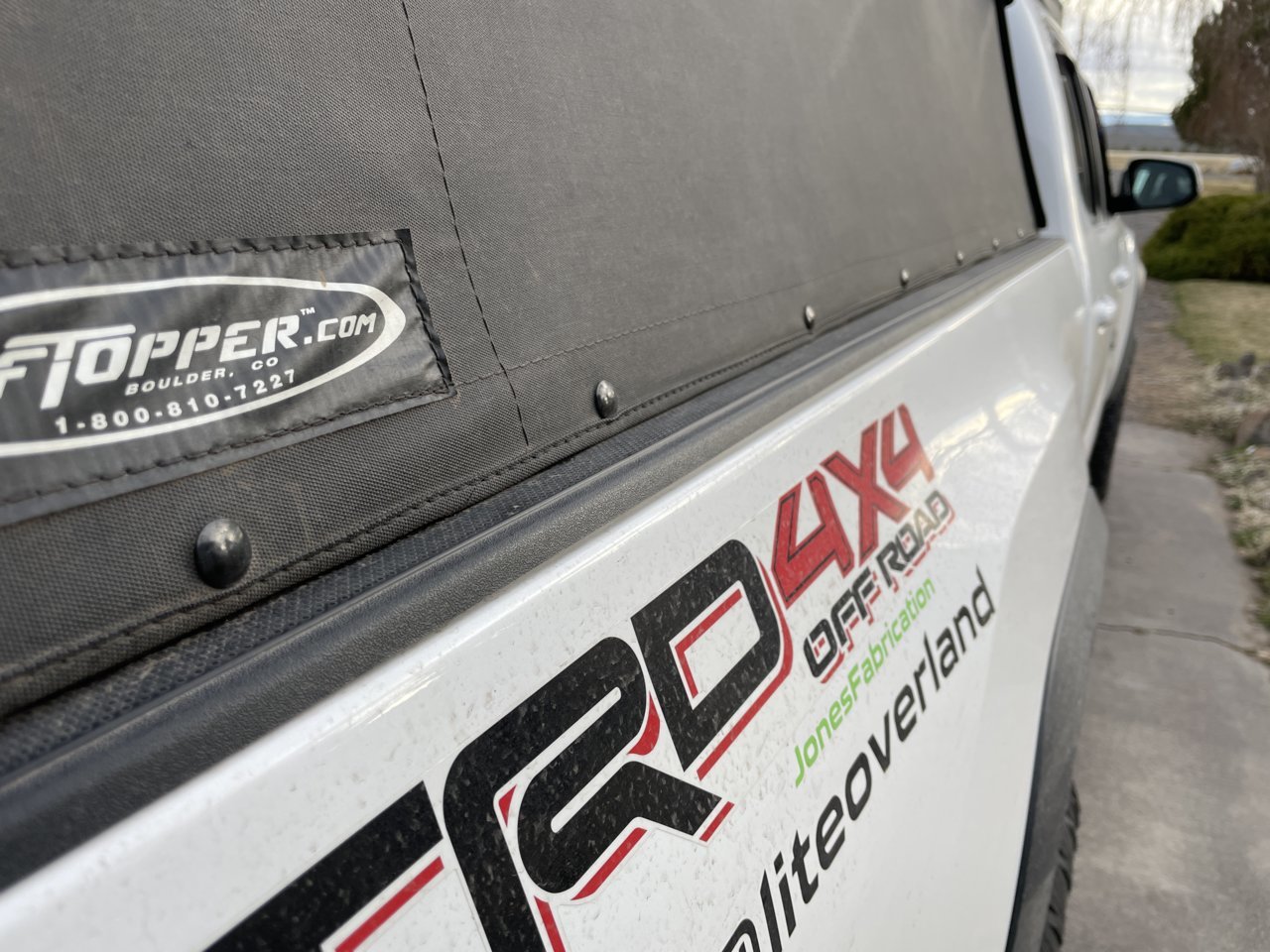

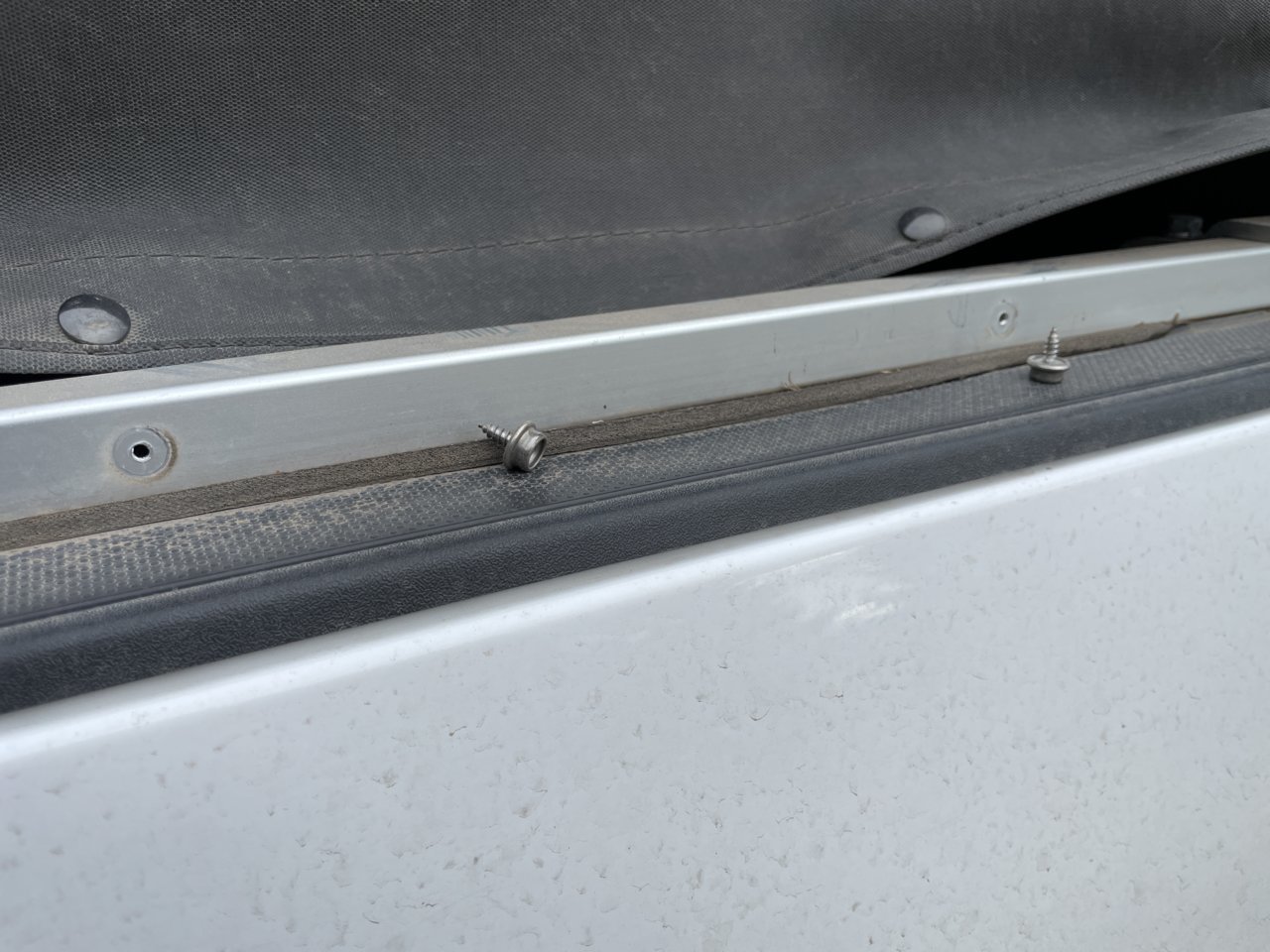

    Hopefully I'm not stealing a previous idea, but I couldn't find anything when I searched. On my Softopper, I have been plagued with several of the snap buttons/screws stripping out from the rails. I think I've come up with a pretty good solution that should last and avoid future issues. Basically I drilled out each hole, inserted a rivet nut, and then threaded snap buttons. This should prevent the issue from ever occurring again. Hope you enjoy the write-up!

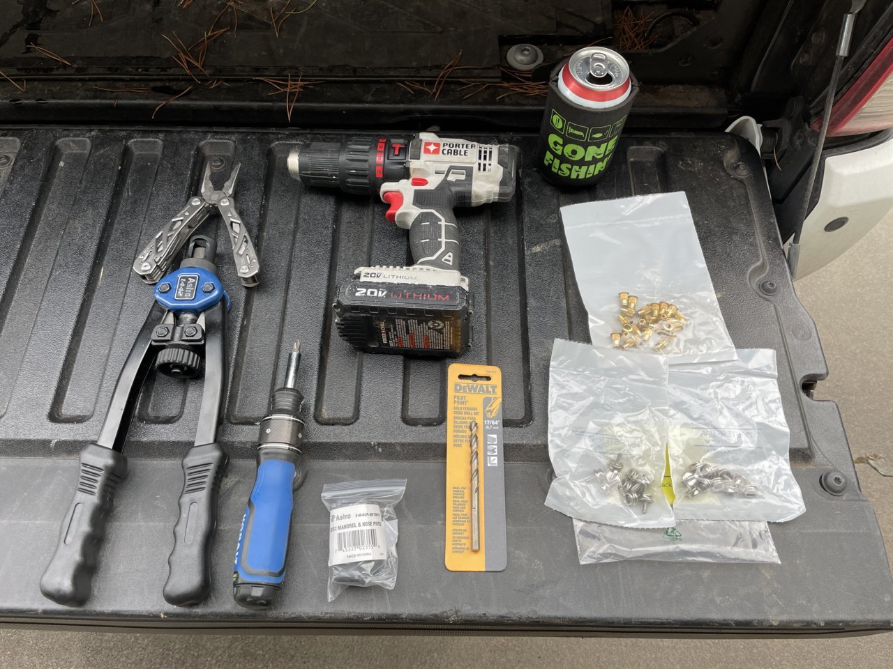

    Things you will need:
    Beer (I only needed one for this, you can have more)
    Pliers
    Philips Screwdriver
    Drill
    Rivet Gun (I like the Astro 1442)
    8/32 Rivet Mandrel & Nose Piece
    17/64 Drill Bit
    8/32 Rivet Nut (McMaster-Carr 95105A123) x18
    8/32 Buttons (McMaster-Carr 95707A110) x18
    Blue Loctite (optional)
    Step 1:
    Look at your sad Softopper with all the stripped out button screws...
    Step 2: Have a sip of beer!
    Step 3: Lay out them tools.

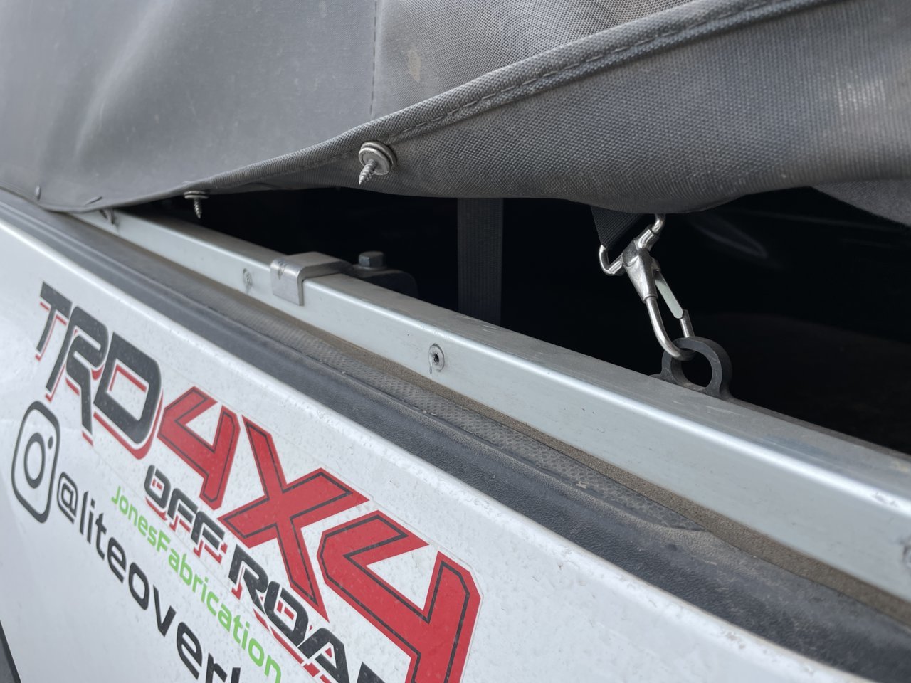

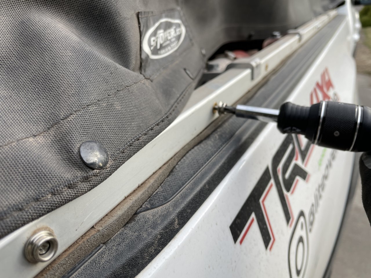

    Step 4: Remove old button screws.

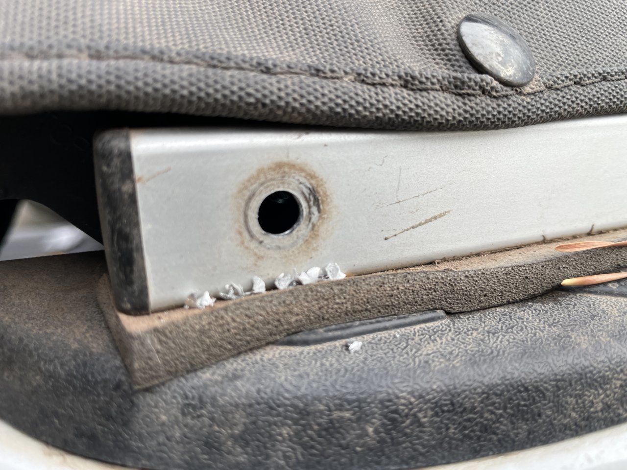

    Step 5: Drill out holes.

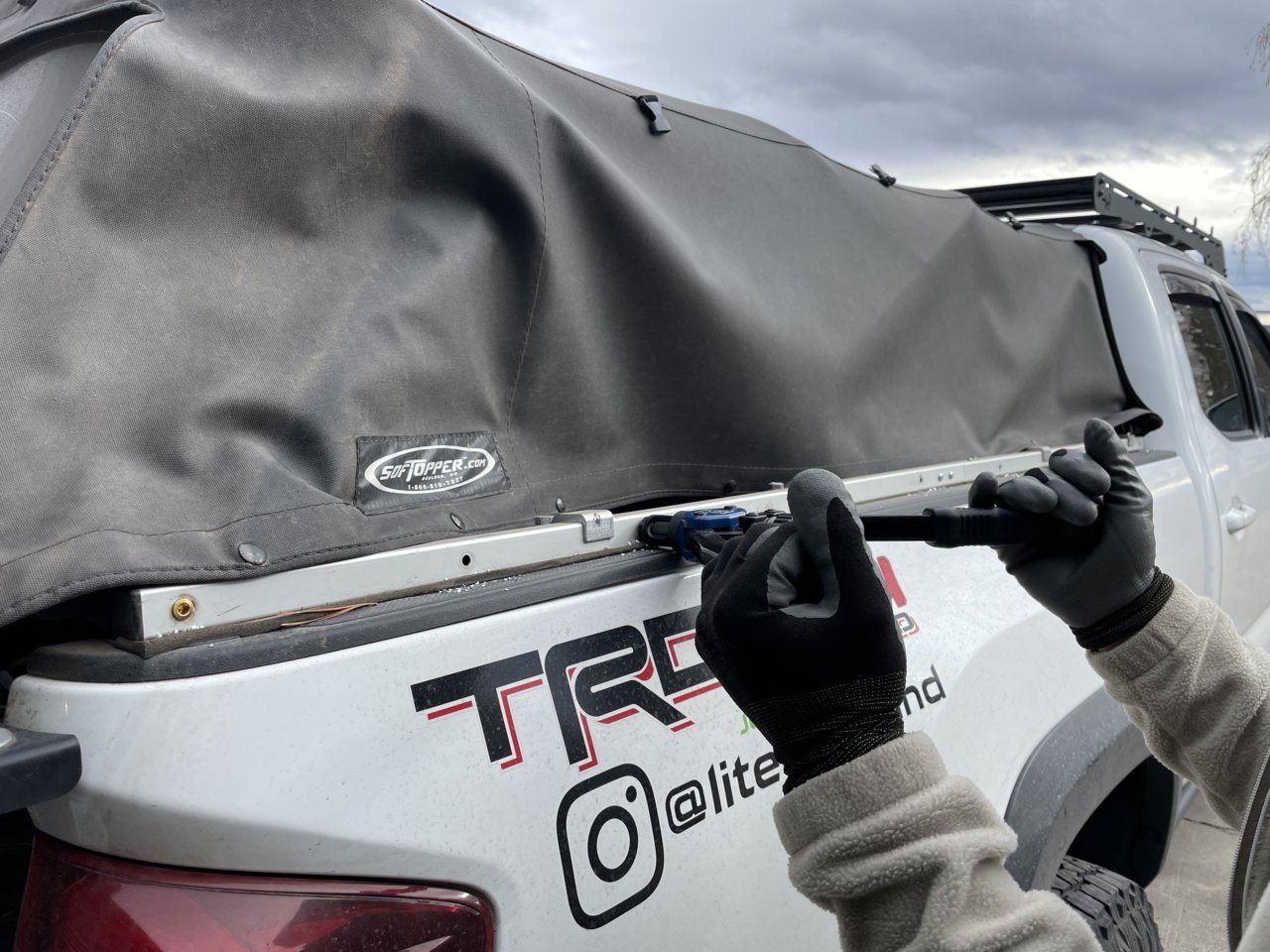

    Step 6: Insert rivet nuts into holes.

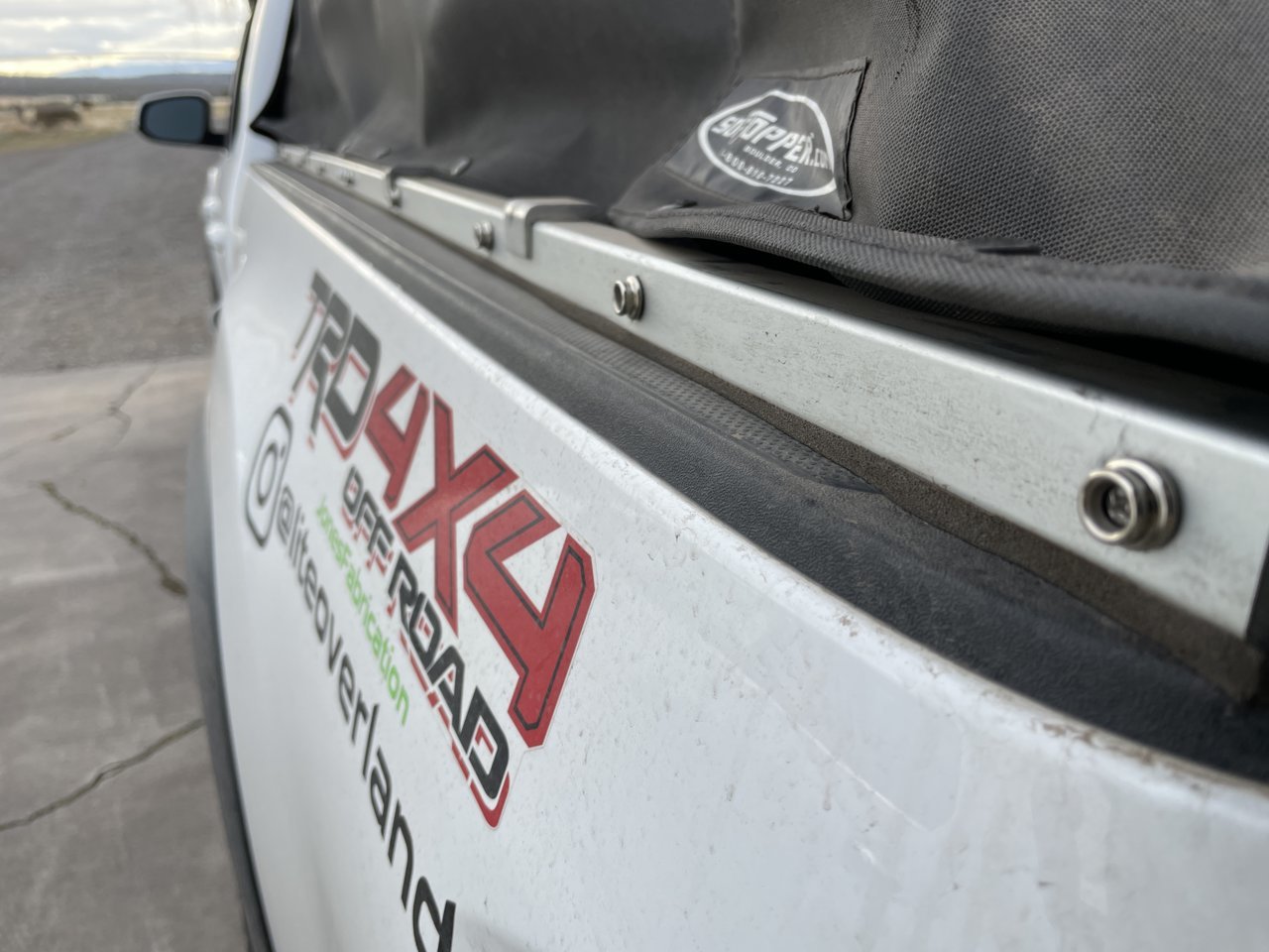

    Step 7: Screw in new buttons (apply Loctite if desired).
    Step 8: Button 'er down!
    Step 9: Rinse and repeat on the other side, and you're done!
