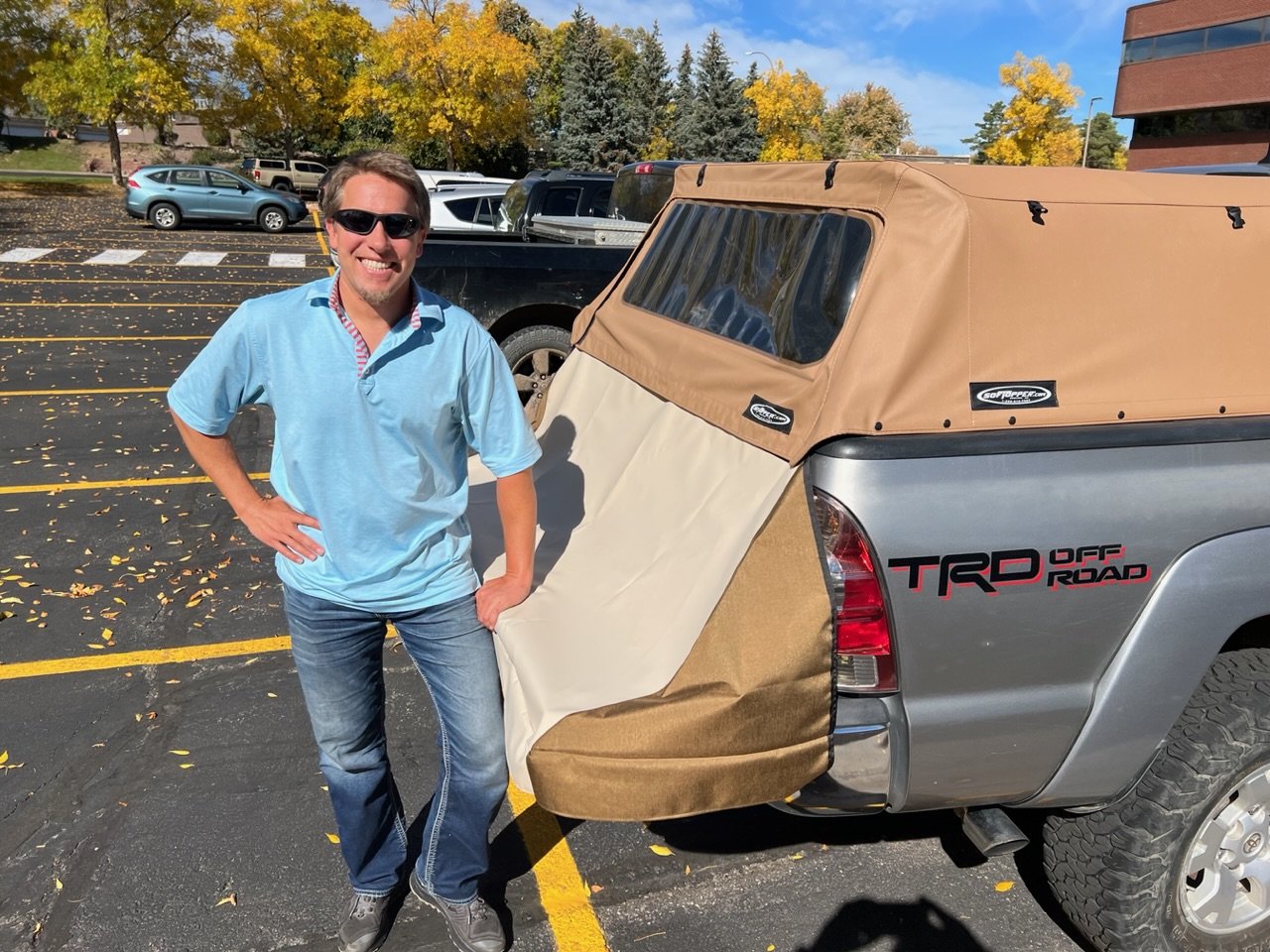

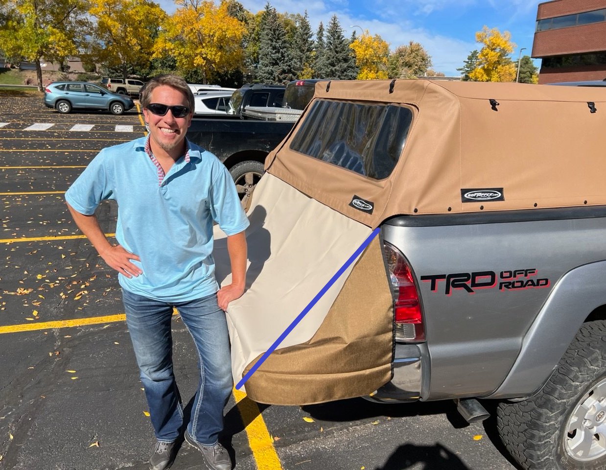

    Here is a Softopper “tent” that lets you fold down the tailgate and sleep comfortably. It velcros to the flap on the window flap so it’s easy to install/remove Without all the fuss like most topper tents. I sewed it up for a friend last night so he hasn’t had a chance to take it out for its maiden voyage. Let me know what you think! Any ideas on how to improve it?

    Looks good! I've had some experience with both DAC and Toppertent extensions. What's the access like getting in and out? Do you just lift it up like a curtain? Any way that it fastens to the tailgate in case of winds?

    He wanted something simple, so you just lift it like a curtain. I did add some webbing loops along the bottom so you can add tie downs for windy nights.
    It would be easy enough to sew in magnets or even just Velcro if you add the Softopper Velcro strip to your tailgate.

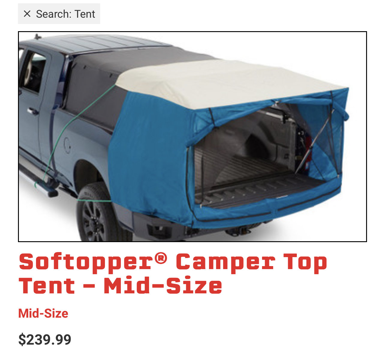

    Softopper has these on their website, but are much bulkier. I’d rather just set up a ground tent than one of these.

    The main panel is 18oz PVC coated polyester and the side panels are 1000 denier Cordura so it should last a long time and keep the weather out.

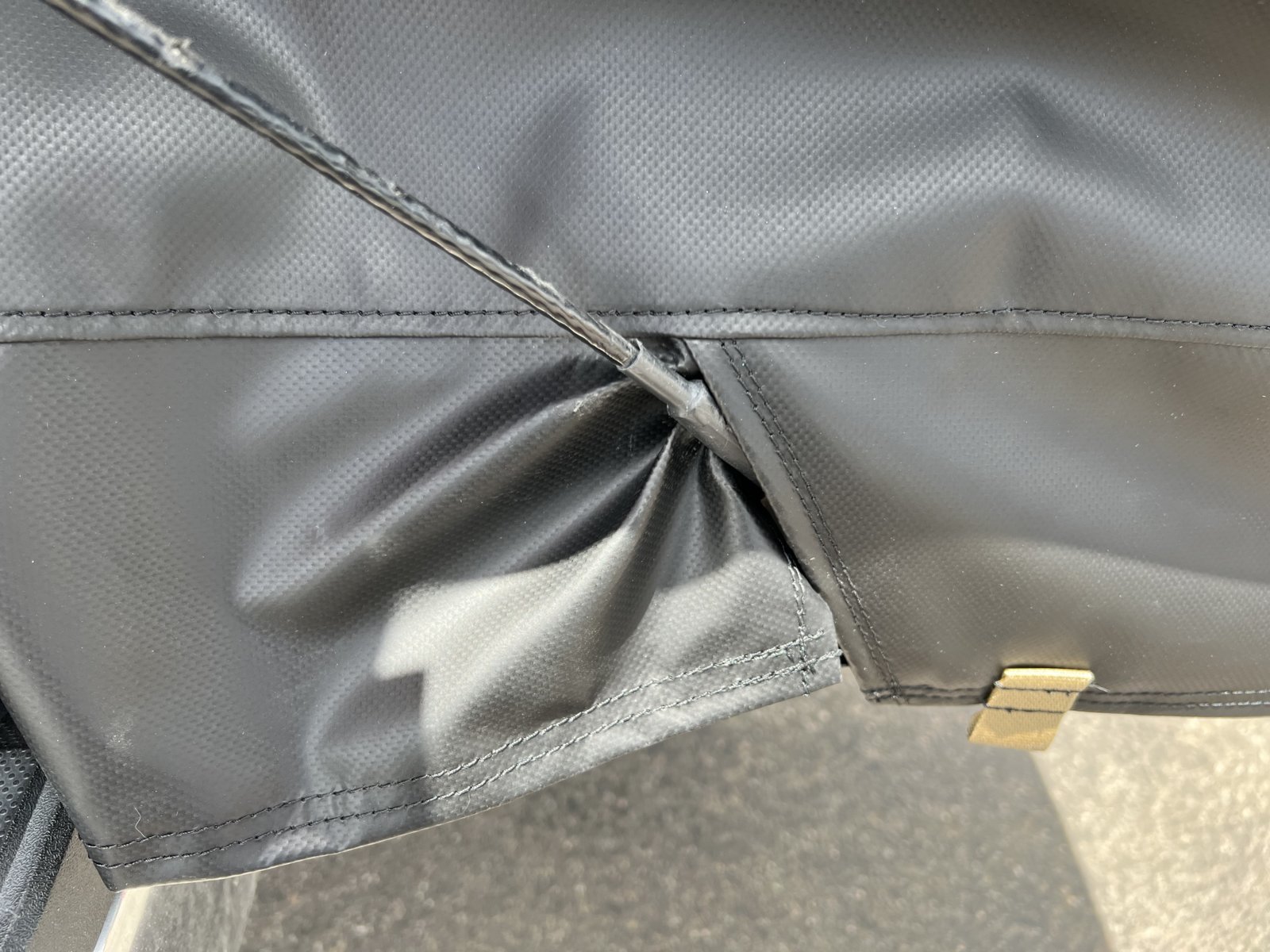

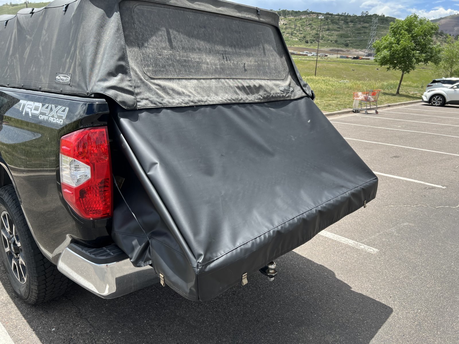

    Came up with an idea for flaps to allow for a better fit with the tailgate cables on a Tundra. I’ll start including these on all of them so they fit better. IMG_6452.jpg
