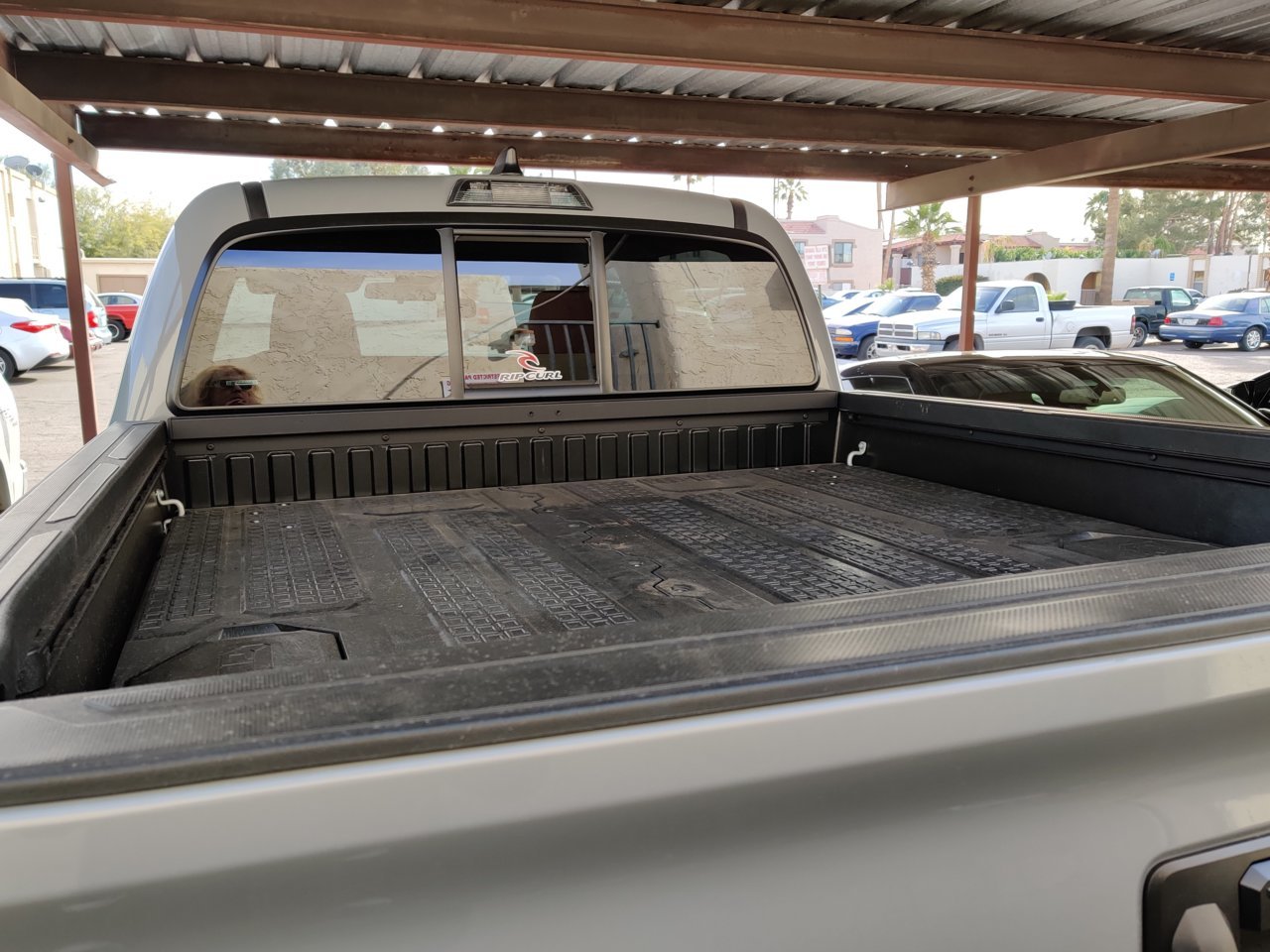

    20200405_151414.jpg Hi,
    Anyone here running a newer Softopper (NOT bestop) with a Decked storage system on a 3rd gen Tacoma?
    I have a Decked system and would like to add a Softopper. However, I am getting mixed information whether or not not it will work. Specifically at the Softopper open/close frame pivot point in reference to the Decked height.
    If anyone is using this, can you please take some picks of the interior frame pivot point and confirm whether or not it clears the Decked height.
    Thanks in advance!

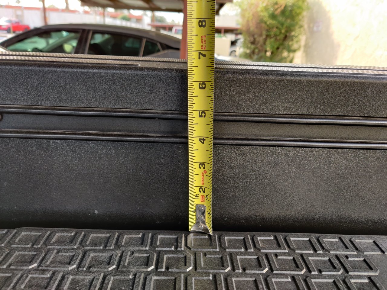

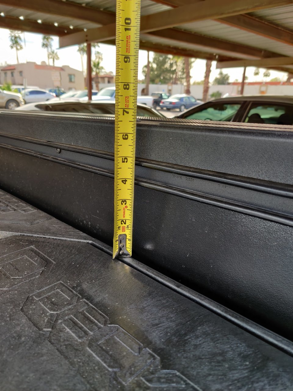

    Doesn't the Decked system only go to just above the wheel wells? From their pictures it looks like there is at least 6" between the top and the OEM tiedown rails. The Softopper pivot doesn't go more than 1" or so below that, so I don't see why it would be a problem. If you need a picture I can grab you one tomorrow.

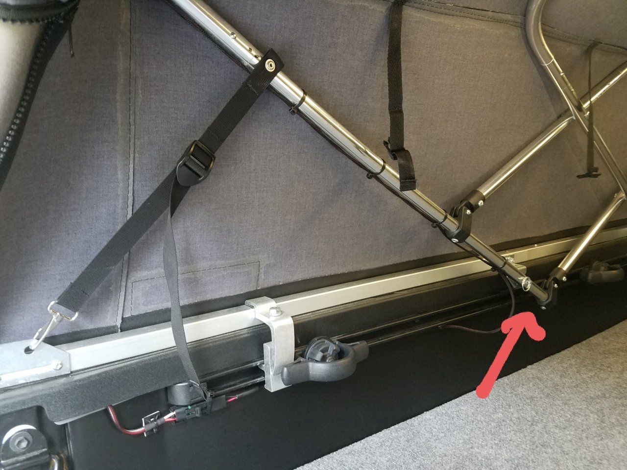

    Hi @lapoltba,
    Thanks for responding. In pictures I have seen, it looks like the pivot point of the Softopper frame may be too long to clear the height of the Decked system when the Softopper is being opened/closed. Please include some pictures, it would be a huge help!

    I’ve got a decked system and a Softopper. I haven’t had any issues with my setup.

    20200405_151414.jpg @El_rojo_grande,
    So, you're able to fold the Softopper (not bestop) back to the the cab without the softopper frame hitting the decked system at the pivot point connection?
    Can you post some pics?
    Thanks

    I’ve never folded mine since I’ve had the decked system in, but I don’t see any reason why it wouldn’t. The lowest it’s going to be at the pivot point is where it is in the upright position. So there should be no clearance issues when folding it.

    It will drop down a bit further when you go to fold it since that hoop rotates forward through vertical.
