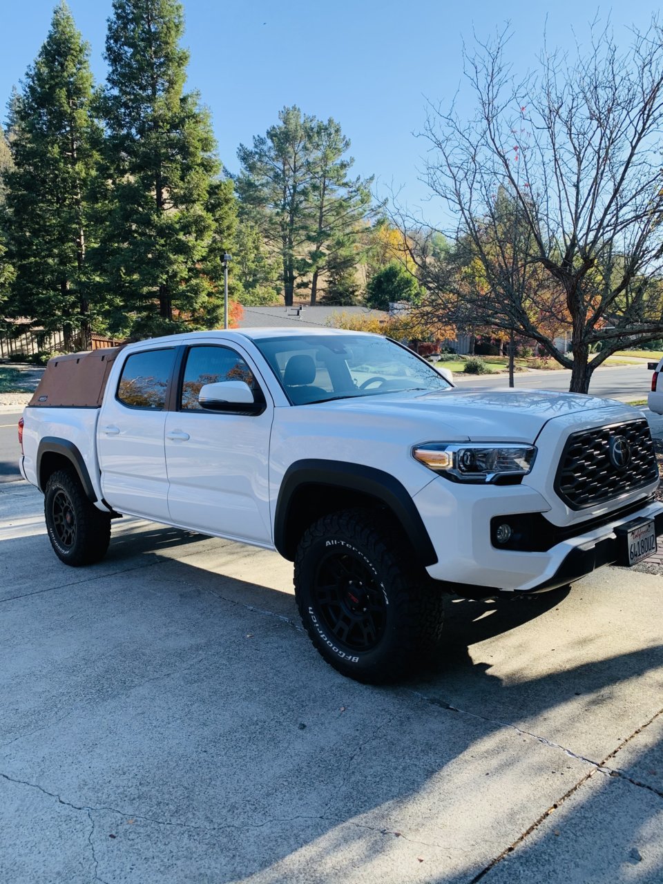

    The installation was easy, but the unit I had received needed some fine adjustment. The super top sat fairly leaned away from the cab allowing it to catch more air. I had to move the supports around to make it sit straight and flat. It took 5 minutes, but you would think that they would just have it set propper. the pic below is after the adjustment, the front of the supertop 2 is flat instead of leaning away from the cab.
    The one thing that always irked me was the fact that the rear center cross bar would leak tons of dirt/sand. The design has the rear flap pulling up on the bar which makes it bow in the middle.

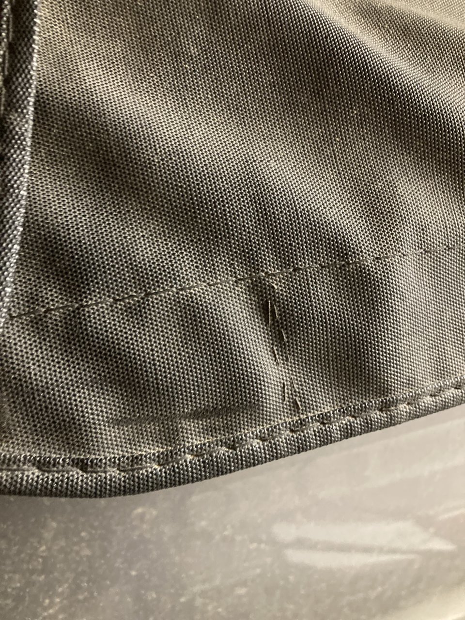

    Softopper by far. I called Bestop once and after the attitude the gal gave me over the phone after asking questions the decision was easy and I’m glad I chose Softopper. Plus I added little earth 3” strip magnets inside the bottom of the rear flap by sewing them in between the layers so no adhesive Velcro needed. Works like a charm

    What is involved in adding the magnets? That seems like the best solution to rear flap issue.

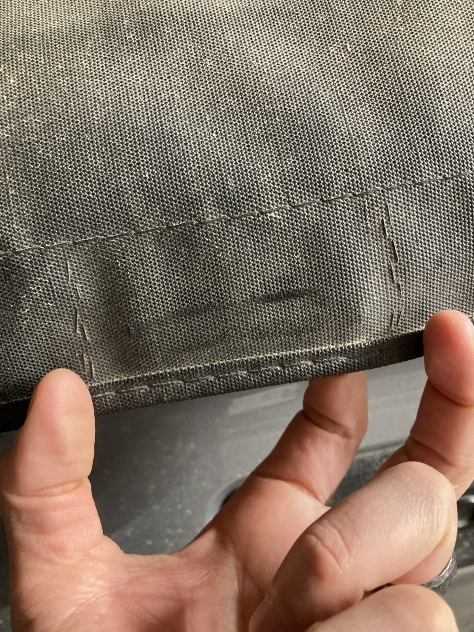

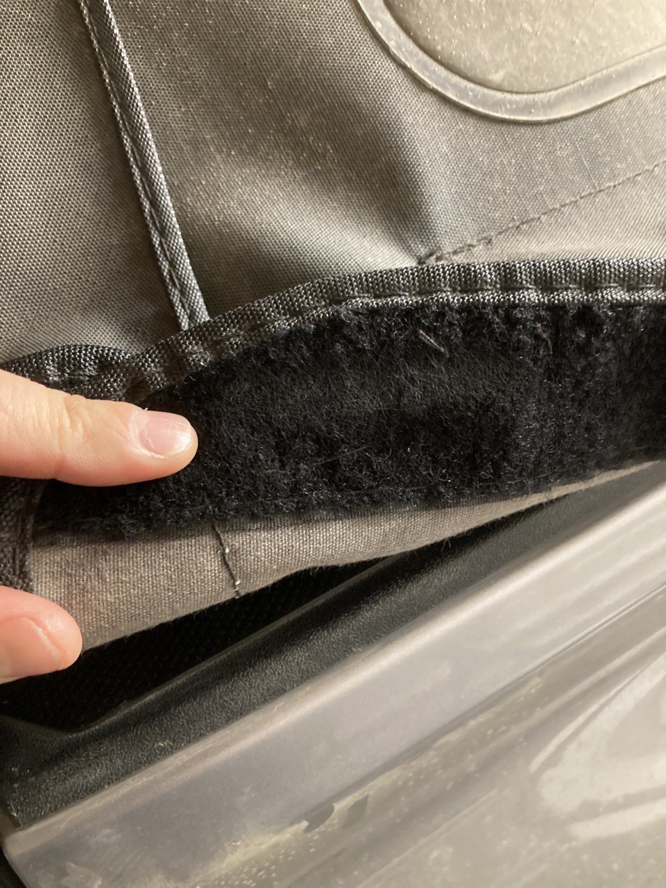

    At one end of the flap make a slice gently flush so you don’t cut through both layers. Use an exacto knife with #11 blade. I used a yard stick to slide the magnets down the length and then sew each one into a small 4-5” space. Hopefully you can see these pics.
    My finger points to the slice/insertion point. Then you can see where I stitched each section. 5 sections total. Took one hour

    Ok... I think I understand. You cut a slit in the Velcro and slide the magnets into the space between the Velcro layer and the canvas layer. Do I have that right? And then you are stitching around each magnet so that you can keep them evenly spaced? Seems like a good solution. Let me know if I’m understanding it correctly.

    correct. And I used the Velcro up front on the inside of the bed with the snaps screwed into the bed plastic. After two coats of seam sealer it doesn’t leak at all and I’ve been through some hellacious rain
